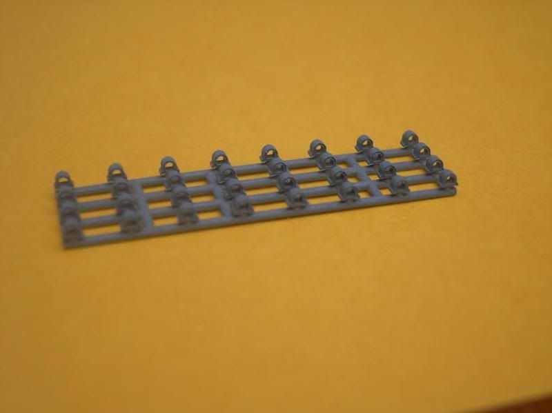

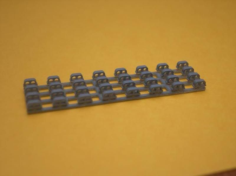

Got another couple pics of pieces that will eventually find their way on this build. I had some single- and dual-line clamps 3D printed for securing my fuel line on the car. They turned out pretty nice, I think. They are design/intended to fit Pro Tech .045" braided fuel line. Thought I'd share a couple pics of them.
I'm hoping they'll clean up and work well. If that's the case, I'm planning to add them to my website as something available for sale.
Put me down for 6 sets of each size Scott.

I'm trying to expand the offerings in smaller scale, John.

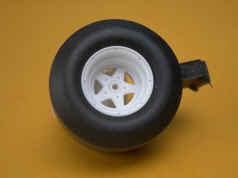

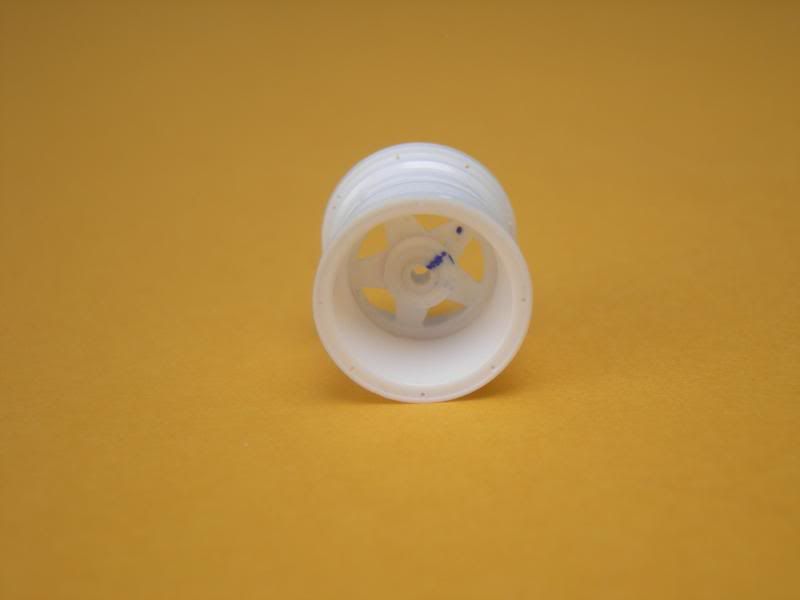

I made some progress on three different fronts over the past few days. In response to the question by John Buzzerio about if I was substituting anything for the cast lug nuts, I drilled out the rears (so far) and am a step closer to using studs and nuts. Still not sure if I want to get into wheel studs as part of the brakes or not, but at least it’s a step in the right direction. I’m showing a couple pics of the wheels as they are now. I will try to show a couple pics of how I got them to this point sometime later. It's amazing how tires seem to attract all kinds of dirt (and macro lens doesn't help!)
Back side with brake hat inserted

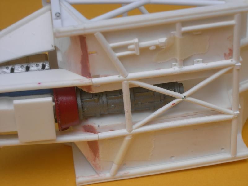

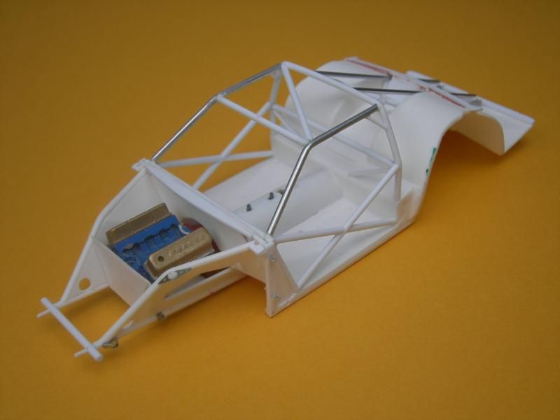

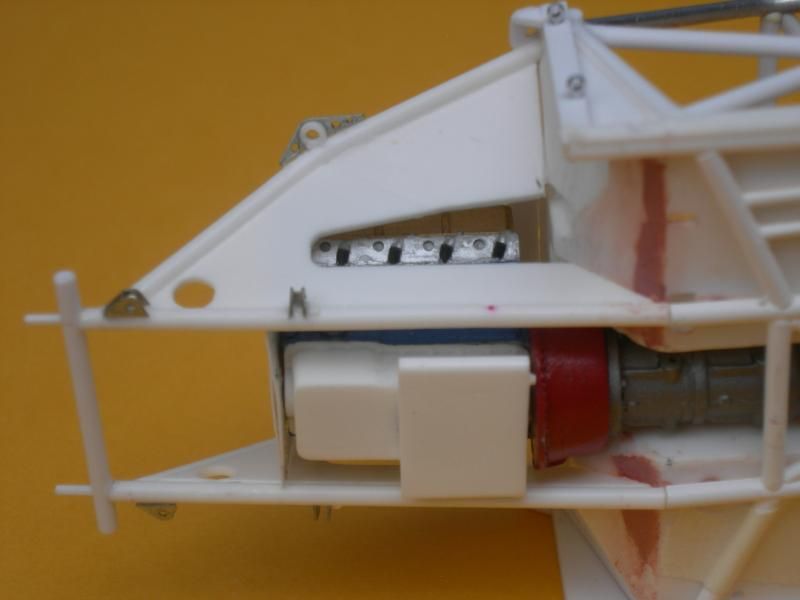

I also got a temporary pin/stand put in place to locate the fore-aft location of the engine/trans and started developing a template for the motor plate. This shows a couple-three angles of that. Although this engine and scatter shield is only for mockup, you can see the exhaust port plates on the underside of the heads. I’m also planning to use a dry sump system in this so it’ll be a much different looking pan.

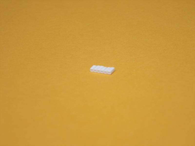

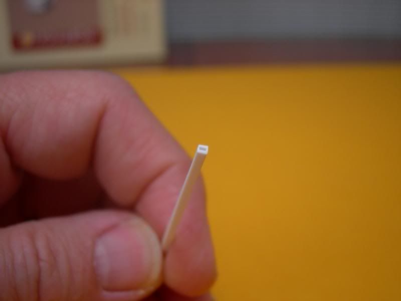

Finally, I got started on the construction of an overhead switch panel that will have separate toggles. I took some .060x.040 styrene channel and boxed it in with some .020x.060 flat strip, then cut it into sections and CA’d them together side by side. I’ve got to make a front for them and get the holes drilled where the toggles will go. I intend to run wiring out the back side of them in the long run.
Sorry for the blurry pics. Couldn't get the camera to cooperate like I'd hoped... Front side of the switches has been trued-up. Rear still must be.

Scott.... beautiful work. I love the attention to detail. As far as the studs go in this and I just have to give my honest opinion. I think you should add them and reason being youbhave put sobmuch work into this and its just a little more to make it pop even more.
I will have to get some pics of a stuss and bolt I have thaybmay work perfect for the studs for your car. Now nothing says you have to make them removable bit i think having an individual stud and nut would look killer. The parta I am thinking of are from tuner 2B or something like that. I am using these parts ony steering gearbox mounts on my funny car but will get some pics of the parts for you.

Thanks Chris. I appreciate your expressing your opinion about the wheel stud situation. I'll look forward to seeing pics/getting info about the studs and bolts you're talking about. Not to sound slobbery, but you've had a tremendous influence on my build, as well. When I see how you've stuck with all the minute detaiing you've done, and "lived through" some of the two-steps-forward-one-step-backward situations, it's given me extra motivation to push through some of my own adversities.

Scott... I dug a couple of the parts out to show you for the studs. Now these are from Tuner Model Factory.
The Dia. of the stud is .7mm = .0275" which is equivalent to .6875" (11/16") in 1:1. I think 1:1 sizes are around 1/2-20 threads. these would be a smidge big but I think will work perfect :D
you could set it up where they are made to size and just glue them in the wheel with the amount of thread sticking out or you could make them functional to take on and off or maybe just functional and never take off...lol. I have to give you props for detailing the heck out of a 1/25th scale car. I know what I have been doing is tuff at times in 1/16th and know its even tougher in a smaller scale.

Thanks Chris. I did some checking online last night to see if I could find distributors. Many of them are overseas and/or don't seem to carry those particular P/Ns, so was hoping you had a suggestion re where to go, ideally here in the States. I think these look cool enough, and are very appropriate, scale- and appearance-wise, so will go overseas if I need to.

Yep, this is one fascinating build, Scott. Go for the studs and nuts- you've done so much with the rest, it would almost be sacrilege not to! I know you've been working on it for some time but how do you find the time to do it all?
