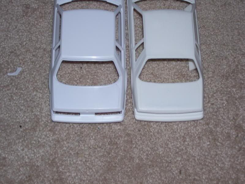

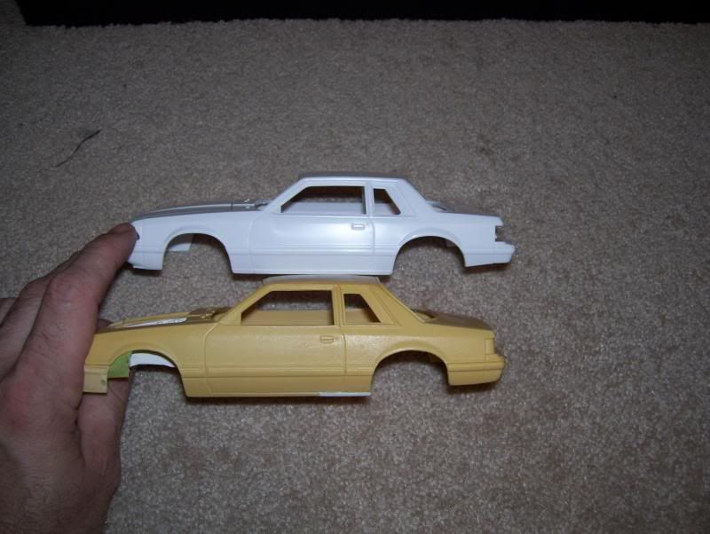

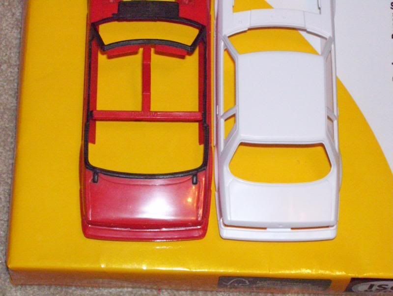

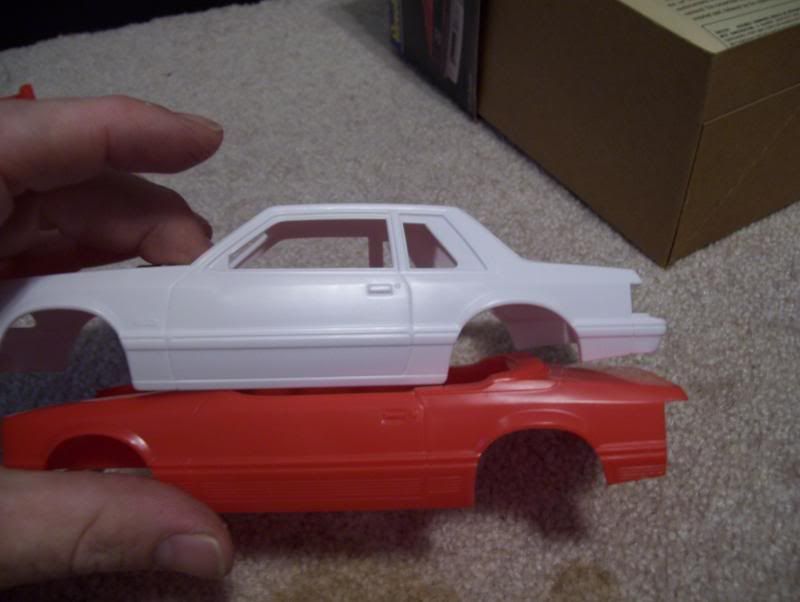

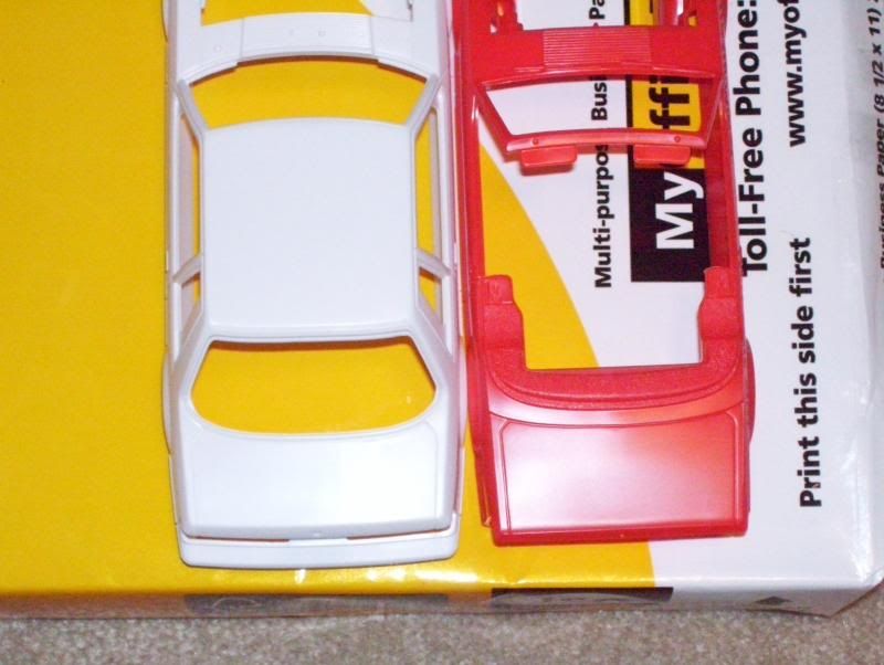

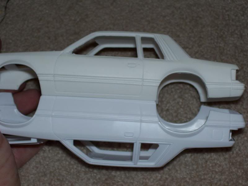

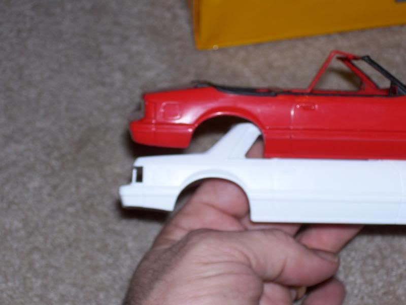

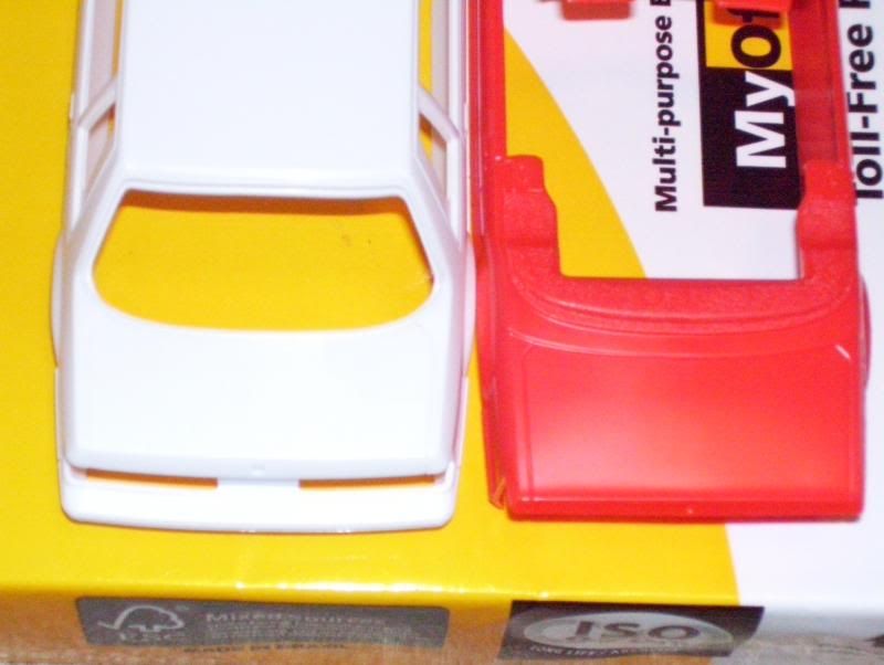

Abell82 Posted May 25, 2013 Posted May 25, 2013 This thread needs more comparison pictures. 1st how about a mad resin coupe?

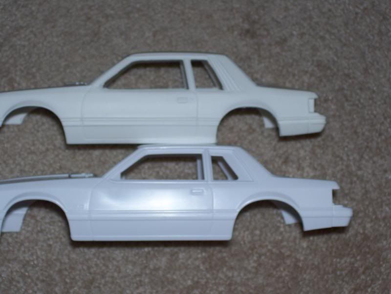

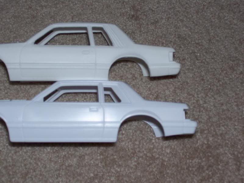

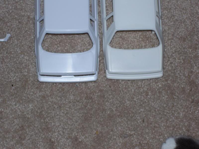

Abell82 Posted May 25, 2013 Posted May 25, 2013 1981? Mustang Convertible Cabrio by Revell.... and finally I think that Prostockmania...(Randy ) may be correct. the roof is NOT the wrong height. the body is? ... Sort of. .. (not really!) here is a shot of the Revell body with the MPC body in front of it... If you notice the body is WIDER then the MPC bodies, AND the MAD coupe that is based off these MPC bodies. Take that into account and the roof IS too short. even though both kits are supposedly 1/25th scale. So one of these is out of scale slightly, as well as being wrong.

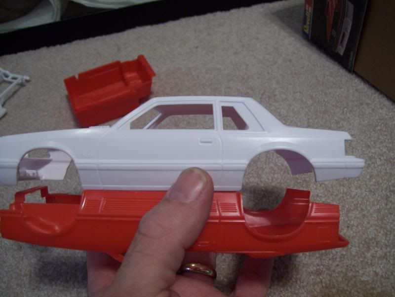

Ben Posted May 26, 2013 Posted May 26, 2013 For anyone that may be wondering, I bought the Replicas and Miniatures resin Ford ten hole wheels with the intent of some day building an LX CHP cruiser. I was curious to see if they would work with this kit. They are stated to be 1/24 scale and are made to fit Monogram tires but I think if they were put in a lower profile tire, they would look good on this kit! The benefit of using these is that they are wider, have photo etch center caps and tiny little valve stems you have to glue on. They're really nice!!!! The kit wheels measure .65 in dia. and are .29 in width. The RoM wheels measure .71 in dia. and are .42 in width. RoM part #RM-17C.
whale392 Posted May 26, 2013 Posted May 26, 2013 (edited) Jason, doing the measurements against the real car shows both kits to have inaccurate roofs. Even the old MPC kits are not correct, but are closer to 1:1 than either Revell offerings. My micrometers and scales just don't lie (and you know what kind of a Fox guy I am, Jason!). Ben, I was just slapping the Pony wheels up under this kit as you were typing. Even though they are 1/24th, they look right under this kit (and could benefit from some lower-profile tires). Edited May 26, 2013 by whale392
Ben Posted May 26, 2013 Posted May 26, 2013 (edited) Jason, doing the measurements against the real car shows both kits to have inaccurate roofs. Even the old MPC kits are not correct, but are closer to 1:1 than either Revell offerings. My micrometers and scales just don't lie (and you know what kind of a Fox guy I am, Jason!). Ben, I was just slapping the Pony wheels up under this kit as you were typing. Even though they are 1/24th, they look right under this kit (and could benefit from some lower-profile tires). I just put them in the BF Goodrich rubber tires from the Otaki/ARII wheel sets (the front tires) and they fit like a glove!!!!! The overall ending diameter of the RoM wheel in that BFG tire is 1.04 whereas the kit wheel and tire measures 1.06. Gonna have to contact Norm and get some more!!!!! (If they decide to correct the body and I buy more kits..: ) Also, Alan at Ma's Resin casts these BFG tires. They are part # 89. Edited May 26, 2013 by Ben

whale392 Posted May 26, 2013 Posted May 26, 2013 (edited) Ask and you shall receive: Actual car measures at shown lines is 19.5" (or .78" in 1/25th scale) Model car measures .696" at the same spot. This is a difference of .084", just a tad over 2" scale (just like i had stated it was several pages back). I can also provide the 'angle of lean' for the B-pillar (which works out to be in the neighborhood of 1.5*-2*, as car consistency is anything but. Edited May 26, 2013 by whale392
