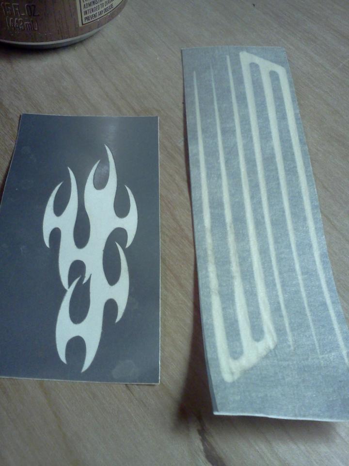

kratvmnd Posted October 19, 2012 Share Posted October 19, 2012 (edited) I have a Roland Camm-1 plotter/cutter that I use on a regular basis for business signs,race car graphics,etc.. I have used it with great results for making paint masks/templates,but as thin and well-conforming as the vinyl is,it is still too thick to be used for actual graphics.Any lettering under 1/4 inch is tricky and when you get into any sharp angles at that size the "points" leave a little to be desired. Also,you will run into adhesion problems and color fade over time.Not to mention the dreaded "shrinkage" problem.Vinyl is affected by temperature changes also,so it shrinks and retracts,I'm sure you have all seen this happen on bumper stickers.The finish would not be very durable either as the vinyl scratches very easily.It really wouldn't be any different than the stickers in a snap kit.Here's a couple pics that may show what I mean. The scallops are about 4"x3/4" to give you an idea of size here. As you can see,the accuracy is very good,but in the 3rd pic,I think you should be able to actually SEE the thickness.Works great for making custom masks for painting like these, but I wouldn't use them directly on something in this small of a scale. Edited October 19, 2012 by kratvmnd Quote Link to comment Share on other sites More sharing options...
