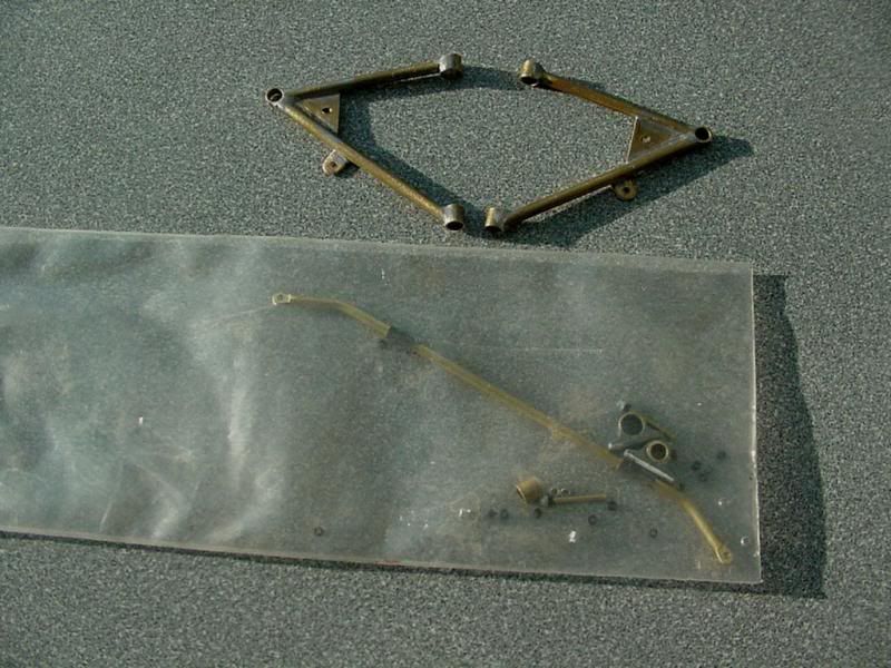

The front sway bar and the stabilizer links (including the bushings) are in the bag. Too many tiny parts I didn’t want to risk losing. Mostly brass with some machined aluminum for the nuts & bolts & washers and soft vinyl for the rubber bushings.
I also added the tabs for the stabilizer links to the lower control arms.

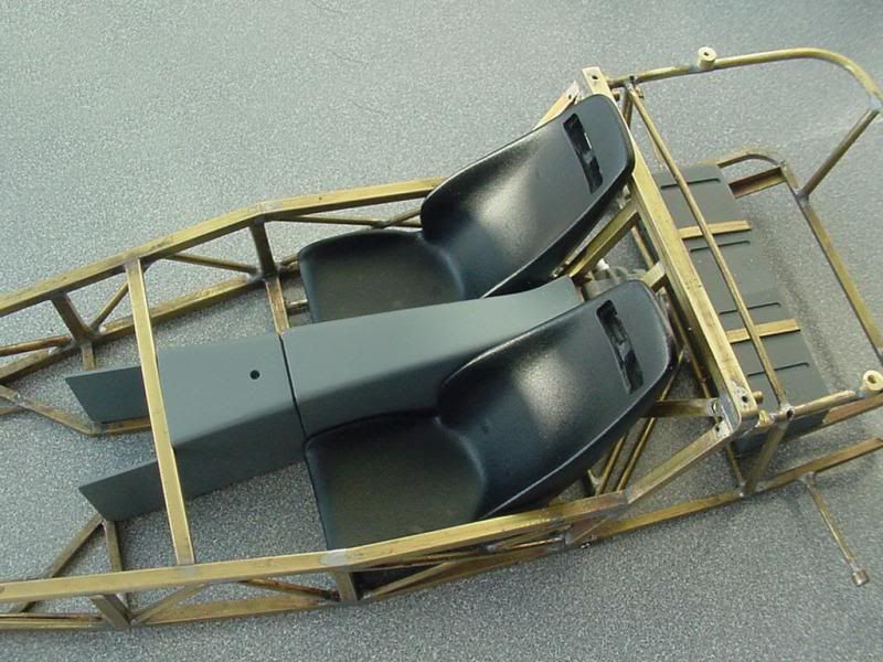

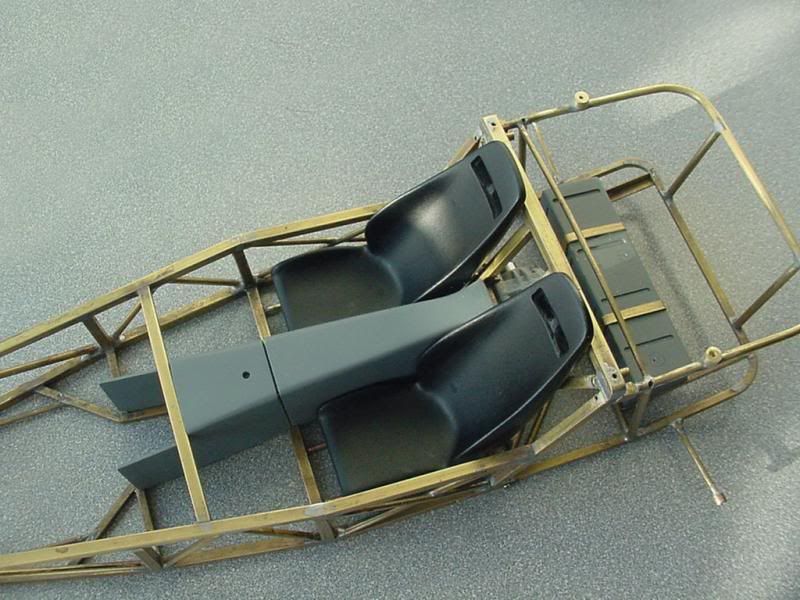

I added the seat mounting rails to the frame.

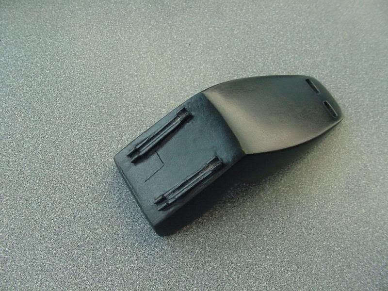

And I made the brackets for the seats. This is the left, hence the engraved “L”…
The seats snap onto the rails and allow the seats slide.

Would you believe me if I said I machined it...? ;)
I think it is sold by The Campbell Line for model railroading. It came loose in a lot I bought of odds and ends of modeling supplies, but it was with some other Campbell materials.
Interesting stuff to work with, very soft. Easy to file, easier to bend, not necessarily where you want it to bend.
Since you can't solder it in place, are you going to machine some sheet metal screws? ;) ;)
They actually fit without any need for mechanical fixturing or adhesive when the seats and body panels are installed. Same for this piece...

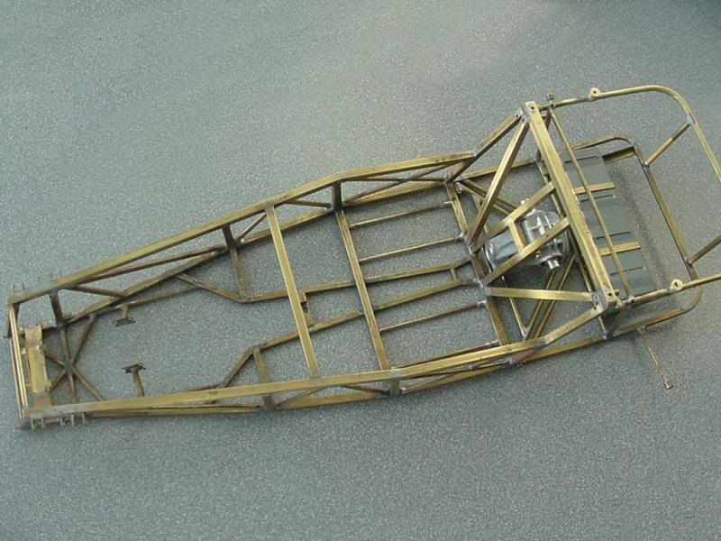

Beginning of upper under hood framework. Snaps in since it will mounted after the engine is built and installed.
That is some really nice engineering Mark. Looks like a nice tight fit. Sorry I missed it Friday. Got my final exam tomorrow and it promises to be a real bear!
Thanks Pete, I need to make sure it can be unbuilt, painted and rebuilt, so the extra time and effort will hopefully pay off in the final assembly.
