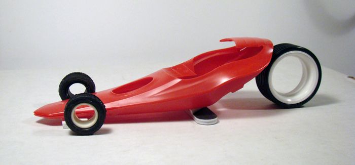

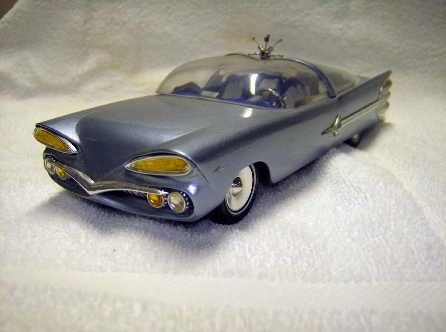

I don't know why I immediately thought about this stalled build. Ancient Elkie from a junker, two sets of custom rear treatments from the old Riv kit, white piece is Deora, while the topper is Fireball 500.
  On 2/23/2013 at 3:30 AM, SSNJim said:
Very clever rear wheel and tire. I like it. Are the front tires going to match?

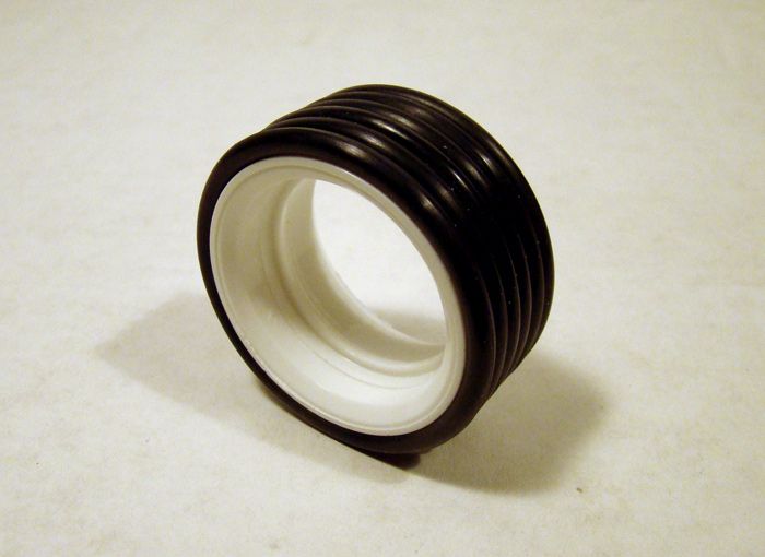

I may have missed something, but why did you cut the coupler into 5 pieces? It looks like you might have finished the outer edges first.

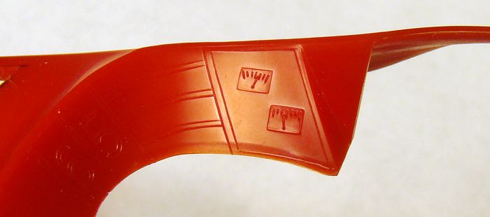

Yes, the front wheels will be as is with the exception of some finishing and a bearing housing. Inside at the center of the coupler is a ridge that I want to keep as a drive track (photo 3). So to narrow the coupler into a rim I need the center ring and the outer edges. The rest goes.

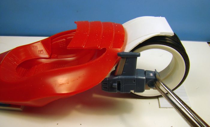

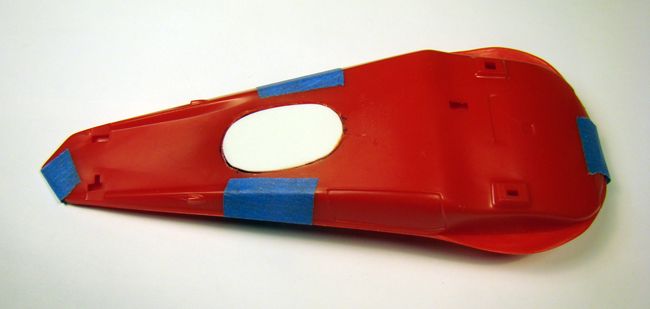

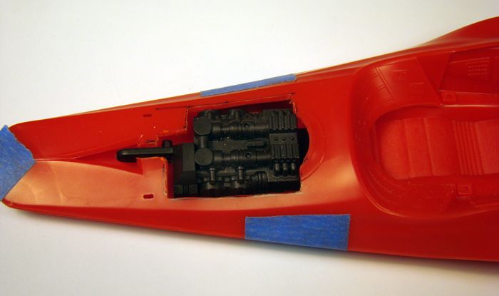

There's a bulge in the body below the Cherry Bomb's turbine engine that had to be leveled or it made problems for my new future engine.
This is the "engine" that I scrounged from a bin at a flea market. The body had to be opened up to make room for it. There will still be some plumbing to add, just have to come up with something convincing.
I've mocked up a rear fender and would like to use some aspect of this piece of Transformers thingy as a drive arm for the hubless wheel.

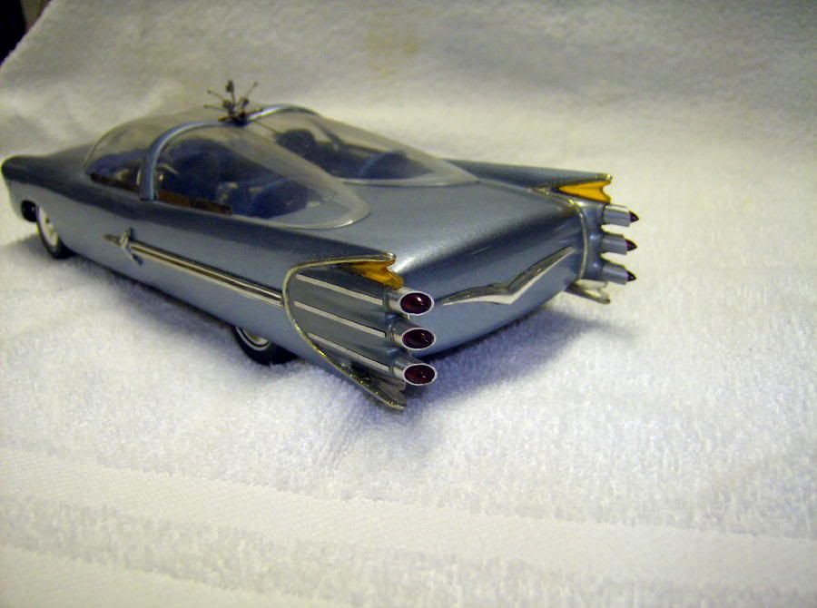

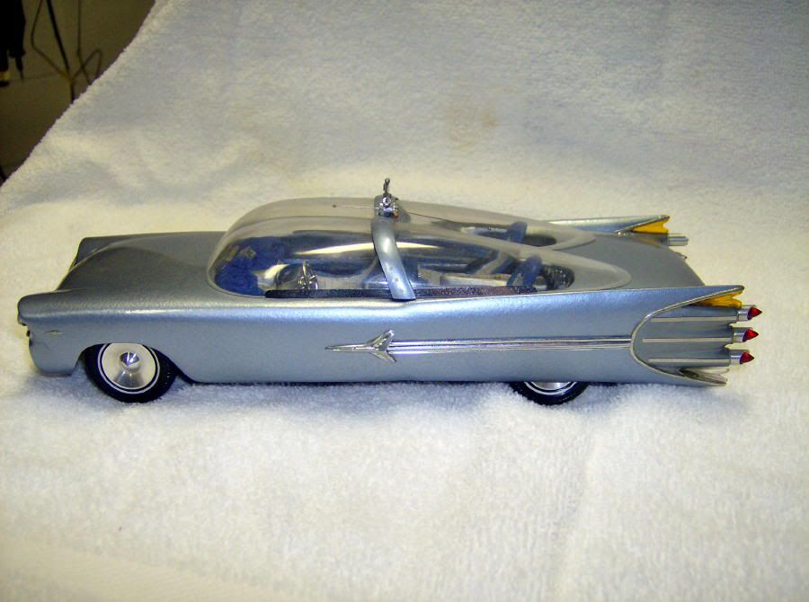

Here's one that, although not eligible for this CBP because I built it about 10 years ago, it certainly does fit into the theme here. It's made from 2 1959 Dodge promos, the bubble top from the Monogram '58 T-Bird, and an interior cobbled together from many different kit parts and scratchbuilt stuff. I call it a 2059 Dodge ZZT.

Very wild Rich. Are you a drinking man ? : ) 59 Chevy taillights as headlights ??? Yes ??

Thanks Mike, Here are a few more pictures of the T- Bird.
Thank you Mike, I enjoyed building ths. Believe it or not it started out when I drew a picture of a '59 Dodge with fins on the bottom too. A couple of months later, there it was.
Ray, yes sir, I've been known to "have a few" now and then, but nowhere near as much as I did in my younger days. The '59 Chevy taillights fit perfectly under the headlight eyebrows of the '59 Dodge. I had a friend cast the taillight lenses in clear resin for me, but they yellowed over time.

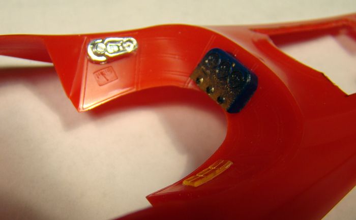

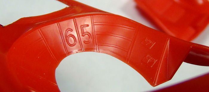

The Cherry Bomb dash is sparse with dated and thinly engraved details including a large "65" which I suppose is the speed.
It's actually begging to be detailed and I considered the nacelle of a '57 Chevy dash, but to move this along I just added a parts box guage cluster, buttons and a canopy release. It would be easy to overdo it but I think a utopian car shouldn't be complicated to operate.

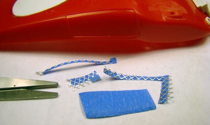

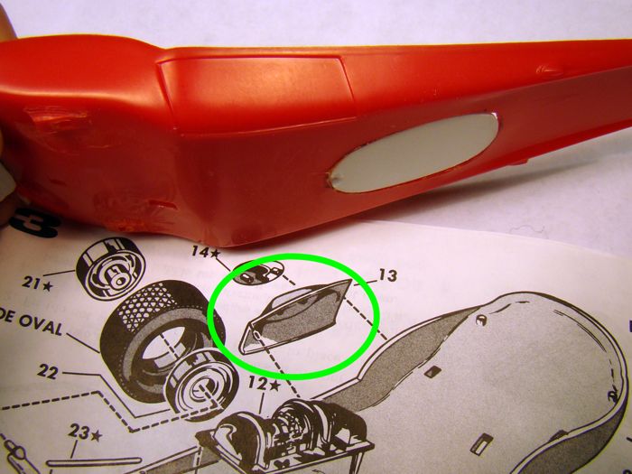

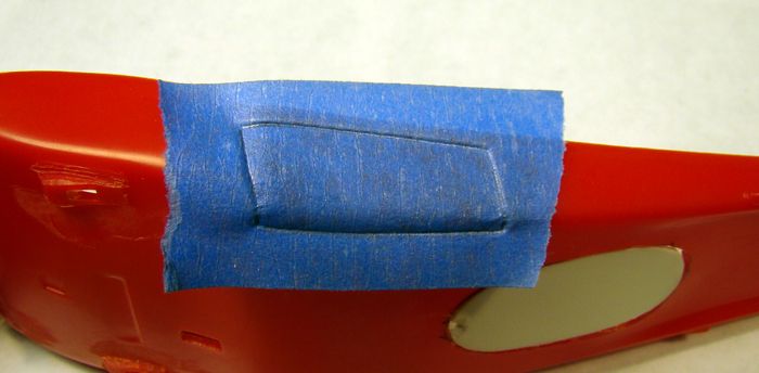

My power plant doesn't require the kit's turbine exhaust, but there's a recessed placement area for it. Rather than just fill it in I'd like to add some texture to the body
I burnished some tape into the recess with a pencil...

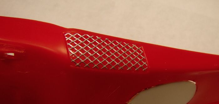

...then laid the tape on some sculpting screen and just trimmed it to the shape of the marks.
Pressed it firmly into the space and superglued. This will be painted body color, maybe with a wash. Mostly I just wanted a little texture to add interest.
