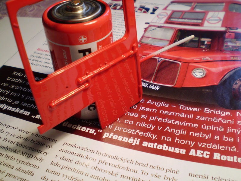

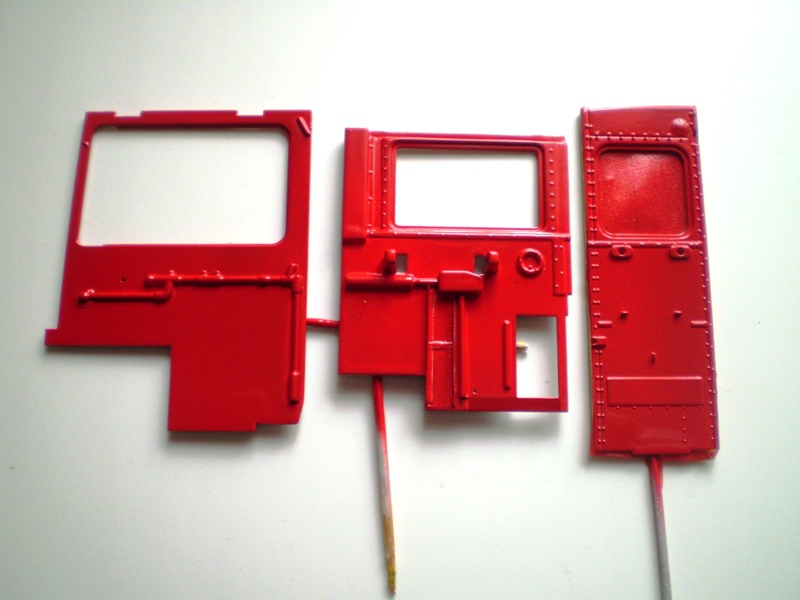

After a few weeks of thinking of the outside colour for the bus, I´ve chosen the RAL 3002 that is reportedly used by London Transport for local colour repairs. It is two-component colour used in 1:1 world. As such, it gives a much deeper shine, that it should be on a model. I will handle that later. I sprayed these first panels separately because I need them to:
A- complete the engine bay
B- fit the inside left-hand board of the lower deck to it
I took the pictures in poor lighting conditions. We have heavy rains here these days.

I will try to soften the shine a bit with filters and post-shading. The engine bay will be covered with some grime and dust.
