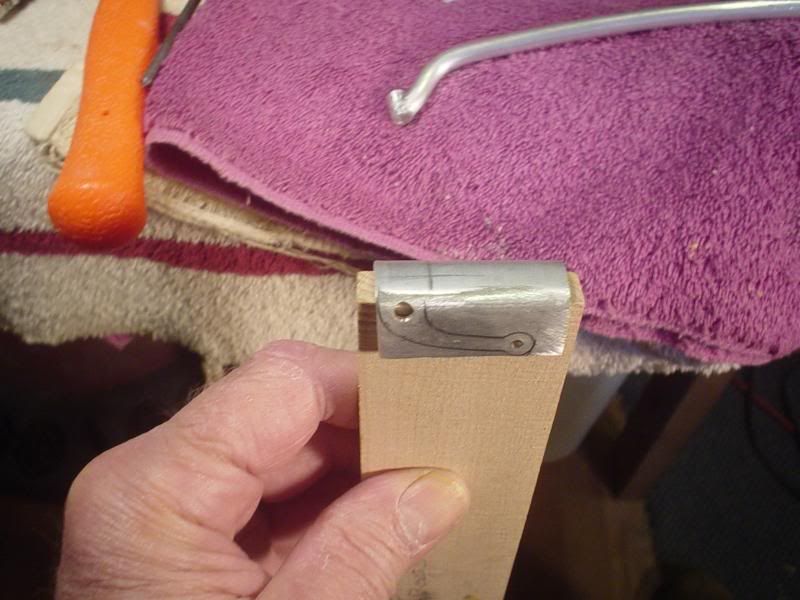

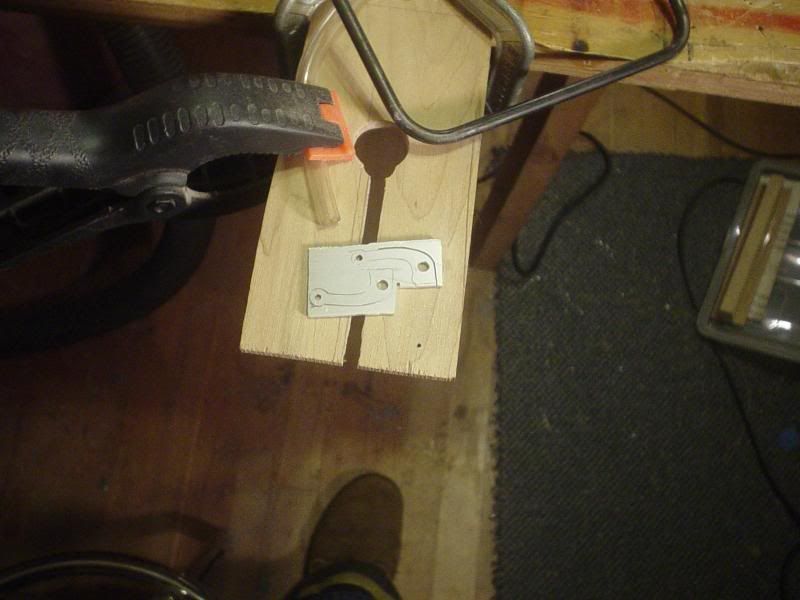

Ognib Posted September 12, 2013 Author Posted September 12, 2013 Thanks, guys. I bought the jewlers saw previously for cutting pearl to do inlay work on the guitars. After I drilled the king pin holes, I slipped the tie rod arm template over the king pin, located it, drilled & pinned & traced it's outline. Just have to whittle it all out.

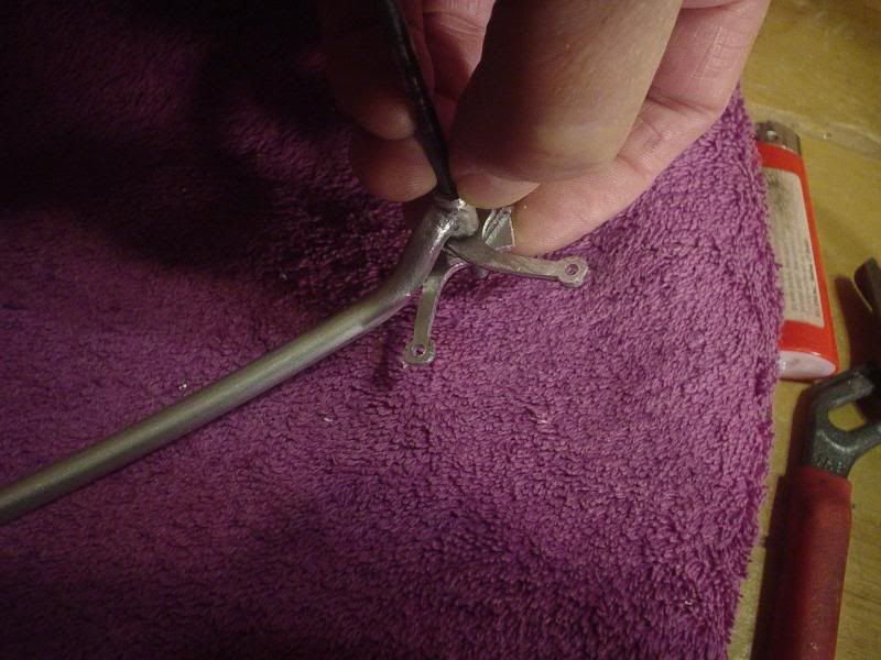

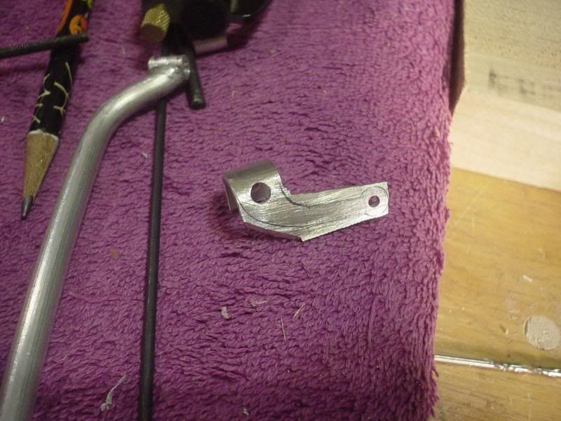

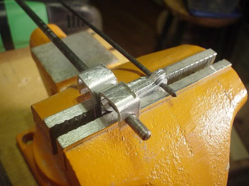

Ognib Posted September 13, 2013 Author Posted September 13, 2013 Thanks, Ray, glad you're enjoying. Pinned both sides back to back, along with the arm template, clamped in the vise & roughing in the shape with a coarse rat tail file. By working multiple parts at one time, it simplifies my ability to have visually matching pieces from side to side.

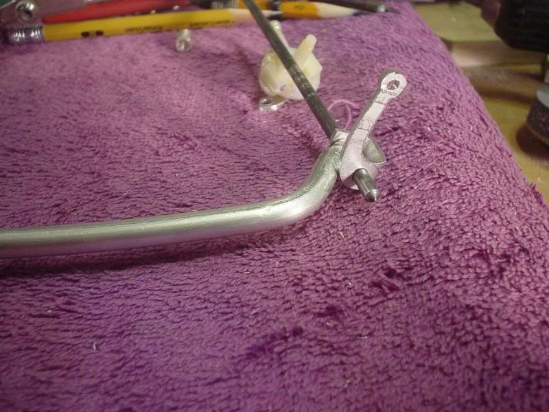

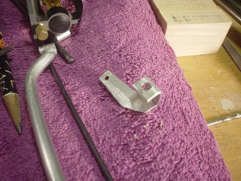

Ognib Posted September 13, 2013 Author Posted September 13, 2013 (edited) First fit. Getting there. There is contact between the tie rod arm & axle. This shows how much I still need to trim it down to match the plastic piece. Edited September 13, 2013 by Ognib

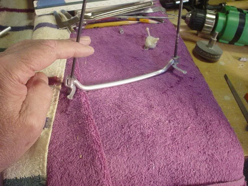

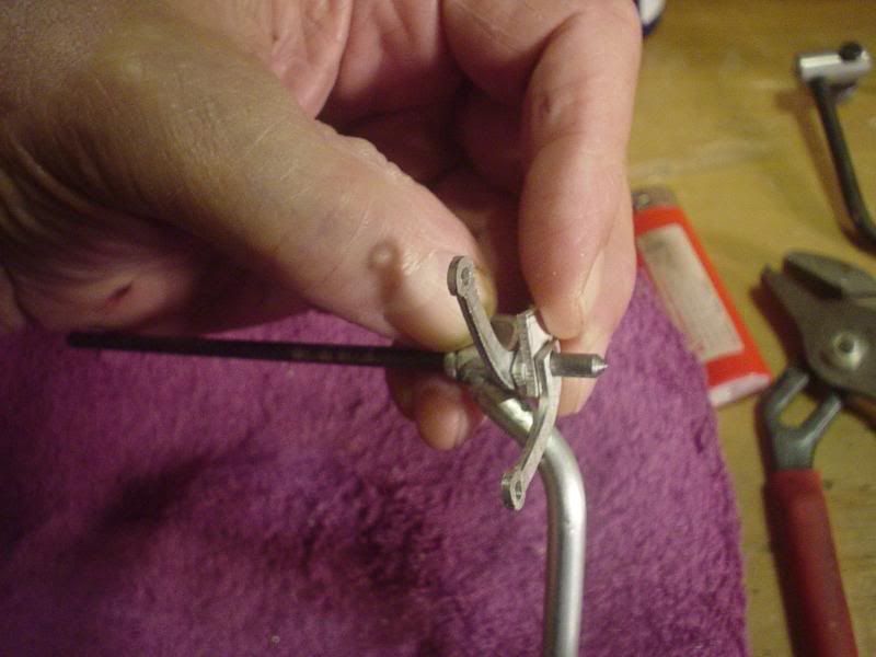

Ognib Posted September 18, 2013 Author Posted September 18, 2013 (edited) Cutting more parts. Due to the interferance between the tie rod arm and the axle, as shown above, I'm modifying the part to lower the tie rod arm in relation to the inward slant of the axle as it drops...giving more room for the arm to rotate. Small hose is attached to an aquarium aerator to keep saw residue blown away...from obscuring my cut line. Edited September 19, 2013 by Ognib
Ognib Posted September 19, 2013 Author Posted September 19, 2013 (edited) Blocks are being added along with a new tie rod arm. Upper arm will be eliminated. Dimensions are 3/16 total drop = 1 1/2" lower at 1:1 This will allow this much more available travel for the arm. Now we can achieve a believable right turn position with the spindle/tire. Edited September 19, 2013 by Ognib

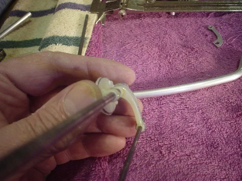

Ognib Posted September 22, 2013 Author Posted September 22, 2013 (edited) I misunderstood your question, sorry. Thanks, Tom. I stuck it together with super glue before removing it from the assembly jig. I use a product that I get from my lutherie supply house that I'm quite impressed with. My plan, from early on, after watching a guy tig weld a .003" coca cola can with no blow through, is to tig the thing together. I don't use credit cards, so until I accumulate the cash for a welder I'm using this. After having done several strength tests on aluminum, I feel confident that It will allow me to proceed with shaping & fitting all of the parts without everying falling apart in my lap. Acetone is an excellent de-bonder for this glue, so when the welder shows up, simple matter to prep the parts for welding. I'm keeping all of my jigs intact to simplify the weld up at that time. Edited September 22, 2013 by Ognib
