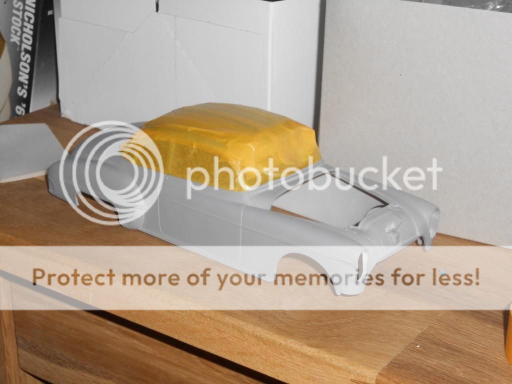

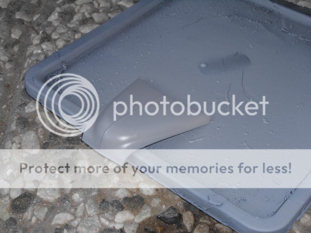

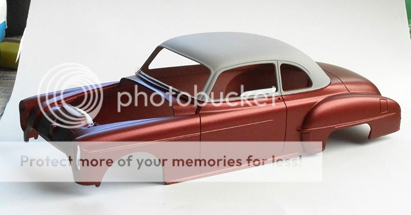

W-409 Posted June 11, 2014 Author Posted June 11, 2014 Sorry guys I'm late with the reply. But finally the Olds got some progress! Anyway Thanks for the comments! I think you may have misunderstood me, on the real cars that ribbed panel is stainless steel, with only the tops of the ribs polished, but you could come close by using aluminum Metalizer (the buffing type) and lightly buffing the tops of the panel to give it the illusion that it's polished stainless. I knew the ribs were polished stainless steel. By painting them I tried to say that I would need to try paint them to look like polished stainless if I wanted. Today I took this one back to the bench. It needed some sanding and smoothing, but nothing too much and I was able to mask off the top and spray some color on it! It wasn't very successful try, though as there are some cracks visible on the rear end. I don't know why that happened, but it will need to be sanded. If I don't sand through the paint I'll just spray another coat on, but if I do I have to start all over again. Anyway the hood got some Primer.

DynoMight Posted June 13, 2014 Posted June 13, 2014 (edited) Thanks Everyone! I'm happy to have it back on the bench, too as it is a nice car and I think the stance came out pretty good. I'm going to sand the body soon and I'll see if I'm able to just shoot more paint on it or if I have to start all over again with the body. The wheels are painted with Revell Copper. I can't remember the number for it, but I think Revell has only one Copper paint color. Thanks Niko, I figured it was Copper... I would wetsand (1200, 1000 grit) the car and put a light coat over it. But don't burn through the paint, go easy. And then clear coat it. That should fix it.. Edited June 13, 2014 by DynoMight

W-409 Posted June 15, 2014 Author Posted June 15, 2014 Thanks Guys, I appreciate the kind words! Thanks Niko, I figured it was Copper... I would wetsand (1200, 1000 grit) the car and put a light coat over it. But don't burn through the paint, go easy. And then clear coat it. That should fix it.. Yep. That's my plan. Only problem is that there is only a little paint as the cracking started before I was able to shoot any wet coats on it. So it will be hard to sand so that it won't go through the paint. But I hope I can make it and then just spray more paint on it, then the second color for the top and then some clear...
DynoMight Posted June 15, 2014 Posted June 15, 2014 Yep. That's my plan. Only problem is that there is only a little paint as the cracking started before I was able to shoot any wet coats on it. So it will be hard to sand so that it won't go through the paint. But I hope I can make it and then just spray more paint on it, then the second color for the top and then some clear... I'd invest in a airbrush if you already don't have one.. a Iwata revolution is like $80 here and a good air compressor is around $100... They also sell airbrush kits at hobby stores around here, so they're probably around you too...
W-409 Posted June 16, 2014 Author Posted June 16, 2014 I have an airbrush and I really like it. It's a Badger 250 that works really well and it's quite simple to use, too. The problem why I use spray paints is that I haven't found a paint that works with the airbrush. Revell and Humbrol Enamels work well otherwise, but my experiences with Revell clear are not very good. It flaked off with BMF and Humbrol's clear will turn yellow during the years. My plan is to try Tamiya Acrylics with the airbrush next, but I'll need to gather some information about them first. I know a couple of modelers here in Finland have used those paints succesfully with an airbrush, so I'll have to ask them about painting those and what clear is suitable. I'll have to practise using Alclad Chrome, too, so the airbrush will be in use really soon, I guess.

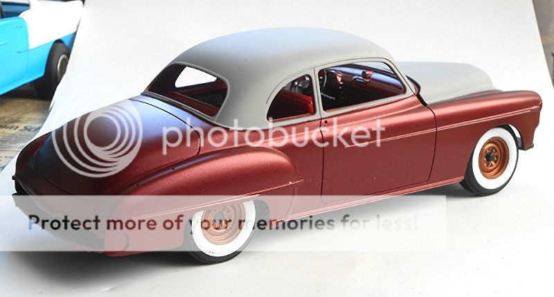

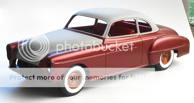

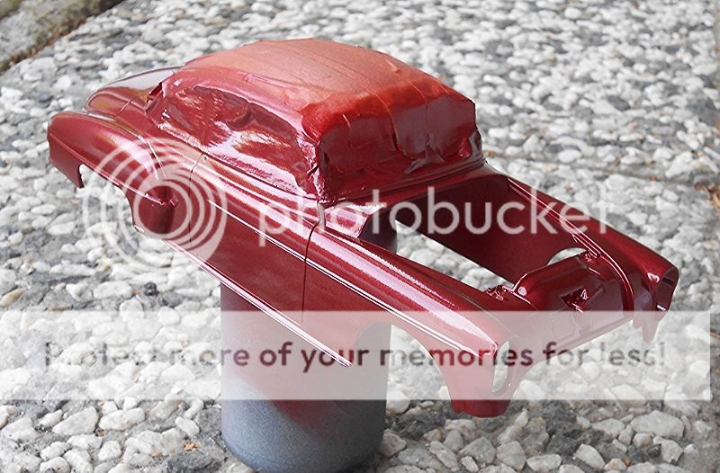

W-409 Posted September 3, 2014 Author Posted September 3, 2014 Thanks for the kind words... Better late than never! Finally I got inspiration to give this body a light wetsand and repaint it. I sanded with 1,000 and 2,000 grit sandpaper and I sprayed a couple of thin coats and two wet coats on the body. At least so far it looks pretty good, hopefully it looks good when dry, too so I could take the tape off and mask everything else but the roof, which will be painted silver. It's great to have this one back on the bench. If the painting goes as it should, I hope this to be finished really soon.

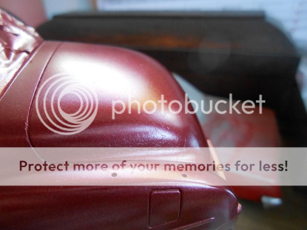

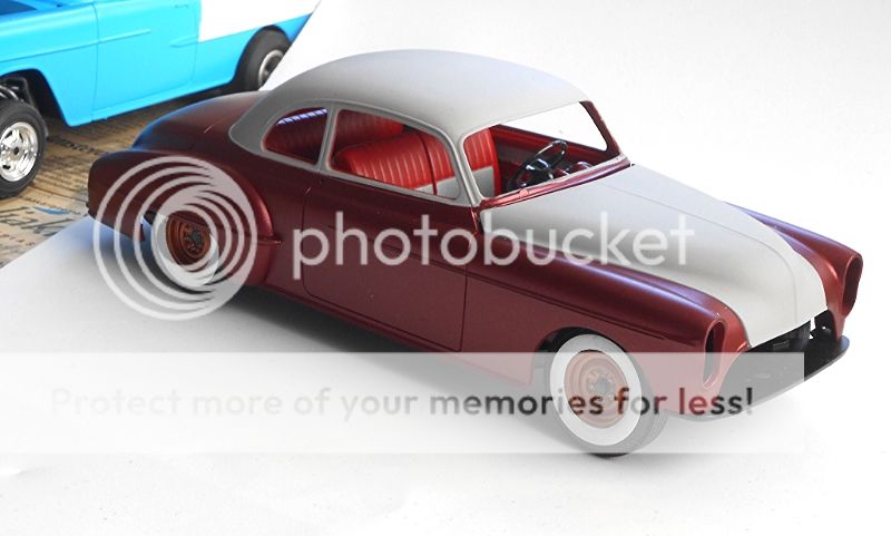

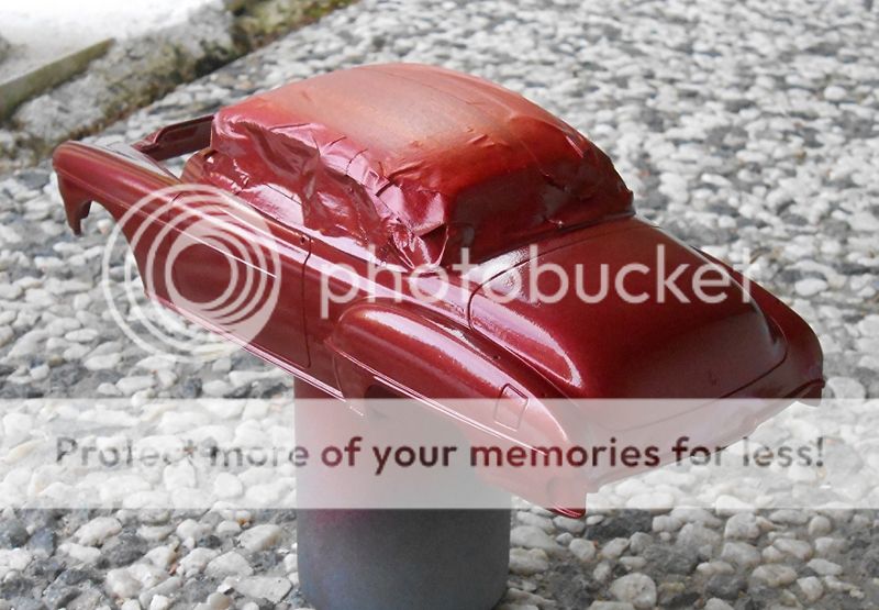

W-409 Posted September 12, 2014 Author Posted September 12, 2014 Thanks Steve for the great tips! I will definitely try those when I find them somewhere. If not in Finland, then I must order them online... Thanks Shane for the kind words! Your builds are something that keep me motivated. You do such a nice and clean work. There was still a minor paint issue after the repaint so I sanded it smooth once more, and sprayed a really light coat of red on the trunk area where the paint was cracked. Luckily it turned out smooth, but as I painted a really light coat, the color turned out being flat rather than shiny. Well, I hope clear coat will fix that. After removing the tape I did a mock up on the chassis. Tomorrow I'm going to a local Model Car Show and I'm taking this one with me to the Primer Table. After that show I will paint the top with silver and clear coat this thing.

StevenGuthmiller Posted September 12, 2014 Posted September 12, 2014 Looks perfect for clear coat now Niko! A coat or two of good gloss coat will really shine it up. Your color coats don't need to be shiny to produce a good finished product. Most lacquers will leave you with a dull finish too. Steve
