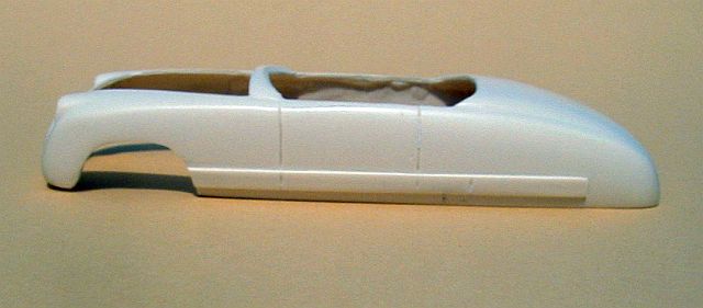

For my next (ahem . . .) challenging project, I will attempt to turn this piece of resin:

I've got the body all marked up - gonna take a deep breath and start slicing. This may take a while . . .

OK - I made some cuts and filled in the front wheel openings. Next, I'll glue it back together. The proportions still look way off, but the overall height of the body still needs to be shortened and the wheel openings moved forward.

Whew, this thing isn't exactly the best piece of resin! Worth a try though . . .

I've made a little more progress since the last time: the body height has been lowered and the front wheel opening is getting close.
And I've started cutting out the hood (yes, this one will have an engine).
