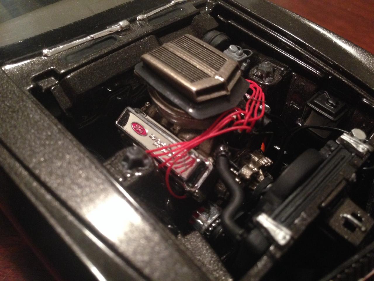

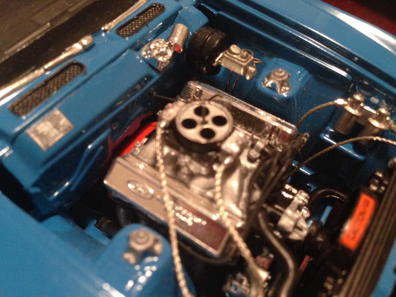

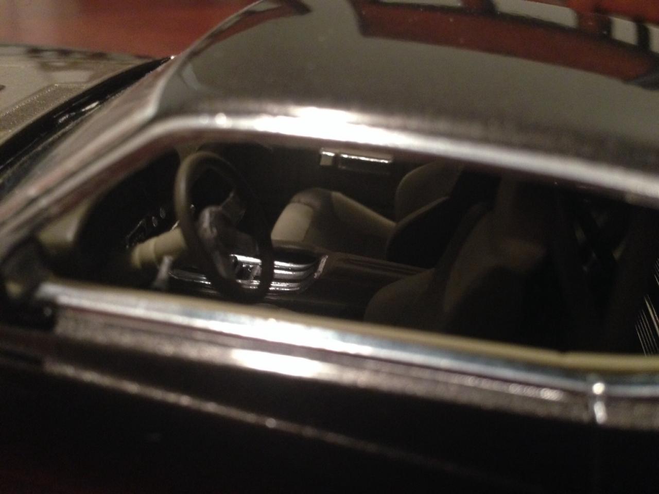

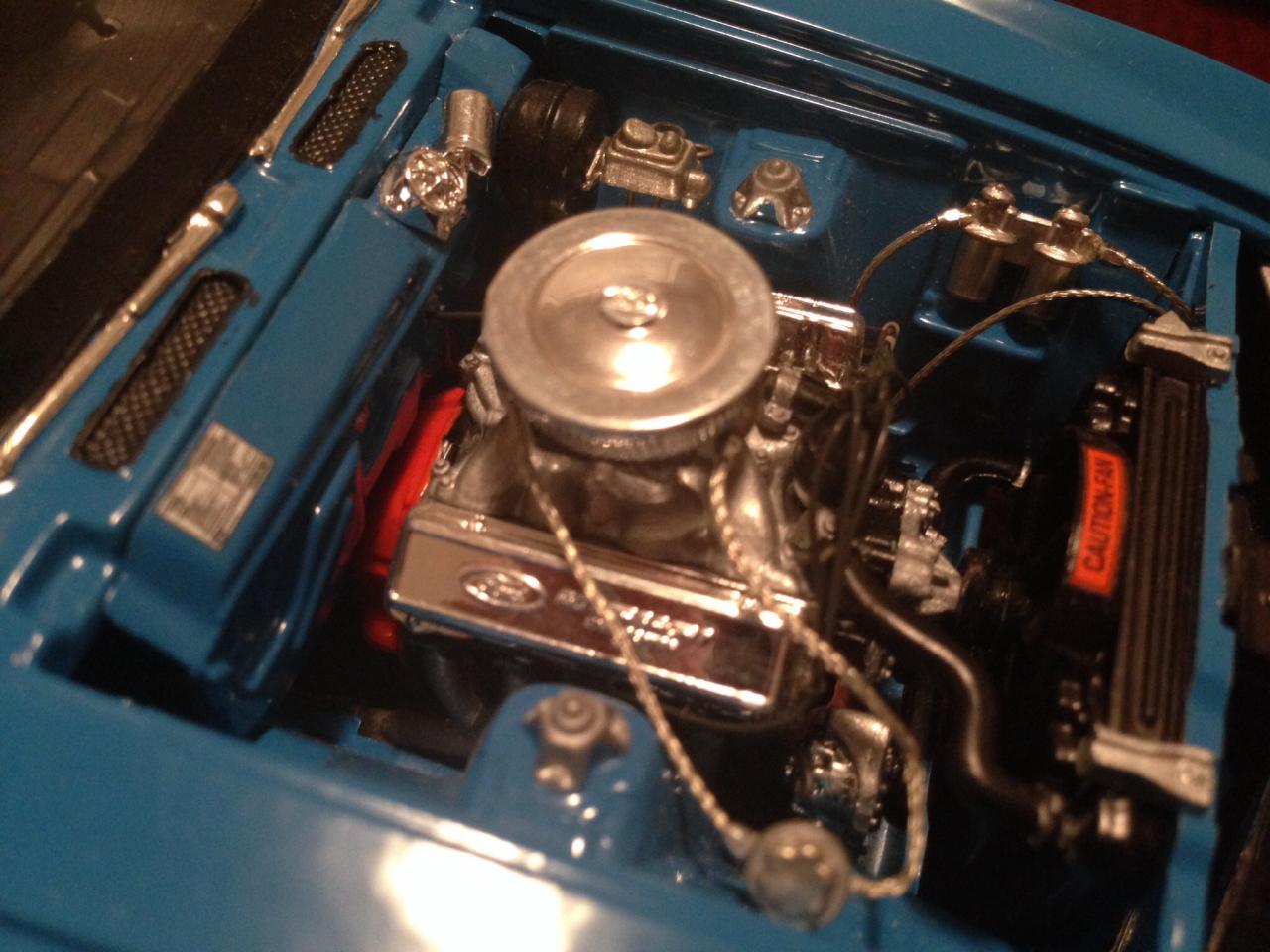

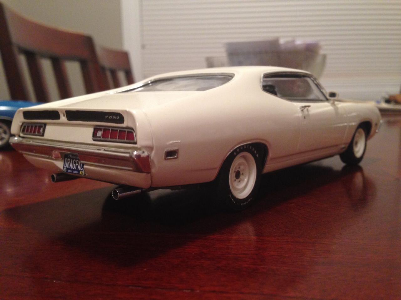

Ok. I did some testing, with a bit of a high spindle pin relocation the mocked up wheels WILL fit no problem and tuck up nicely. They should fit on the front to the point where the top edge of rim is at top of wheel well trim. That's a good spot. The rears should tuck in nicely too to the top of the inner wheel house. At that height the headers will clear and the car will be in the weeds. I also must note that to get the tailpipes to fit properly a small mod is required. The tabs on either side of gas tank need to be trimmed at least 1mm. Doing this gets the tips up closer to the rear pan. Left untouched they hang down too far. Here are some shots of some of the torinos I have built. These are all fairly old but I am happy with thempost-8987-0-24195300-1381197661_thumb.jppost-8987-0-10430100-1381197690_thumb.jppost-8987-0-65657600-1381197722_thumb.jppost-8987-0-83861000-1381197767_thumb.jppost-8987-0-85027800-1381197806_thumb.jppost-8987-0-68056600-1381197847_thumb.jp

Fred, your builds look GREAT! I'm totally unfamiliar with this kit as it's one I've never seen the contents of. Is there the option of exposed headlights in the kit, or did you modify the kit hidden-headlight grille???
I kinda like the exposed look myself B)
The exposed lights are from the Torino cobra version which is what my touring car and the base model are built off. All totaled I have done 7 of these kits so I know the quirks. Lol
I do not believe anyone makes the exposed light 70-1 grille. It's alot different from the cobra grille. I may have to try that

For what it's worth, on my brown one I used the saleen seats in front. Put in the roll bar and deleted the rear seat. In it's place I used the sub boxes and amps from the pro street Lincoln kit. Zero modifications needed and it looked good I thought
