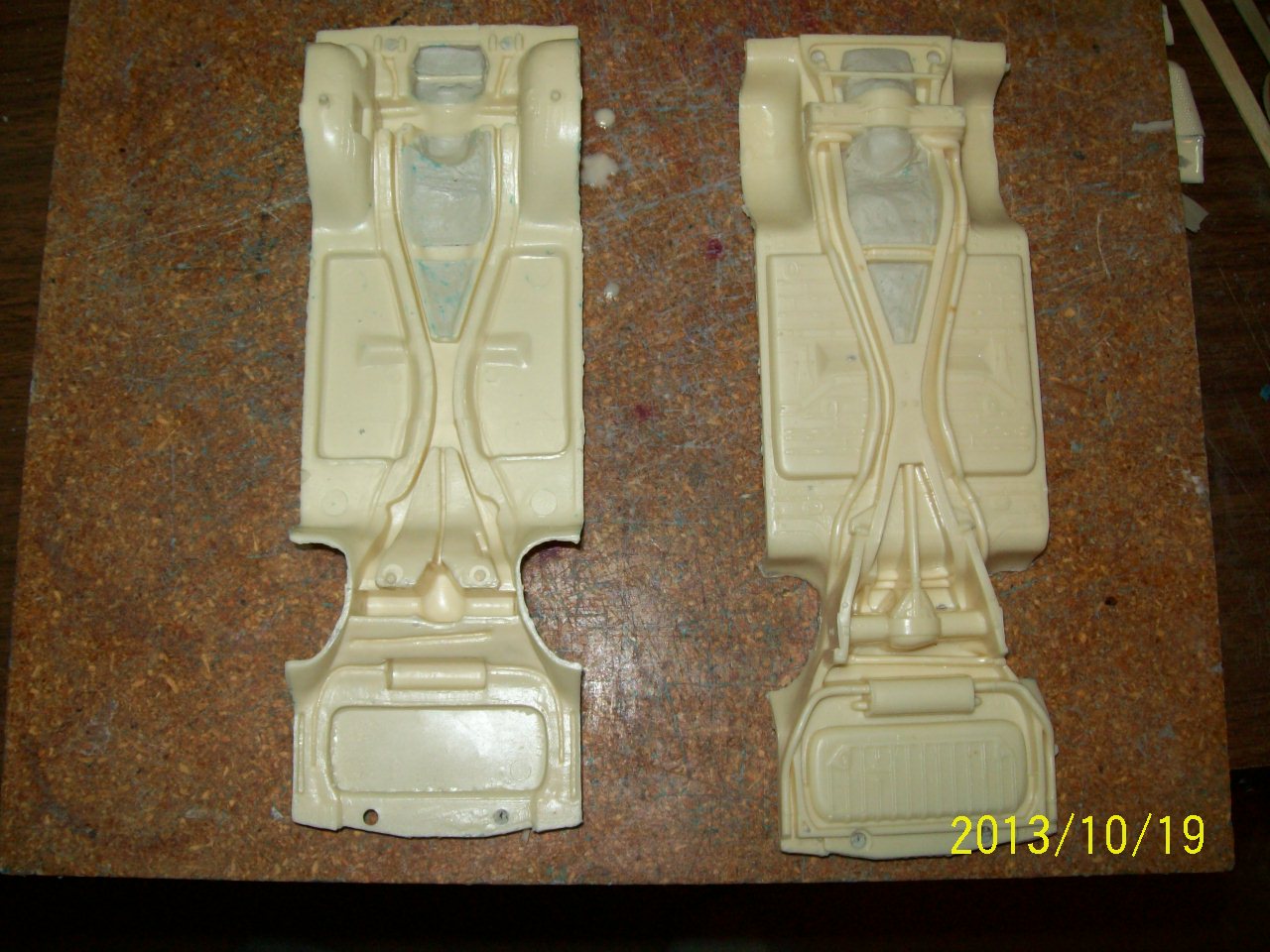

Greg Wann Posted October 19, 2013 Posted October 19, 2013 Charlie, Here is a pic of the two chassis I made today.
charlie8575 Posted October 23, 2013 Author Posted October 23, 2013 Greg, those are GORGEOUS. I'm still fiddling with mine to see what I can do to salvage it, but if it turns out to be a no-go, I'll be contacting you. The windows are indeed pretty well in there. I'll be re-soaking the body and trying again, as it did seem that there might be some hope as a little bit was coming loose. More updates very soon. Charlie Larkin
Greg Wann Posted October 23, 2013 Posted October 23, 2013 (edited) Thanks, Charlie, yes, they turned out really well. I am even impressed. i will do the glass too. I will make a resin buck that Mike will use to create vacuum form windows like he did with the Fox Mustang. I will do the interior parts, hoods, boot and mold of the convertible body. I don't think Modelhaus does these parts. Edited October 24, 2013 by Greg Wann
