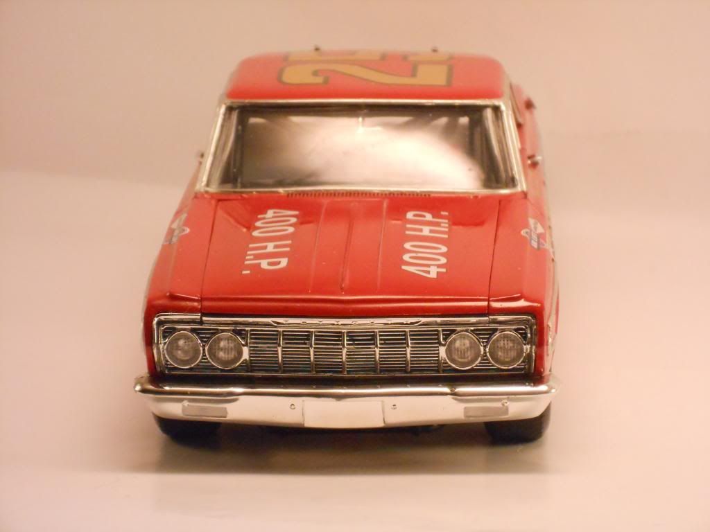

The easiest way is to buy The Detailer's stuff that is meant for Black Washing. You can get it in different colors, it's water based and you just brush paint it over the grille and the liquid will go between the grille bars. Very easy and simple, and it has given me the best results yet, basically I've never went wrong with that stuff.
I've never tried the other colors, so I have no experience from them. But at least the black stuff is top notch, makes black washing very easy. This Grille was Black Washed with Detailer's stuff.

Yes that's true. The liquid goes in all of those grooves and areas between the grille bars automatically, so there is no need to wipe off excess paint. Thanks for the compliment regarding the Plymouth!
