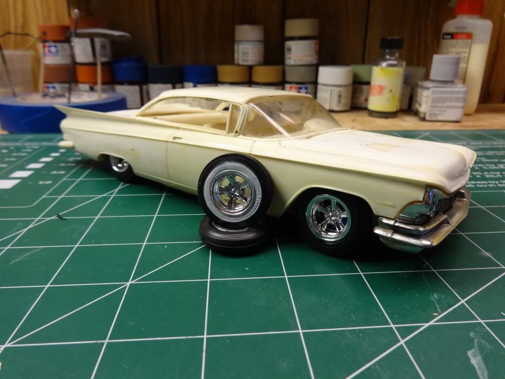

James2 Posted October 26, 2013 Author Posted October 26, 2013 Thanks for the help everyone. These tires are a little big for this build, but could be used. They are from the 50 Olds kit. But this is the look I'm after. The white wall is kind of an experiment with acrylic paint. This could work with an airbrush and a circle template.

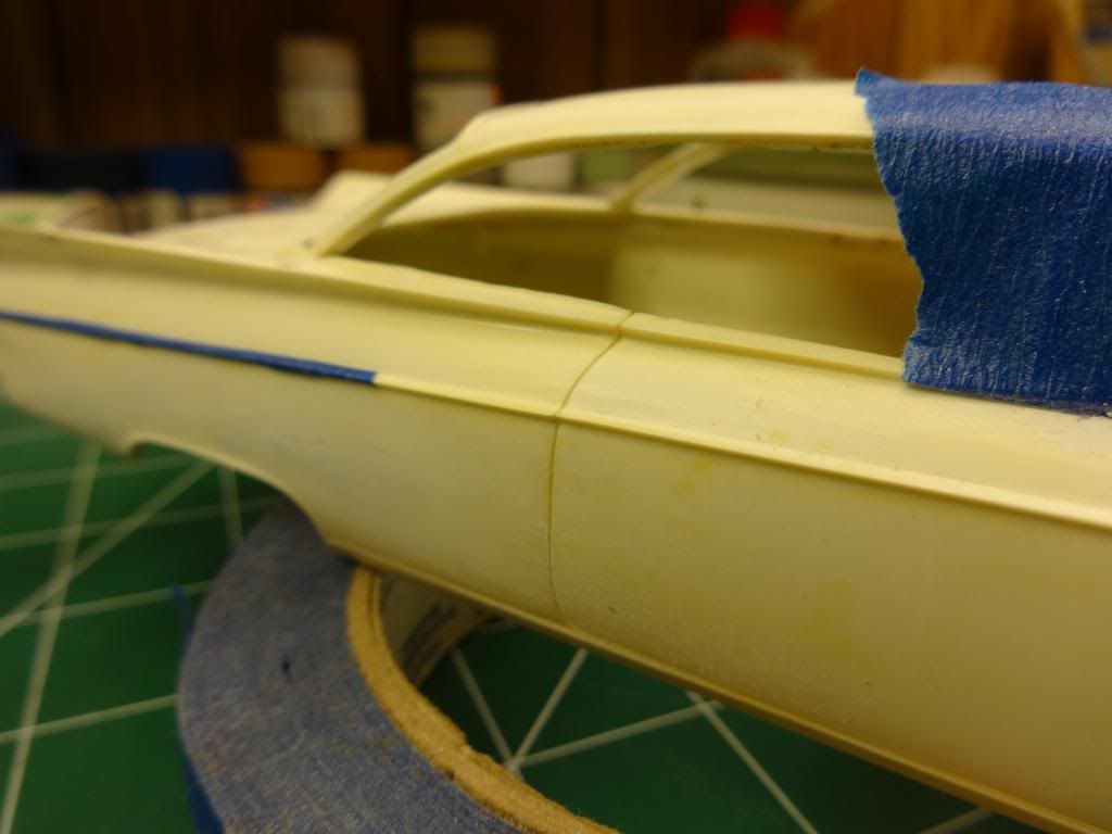

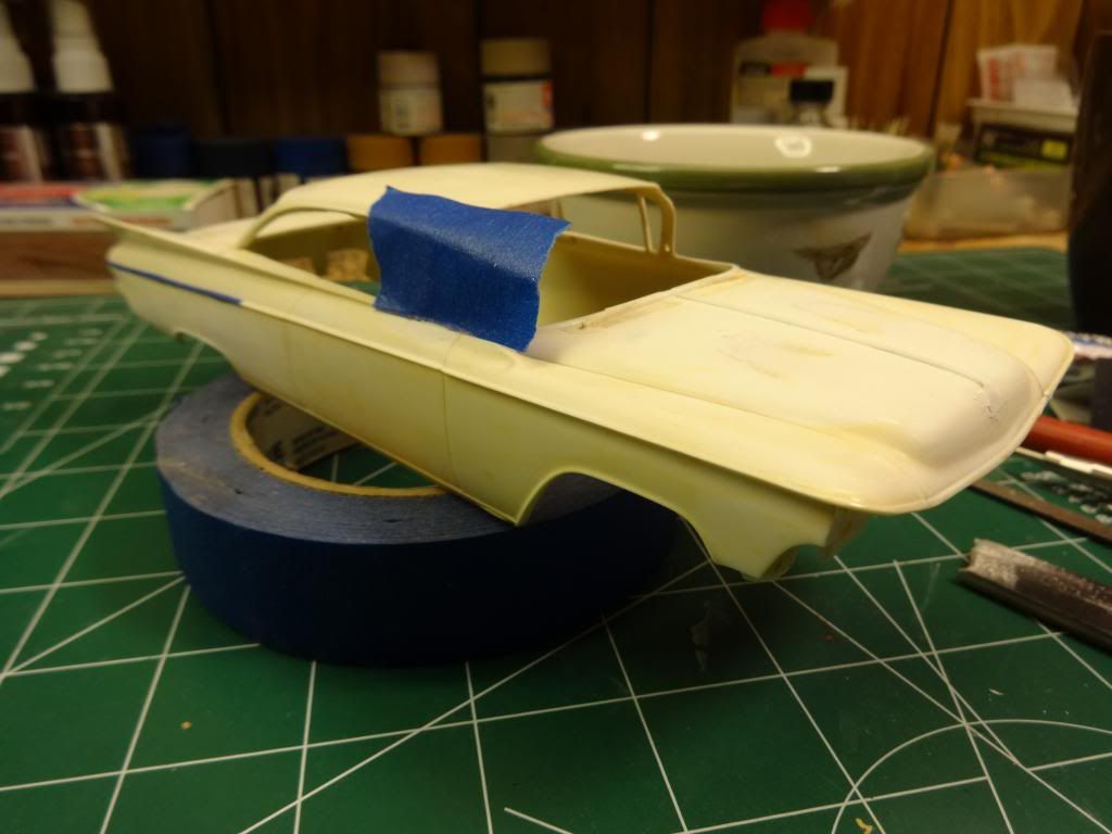

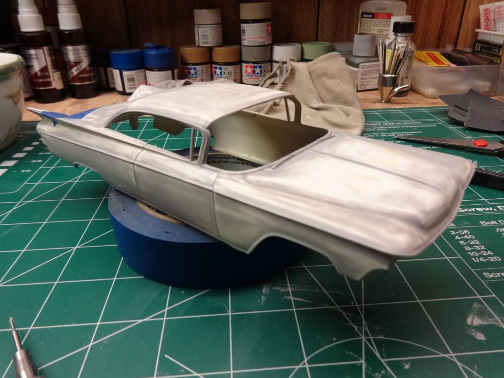

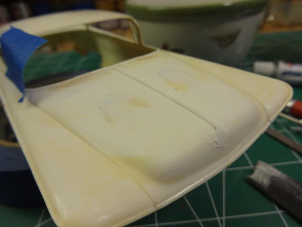

James2 Posted November 9, 2013 Author Posted November 9, 2013 I've been doing some clean up on this one, removed emblems and handles. The tape helps me to stay off of the trim when filling and sanding. Also had to make a new ridge on the hood, the previous owner had partially sanded it off. Plenty of work to do still. Thanks, Jim...

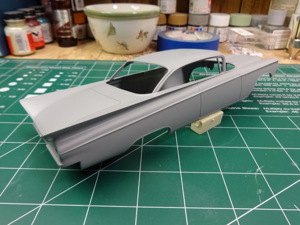

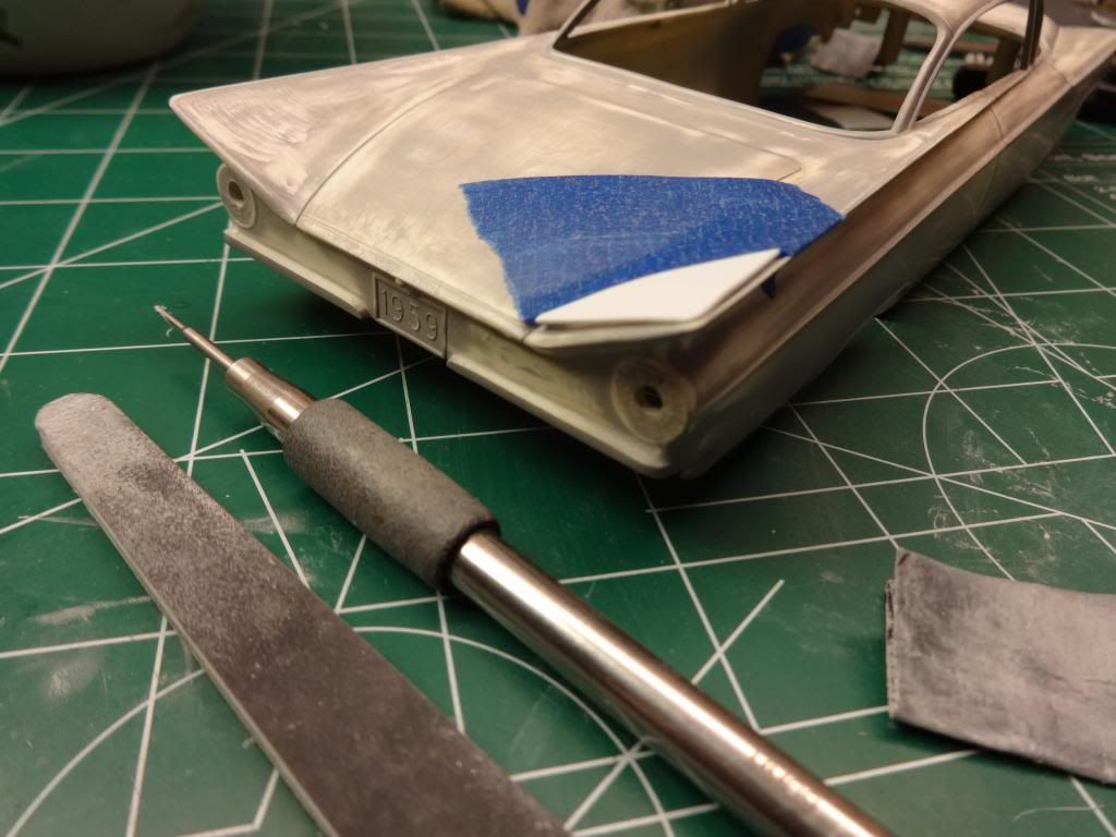

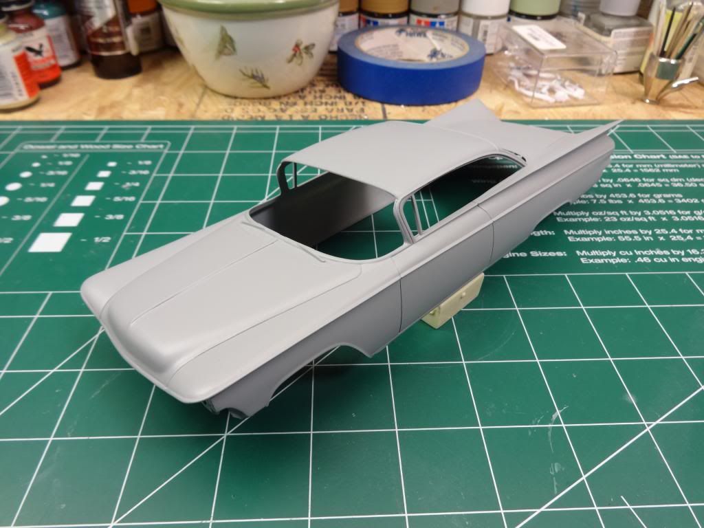

James2 Posted November 17, 2013 Author Posted November 17, 2013 (edited) ​Tried my hand at a little re-scribing. I made a template for the wings and glued a guide on the tool for the straights. Also some block sanding... And then final primer... I also plugged the holes in the "A" pillars and removed the door handles, Thanks for looking, Jim. Edited November 17, 2013 by James2
Tom Geiger Posted November 18, 2013 Posted November 18, 2013 It's good that you are rescribing the fin trim. It's very faint on both the '59 and '60. While you're in there, look at the underside of the fin for the trim edge. That one is nearly non-existent. Note that on the real car the trim at the edge of the fin is the finish. Take it off and there's just an unfinished pinch weld between the two pieces that make up the top and bottom of the fin. I had a 1:1 1960 Electra.
Edsel-Dan Posted November 19, 2013 Posted November 19, 2013 I had to re-scribe the trim on mine too I used a dial set compass/divider with 2 points. Set it to the correct width, set the long point against the edge, and drug it along the fender letting th e shaper point Deepen the scribe line of the trim. JUST Make sure to keep it Straight!!!!
James2 Posted November 19, 2013 Author Posted November 19, 2013 Thanks guys. I was able to rescribe both sides as well. Only I glued a spacer and guide on a #11 blade and pulled it backward. Lightly!

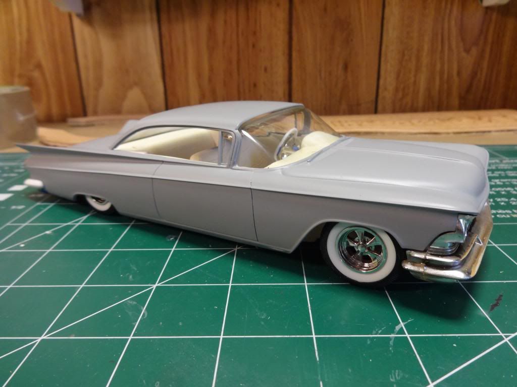

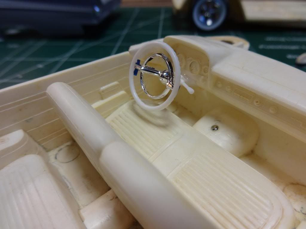

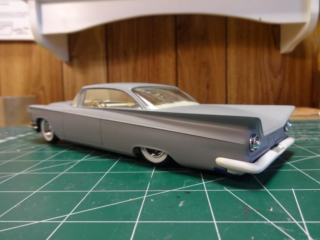

James2 Posted March 30, 2014 Author Posted March 30, 2014 Winter is finally giving way, warmer temps bring paint booth time. Won't be long now I can put some color on this one. My kit was missing a steering wheel so I grafted one in from a Caddy, not to big of a stretch! Polished glass and ride height set. Felt good to spend some time at the bench...

Joker Posted April 1, 2014 Posted April 1, 2014 Awesome work on the Buick James. For the tire/rim combo, Pegasus saves the day. I swapped the wide whites from the 4bar with the Supremes thin line to make this combo.
