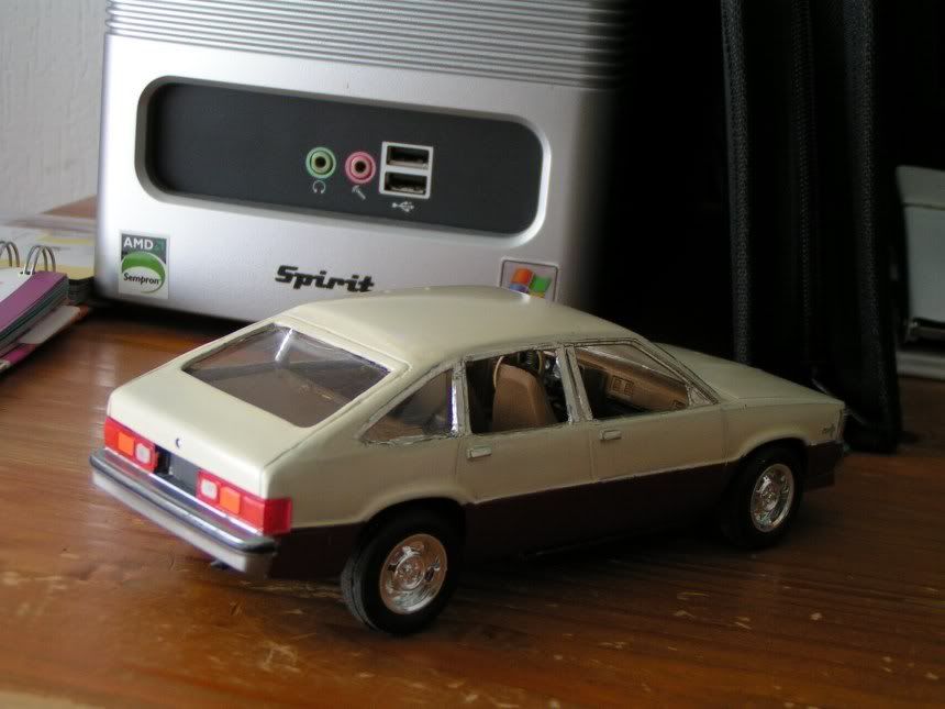

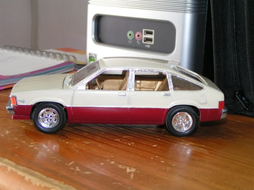

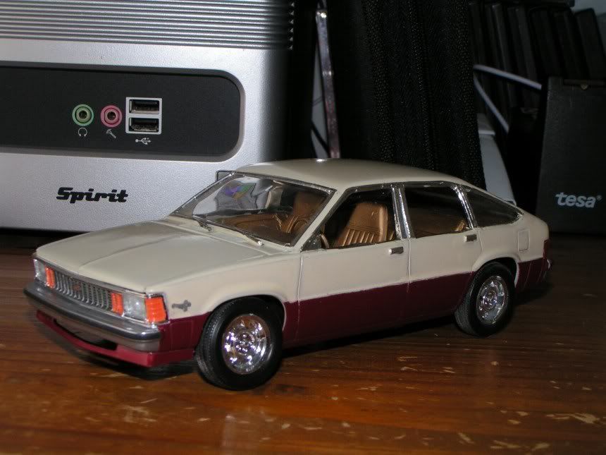

Gotta admit that this conversion is really cool! I think the 4 door Citation is more in people's experience than the two door. I remember friends of ours having the 4 door.
WOW… I really wasn't expecting a response LOL. Let alone someone else crazy enough to pull it off.
I cut the body at the end of the roof line and the in front of the fin which is part of the X-11 package. I guess I'll just start scratching until I have something. I'll get some progress pictures up in a couple of days.
