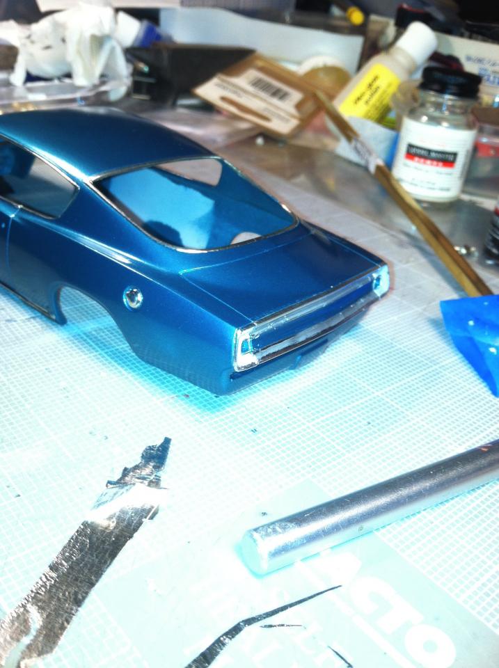

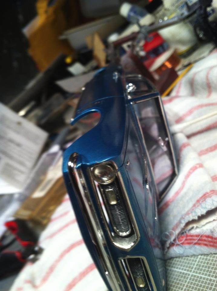

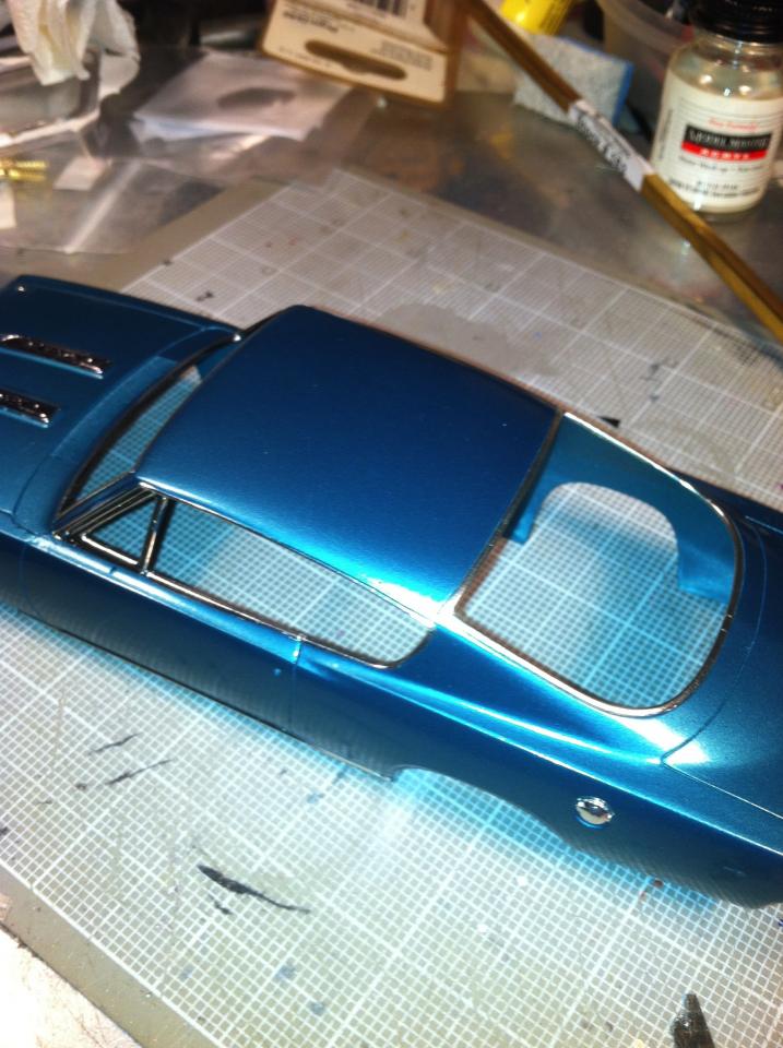

FASTBACK340 Posted January 18, 2014 Author Posted January 18, 2014 OK … updates on the "Quick Build" Today we spent the better part of a dreary Saturday morning trying not to destroy the marginal paint job I applied. Believe me, it looks much better in photographs….. and the bare metal was trying to lift the clear in some spots. I fought with it until I was tired and hungry and managed to make it presentable. But remember - Experience: this is where it comes from, our mistakes. On with todays updates. If I wasn't so busy this weekend I'd probably have it done. Let's see how things roll…. I still have to install the headlight buckets, but here's the modified grilles. The foiling is done. The rear window was split into pieces as on the actual car. The overlapping edges look realistic. I have to work on making this overlap more pronounced as on a real car it does NOT have one continuous piece of trim. I did the front windshield one piece and the rear looks better. I also foiled and painted/detailed the rear trunk lid trim. This was a major league PIA! It's the worst aspect of the build and I now know what NOT to do. Again…. experience. All you young/new builders pay attention. There's good and bad side by side on this build. We (hopefully….) learn from every build. Here's a shot or two of those Keith Marks decals. They are thin. I mean so thin theres only one side….. BE CAREFUL! Use one that has an extra on the sheet for your first attempt. He thoughtfully includes extra graphics, thank you very much. Just have to cut glass, install it and the headlights, mount bumpers, and stuff it all together. It's getting there…..

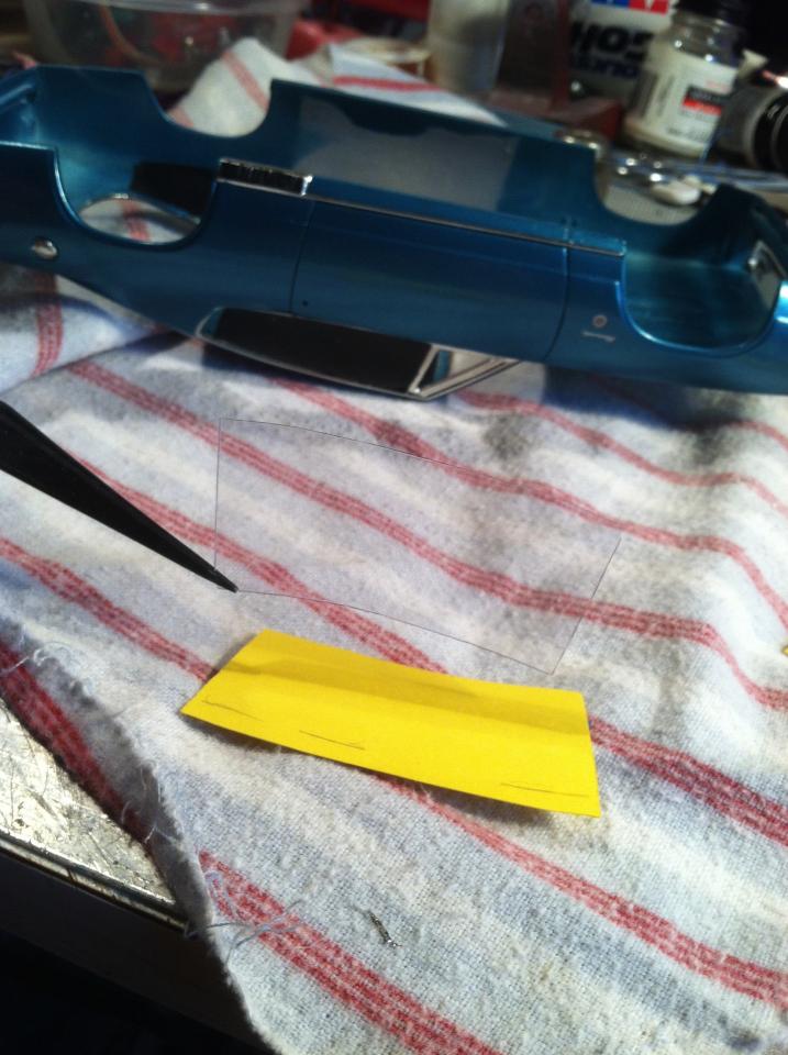

FASTBACK340 Posted January 31, 2014 Author Posted January 31, 2014 Wow, after a brief kick in the shorts from life, I got a chance to hit the workbench again…. I made templates for all the glass and cut them from clear packaging I saved. I don't remember if it was from Holiday cards or something else. Then we polished and installed the body "glass". While this is a little more tricky to install, the realism is worth it. I used this neat little tool I think I got from MCM… if not, my apologies, but it does work good! 5 minute epoxy is key…. Once installed it looks sweet! The vent windows and rear side glass are in. I still have to add the chrome divider strip on the rear side windows. The headlamp buckets will go in next. Shells are foiled brass tube w/ plastic buckets holding MV Lense's. I know this build is taking way longer than I expected. I wonder how long the full-detail build will last? This WILL be done this weekend. I'm fussing with the high mount third brake light now……

Tom Geiger Posted January 31, 2014 Posted January 31, 2014 Looks great John! Per your comment on making the BMF edges of the window trim stand out, I found if I went two layers thick on one of the matching edges, maybe on the side pieces, the edge becomes more visible. Hope to see you in April!

Custom Mike Posted February 2, 2014 Posted February 2, 2014 (edited) John, the front end looks great, and the glass is perfect! Hurry up and finish this baby! I used this neat little tool I think I got from MCM… if not, my apologies, but it does work good! 5 minute epoxy is key…. You've got to show me some more of that tool, I need something like that...BAD!!! Edited February 2, 2014 by Custom Mike
FASTBACK340 Posted February 2, 2014 Author Posted February 2, 2014 Google Model Cars Windshield Tool and the page will be listed. It's an article I read in MCM it works sweet. Check it out!
