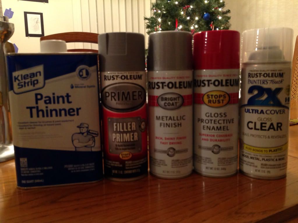

I just wanted to thank everyone for all the help. People got me thinking about getting an airbrush but after I did research the airbrush I wanted was way out of my budget. I ended up with a couple of models and some spray paint.
Michael's had junk everywhere and a piss poor selection of paint. Cans opened and used. Even the employee who unlocked the cabinet was spraying them all over everything. So I picked out the two models I wanted and hit up HomeDepot. The only paints they had were Rustoleum's and there was neither all lacquer or all enamel paints so I'm hoping these will work together. I did the best I could with what I had to work with.
LMK what you all think.
