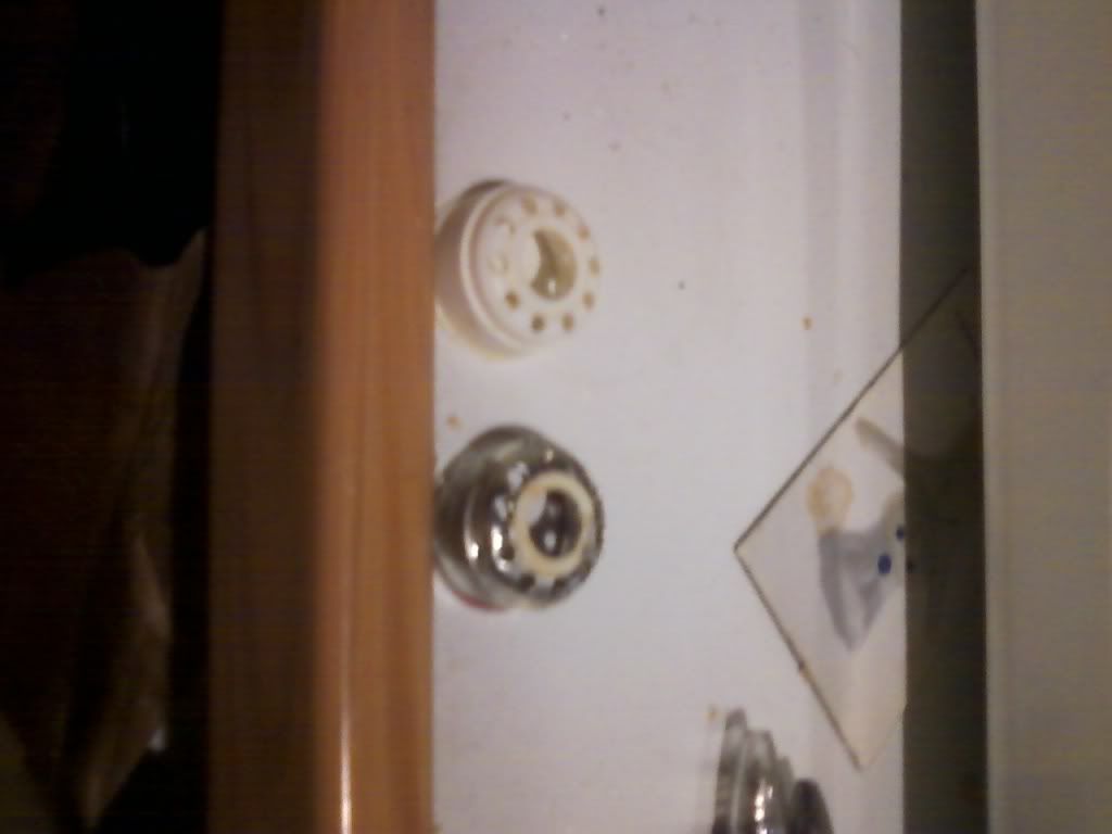

ARTEMIS1759 Posted April 5, 2012 Posted April 5, 2012 OK so these are my parts I expiremented with. Chrome wheels. Before and after:
ARTEMIS1759 Posted April 9, 2012 Posted April 9, 2012 I have had parts in for a week now and still no sign of warpage. I had some more paint that would not come off but it is all peeling now.
