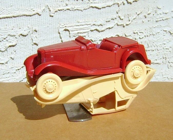

Russell C Posted June 15, 2019 Author Share Posted June 15, 2019 Time to get back to this relatively simple, but still neglected project. What stumped me was the proportions of the kit to begin with, and how it still didn't look right after my last bit of reshaping. The radiator was still too tall, closer rsembling the height of a TC model than a TD. So, it may be a little hard to see in the first photo below of the resized driver's side vs not-yet-resized passenger side, but I removed more from the top and bottom edges of the door panels, then sawed the hood side panels off from the top panels, and then reduced the blank area above the louvers to nearly half the height, and removed more from the bottom edges of the hood sides. Top & bottom, this second resizing amounts to nearly an eighth of an inch. Who knows how many inches that would be in 1:1 scale. And, I also leaned the fuel tank several degrees further into the back of the body. I'm happier now with the taped-together mock up here. Subtle to see, but better proportions now from this additional resizing for my personal tastes. The Gowland & Gowland kit version is still far more accurately proportioned overall, wider and flatter. But there's no way I can polish that kind of plastic to a good shine, and I've gotten way to lazy in my old age to put a killer paint job on such a small model, so I'll be plunging ahead on this build. There's entertainment value for me to see what kind of gem can be ultimately polished out of such a roughly designed simple kit. Quote Link to comment Share on other sites More sharing options...
