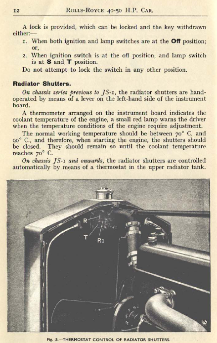

sjordan2 Posted October 14, 2014 Posted October 14, 2014 I'm confused. My original Rolls handbook shows that your first placement of the thermostat control on the left was correct (page 12, fig. 3).
Cato Posted October 14, 2014 Author Posted October 14, 2014 (edited) Different placement on LHD vs RHD models? Sure but they replicated a RHD car; somebody shoulda told Senior Radiator Die Maker.... Edited October 14, 2014 by Cato
sjordan2 Posted October 14, 2014 Posted October 14, 2014 (edited) I have both the LHD and RHD handbooks, and they use the same illustration in both manuals (OOPS! WRONG. SEE CORRECTION BELOW IN POST 484). The image below is from the LHD handbook. Neither handbook contains an original publication date anywhere. I seem to recall that somewhere along the way (I don't know when), Rolls modified manual shutter opening/closing with the automatic thermostat shown here. It can be overridden manually. Edited October 14, 2014 by sjordan2

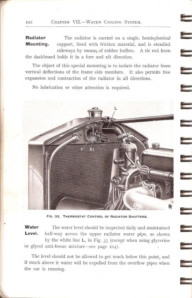

sjordan2 Posted October 14, 2014 Posted October 14, 2014 (edited) I would add that I was incorrect about the illustrations being the same. The placement of the thermostat is the only thing that is common between the LHD and RHD illustrations. That's because the LHD version as shown above is mostly a mirror image of the RHD chassis and engine layout, and components like the carburetor, exhaust, etc This is the correct RHD illustration... Edited October 14, 2014 by sjordan2
Cato Posted October 14, 2014 Author Posted October 14, 2014 I have both the LHD and RHD handbooks, and they use the same illustration in both manuals. The image below is from the LHD handbook. Neither handbook contains an original publication date anywhere. I seem to recall that somewhere along the way (I don't know when), Rolls modified manual shutter opening/closing with the automatic thermostat shown here. It can be overridden manually. Most impressive and thorough explanation Skip-thanks. So I've inadvertently modeled the full manual system. Rolls went to the full thermostatic system shortly after 1932. Just like with the gas tank (22 gallon vs 28 gallon) and the carburetors (2 different designs, prior to and after 1931), Pocher has blurred the changes and modeled an amalgam of Rolls parts in the same car. The enduring mystery of the swept front fenders continues. No evidence exists (to my knowledge) of a car with them on a Sedanca (Continental). Possibly the boat-tailed roadster IIRC. If Pocher modeled them from a real car, it does not now exist or any record of it. Yes these were all done to customer's wishes by coachbuilders so maybe one owner desired them in all P II production. Again, almost nothing you do is 'wrong' on a Pocher classic. It's made me more comfortable with the license I took on details and finishes. I'm going for art as much as a faithful replica.
sjordan2 Posted October 14, 2014 Posted October 14, 2014 (edited) Rolls registry info indicates that chassis JS1 with the auto thermostat and other JS series were introduced in 1931 (the kit is supposed to be 1932, isn't it?). I found a catalog picture of an enclosed 1931 Hooper sports saloon with similar fenders. I find the caption a bit confusing, but I'll scan it today and post it. NOTE: I've come up dry on this --many of the Rolls coachbuilders had similar flared front fenders on fixed-head tourers and sports saloons, but I can't find one on any open car. Edited October 14, 2014 by sjordan2
