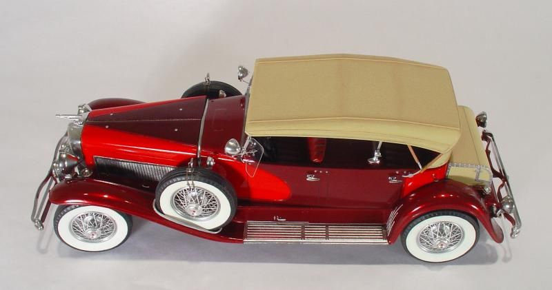

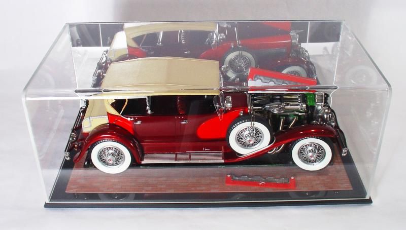

Thanks also to Tom and Stan for their kind remarks; much appreciated! I've added one more photo which shows the model more clearly out of its mirrored case, being careful not to use any that appear in the article itself. Thanks also go to Gregg Hutchings and Harry Pristovnik for accepting the article in the first place. I hope you fellows enjoy it.

Bob....Congratulations on your Hubley Duesenberg build, preceding my IPMS van build in the magazine. Your article is so interesting that I read it a number of times over.
It is by far the very best built model Dusie from a Hubley kit that I have ever seen. Fantastic! I built one of the SJ kits about 5 years ago and re spoked the wheels, opened up the hood etc. and added some other extra details. But yours far surpasses the model that I made both in finesse and detailing (especially all the incredibly fine detailing of your model's engine/clutch assembly). Making yours with the roof up and detailing it on the inside was also a really nice touch. Your choice of colours for your model really suits the car. Mine is finished in a two tone blue and there may possibly still be a couple of pictures of it in the gallery of the Scale Motorcars website from ages ago.
I certainly picked up some very useful tips from your article, as it is always interesting to see a fellow modeller's approach.
