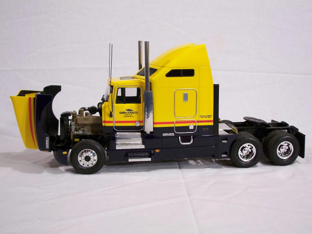

purepmd Posted March 12, 2014 Posted March 12, 2014 Tom, one of the most troublesome aspects of building my first T600, was getting the hood and bumper to line up right and clear each other so you could raise the hood. Combine that with a wheel base thats a good inch to an inch and a quarter to short, and you have a challeging build. They can turn out well though. I stretched the frame and fairings, built some supports for the fairings, moved the tanks forward, and moulded the grille. Here are a couple of pics to show that it can be done.

tbill Posted March 12, 2014 Author Posted March 12, 2014 thanks guys, interesting info, this should be something else lol. Mark, that looks terrific, if i end up half as as good as that, i will be pleased.
