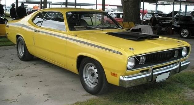

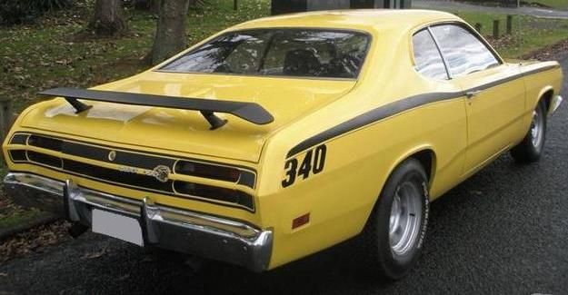

69NovaYenko Posted April 26, 2014 Author Posted April 26, 2014 (edited) Cosmetic Differences , 1970-1971 Duster : 1.) Upholstery patterns (including interior door panels) 2.) "Generic" grille 3.) Aforementioned 340 model's stripes 4.) "Flat" decklid (i.e. , no centre highpoint-crease) 1970-Specific Duster 340 Items : 1.) Carter AVS carb 2.) Non-assist disc brakes , standard 3.) Exhaust tips were turned-down (i.e. , no Bright Exhaust Tips) Converting / backdating the 1971 model to 1970 specs --and doing so *correctly*-- would be an undertaking . I wonder why MPC (or even AMT) didn't tool-up a 1970 Duster promo / kit ? One would think that Plymouth would want to promote its newest "Junior Supercar" ! Thanks for the detailed cosmetic differences list. From the photos I have located it appears that the taillights and body side markers are the same on both the `70 and '71 models. The difference between the two model years are the front grills. I'm I off base? '70 Duster 71 Duster Edited April 26, 2014 by 69NovaYenko
Sport Suburban Posted April 26, 2014 Posted April 26, 2014 My research on the body's was that the 70 and 71 used all the same steel. The grills are different and the trunk peak showed up on 72 and later models. That yellow 71 has a 72 and later trunk on it.

69NovaYenko Posted April 27, 2014 Author Posted April 27, 2014 (edited) My research on the body's was that the 70 and 71 used all the same steel. The grills are different and the trunk peak showed up on 72 and later models. That yellow 71 has a 72 and later trunk on it. non sharktooth grilles are 'almost' the same between 1970 , 1971 and 1972 , if I remember right the differences were color schemes were different Body sheetmetal is the same between 70 and 71 decklids with the peak showed up on some late 1971 cars , and I think some 1972 cars had a smooth decklid door panels are 1970 only I think seat patterns were the same between 70 and 71 but there were color differences that were model year only Let see if I'm undersatndig this correctly. As far as "outward cosmetic appeareance" is concerned to convert the `71 Duster kit to a '70 Duster I would need to scrounge up a correct '70 non-shark tooth front grill. Remove the peak on the rear trunk decklid and hood. Additinally, ,the interior door panel patterns were different between the '70 and '71 Duster but th seat style and upholstery pattern were the same. Edited April 27, 2014 by 69NovaYenko
