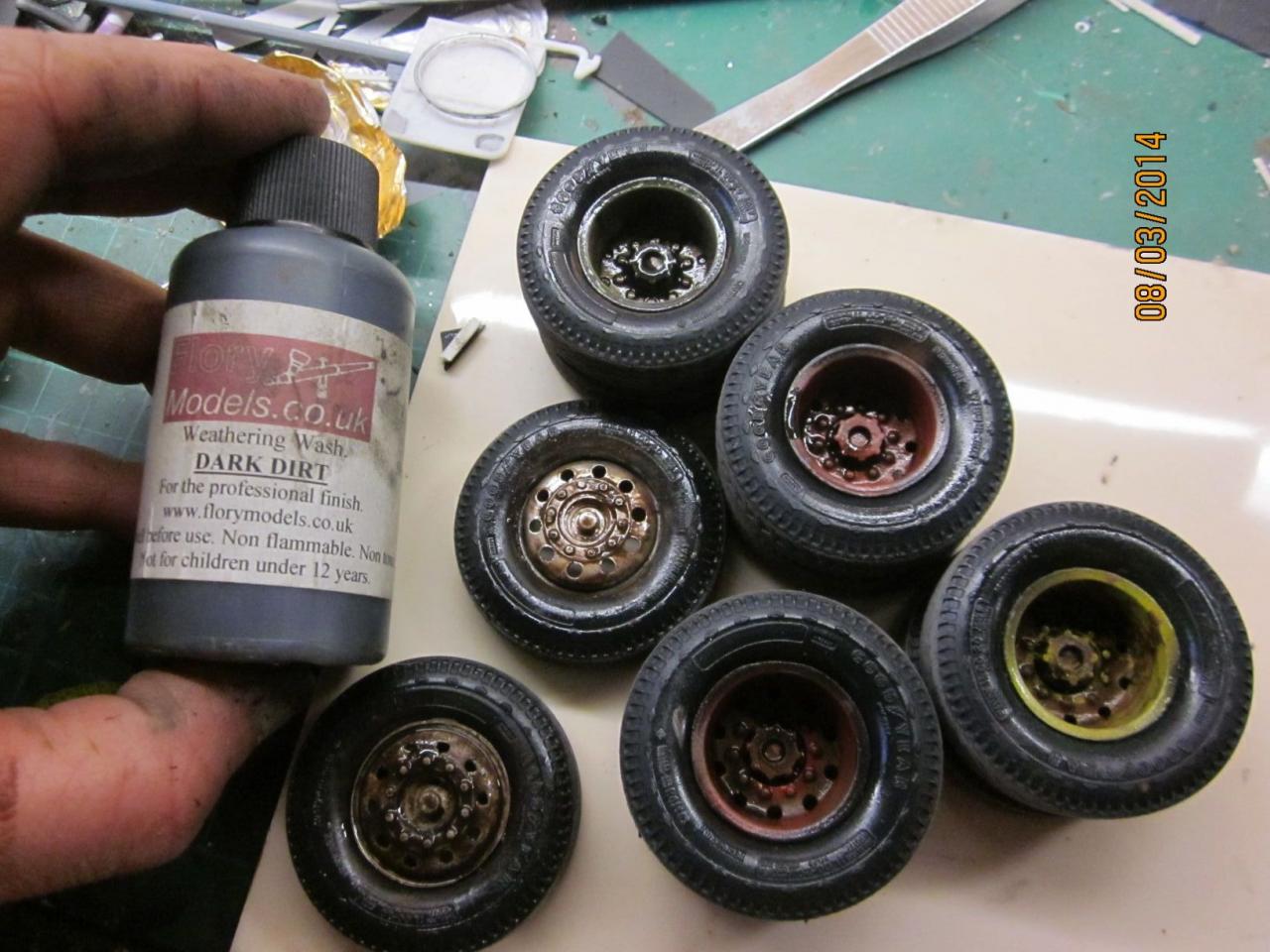

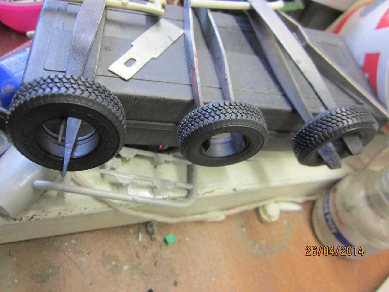

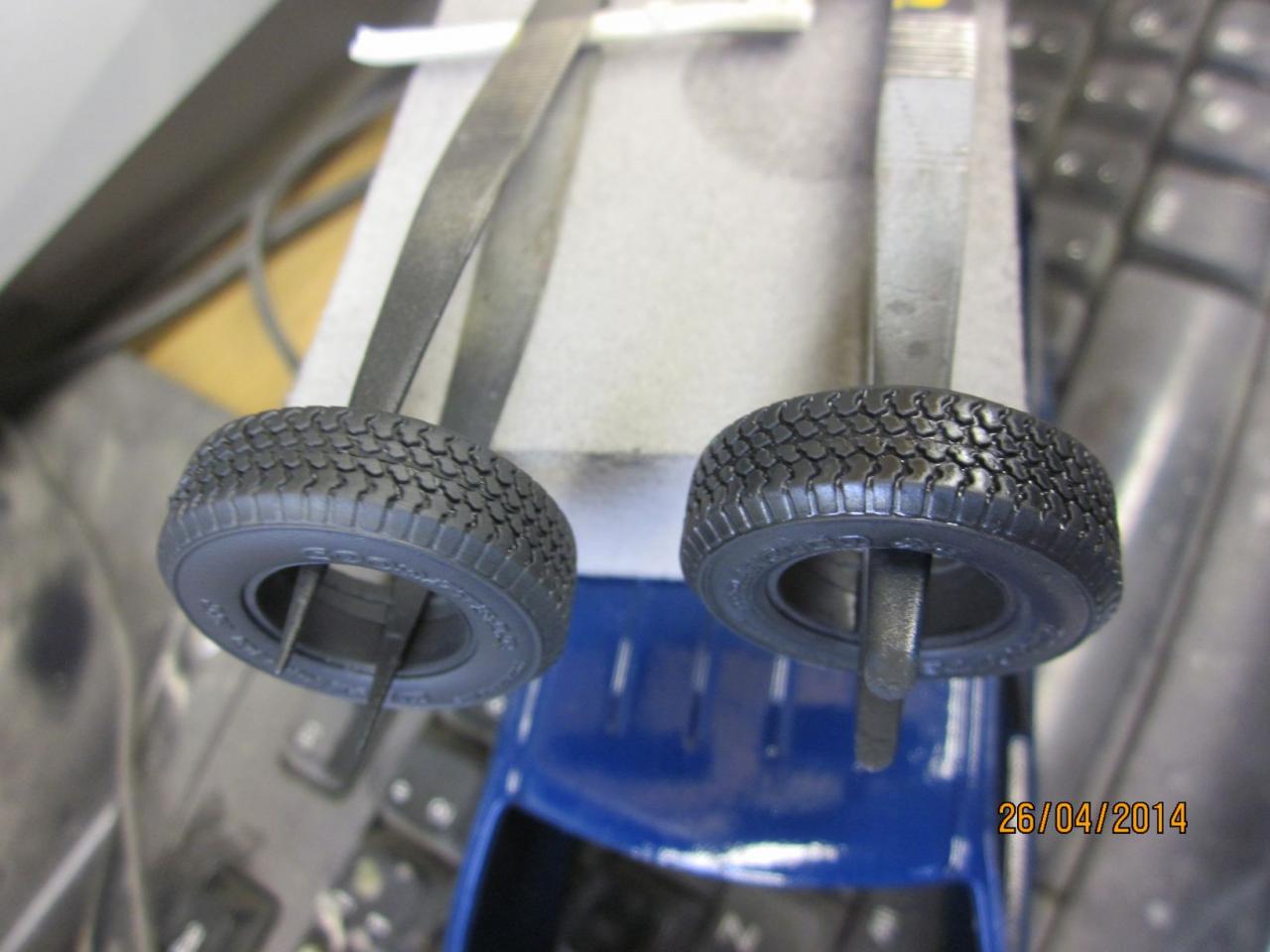

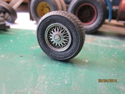

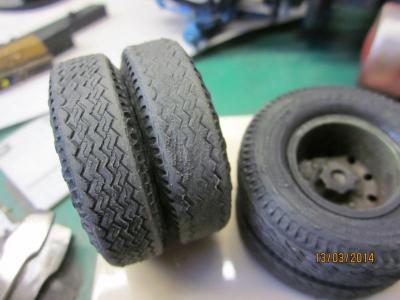

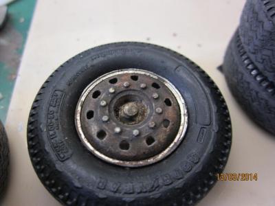

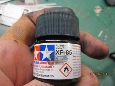

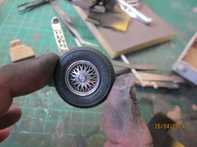

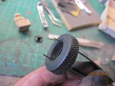

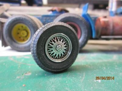

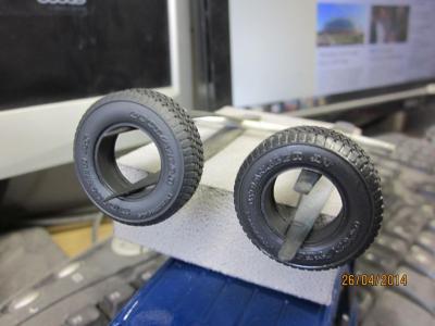

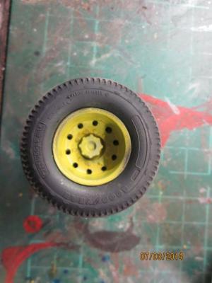

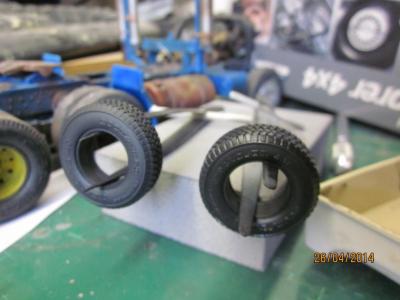

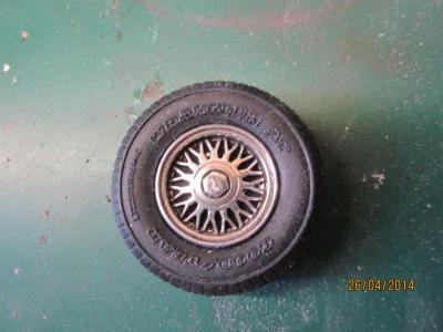

English Jules Posted May 20, 2014 Posted May 20, 2014 I brush on a klear floor polish, then when that has dried i airbrush on a tyre black, or something similar by Tamiya. I thin with cellulose thinners which is why i protect the rubber with Klear first
