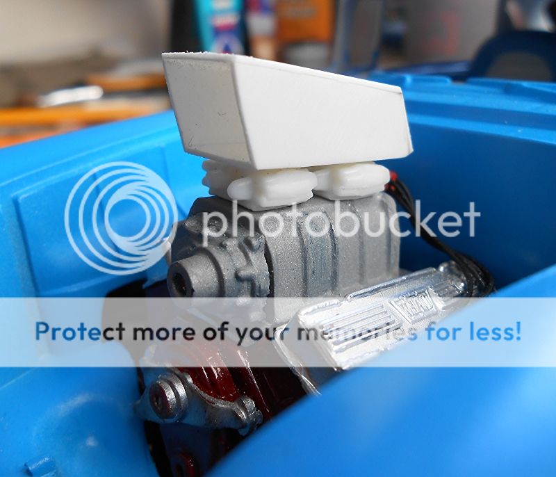

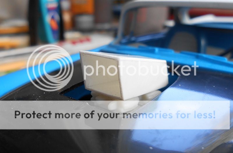

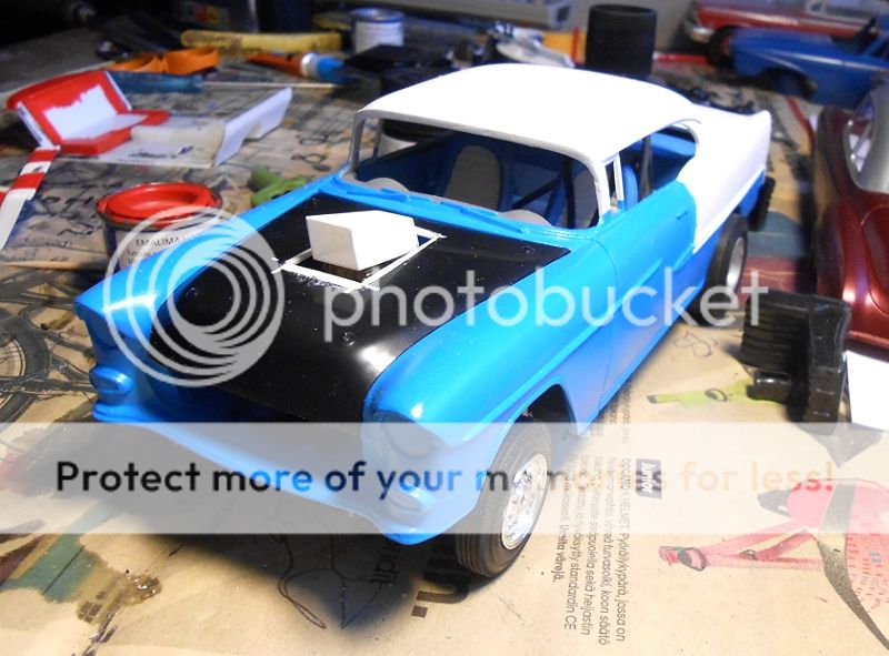

W-409 Posted September 20, 2014 Author Posted September 20, 2014 Thanks guys! I highly appreciate the kind words. A Small update for this one. I found a set of carburetors from my parts box. They're from AMT '66 Chevy Nova kit and they should be pretty good for this one. I also scratchbuilt a scoop from sheet styrene. I still have to drill holes for the carburetor throats to the bottom of that scoop, but otherwise it should be ready for paint. The hood isn't painted yet, because I have to make the hole on it slightly smaller.

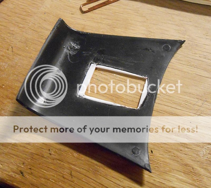

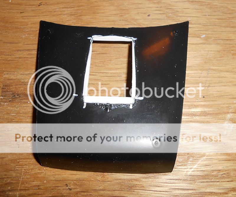

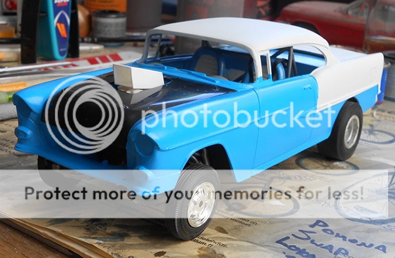

W-409 Posted October 20, 2014 Author Posted October 20, 2014 Thanks Glenn and Ron! I appreciate your comments. Finally I'm back working with this one. I started modifying the hole on the hood. It's too big for the scoop so I started adding some sheet styrene to make the hole smaller. I'll try to add some more styrene on this one really soon to get the hood painted.

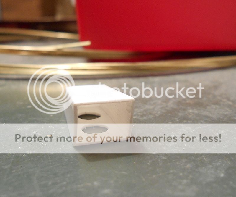

JTalmage Posted October 20, 2014 Posted October 20, 2014 Any tips on making that scoop? I'd like to make one similar and cover it in chrome BMF
W-409 Posted October 21, 2014 Author Posted October 21, 2014 Any tips on making that scoop? I'd like to make one similar and cover it in chrome BMF It's actually quite easy. I started by making the bottom plate from sheet styrene. I just drew the lines to the sheet styrene and cut it off. The sides were done next. I used the first side piece as a quide to the other one and that way they turned out similar to each other. Then I glued those parts together and I also glued a larger piece of styrene to the top. Once the glue was dry, I trimmed it into a proper size and then I did the back piece with the same method. I've done three of these scoops in the past and all of them have turned out good. So those are actually quite easy to scratchbuild... I'm sure you can do it. I still have to drill holes for the carburetor throats on the bottom part, though.

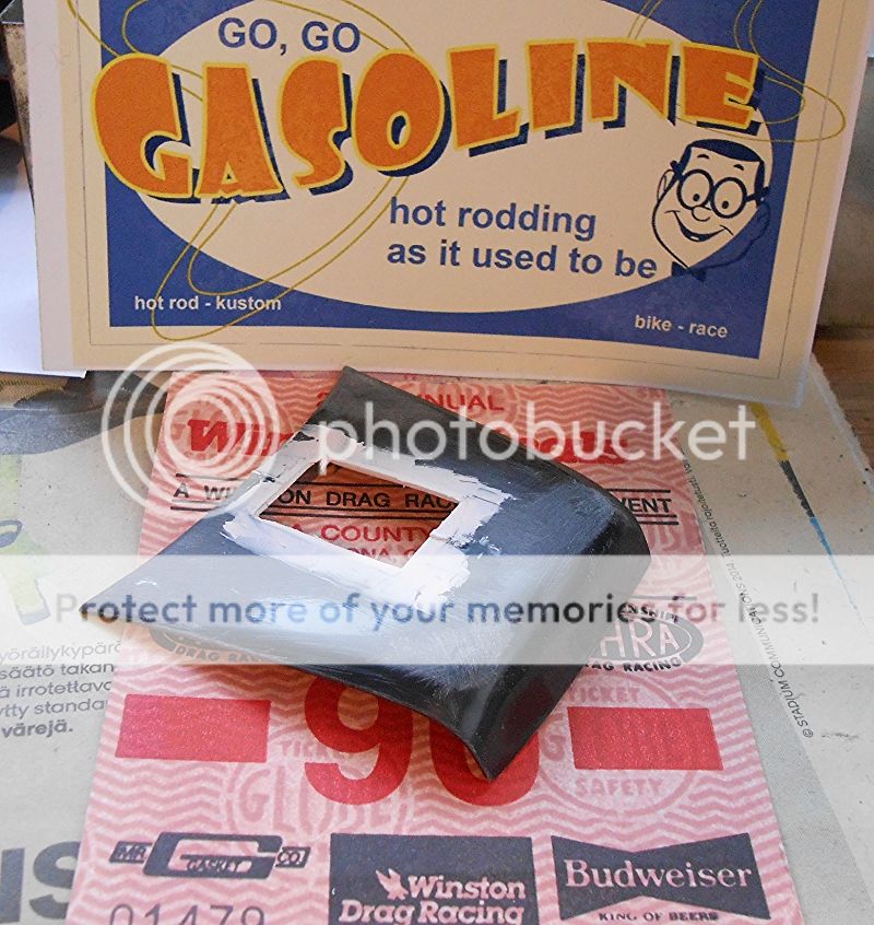

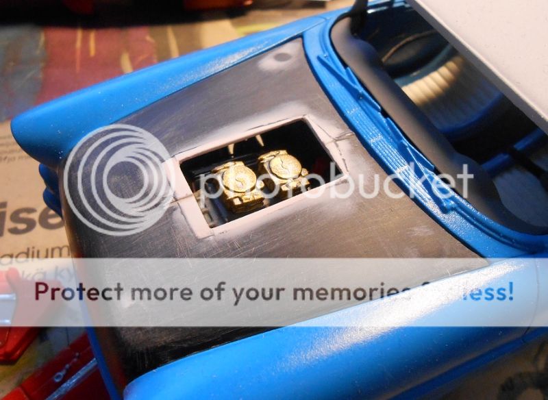

W-409 Posted October 24, 2014 Author Posted October 24, 2014 (edited) Thanks Philip and Darryl! I appreciate it! Yep I know many people who don't like to build 1/24 scale models. I think it makes no difference, so for me this is not a big deal. I got the hole on the hood done. A couple of pieces of sheet styrene and some rough sanding and now it's covered in Bondo. I also drilled holes to the scoop and now the carbs get some fresh air, too. Edited October 24, 2014 by W-409
W-409 Posted November 1, 2014 Author Posted November 1, 2014 The hood is starting to look smooth now from the top side. After the last set of pics I have put a couple of coats of Bondo on it and sanded it smooth each time. Now it should be ready for a coat of Spray Filler or Primer, I'm not sure which one I'll be using. The underside is still rough, though. It needs to be smoothed out before I can shoot anything on it.

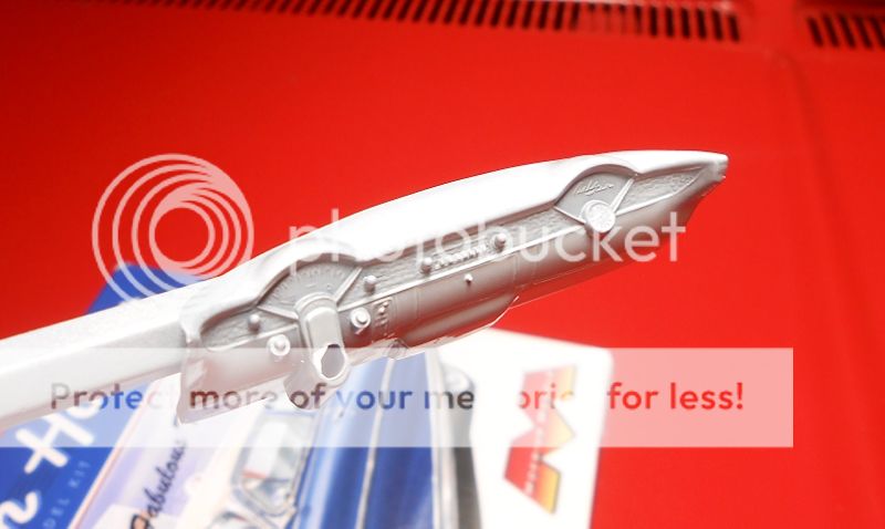

W-409 Posted November 1, 2014 Author Posted November 1, 2014 Thanks Gene! The prep work can be really frustrating at sometimes, but now I somehow had inspiration to work with the hood as fast as the filler dried. The underside is another story though.... It will be a pain to get right as the shapes make it difficult to sand. How do you apply the Bondo? Is it sprayed on? I found this picture from the Internet. It shows how the Bondo looks when the actual filler and the hardener paste are mixed up. For applying it on a surface I use a piece of thin styrene sheet or then a piece of thicker cardboard. It's the best way I've figured out anyway. It works like this, but of course just in a smaller scale.

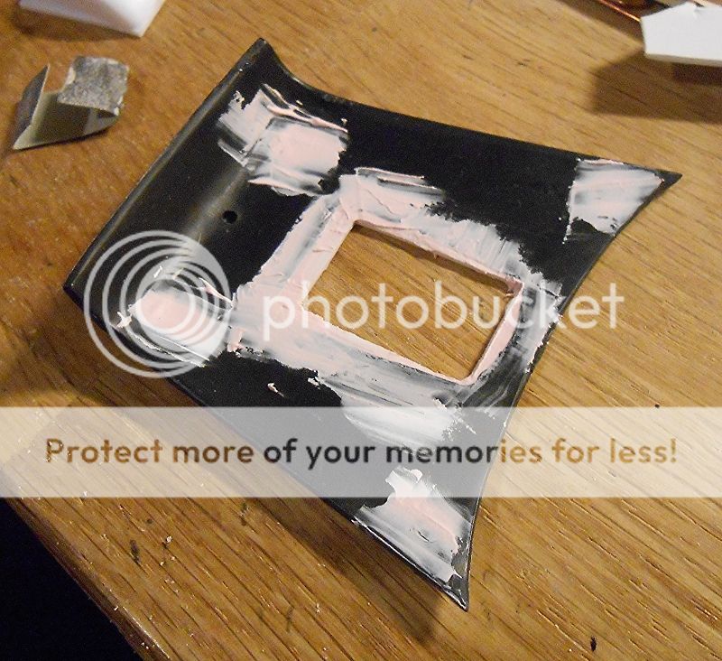

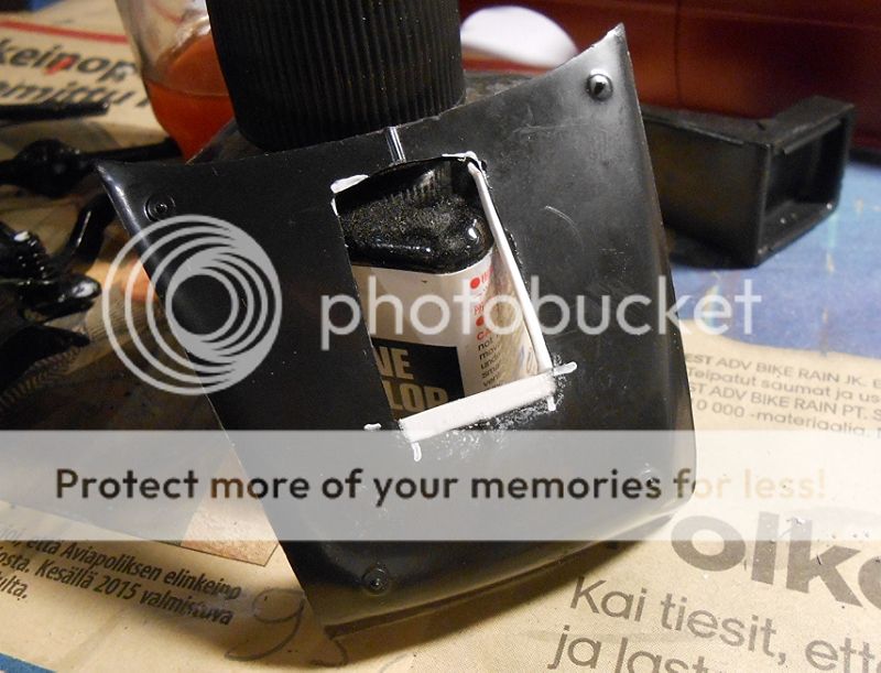

W-409 Posted November 2, 2014 Author Posted November 2, 2014 Thanks Guys! everyone has what works for them, I used it daily for years and mixing in air is almost unavoidable with a stick and creates nightmares in 1:1 but by all means, what ever works for ya, I was just try'n to keep anyone new to the process from developing a bad habit. Filler primer or 2K as its called is far from sprayable filler, it requires a pressure pot gun and is odd if your not used to it where as 1 and 2k's can easily be applied from anything from an airbrush to an hvlp or even rattle cans. The primers that are used and commonly available to us as auto refinishers and moddlers fall under 1k and 2k primers, sprayable filler is almost always a special order item and is usually in the industrial coatings rather than the typical automotive line. Yep it's true everyone has their own building techniques and for someone a technique that works for me might not work. Oh well, looks like I've hit a language barrier in here. We call it Spray Filler or Filler Primer here in Finland, but I guess there might be another word for it in English. A Small update. I just put the first coat of Bondo to the underside of the hood. Once it's dry, I will sand it smooth and it probably will need some more Bondo. I also shot some white Primer on the dashboard. Hopefully I can get it painted blue really soon.
