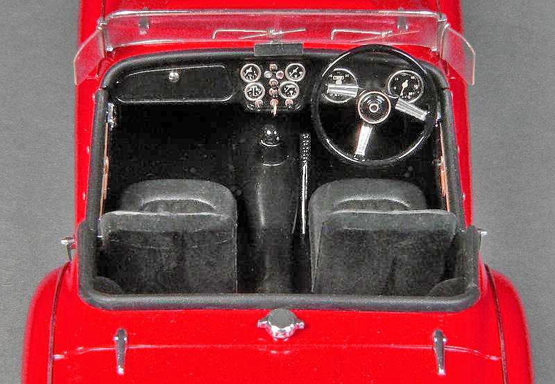

Plastheniker Posted June 24, 2014 Author Posted June 24, 2014 Still not satisfactory but better than the first attempt:
Plastheniker Posted June 24, 2014 Author Posted June 24, 2014 Thanks Harry, indeed much more visible details though it is a very bright black now ... .
