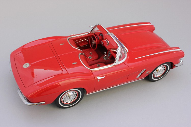

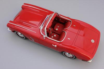

I've had success using a simple method that looks convincing and easy to do. The seats on this Corvette were painted with Testor's Enamel Flat Red. Once dry, using my airbrush at a distance of about 12 inches from the seats, I lightly airbrushed two coats of gloss clear. This will give the seats a slight vinyl sheen. Go very easy and play around with the distance and the pressure from the airbrush until you are satisfied with the results.
