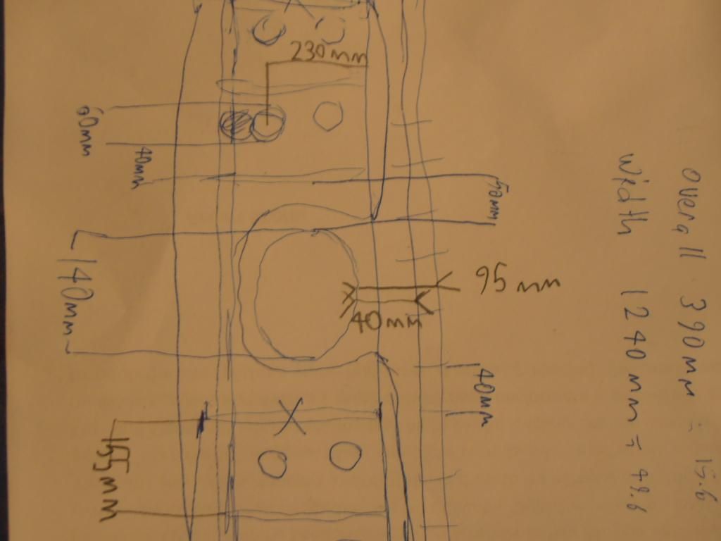

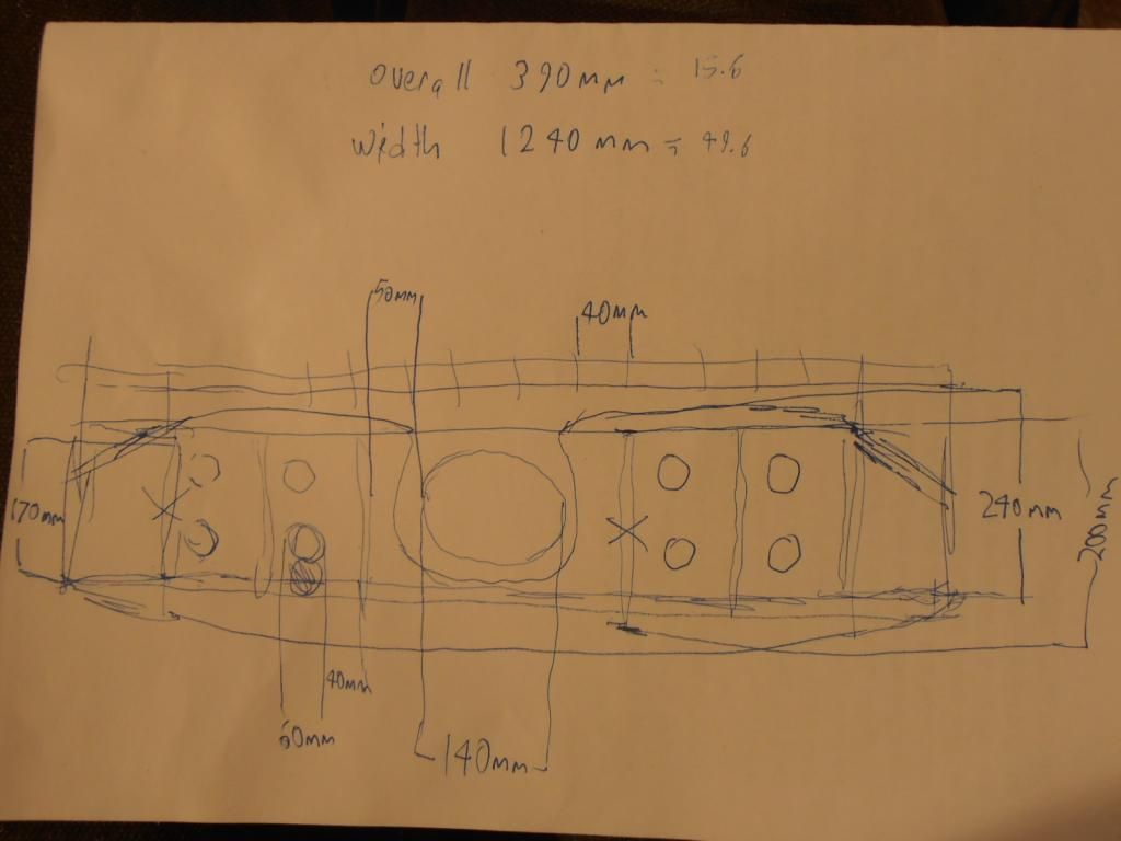

I made up a basic sketch of the parcel shelf and then got most of the measurements from the 1:1.
Its a fairly complex structure with various recesses and holes. It will be done in two layers.

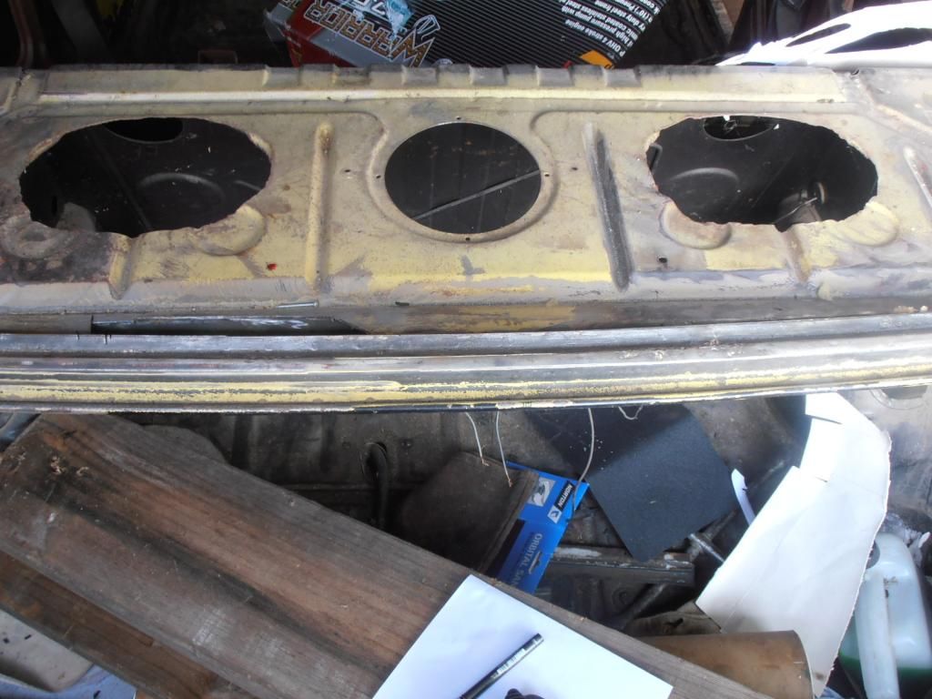

One thing I should add is that the two oval holes either side of the centre hole are not factory based. They were cut out "correction butchered out" by the previous owners for speakers. Because I plan to restore the 1:1 I will need to repair this area. In the sketch I Have corrected this area.

what, you're not going to replicate the butchered speaker holes? there wouldn't be a torana out there that doesn't have those.....
on a related matter, holes like those will fail you on a RWC down here (victoria) for compromising structural integrity and you'd have to have them repaired and engineer certificated to get the vehicle registered.
just another way to get old cars off the road or genuine safety matter ?
Edited by spotarama
And here I was thinking NSW had the most stringent engineering laws. Having said that, the holes should never have been cut and it is definitely something that I will be repairing a soon as a can find a suitable replacement panel.

I was getting ready to cut the holes for the parcel shelf when I realised I needed some more measurements. So down too garage I went. Here are the extra measurements.

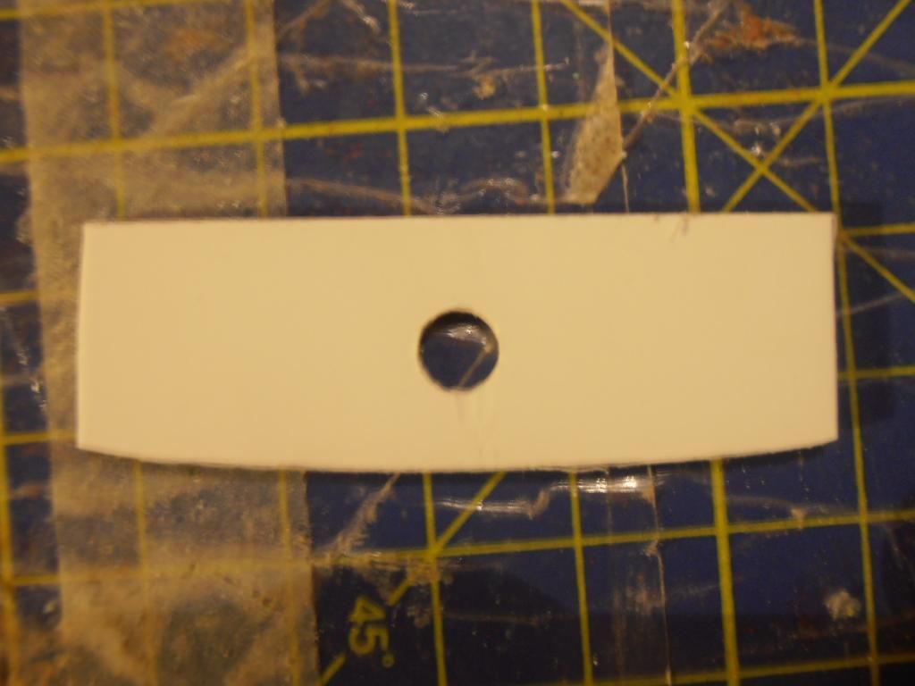

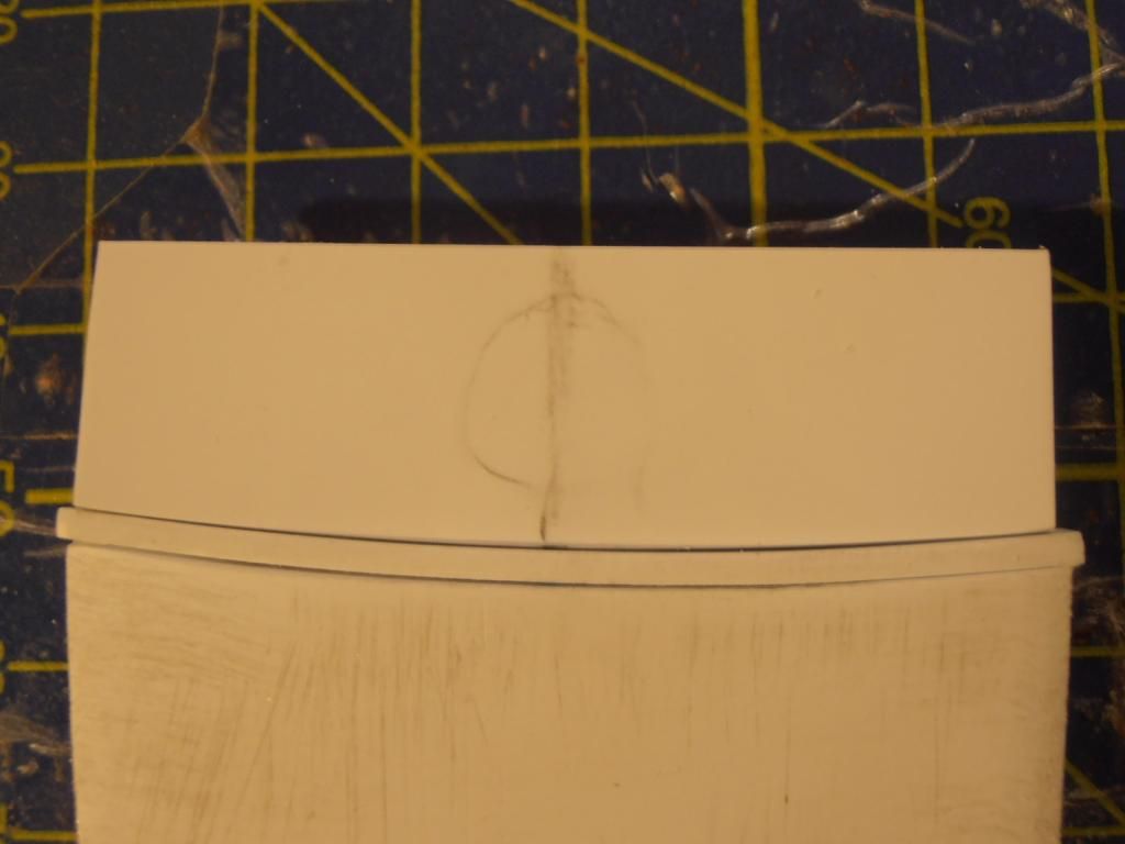

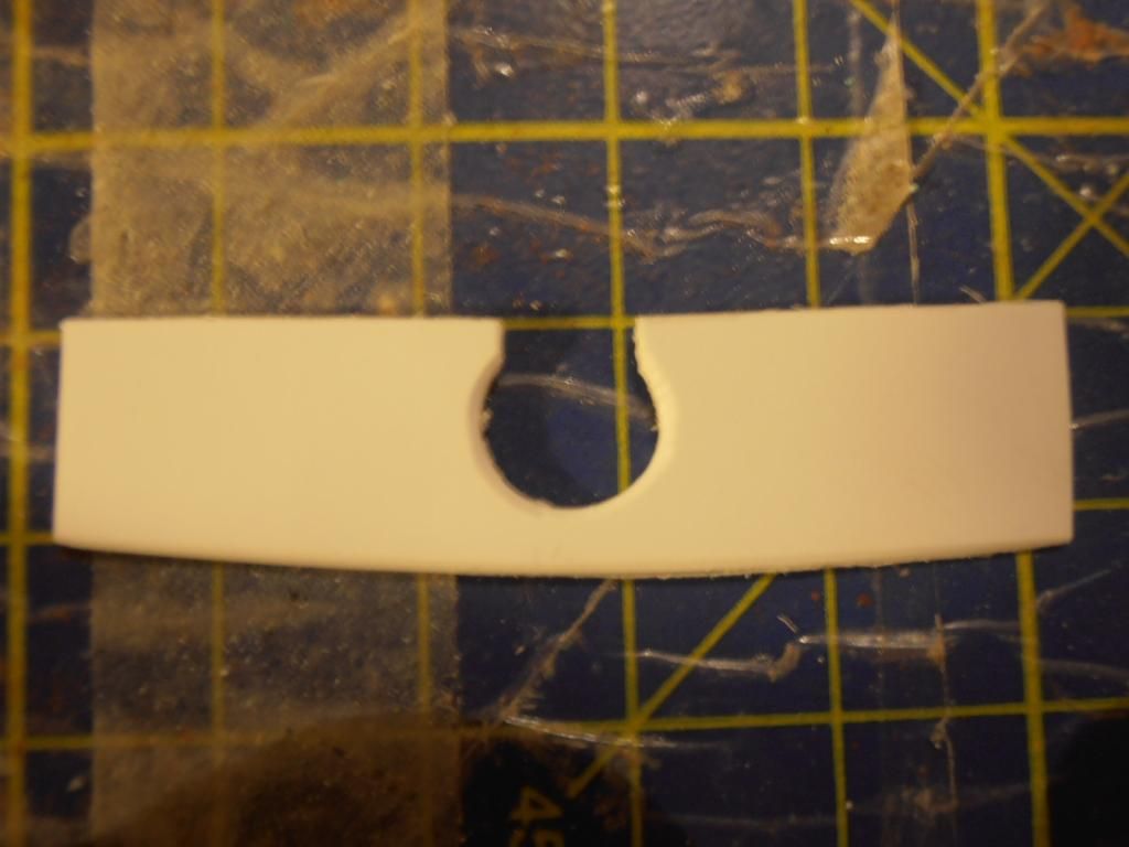

With measurements taken I was keen to get the centre hole drilled so I used the biggest drill bit I could find and made the hole about 7.8mm.

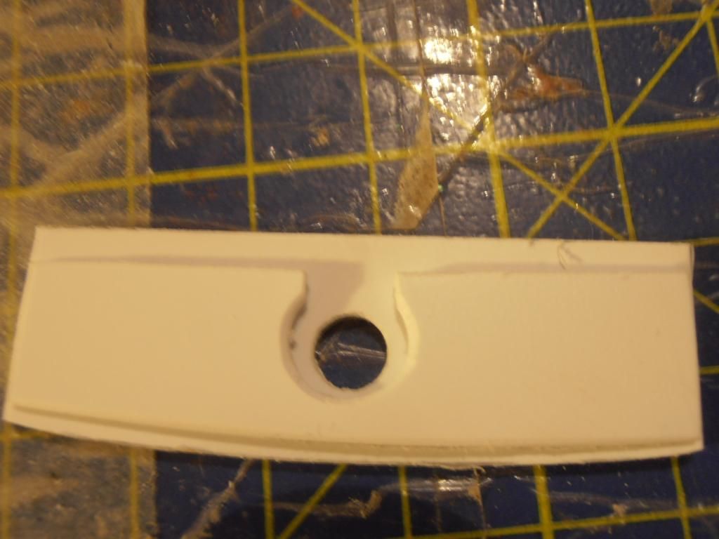

I had no idea that the actual hole was only 5.6 mm until I scaled down the full size measurement. With the hole to big for the parcel shelf I came up with an idea.
Here is how they should eventually look minus the ugly speaker holes of course. Next task will be to get more measurements for the upper layer and begin making the recesses.

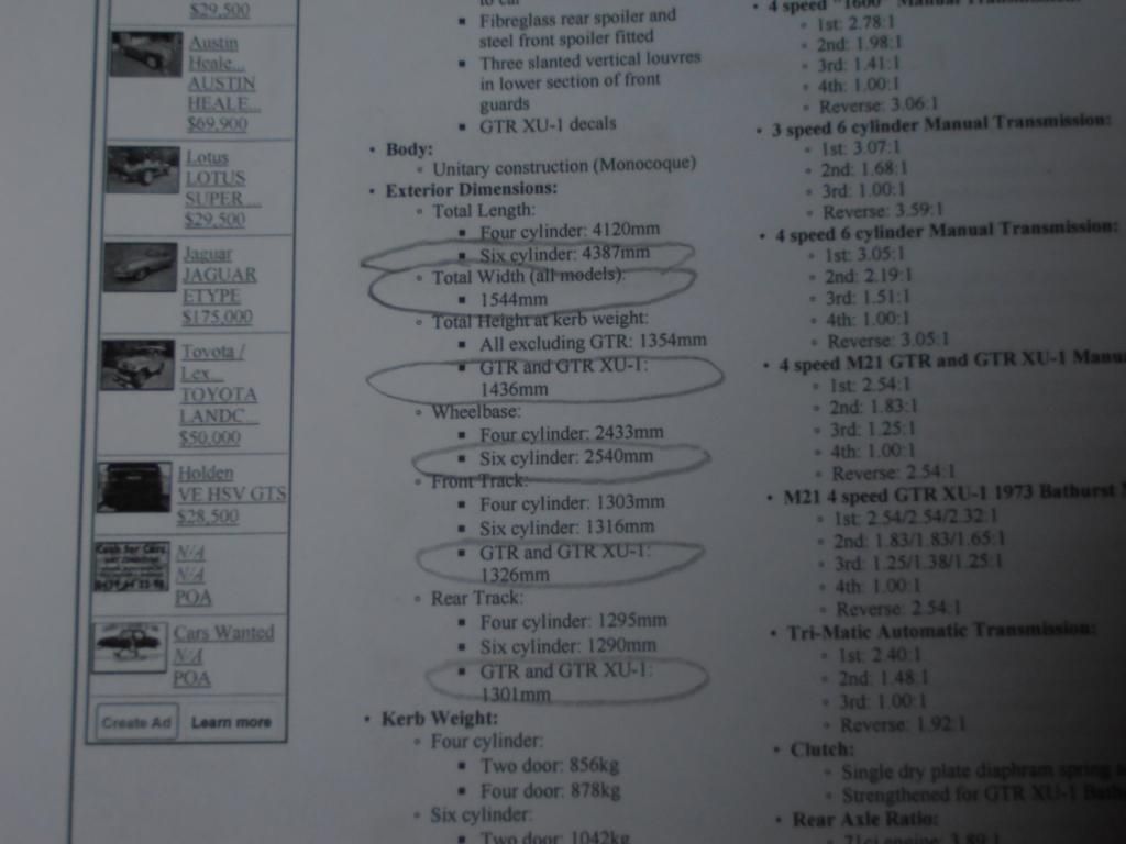

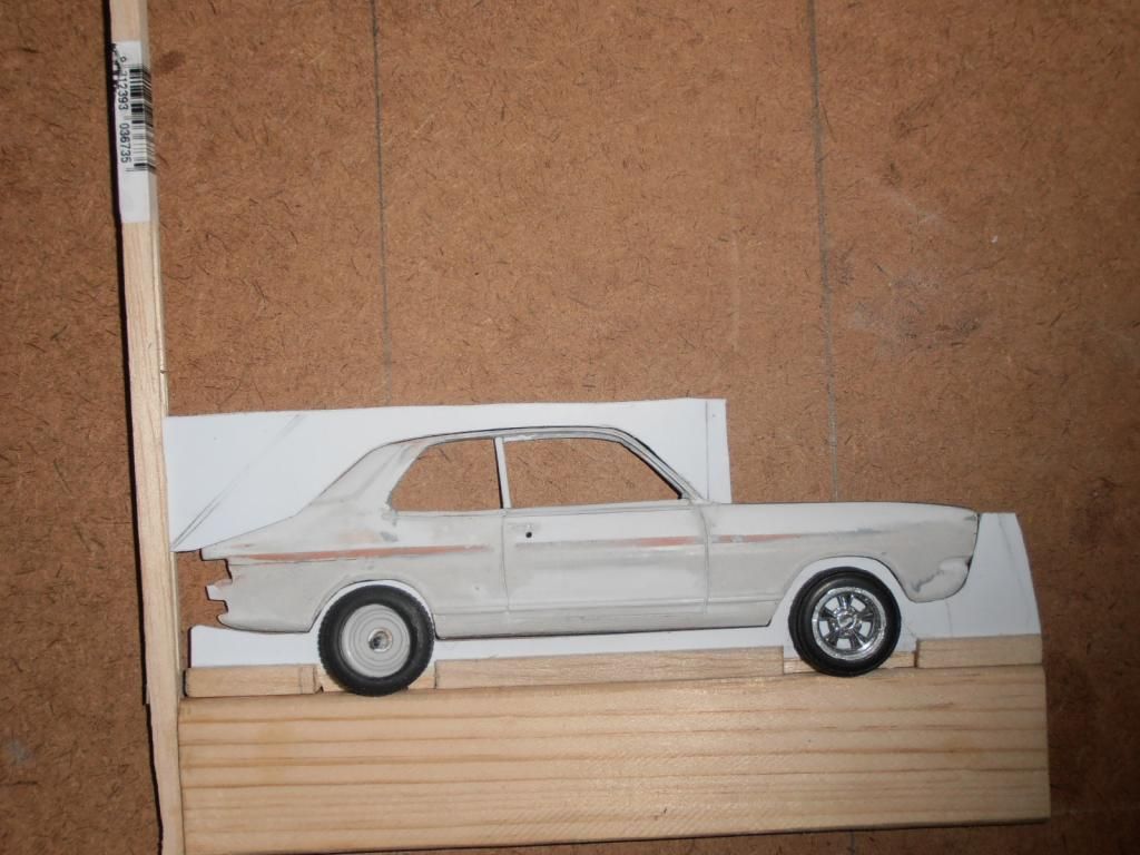

After nearly a month away from it I decided to get back into the build. My arm is still in cast but the next but with the next check up still a month away I can't wait any longer. I have already lost a month and I don't on losing another. With move movement of my right hand somewhat restricted I am finding most tasks a challenge. The last thing I was working on was the parcel shelf, that is on hold at the moment duh to its complex structure. Instead I have decided to focus on the body again. A couple of weeks ago I was looking for parts for my Torana the 1:1 version and I came across this. Titled "Torana Specifications"
It had the important measurements for each model type. I circled the ones relevant to the XU-1 since my own version is only a standard model.
This was also an opportunity to the cross reference my own measurements.

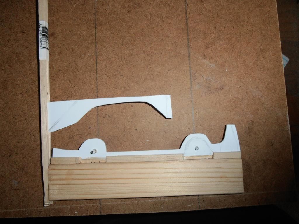

With the wheelbase measurements worked out I decided to put this together. The lower contour gauges for the under side had the side cut away for the addition of wheels. A piece of timber was added top the bottom edge to reinforce the gauge. Another piece of ply was added to the back and a slat was cut to allow the upper count our gauge to be added. I also cut holes where the wheelbase was measured from and added axles for the wheels.
Here is how its looks with the body and wheels added. Once all the parts of the contour gauge are added the unit will surround the whole body and because the wheelbase is already set up with the axles in place, the other body side will be able to resemble this one. The next task will be to finish the windscreen/hood contour gauge and add it.
