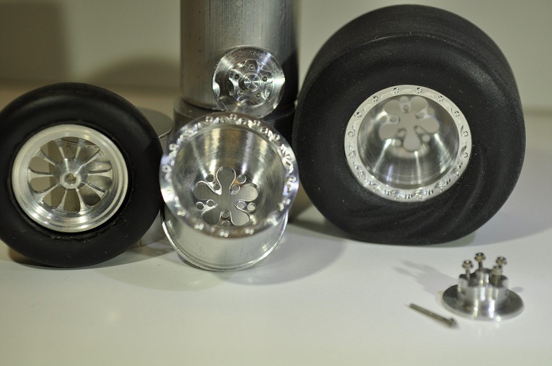

Codi Posted September 21, 2014 Author Share Posted September 21, 2014 Small update but boy they sure are pretty....got these Saturday from Jim @ MicroNitro. The new Weld Delta 1's and I ordered them with the drilled hubs for display purposes. Great product from a great company. I have threaded rod for the studs that I'll cut to length and flanged threaded nuts to secure em'. Cheers, Tim Quote Link to comment Share on other sites More sharing options...
turbo nova Posted September 22, 2014 Share Posted September 22, 2014 Nice, I may be able to own a set in 1/25, I priced a set for the race car WOW $$$$$$$$$$$$$$$$$$$$$$$$$$$$$$ Are you gonna leave em natural or do em black with the big delta stickers inside. That rotor and wheel are gonna look killer. Quote Link to comment Share on other sites More sharing options...
Mooneyzs Posted September 22, 2014 Share Posted September 22, 2014 Tim... those are some killer looking wheels. Jim does some nice work. Quote Link to comment Share on other sites More sharing options...
Codi Posted September 22, 2014 Author Share Posted September 22, 2014 Thanks Chris, I most certainly agree. J ames, I'm not sure yet...I'm going to polish the centers possibly and see how they look and then decide...a lot will depend on the final color of the car. If I go with a satin/flat black finish, then the polished wheels will likely look the best. Cheers, Tim Quote Link to comment Share on other sites More sharing options...
