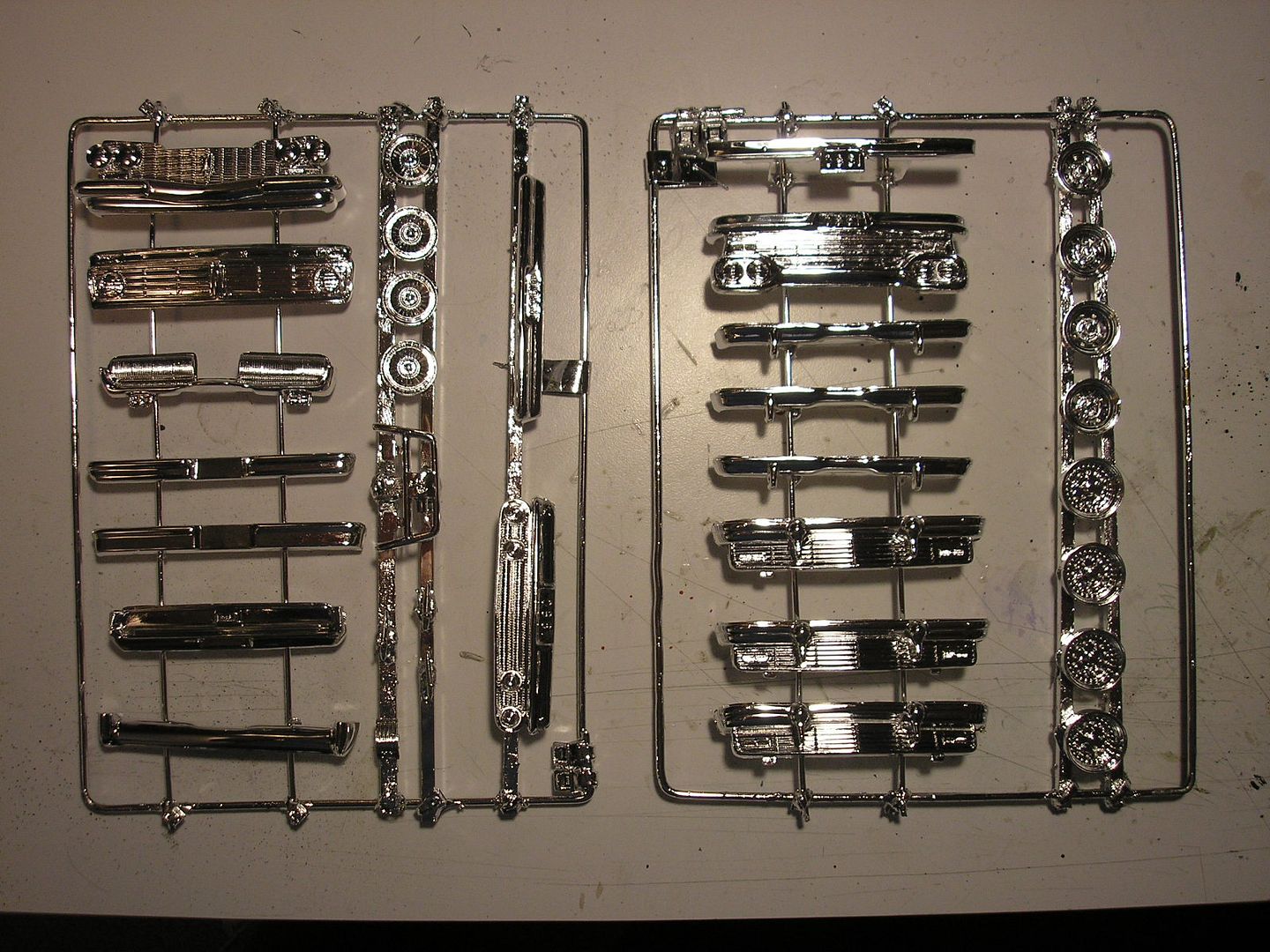

Art Anderson Posted September 16, 2014 Posted September 16, 2014 If you mean "chrome plating" of plastic model parts, there are only two that I am aware of in the US who do this. It's a very specialized process, called "vacuum plating" in which a micro-thin layer of pure aluminum is deposited, electrostatically (at least I think that would be the description) onto specially prepared plastic pieces (prepared by their being coated with a shiny lacquer surface), in a vacuum tank that is drawn down to a mechanically perfect vacuum. It's not something that any of us are likely to do at home, on our workbenches. Chrome Tech USA is Robert Shebilski in Wisconsin. Bob pulls together a run of parts that modelers send in, delivers them to a vacuum-plating shop which actually does the plating, then sends the plated parts back to his customers. The other vendor is Little Motor Kar Company, in Pennsylvania, who actually does the work in his own shop. Art

Maindrian Pace Posted September 17, 2014 Posted September 17, 2014 Chrome Tech: Alclad is nice, but it looks like polished aluminum. Nothing looks more like chrome than vacuum metallizing. -MJS
StevenGuthmiller Posted September 17, 2014 Posted September 17, 2014 I have all of my work done with Chrome Tech. They do very nice work. My only complaint is turn around time. The web site says 3-4 weeks. I've never recieved my shipment in less than 6. Many times it's approaching 2 months. Steve
Bob Ellis Posted September 17, 2014 Posted September 17, 2014 I had somebody in the Boston area do it for my model parts years ago. BTW, it's called vacuum metallizing and that is how you can search for those companies. The biggest problem may be that you might not be able to fill the minimum order.

Art Anderson Posted September 18, 2014 Posted September 18, 2014 I have all of my work done with Chrome Tech. They do very nice work. My only complaint is turn around time. The web site says 3-4 weeks. I've never recieved my shipment in less than 6. Many times it's approaching 2 months. Steve Steven, I've used ChromeTech many times in the past, and found that "timing" is everything: Robert takes in his run of plating somewhere in the neighborhood of once a month or so. If you can contact him, find out just when his next run will be, and how soon you need to get your parts to him, that cuts down the lead time considerably. Art
Bob Ellis Posted September 18, 2014 Posted September 18, 2014 Anthony, it's been a few years and I forgot the name. I just googled vacuum metallizing in Boston and it came up with a few companies. So, they are out there. Just call. I sent Chrome Tech business back in the '90s. I decided to find a local place later. Art is correct. Unless CT has the equipment, customer orders are batched together and sent to one of these vacuum metallizing houses.
