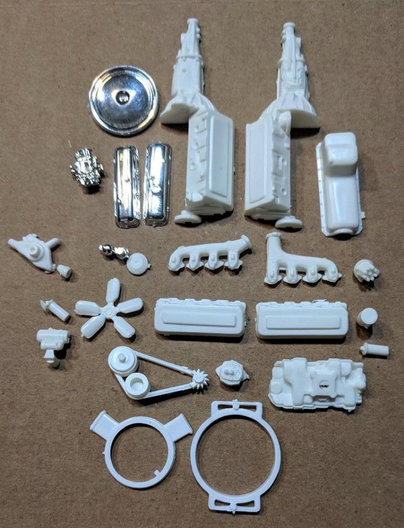

Here's a shot of the Revell '65 Chevelle Z-16's 396 Big Block Chevy engine parts:
