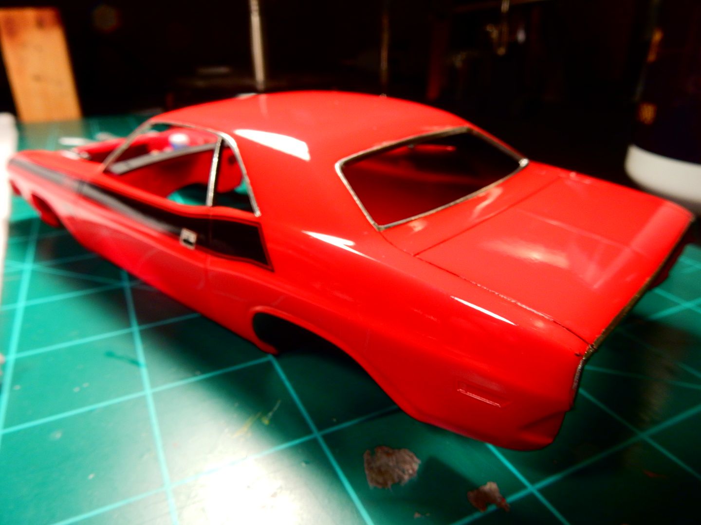

mustang1989 Posted February 11, 2015 Author Posted February 11, 2015 Thanks Tim and Jim! I did get some sleep last night. I already feel better! Not a whole lot of progress this morning. I got the windshield moldings and the R/H side drip rail moldings applied. We're gettin' there................

Mopar - D Posted February 11, 2015 Posted February 11, 2015 Joe your BMF is coming along nice and smooth with clean lines. Going to be a real sharp looking Challenger. Glad to see you are healthly again.
afx Posted February 11, 2015 Posted February 11, 2015 Looking good Joe. The blacked out cowl is sharp.

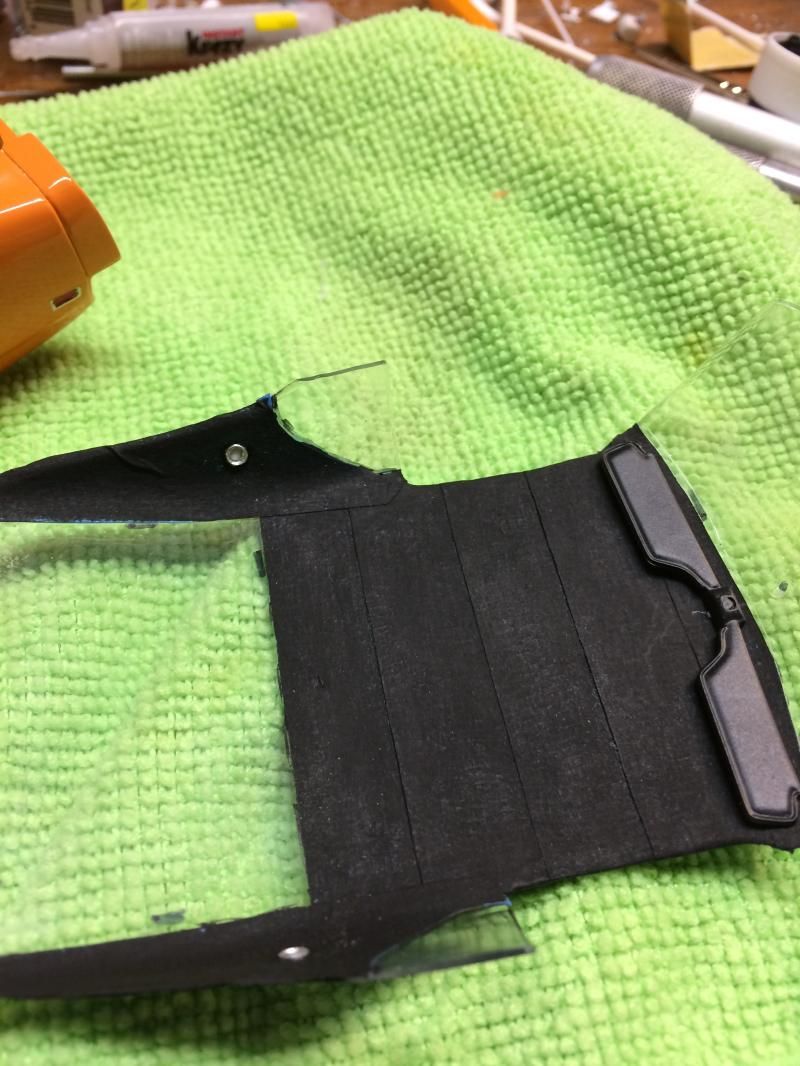

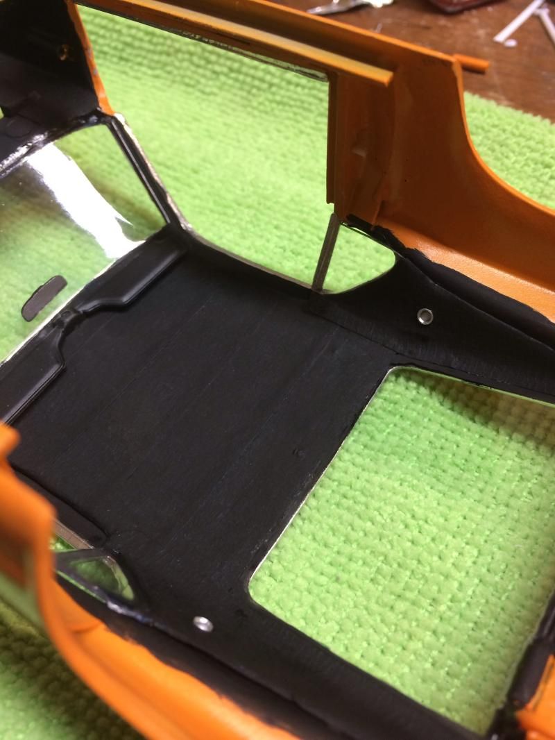

freakshow12 Posted February 12, 2015 Posted February 12, 2015 I've got something for you on the window assembly, a trick I've done a couple times. What I did here was cut styrene to fit in all the holes of the glass setup. Glue it all in and smooth it out, then I used masking tape and overlapped it where the top bows are. I just used pictures of the 1:1. I added the courtesy lights and visors.
mustang1989 Posted February 12, 2015 Author Posted February 12, 2015 Thanks for the tip Fred! Took me a minute to look at it all and figure it out but I've got it!
