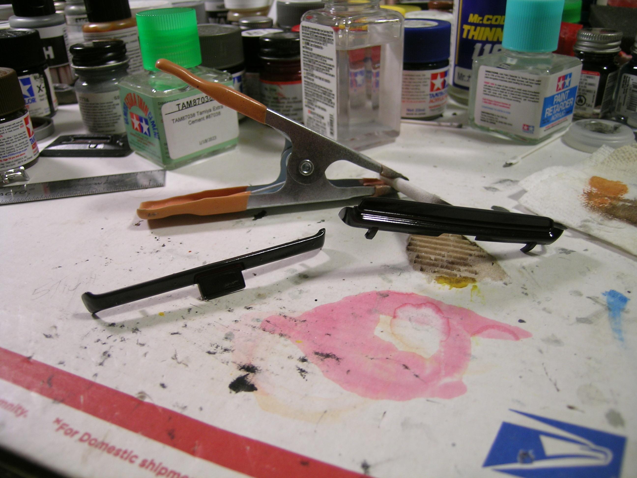

Roadrunner Posted October 18, 2023 Author Posted October 18, 2023 Bumpers stripped, sanded and given a base coat of Tamiya gloss black lacquer. I’ll hit them with Alclad chrome tomorrow, or perhaps later tonight. (Fingers crossed.)

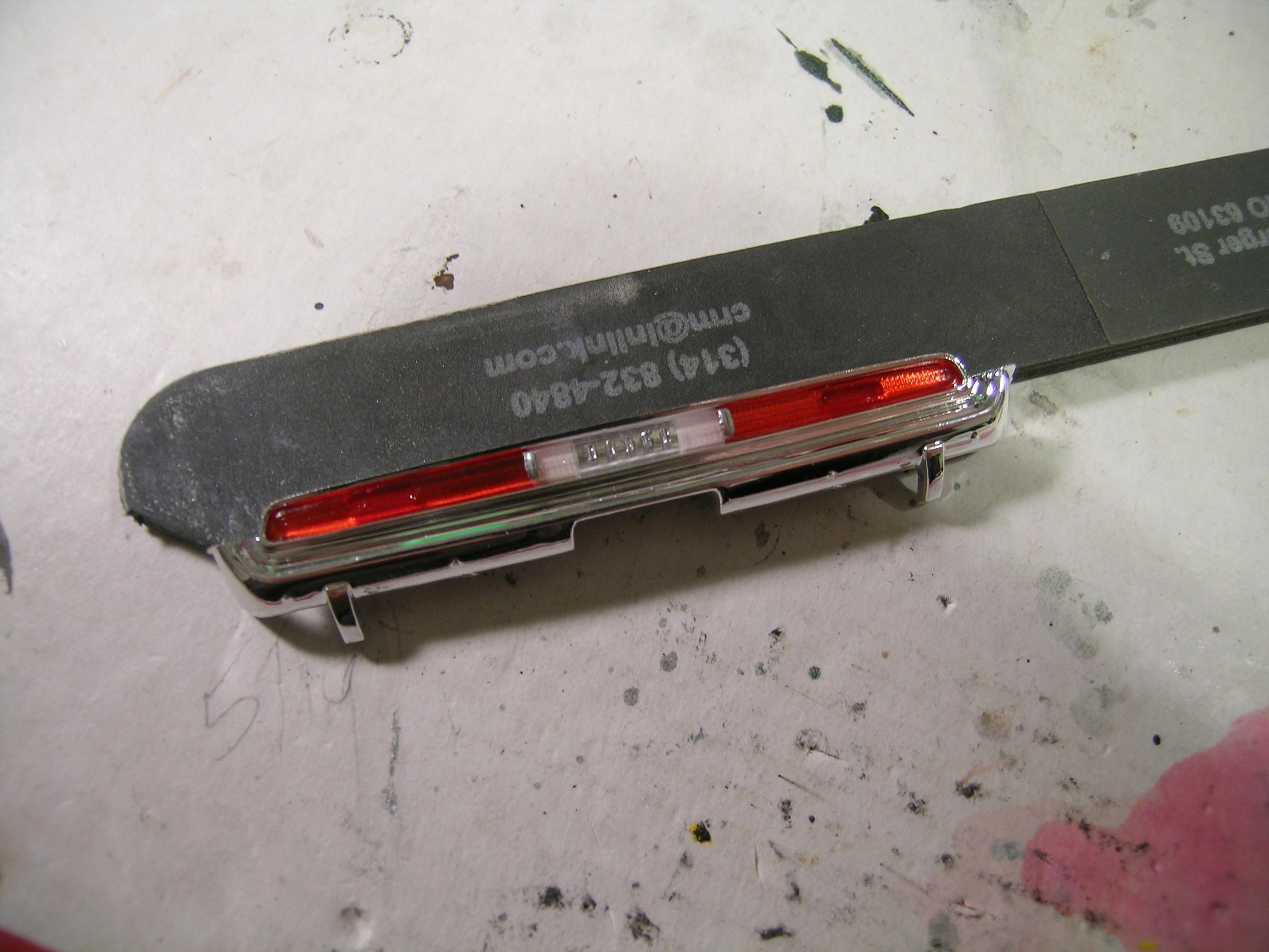

Roadrunner Posted October 18, 2023 Author Posted October 18, 2023 Painting the Dodge letters on the tail light with Molotow really stumped me (the letters are really delicate), but I finally figured out a way to do it. Here is the result. This may or may not really show up well on the finished kit, but I certainly hope it does. 3
atomicholiday Posted October 18, 2023 Posted October 18, 2023 That looks excellent! How’d you manage it? 1
Roadrunner Posted October 18, 2023 Author Posted October 18, 2023 11 hours ago, David G. said: Dang! That came out great! David G. Thanks a bunch. It still needs some minor tweaking, but if my luck continues to hold, it'll turn out just fine I think. 1 hour ago, atomicholiday said: That looks excellent! How’d you manage it? I created a flat stamp out of plastic bits, smeared a layer of chrome on it, and just stamped the letters. Still a teeny bit of cleanup needed with alcohol, but should work out just great. 2
