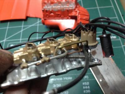

jaftygas Posted January 3, 2015 Posted January 3, 2015 Well, I hope I will have the time to do this. Quite a while ago my 1/12th corvette took a spill off of the TV, and my 1/12th scale Z28 has been staring me down for, oh 15 years! So I thought I would do a motor swap and wheel change and do a COPO Camaro. I know it won't be perfect, but here her goes. This is the kit.this is the donor.seems such a waste, because the tri power looked really cool.?

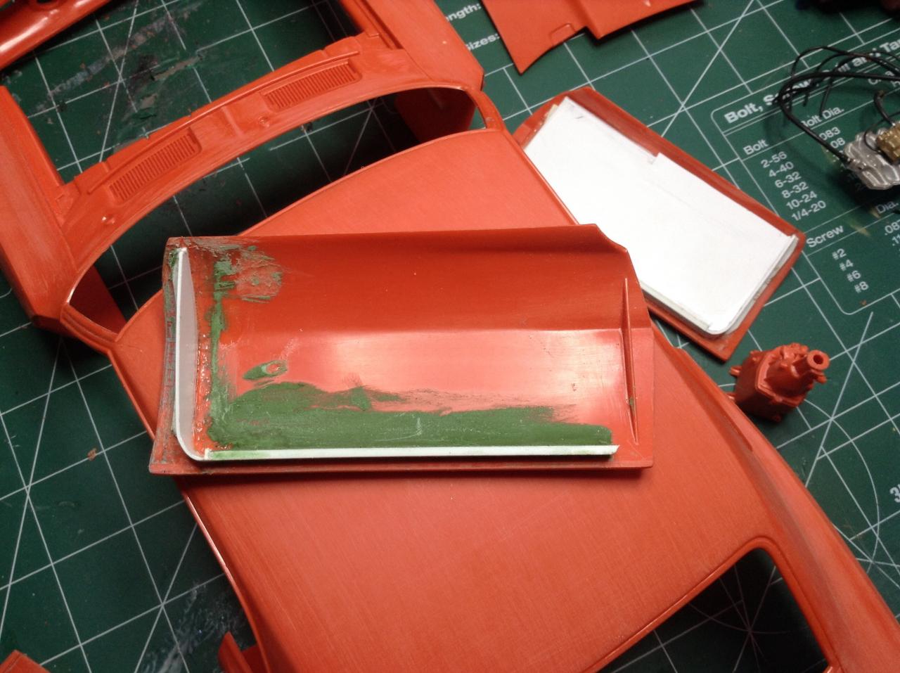

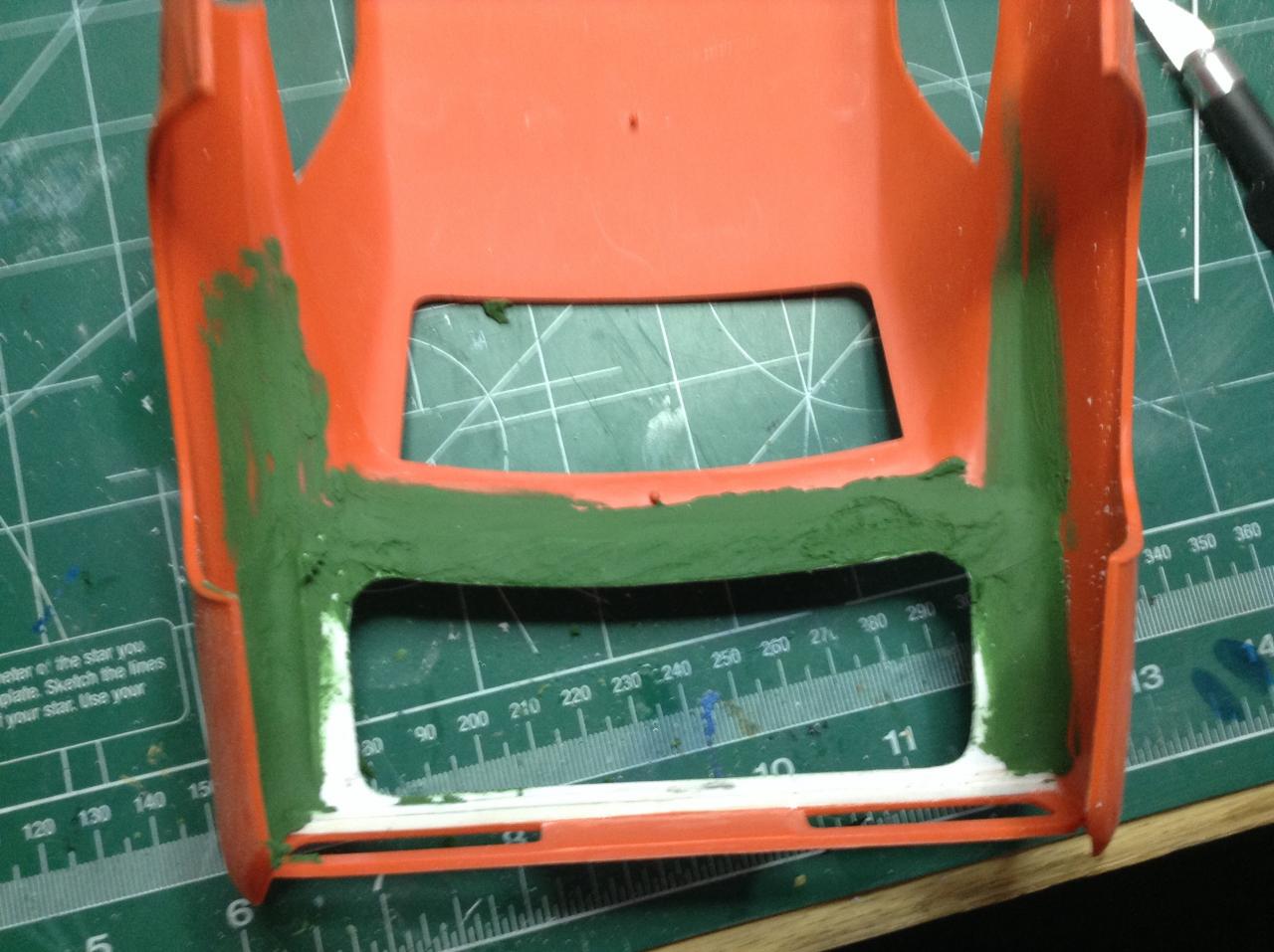

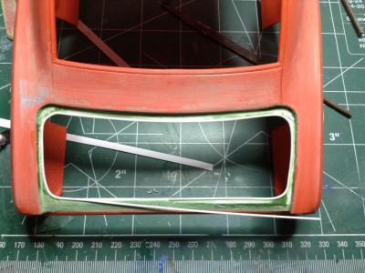

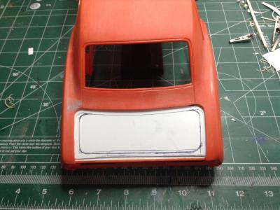

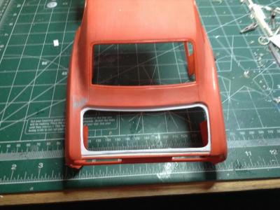

jaftygas Posted January 3, 2015 Author Posted January 3, 2015 I started by cutting the trunk and doors open. Then I'm trying my hand at styrene work.

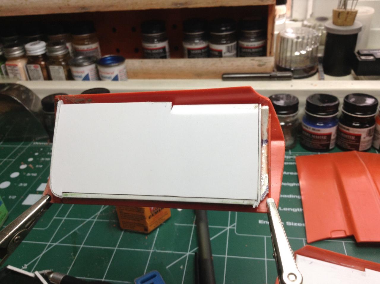

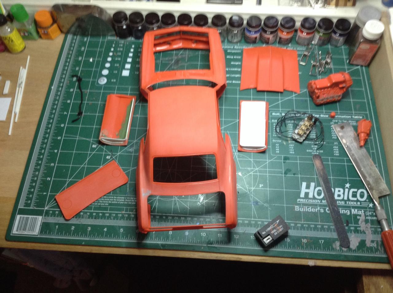

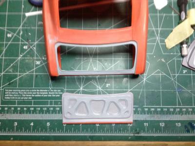

jaftygas Posted January 4, 2015 Author Posted January 4, 2015 Well worked on the trunk to day most of the day was spent making doors and trunk deck. Here's the drivers door core getting built I used .030 styrene sheet for the skin and .125X.060 for the jams. I cut out two of every thing and glued it all together with Tenx-7R solvent. Then I used dupli-color scratch and bent filler primer to seal them. Next is the trunk. Then I thought I would add a weather seal to the profile of the trunk with .035 round stock. That turned out, so I sealed it and I'm real happy with it. I think I will call it a day thanks for following. P.S thanks to Bill At the big boys for the reference pictures.

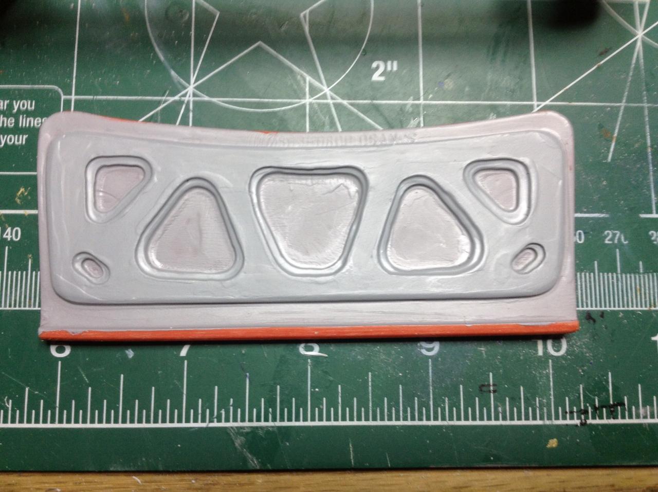

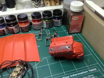

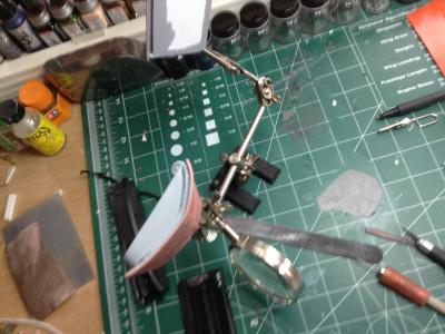

jaftygas Posted January 4, 2015 Author Posted January 4, 2015 Thanks Stan, and Jim I'm really having some fun today. Here is some more pictures of the trunk. Stay tuned I really need some ideas on how to do the door hinges.
