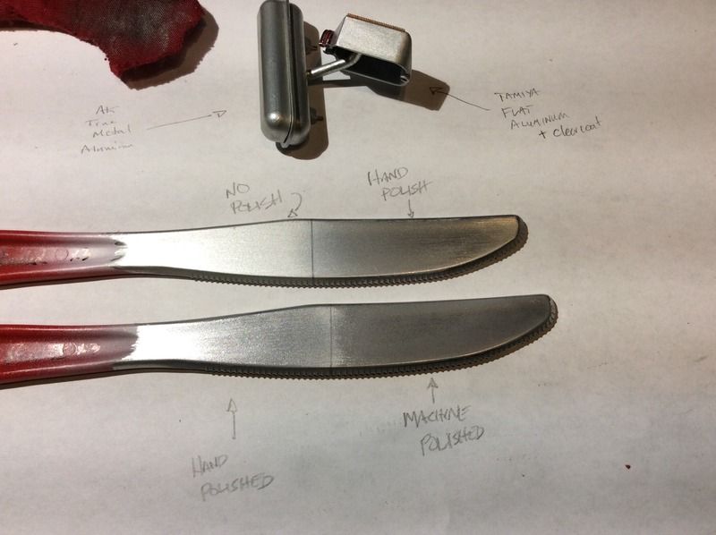

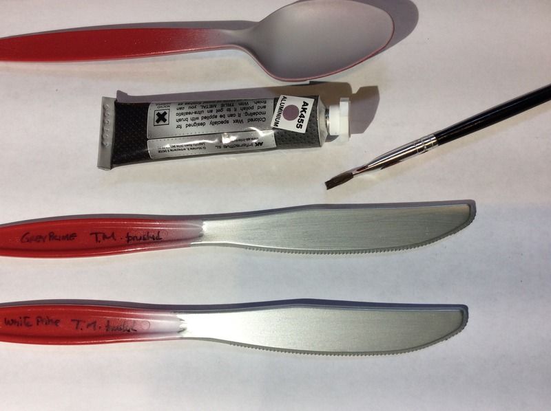

Twokidsnosleep Posted May 7, 2015 Share Posted May 7, 2015 (edited) I have some AK True Metal, it's awesome stuff, it's like Rub n' Buff but it actually dries and hardens and doesn't keep wiping off on your fingers. I've been using it over Alclad base coats to give them a more realistic look. It's transparent and will let the base color show through. You can put it on with a brush or q-tip or even your finger and you buff it up to give it a shine. You can even thin it down with thinner and turn it into a paint. I found that my True Metal Aluminum kept rubbing off on me As I polished, it stripped down through the primer.....hand polish even I wasn't super impressed, but maybe I did something stupid with it??? Three coats over primer After polishing and the control no polish area I love the way it paints and handles, but the rub off and lack of shine don't really justify it. Tamiya flat aluminum looks almost identical If I did something wrong, love to hear it, but this is what it did in my hands Edited May 7, 2015 by Twokidsnosleep Quote Link to comment Share on other sites More sharing options...
Brett Barrow Posted May 7, 2015 Share Posted May 7, 2015 As I said, I used it over Alclad on some natural metal airplanes I'm working on. I guess it works differently as the base coat. Front half of this wing has been done with the True Metal over both Alclad and AK's new Xtreme Metal. The Xtreme Metal works great too, it's really shiny. Quote Link to comment Share on other sites More sharing options...
Twokidsnosleep Posted May 7, 2015 Share Posted May 7, 2015 (edited) Yours looks great!! Hmm, maybe I will try it with the Alcald base...like the gloss black??? How long do you wait before polishing??? My tests were over Tamiya fine white and grey primers I have Alclad gloss black, Aclad white primer and Alclad grey primer as well to try out Edited May 7, 2015 by Twokidsnosleep Quote Link to comment Share on other sites More sharing options...
Brett Barrow Posted May 7, 2015 Share Posted May 7, 2015 I used Alclad aluminum under it. I think you need a metallic color under it as the True metal is very transparent. I just glopped it on with a brush right out of the tube and then with my bare finger started polishing it right away, rubbing until I feel the heat from friction in my finger. I think it's meant more for "punching up" other metallic finishes than to be used as a finish all on its own. Quote Link to comment Share on other sites More sharing options...
Twokidsnosleep Posted May 7, 2015 Share Posted May 7, 2015 Ahah, I will give that a try as well I did try it on the Tamiya flat aluminum of my F40 engine exhaust....meh, didn't shine up and looked a bit gloppy in the end Maybe I am just all sausage fingers Quote Link to comment Share on other sites More sharing options...
