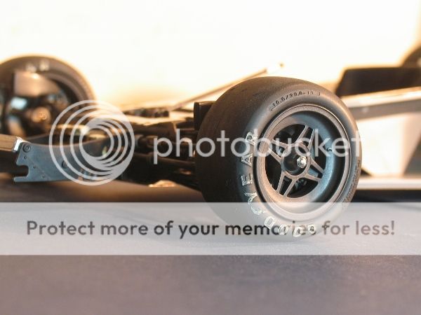

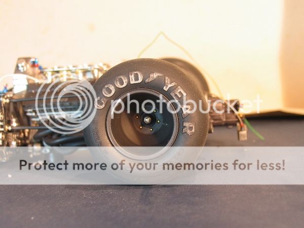

Belugawrx Posted June 3, 2015 Author Posted June 3, 2015 (edited) Sooo ...had a couple of rain days ..= bench time I was able to spend some time on the tires .... 100 grit took it down pretty quick.. then 250g to smooth them out...(CAUTION!!! older Tamiya kits are much softer, thinner rubber!!) Used Craft Smart (Michaels(cdn sp)) acrylic paint to pick out the GYear . Then hit it with Testor's Dullcote spray,... Washed with vallejo 76.517 WASH for dark Grey,..Let dry ..rubbed off the excess, hit again with dullcoat,... And....... Daddy's got a new pair of shoes! Post race dirty shoes , but,.... Ya Sitting on all 4rs It was awesome to spend some time actually modelling again after a long ,.... busy month. Thanks for looking in... Q, C, + C's are welcome Cheers Edited June 3, 2015 by Belugawrx
Belugawrx Posted June 3, 2015 Author Posted June 3, 2015 gotta swap out those tires ...the directional arrows are reversed...HAHAHA
Twokidsnosleep Posted June 3, 2015 Posted June 3, 2015 Good to see you got some bench time and progress made It is hard slicing out hobby time in life, but especially as the weather improves Keep plugging away when you can, it is always interesting to see this build Love the custom tire sanding jig...that is right up my MacGyver alley Cheers, Scott

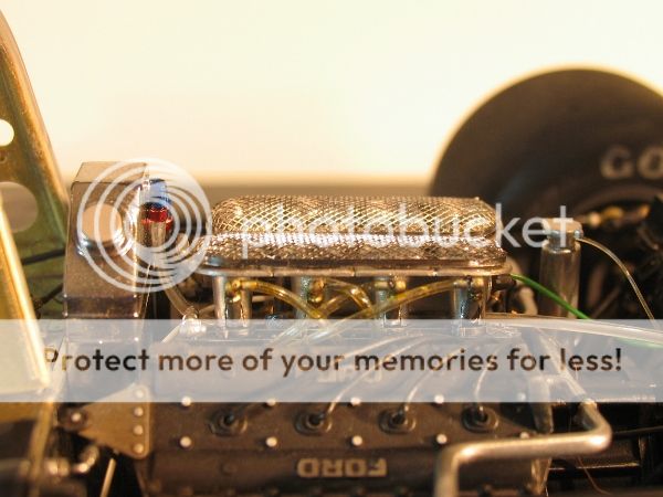

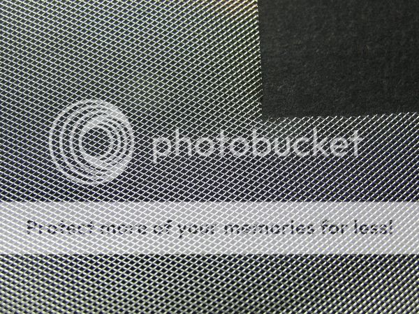

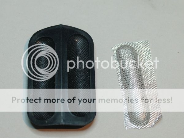

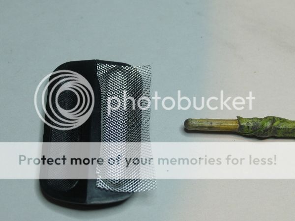

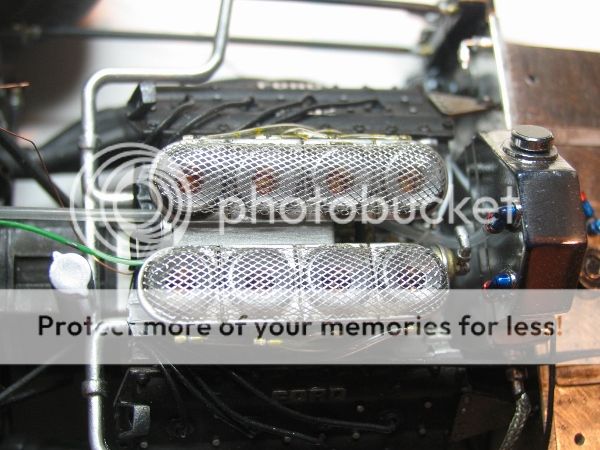

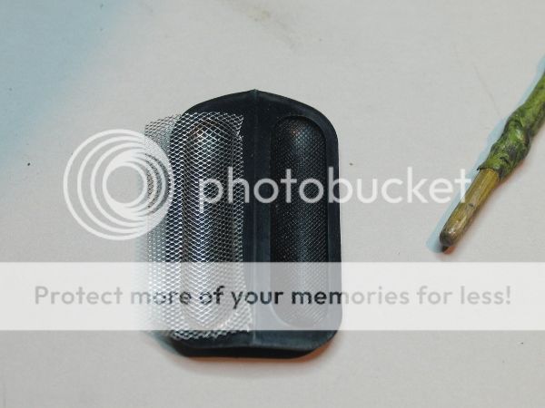

Belugawrx Posted June 11, 2015 Author Posted June 11, 2015 (edited) Thanks Scott, I tend to McGyver quite a bit in modelling lol Forgot I had this HO scale chain link fence material So I took the under scoop part And gently rubbed the screen into the cavity Flattened out the edges Trimmed off the excess And installed over the intake trumpets A little tweeking and a strip of BMF,..and weathered they will look ok I think Thanks for looking in Q.C+C's welcome Cheers Edited July 17, 2015 by Belugawrx
Codi Posted June 11, 2015 Posted June 11, 2015 Bruce, so good to see you back at it on this build. Love the new posts and progress. Your tire weathering skills are simply perfection. I swear I had to take 3 looks at em' to discern that they weren't the real thing. The best weathering of a tire I've ever seen, at least in our hobby. And the intake screens are of a similar quality. Now I remember WHY i always look forward to your posts. Cheers, Tim

LaughingIndian Posted June 24, 2015 Posted June 24, 2015 And installed over the intake trumpets A little tweeking and a strip of BMF,..and weathered they will look ok I think Thanks for looking in Q.C+C's welcome Cheers I like the screens over the intakes Bruce ... but what did you BMF?

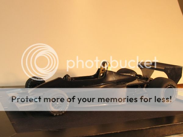

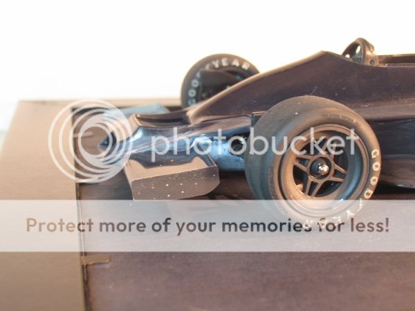

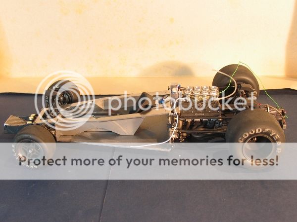

Belugawrx Posted June 28, 2015 Author Posted June 28, 2015 Hey Scott you'll love that kit! Mike I applied a strip around the bottom as a cinch So, a couple of rain days Started on the body panels Much sanding, filling, sanding, ad nauseum... Got the wing dry fitted to check lengths of hoses and wires Now I can start on the paint,...as soon as I can find some Tamiya TS-55 and the gold... I also need to figure out an attachment method for those side pod panels, I need to squeeze them with about 10lbs pressure to get them to close up to the top panel.... Anyway building on Thanks for looking in Q,C+C's welcome Cheers
Codi Posted June 29, 2015 Posted June 29, 2015 Bruce, just love that 2nd pic of the side profile of the car and of course, pic 4 of the rear / wing. That was always one of my favorite gran prix cars of the period. It just looked "right". And it was quick to boot. You're doing this build justice. I remember going to the gran prix in Montreal in the 70's on a few occasions and just had the time of my life. Cheers, Tim
Cato Posted June 29, 2015 Posted June 29, 2015 Bruce, magnificent job. Don't rush a thing. Tim is right, one of the most beautiful F-1's ever - all business. The modern ones look like transformers next to this. They just don't have 'IT'. For that panel fit, don't leave things in tension. Sand away inner surfaces or detail if you have to. Consider making new ones from .005 ally or brass. If you get the relief, consider mini magnets to hold closure. Some are very powerful. Show us what you come up with. C
youngtiger1 Posted June 29, 2015 Posted June 29, 2015 Ah, totally cool tip on the HO scale chain link fence. I'm no race care expert but it looks very realistic to me.
