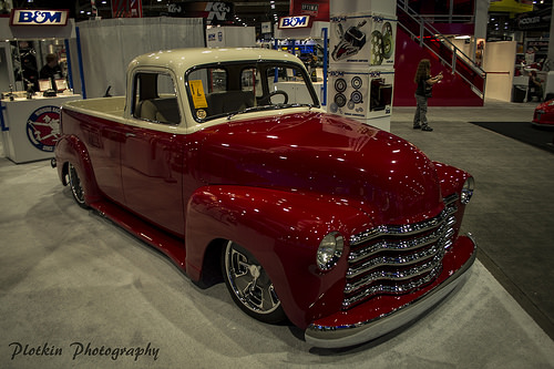

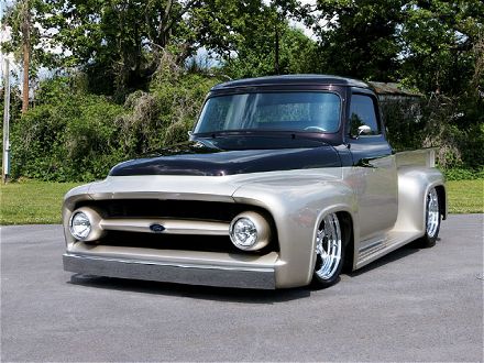

taaron76 Posted March 14, 2015 Author Posted March 14, 2015 Thanks for all the comments and tips. I can already see that I'm going to have to tub the rear just a little in order to get the wheels I plan on using to fit. I may use the tonneau cover that comes with it, so that would potentially hide that anyway. Decisions, decisions... Out of the box, there is an ample amount of flashing on the parts and pieces. Nothing a sanding stick can't take care of, but just a lot more than what I'm used to seeing. I do like the fact that you can build three different builds of your choosing, which makes for some nice options. I'll definitely go with the custom engine and bumpers. This is the color combo I was going to go with for my '62 Impala build, but went another direction. Here are more color options; Black top/Titanium silver bottom Metallic teal top/Titanium silver bottom I'll make my mind up, eventually. lol Tim
