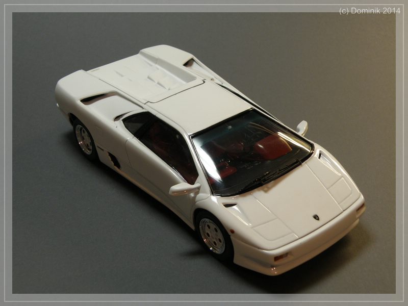

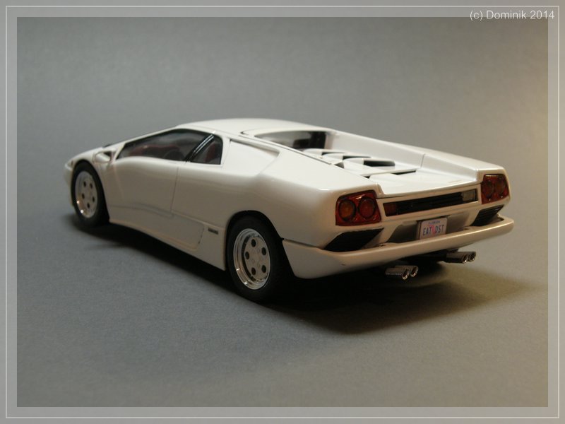

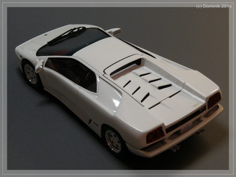

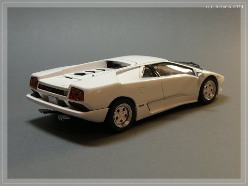

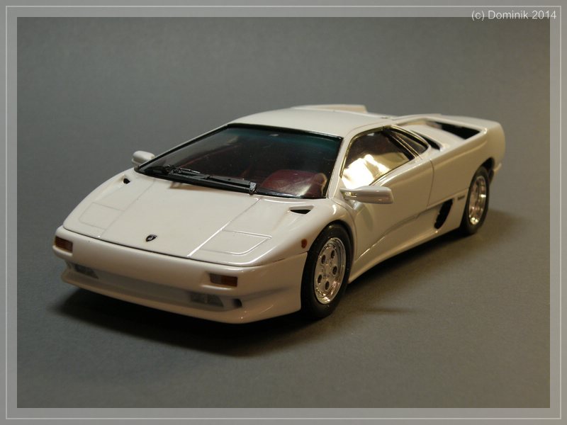

Dominik Posted March 23, 2015 Share Posted March 23, 2015 Today something new from my cars i built...last year...,unbelivable Lamborghini Diablo from italeri. Nothing special done, the rear wing i didn't mounted it. I like it more without that thing... enjoy comments welcome as always. feel free to say, what you think Quote Link to comment Share on other sites More sharing options...

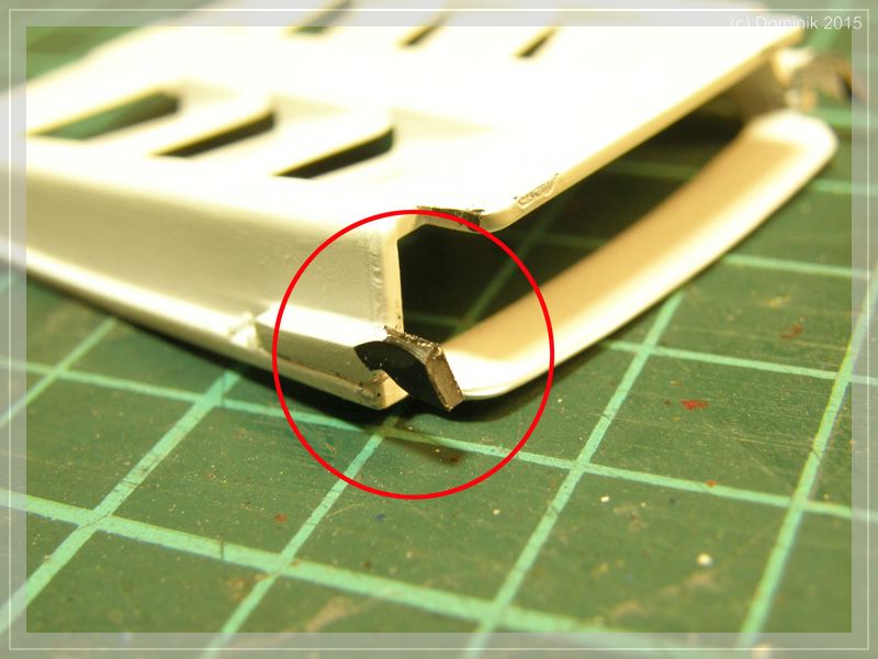

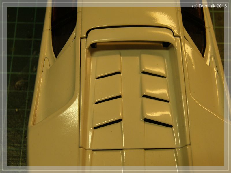

Dominik Posted March 24, 2015 Author Share Posted March 24, 2015 (edited) Thank you very much for comments. Looks good. I have one I'm finishing up but had a an issue getting the engine hatch to fit after the chassis was in. Did you have any issues with yours? Bob, i think you talk about those lousi hinges from the hatch, wich were mounted between the Body and chassis. I had some more Problems after it was painted. the paint was (think so) to thick and so it would not fit "perfect" like before as i made some fittingtests and sanded the Body. I thinned out those round hinge-pieces wich were slip between the Body and Chassis. the second was, i shortened the hatch on the rear side (to the back of the car) just a Little bit to have more space on the roofside while opening it. Understood, what i mean? I can make a Photo from the manuel, what i have made / what i mean. I must take a look on it, if there are more changes i made while mounting the hatch. That's gorgeous! Is it like a pearl white? Thank you Hugh, the paint is pure White with a couple of clear coat. i think, i painted three or for layers of clear coat because the dust... painted, wet sanded, painted, wet sanded and so on... Edited March 24, 2015 by Dominik Quote Link to comment Share on other sites More sharing options...
bobthehobbyguy Posted March 24, 2015 Share Posted March 24, 2015 Thanks I understand what you are saying. I had to trim the hinges and the rear bulkhead on the interior to get it to fit . Didn't want to trim the hatch as I didn't have any paint left for touchup. Quote Link to comment Share on other sites More sharing options...

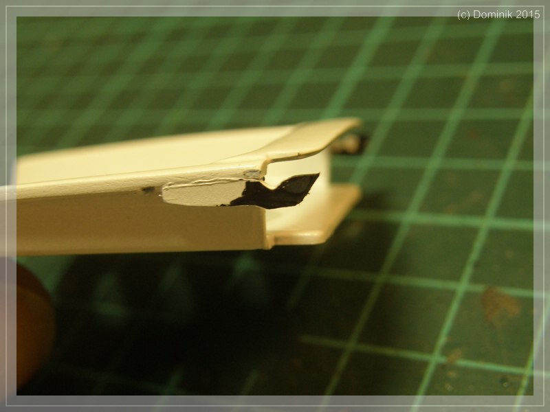

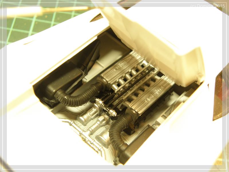

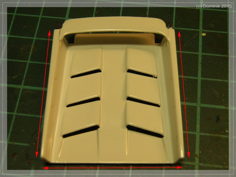

Dominik Posted March 24, 2015 Author Share Posted March 24, 2015 Thanks Joe and Chris Bob, i made some pictures from the hatch. here you can see the hinges, how much styrene i removed: as i took a look to make this pictures, i saw, that i sanded all sides on the hatch: to make it "perfect" fit: because, the paint was really thick...i removed the paint after the last lay of clearcoat and painted it after it fits white again. the good thing is, while i thinned that hinges that out, i can lift up the hatch on the rear side and pull it a little back to open it without damage the paint. also it can be closed this way with a cool "click". by the way, i made a picture from the stock engine: thanks again Quote Link to comment Share on other sites More sharing options...

caapa Posted April 1, 2015 Share Posted April 1, 2015 Hey Dominic - your Diablo is a gem ! The plastic kit manufacturer seems to forget that the body and the hatch (or bonnet or doors) shall be painted inside too. That makes a difference in thickness 0.1 - 0.2 mm (if you use primer and clear coat too may be even more) both sides. If you want to close there is about a half mm difference in thickness very near to the hinges. The result: the hatch don`t close. You solved the problem perfectly. Quote Link to comment Share on other sites More sharing options...
