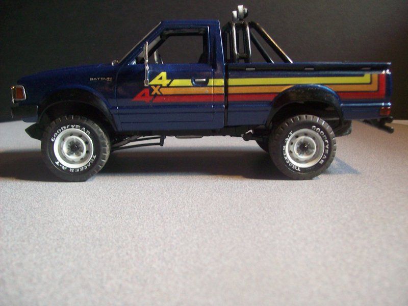

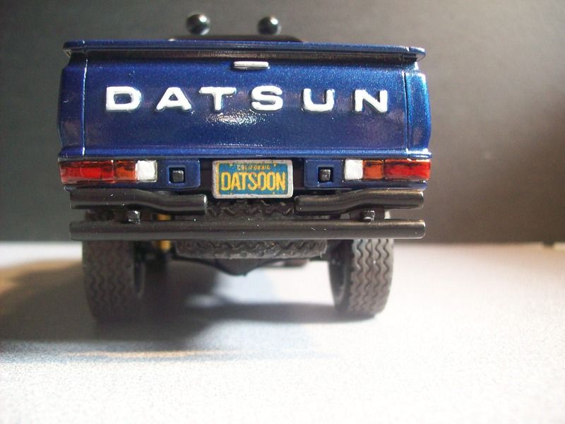

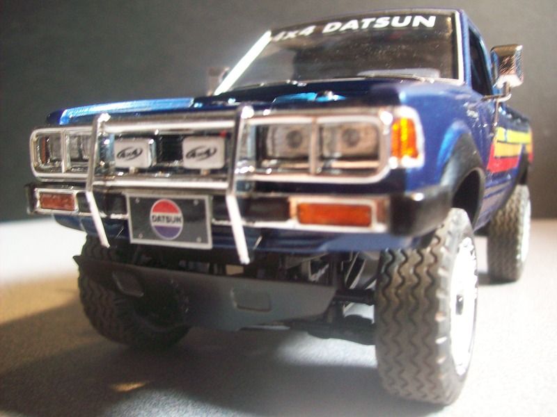

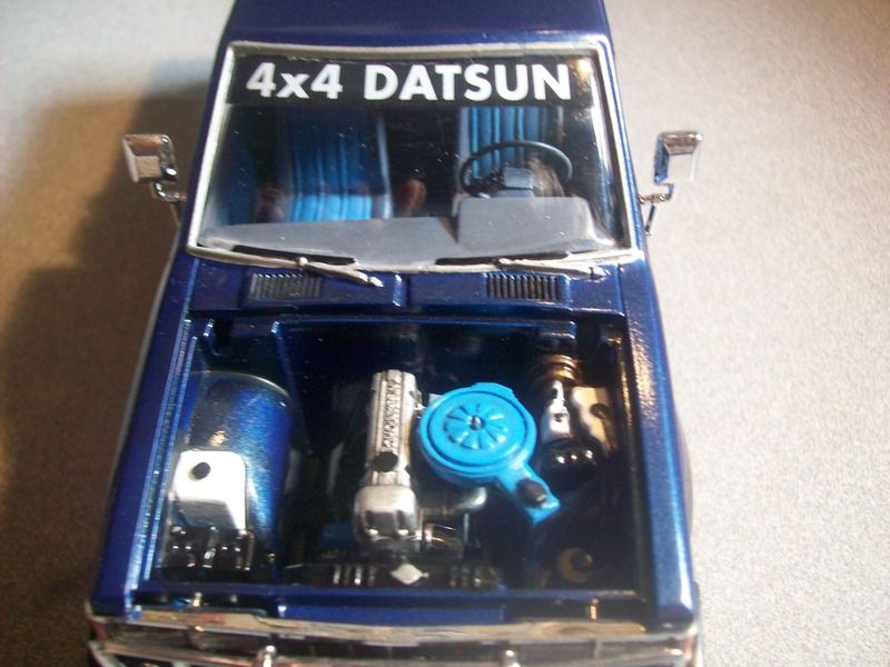

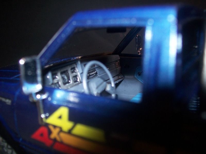

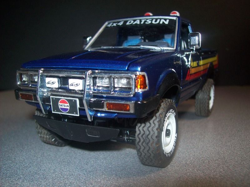

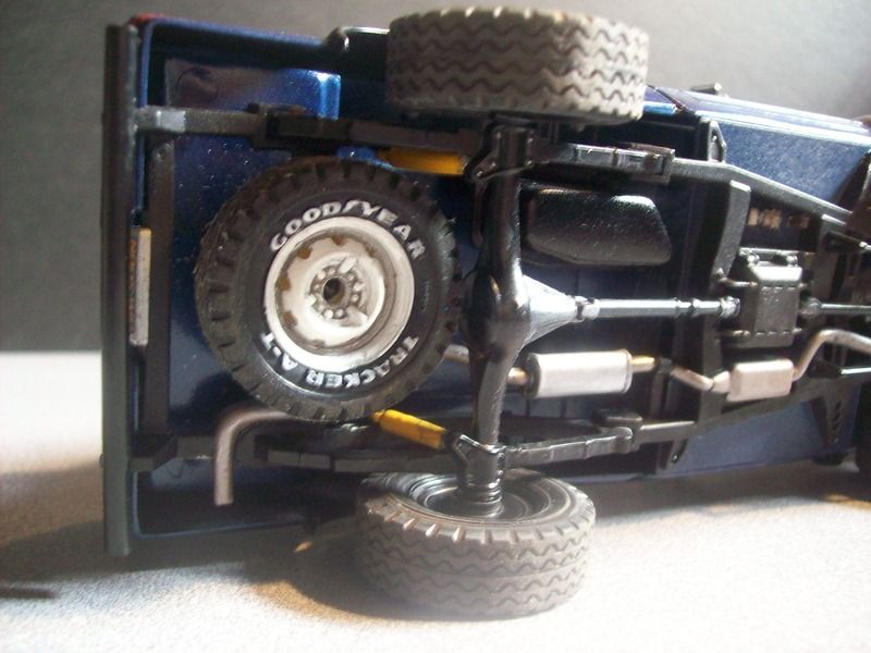

Zarana-X Posted April 12, 2015 Share Posted April 12, 2015 (edited) Finished the Datsun. It gave me more issues than I care for. The decals didn't adhere well, so I used Future to make them stick. Then the chassis wouldn't sit flush, because the interior was hitting the windows. So, I had to clearance the windshield, and the tab that held the interior tub to the body, in order for the chassis to sit flush. And I broke the shocks and spare tire off during my repeated test fittings. Save yourself some trouble, and just cut off the locating pin for the windows and interior tub. Then shave off the tab for the tub. I also had to shave down the windshield because it was hitting the dashboard. All of these were making the floor of the chassis stick out past the bottom of the body. I got it where it sits flush. Glad I spent the extra time to detail the Datsun script on the grille , also added a radiator. You cant see it, but there's an opening behind the bumper, if I didn't add it, you would see the fan. You can sorta see the Datsun script here. The holes in the skid plate should be actual holes, but its a mounting point on th emodel, otherwise I would've opened them up. Distributorless engine, not really enough room to add one, either. I did add a carburator, but you can't see it anyway. Added a rearview mirror. Replaced blob with an actual spare tire. (yeah, I know it has lugnuts in it still, I'm not that good) and added shocks. For whatever reason, there's a pretty big gap behind the cab, and roll bar, so I made it a double tube to fill in the gap. Added the license plate from the original release. The taillights are molded into the body, that's one of my bugaboos. Tried to shade them, but I have mixed feelings how it turned out. Edited April 12, 2015 by Zarana-X Quote Link to comment Share on other sites More sharing options...
mikemopar70 Posted April 13, 2015 Share Posted April 13, 2015 It Turned out a pretty Little truck... Quote Link to comment Share on other sites More sharing options...
Daddyfink Posted April 13, 2015 Share Posted April 13, 2015 It came out great! Nice build!! Quote Link to comment Share on other sites More sharing options...
