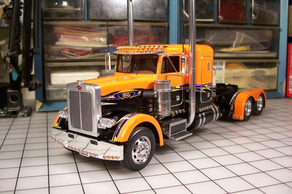

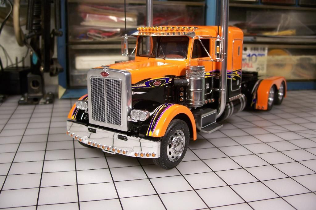

Petetrucker07 Posted July 18, 2014 Share Posted July 18, 2014 That is awesome. I like the flush deck plates. It looks great. Good job Quote Link to comment Share on other sites More sharing options...
Jim B Posted July 18, 2014 Share Posted July 18, 2014 That's a really slick looking paint job! Quote Link to comment Share on other sites More sharing options...
Pavel A. Posted July 18, 2014 Share Posted July 18, 2014 Great work Mark. Awesome! Quote Link to comment Share on other sites More sharing options...
Mr mopar Posted July 18, 2014 Share Posted July 18, 2014 (edited) All I can say Mark is WOW nice work ................... your work inspired me to do more detailing on my trucks thx. Please tell me that you will put a sunvisor on this and where did you get the decals? Edited July 18, 2014 by Mr mopar Quote Link to comment Share on other sites More sharing options...

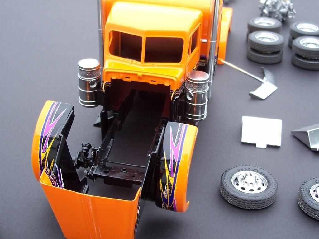

Rigzndiesel Posted July 18, 2014 Share Posted July 18, 2014 Mark, This is amazing work! I can't get over the (Alclad) chrome wheels, stacks and breathers! That came out really bright and shiney! The paint job is really eye catching and resembles a today's (2010s) paint scheme. This is real inovative and inspiring work...great stuff. Jeff Quote Link to comment Share on other sites More sharing options...
purepmd Posted July 18, 2014 Author Share Posted July 18, 2014 (edited) Thanks, everyone, for the kind words. Doug, I did make a custom, stainless visor for it. The decals are from Slixx. It is one of the graphic sheets they sell. Jeff, the trick to the alclad, or spaz stix, is very low pressure; 8-10 psi, and such light coats that you cannot even see the mist. You have to watch the part very closely to see the shine to appear. Then lots of coats, about 25 to 30 got this level of reflectivity. After a few hours in a food dehydrator, polish gently with a dry Q-tip. Takes lots of time. I created a Photobucket account, and you can see it in the background. Edited July 18, 2014 by purepmd Quote Link to comment Share on other sites More sharing options...
tbill Posted July 18, 2014 Share Posted July 18, 2014 this thing is saweet! love the paint job, holy smokes that's pretty!! great work with the alclad as well, and thanks for the tips on applying it. Quote Link to comment Share on other sites More sharing options...

Petetrucker07 Posted July 19, 2014 Share Posted July 19, 2014 Mark i just noticed the paint scheme inside the hood, now thats an area often over looked. Usually un painted or over sprayed or painted a basic color. You brought the whole thing under the hood. Great job. Quote Link to comment Share on other sites More sharing options...
purepmd Posted July 19, 2014 Author Share Posted July 19, 2014 Hey Clayton, Thanks for the compliments. As to the Alclad base, these parts were covered with the Alclad black base. I have done some tests with Gloss and Flat white, and gloss gray, acrylic and enamel black. I believe that, because of the extremely light coats I apply, it will stick to about anything. The big concern is that it be smooth. The gray baseworks the best for the Alclad Airframe Aluminum, while flat white gives a finish almost exactly like the JetHot coating on exhaust headers. A very cool effect. The Alclad black base is very easy to spray and covers very well in just a couple of thin coats. When they say to let it dry overnight, they are not kidding. I was in a hurry once, and tried to recoat it after only about 3 hours, and it looked like Testors silver. It would not get shiny. I also use a food dehydrator on all my paint jobs now, even Spaz Stix and Alclad. It makes a great difference in how smooth the paint flows out, and how hard it gets. With a little practice, I think you will like the results. Good luck. Mark. Quote Link to comment Share on other sites More sharing options...

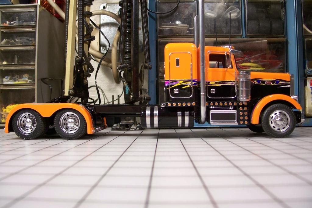

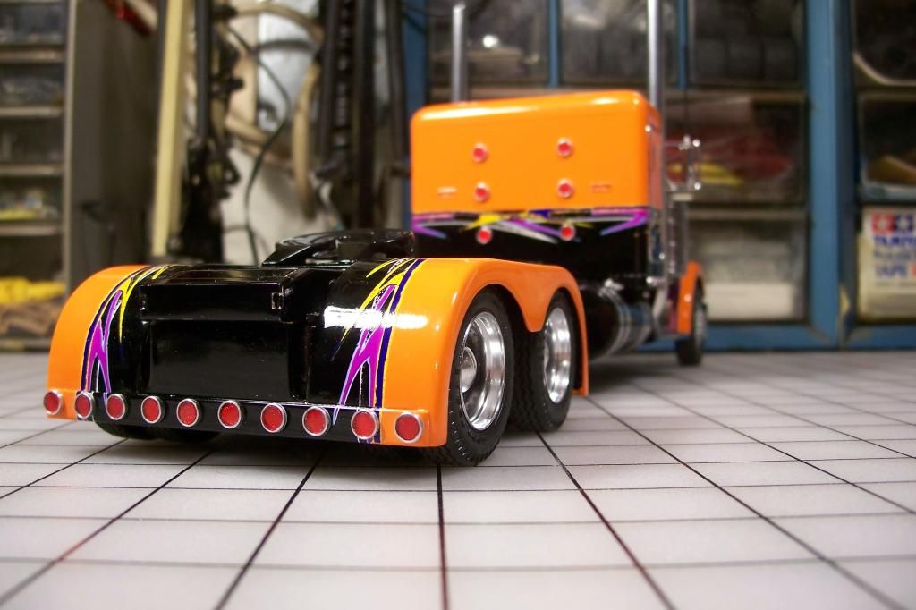

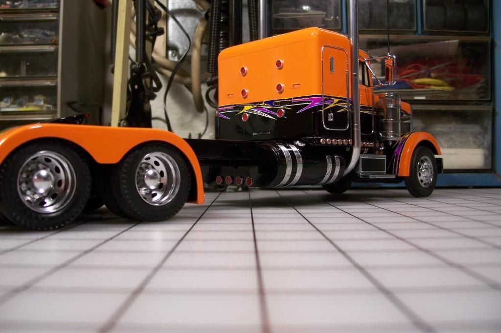

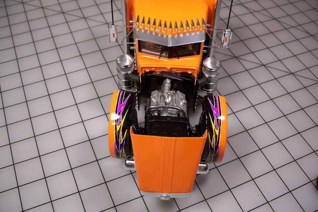

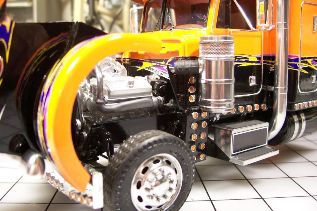

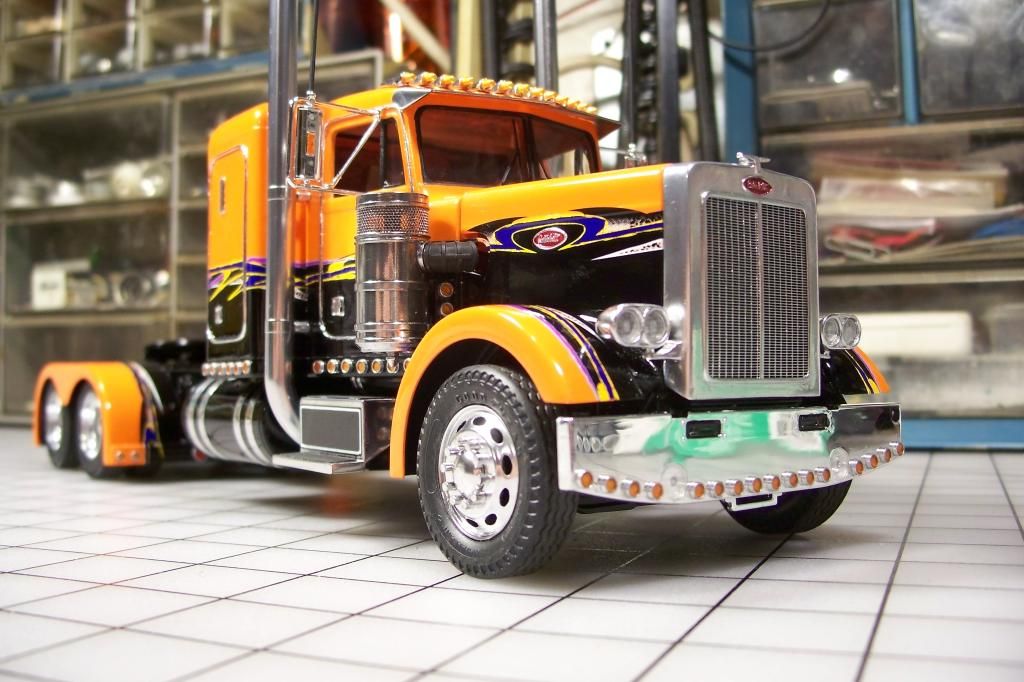

purepmd Posted February 1, 2015 Author Share Posted February 1, 2015 Hey Guys, It has been a while since I have had anything to post. 2014 was a very tough year, but I have made some progress of late and I would like to share some pictures with you all. I have to finish the exhaust, intake piping, air lines, and driveshaft and I am calling it quits on this one. Here is the photobucket links; Quote Link to comment Share on other sites More sharing options...
Petetrucker07 Posted February 1, 2015 Share Posted February 1, 2015 Holy Cr@p. This is just awesome. This looks outstanding. Very well done. Quote Link to comment Share on other sites More sharing options...
kilrathy10 Posted February 1, 2015 Share Posted February 1, 2015 She came out a might nice.....Just beautiful.....Excellent job.....The whole thing just hits you in the face with awesomeness..... Quote Link to comment Share on other sites More sharing options...
