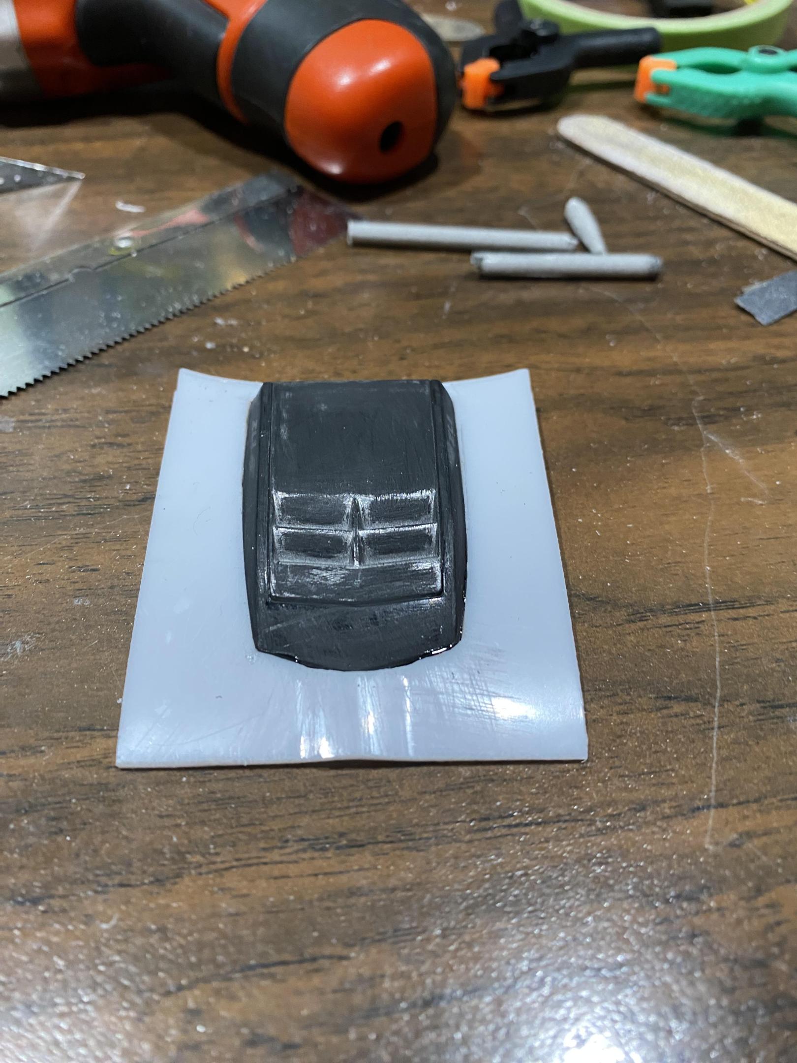

Joe Handley replied to Joe Handley's topic in WIP: Model Cars

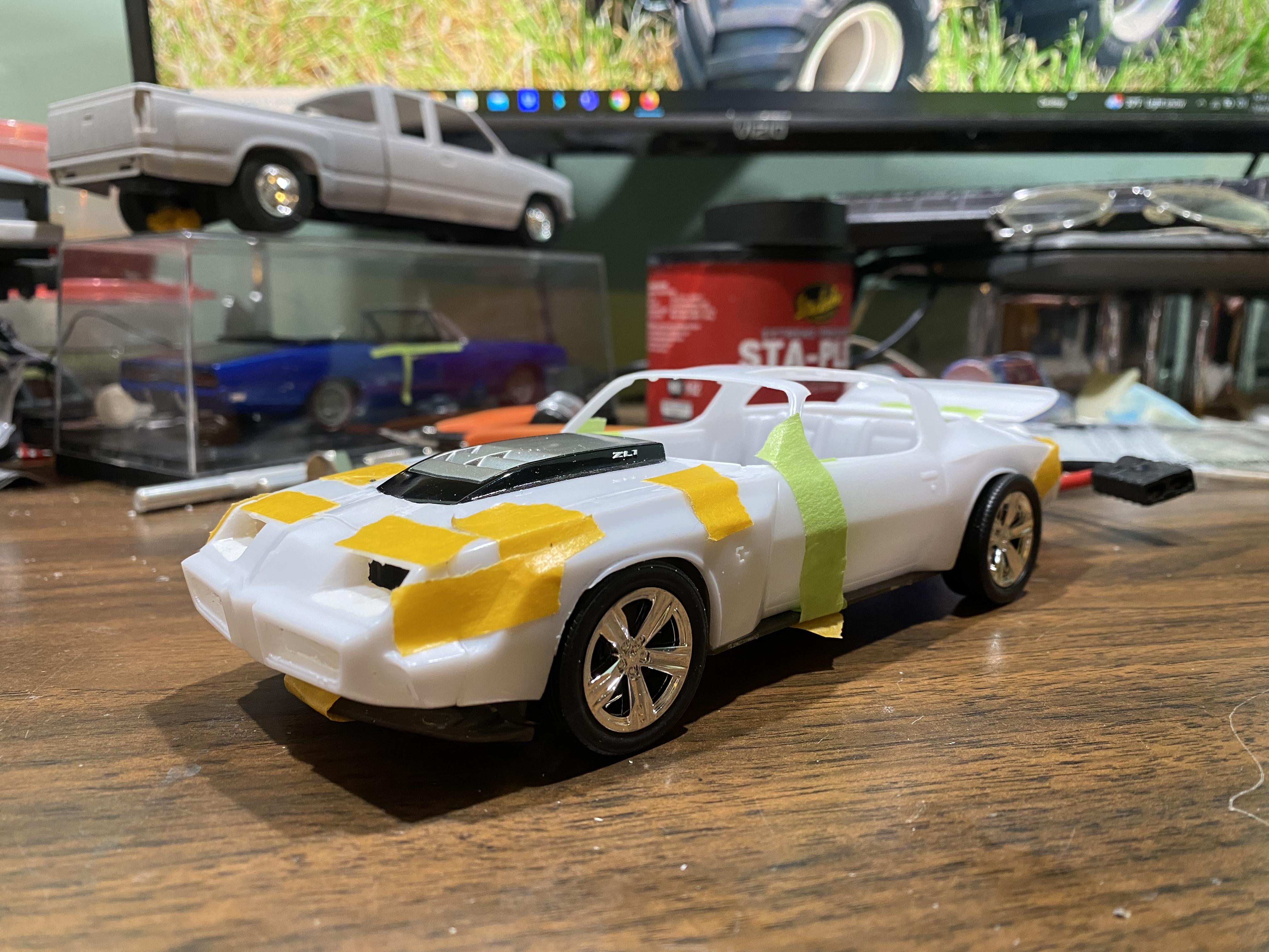

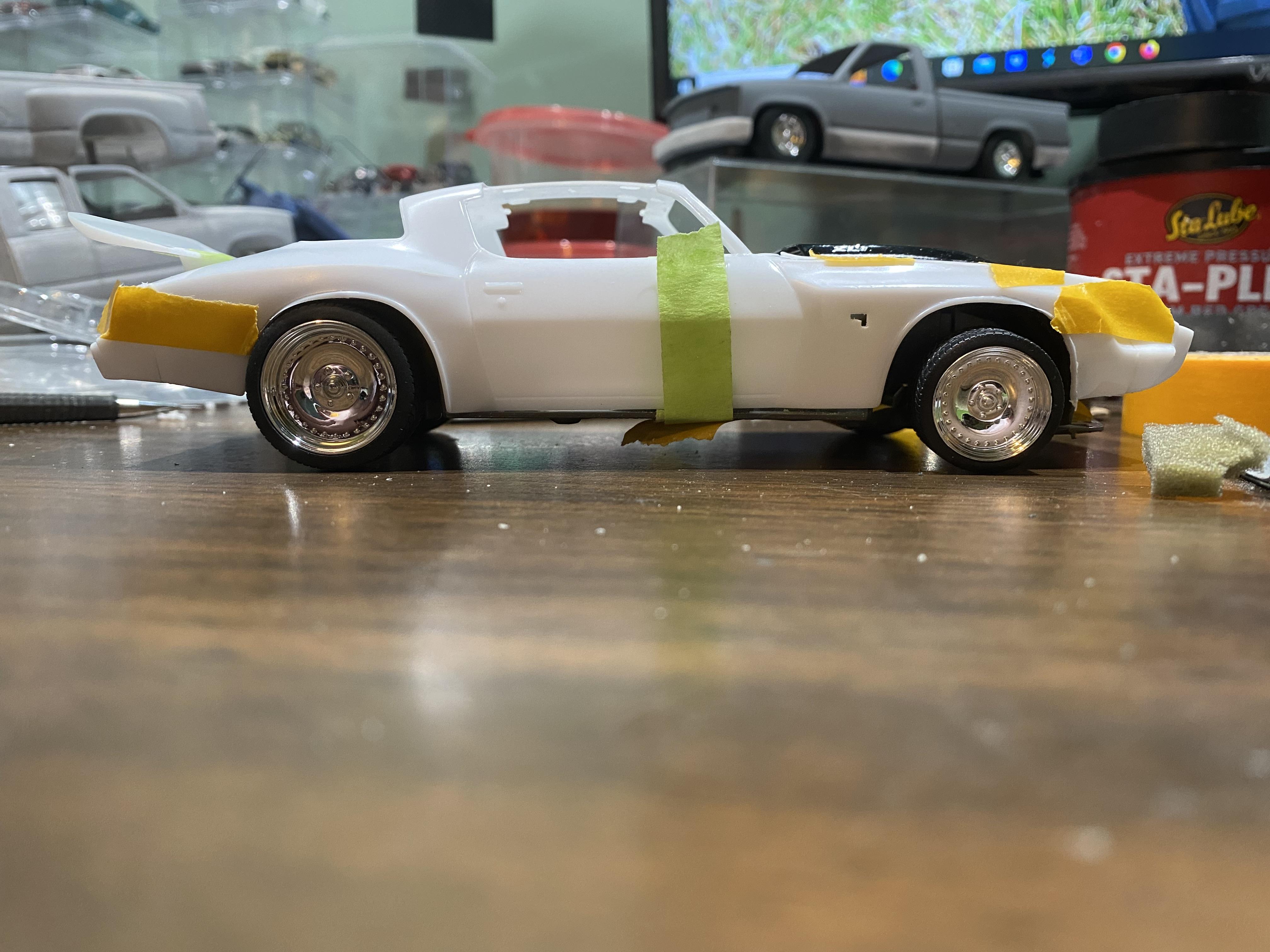

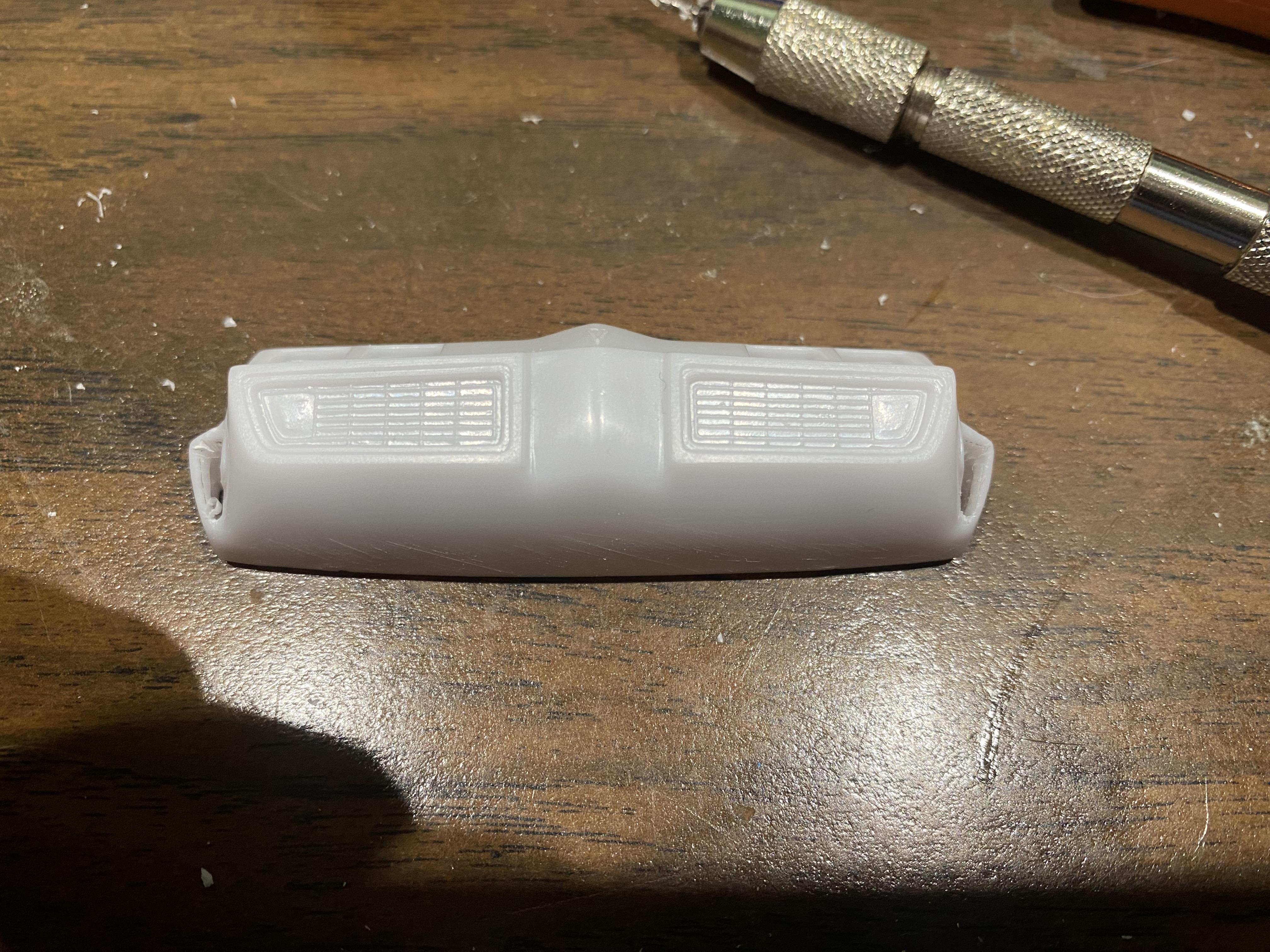

Messed around with the fillers tonight need to do more work on the openings, need to do more work on the new openings but it looks like I had the right idea for what I did. There was one gap that still needed filling after I took the above pics, so I took an extra scrap of the .020” that I used in other spots. Not sure if I’m going to use the UV filler, Tamiya White Putty, or the 2 part body filler I used for a lot of the filler on the quarters on the Charger convertible. -
Almost unexpected, know somebody who melted the nose off a Revell WW2 bomber using Squadron putty, he was unaware of the toluene solvent in it and being something that would melt plastic if applied excessively. I had a similar experience, but not that bad at the same time.
Did that melt the fender?!

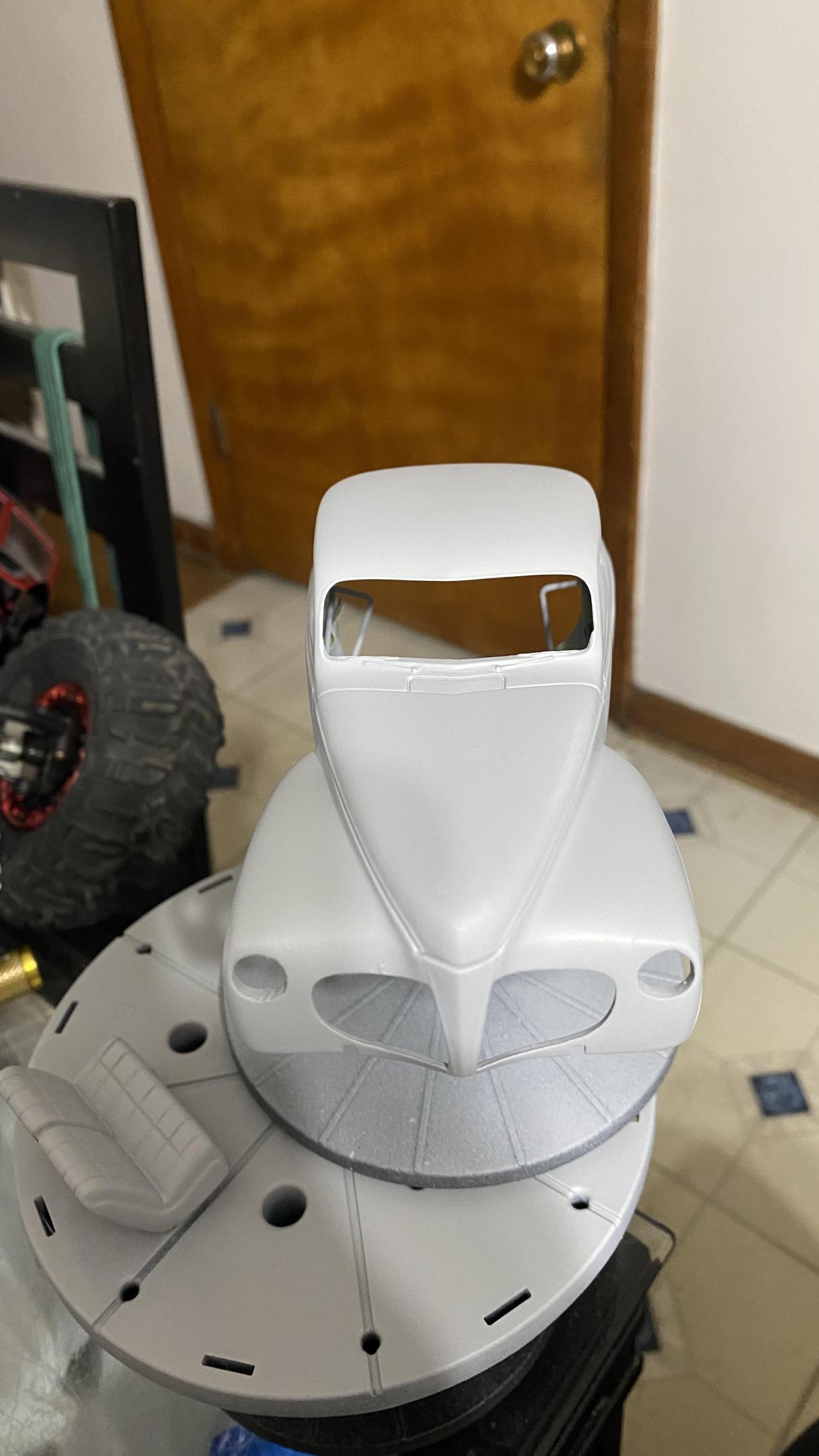

That took a good bit of work on the Custom ‘41 I built in ‘22, ended up filling with both UV resin and body filler to make all those areas look like one large assembly.

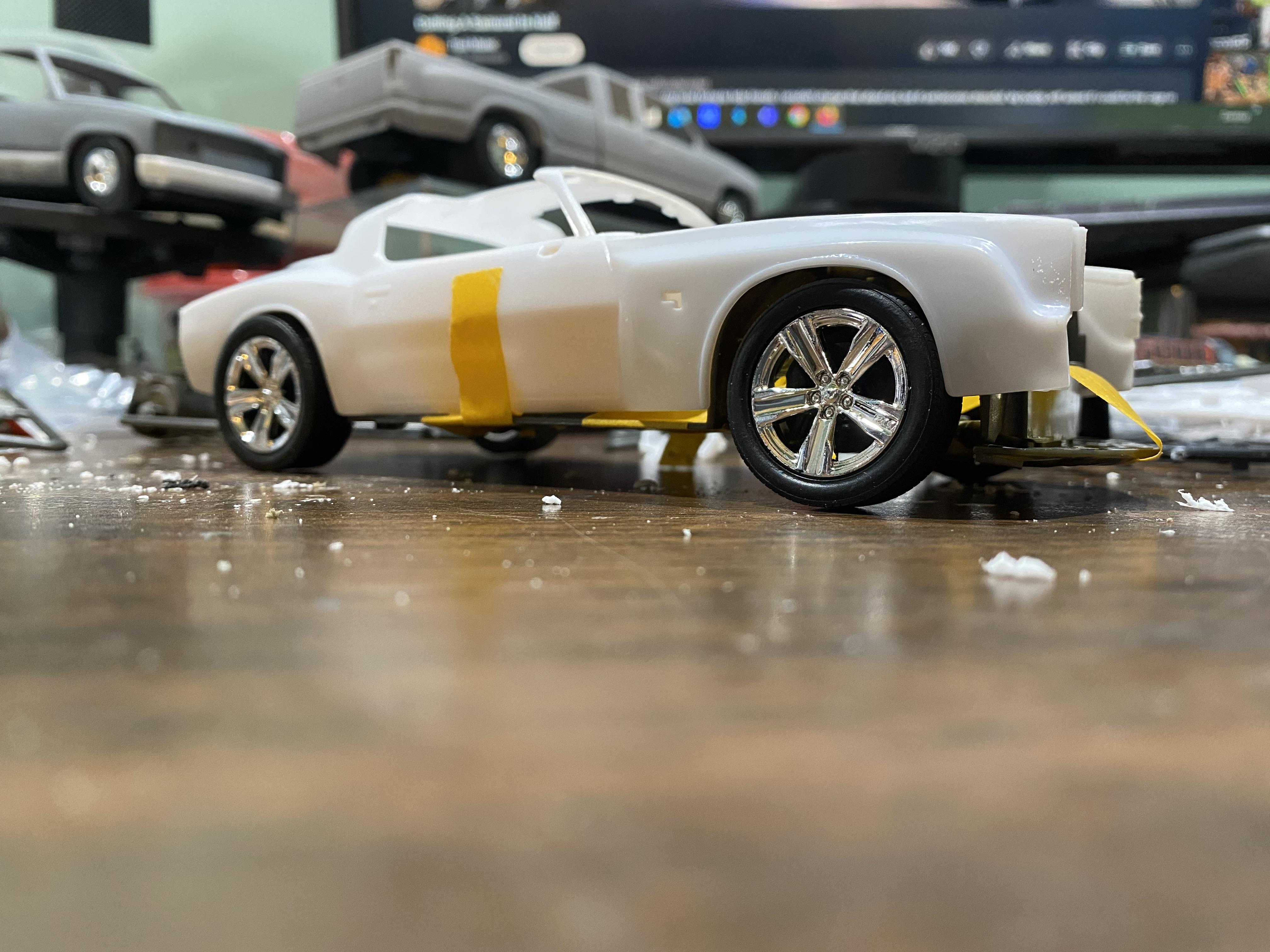

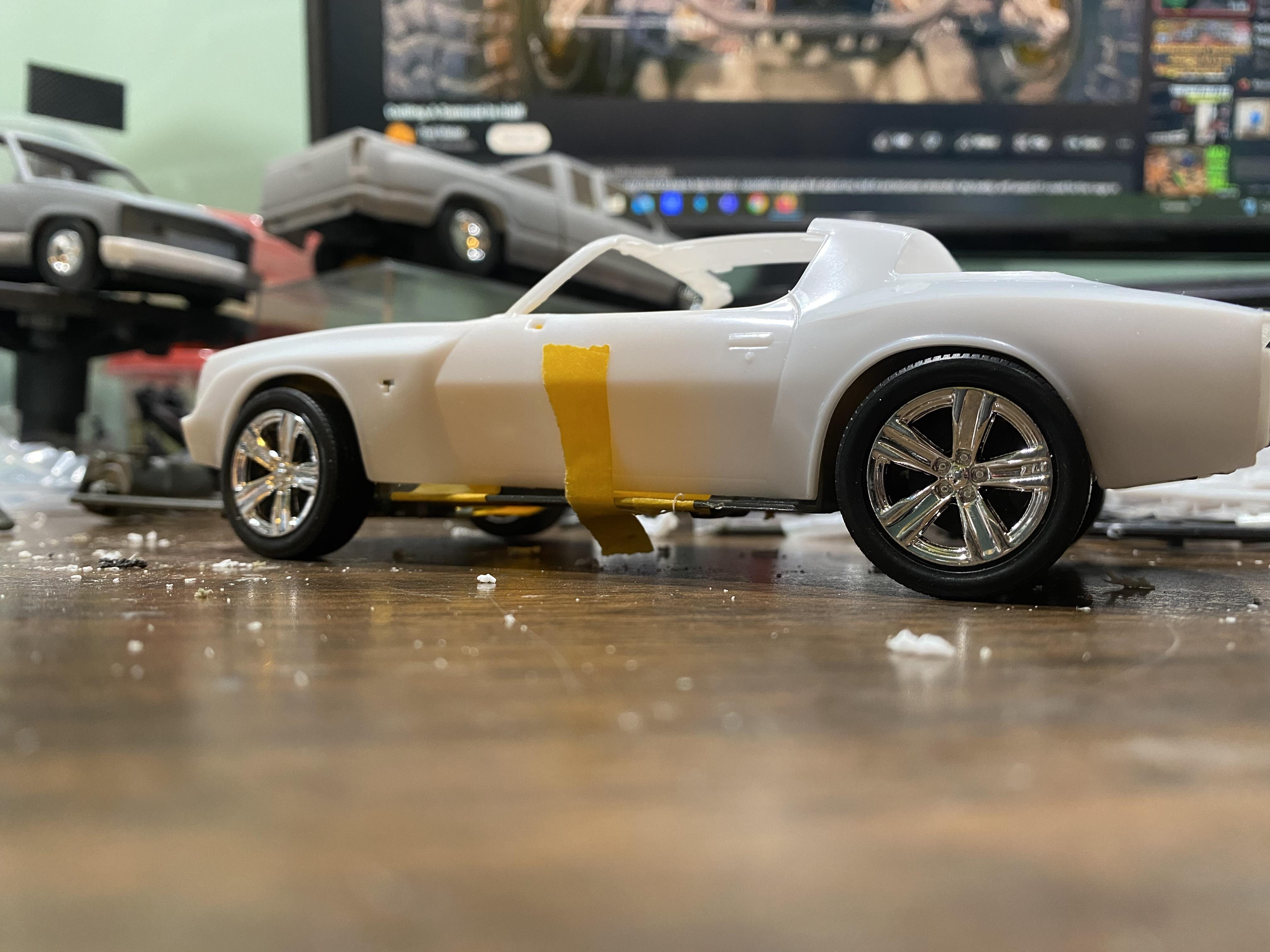

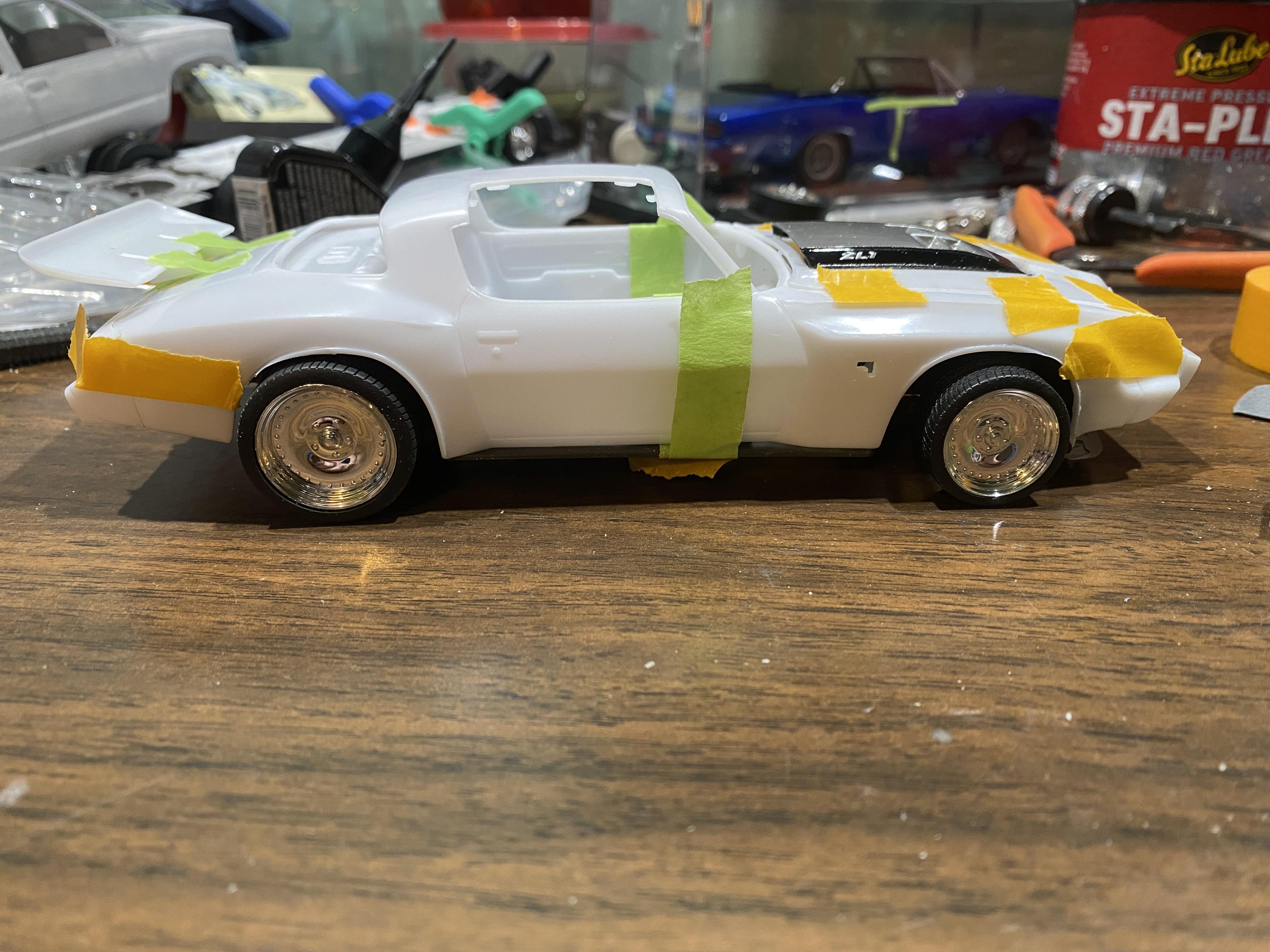

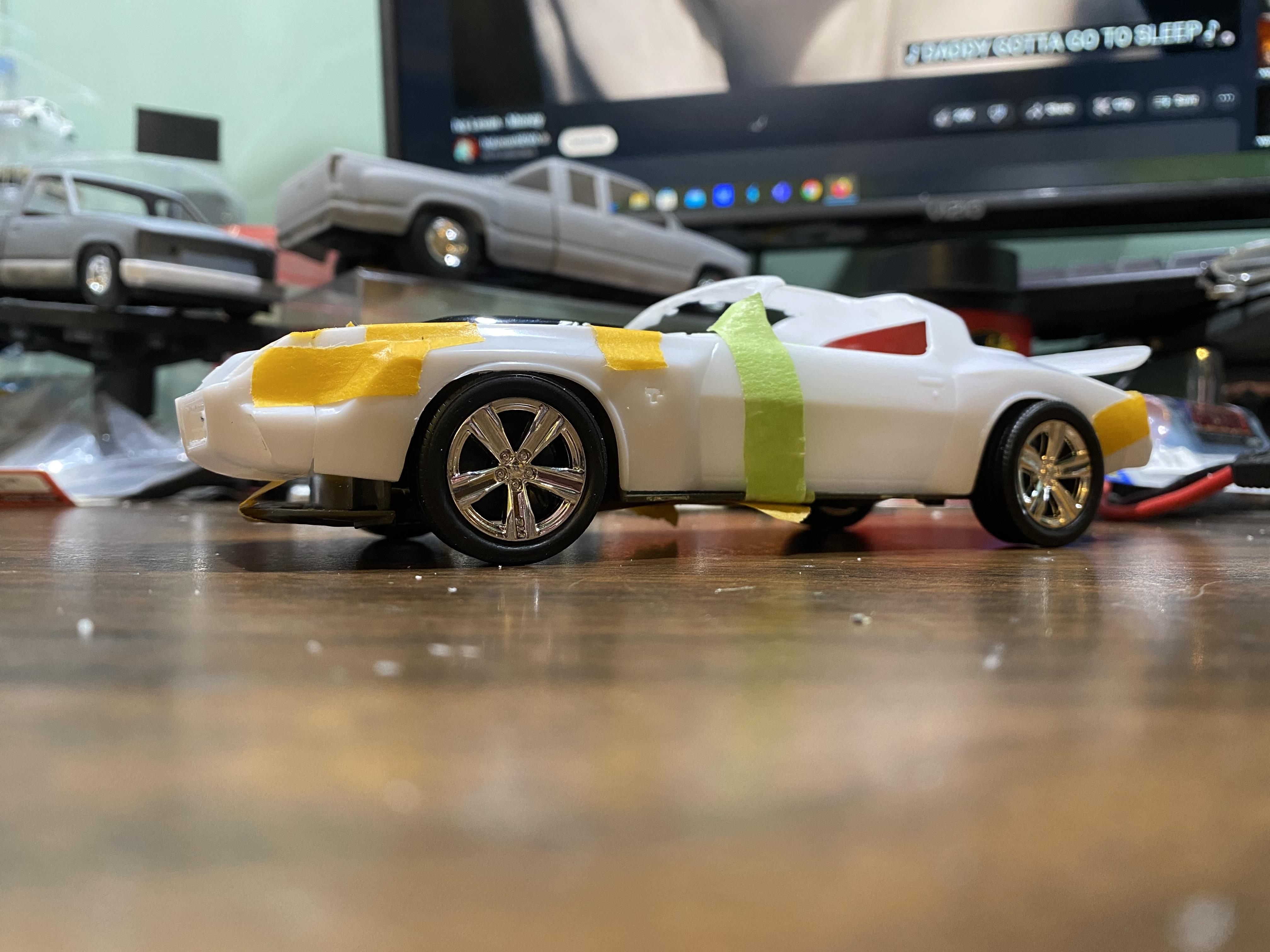

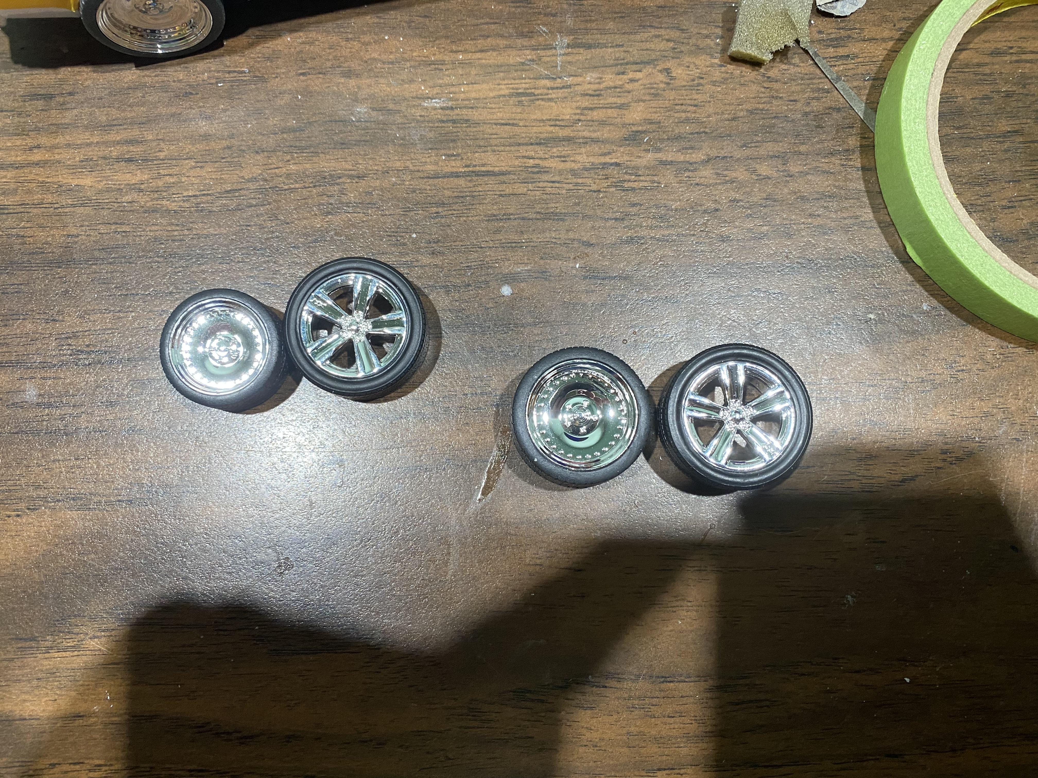

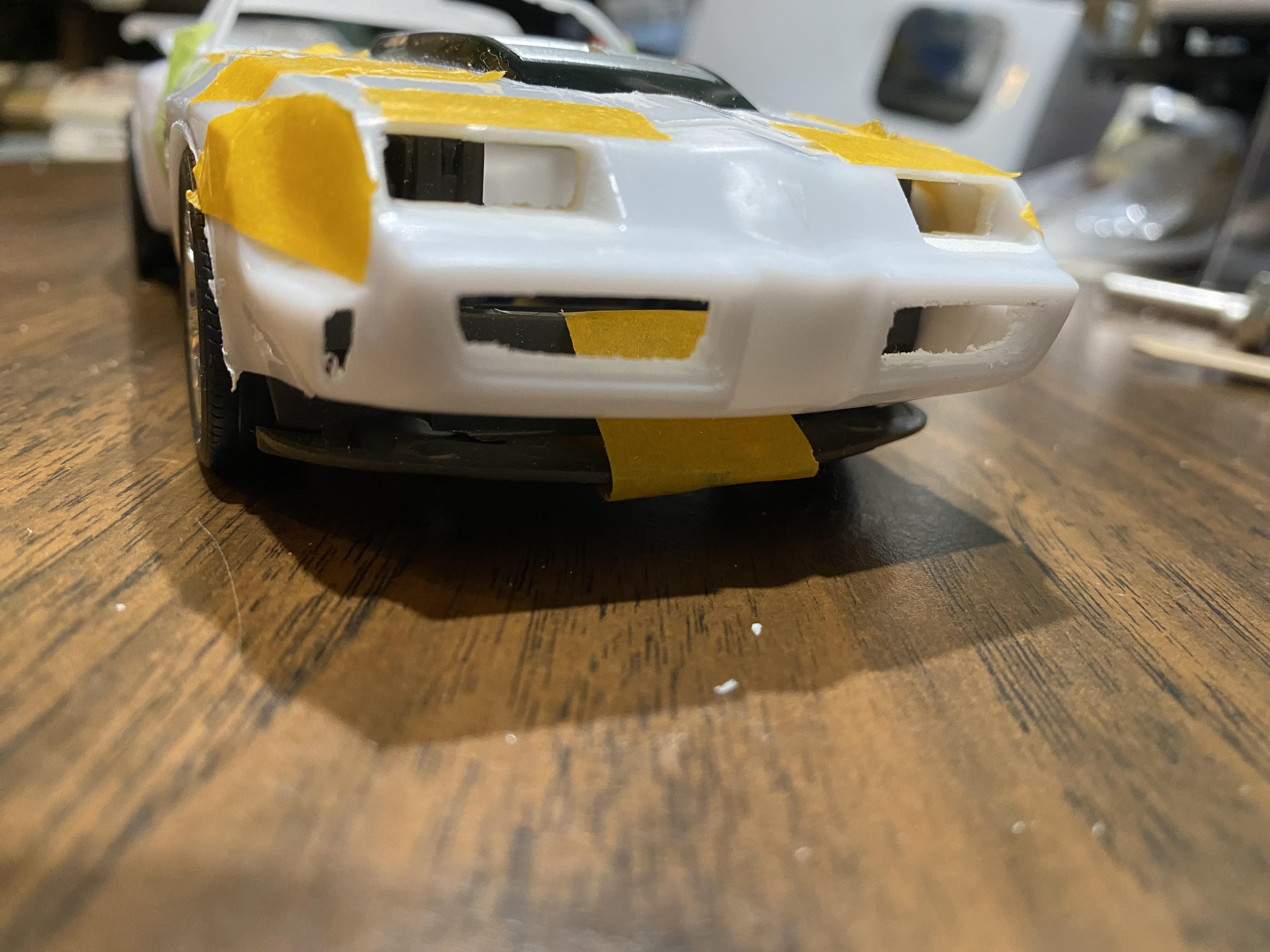

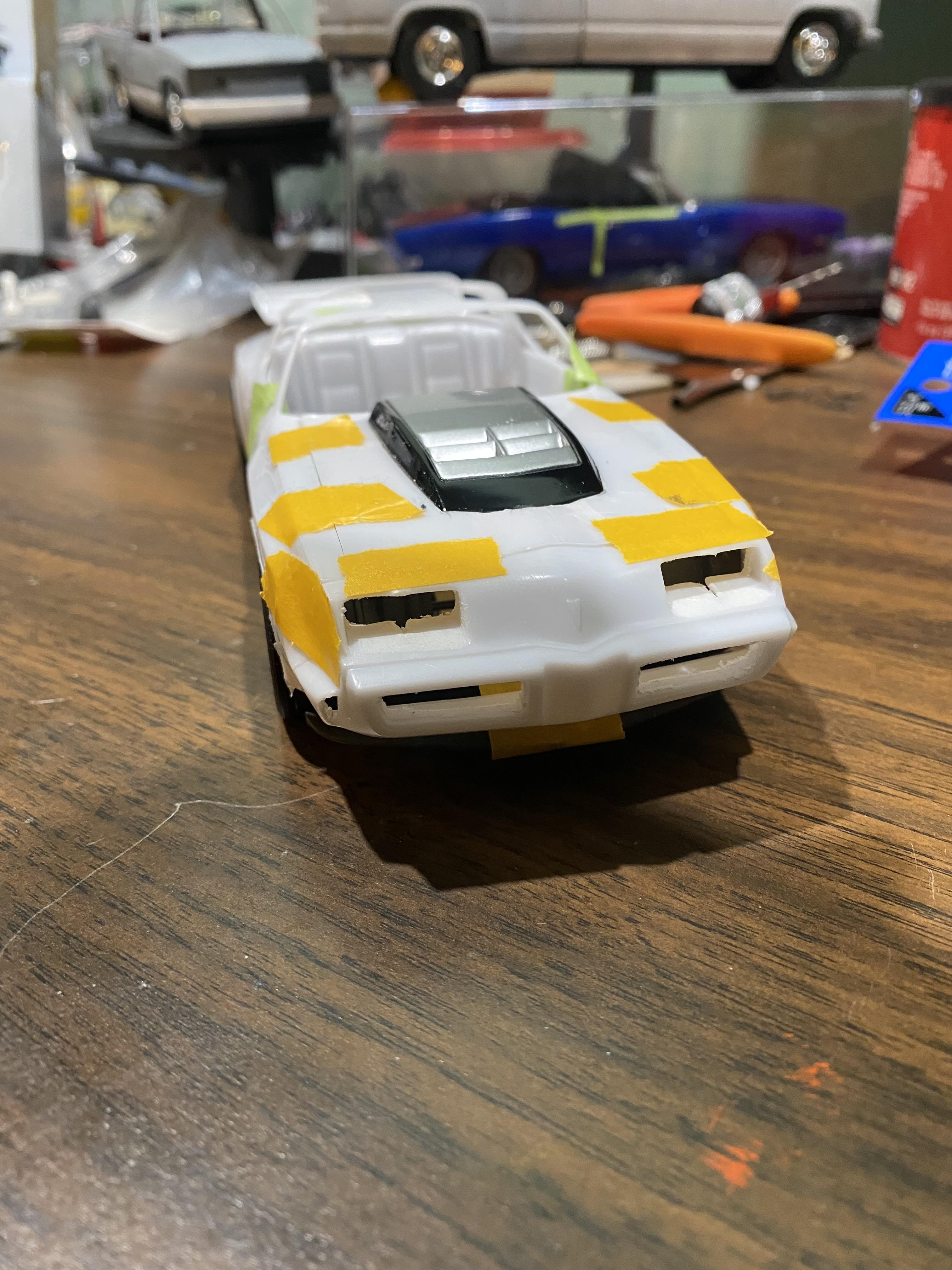

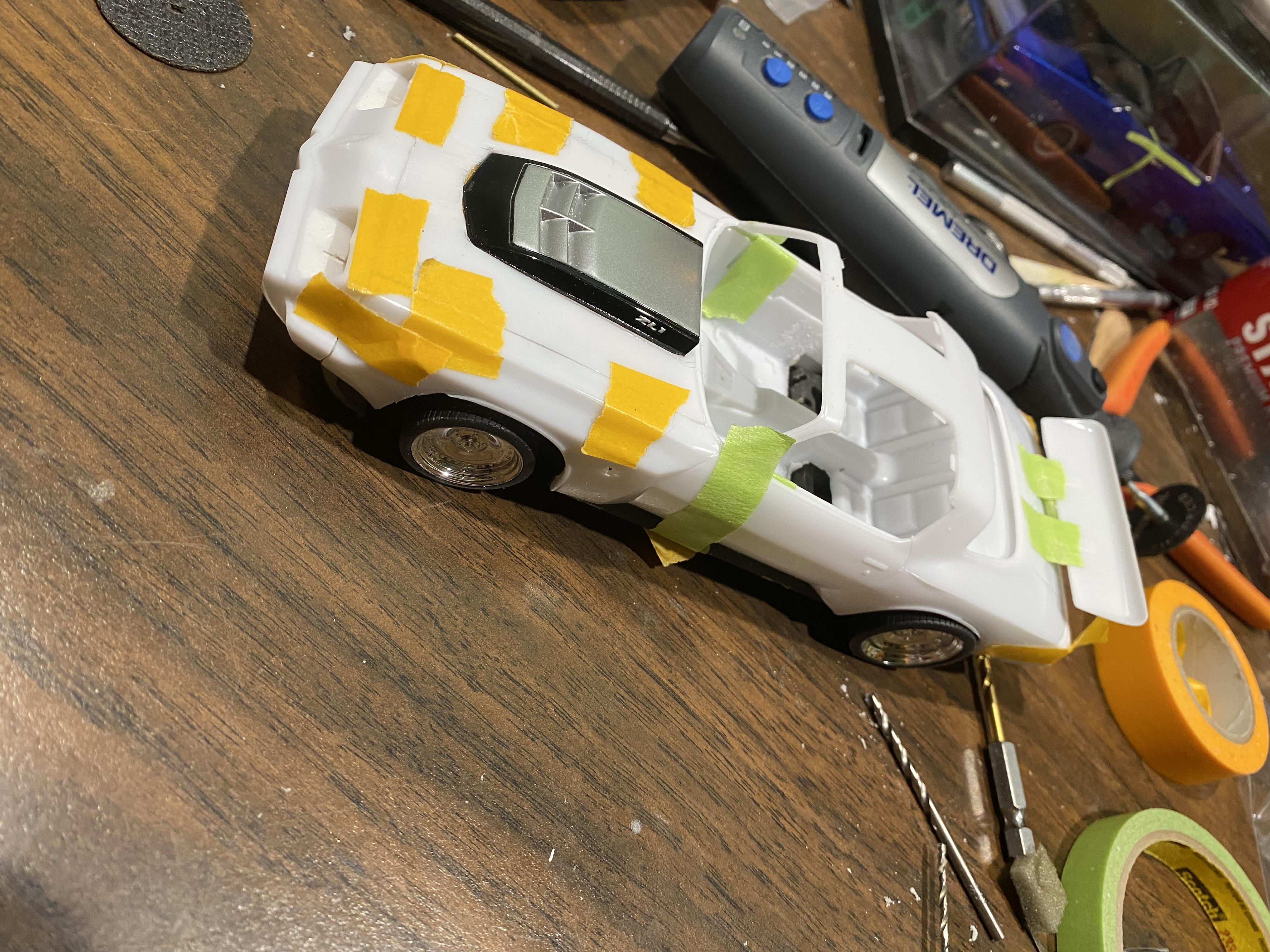

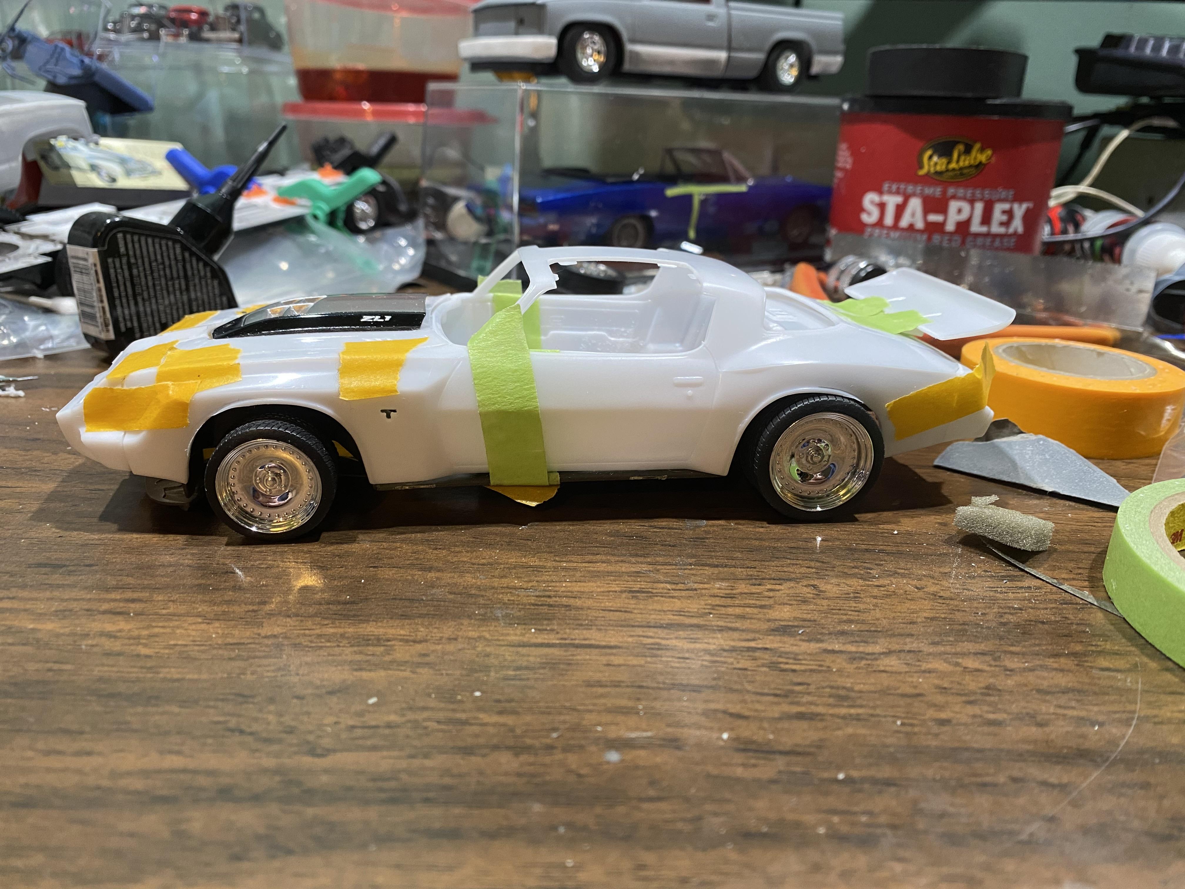

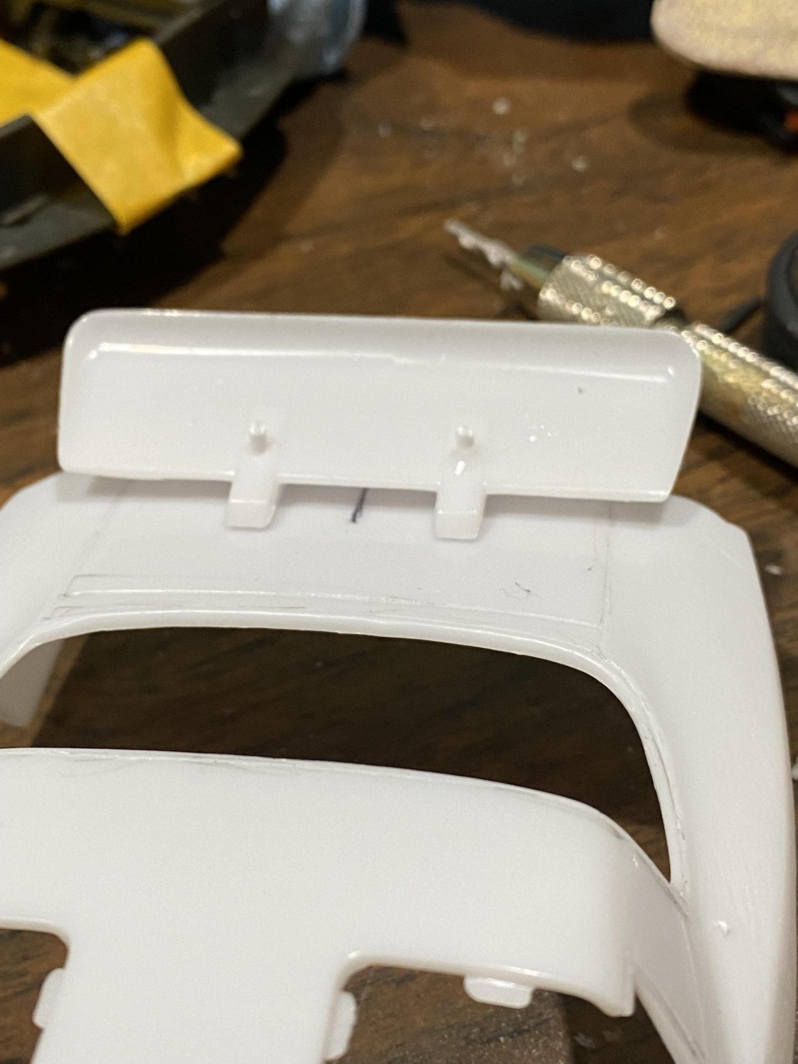

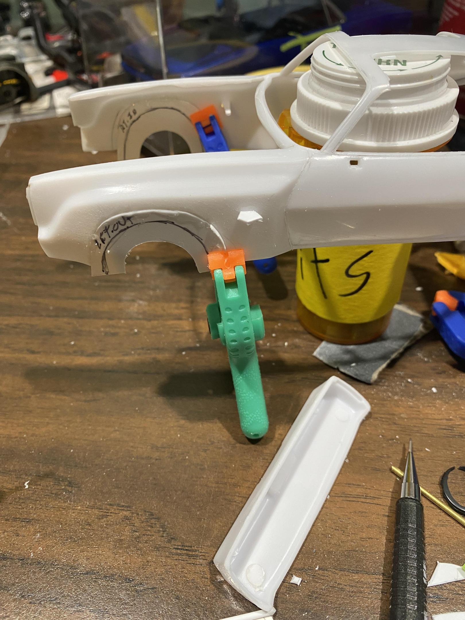

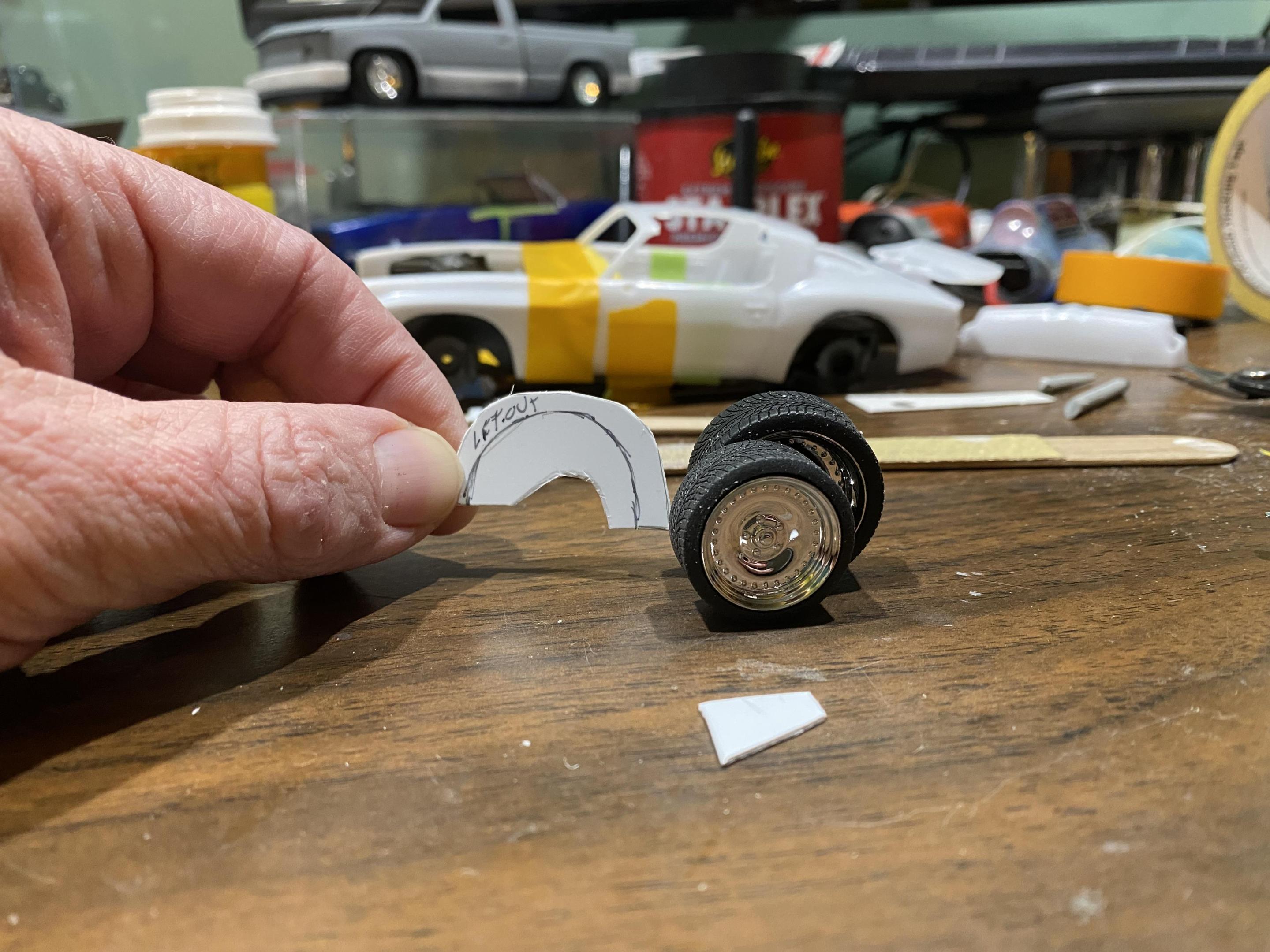

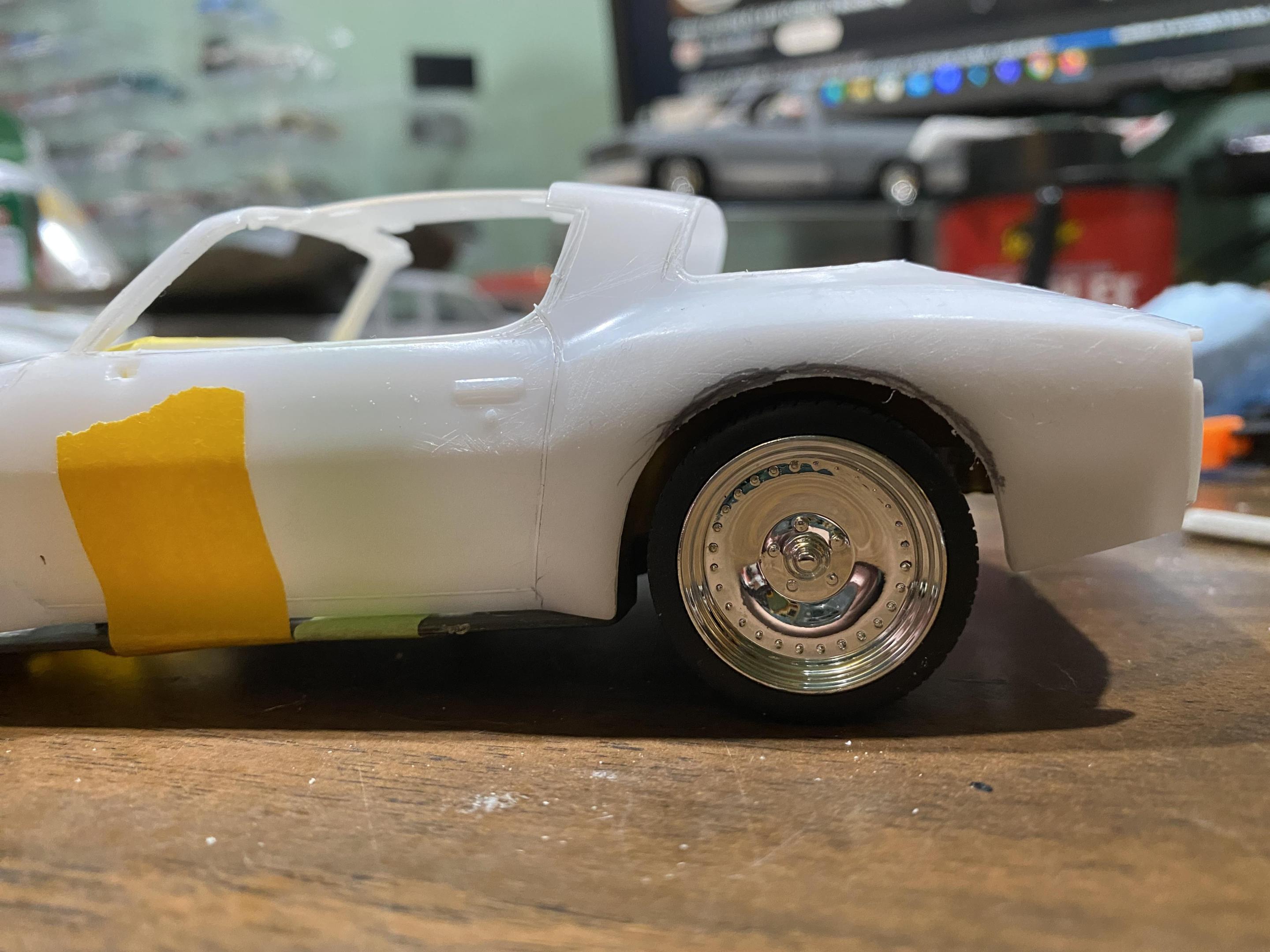

Got more work done on this last night/this morning, started filling the holes for the fender scoops and finally figured out what I wanted to do for the wheel openings. Made the wheel openings from .040 Evergreen sheet after making a template from a Du-Bro header card I had laying around. Stuck the card into the wheel opening and traced the shape of that out then sat there scratching my head for the new opening and started to freehand draw it until I realized that to match the gap in the radius of the rear openings, I could use the rear tire and trace it’s diameter onto the paper and get an appropriate opening size and shape! There were a couple gaps between the opening and filler that I was able to fill with some .020” styrene then started to fill the holes for the scoops with some of the extra plastic cut from the OD of the fillers. I also filled the backs of the wing pedestals with more of that extra .040” from the fillers. I’m waiting for the cement to fully harden before I do any sanding on what is there then will finish filling the small holes in the front fenders once I get the rest of the fillers sanded down. Kinda want to throw some primer on them once I get those sanded down as I can’t see what needs to be filled due to lack of contrast with all the while plastic used. Here’s the nose piece after filling in the gaps I created when cutting the dividers from between the headlights. Used masking tape to create a dam on the top side of the openings the filled with the UV resin from the bottom and sanded fairly smooth. This is another area where a little primer will show what needs extra filler -

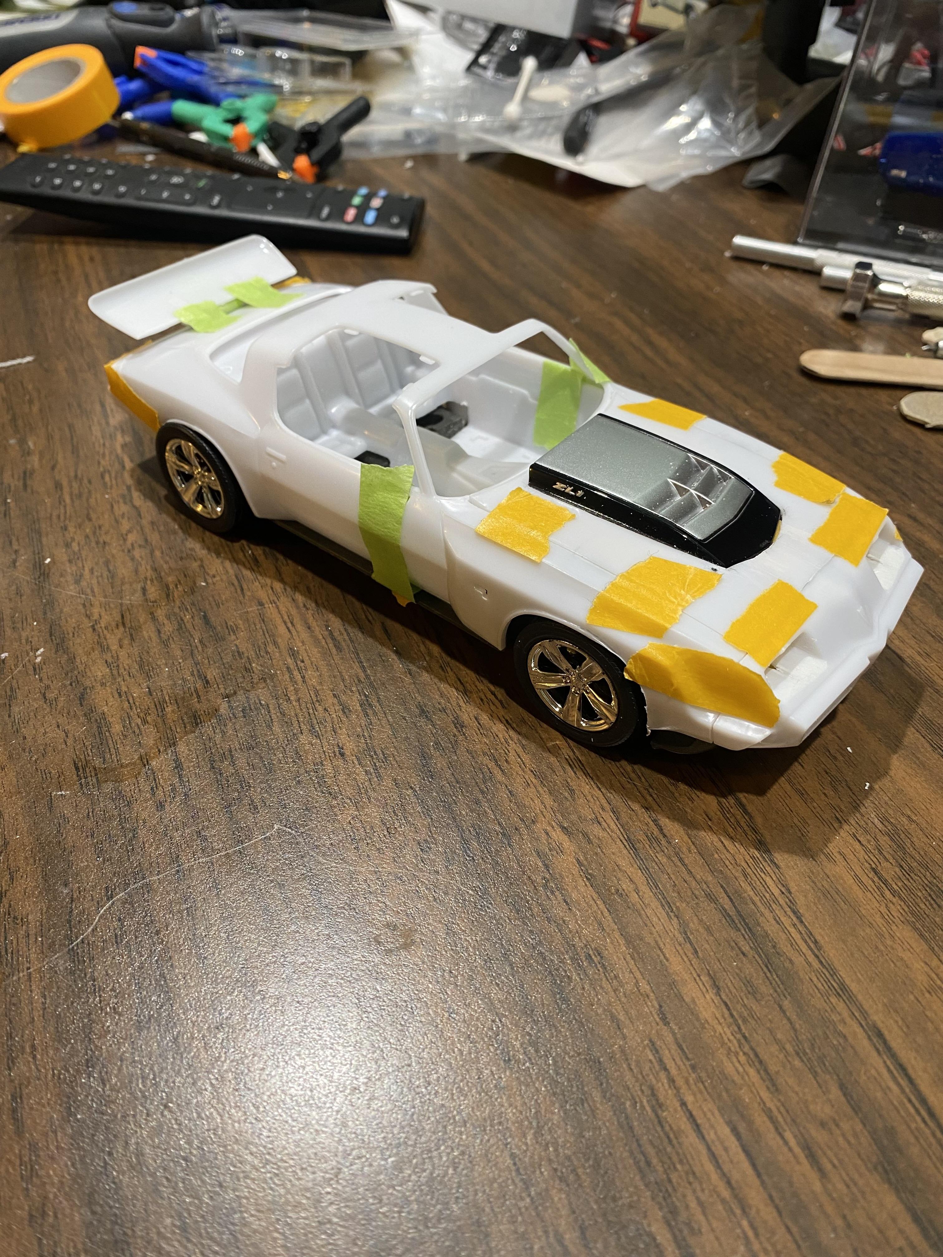

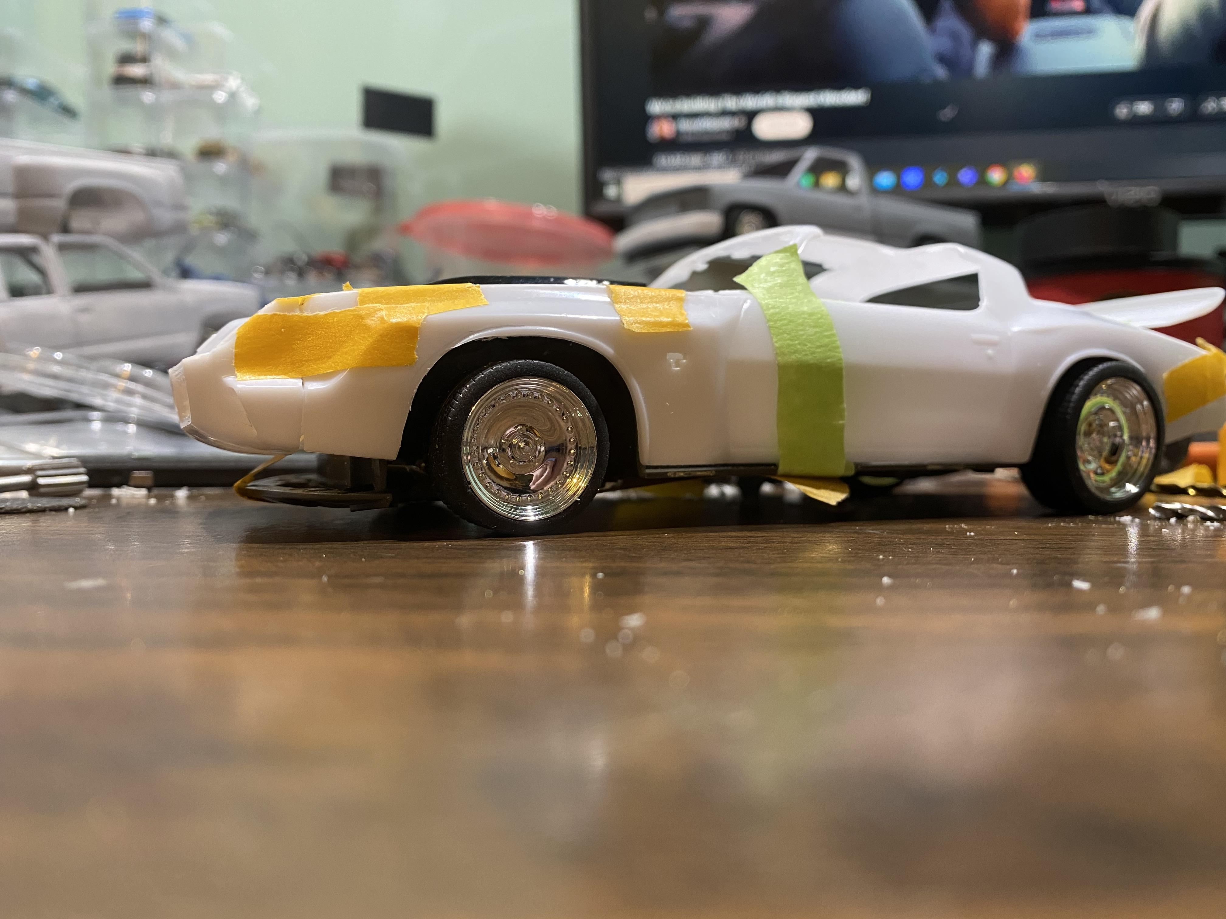

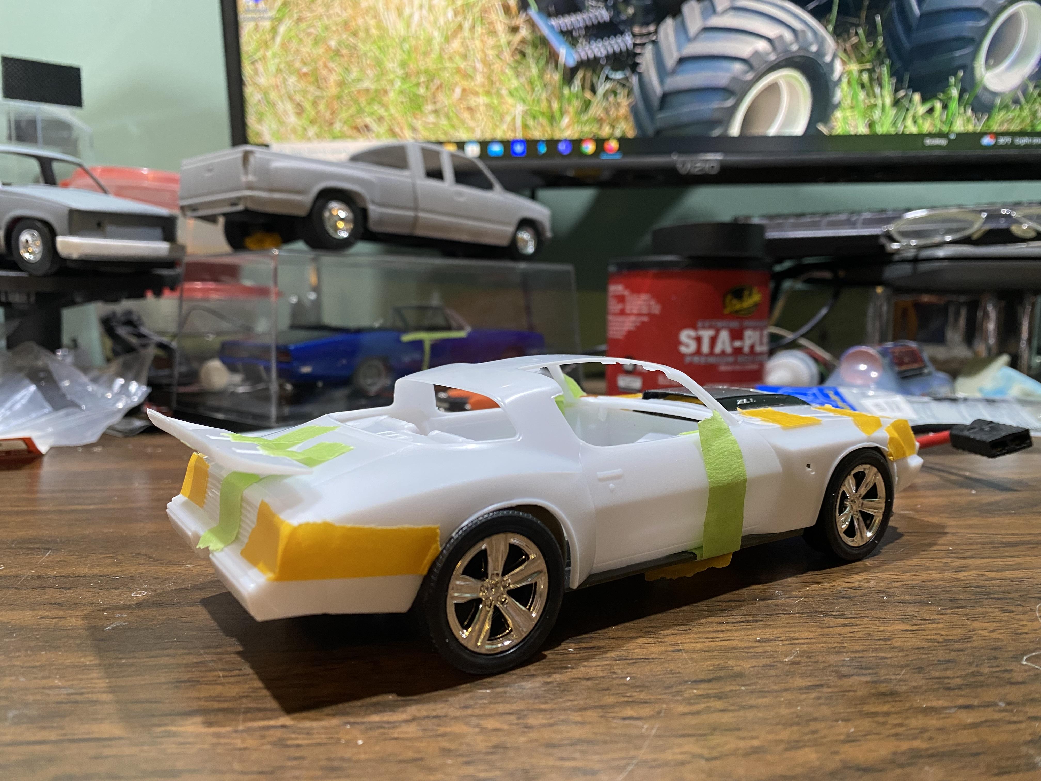

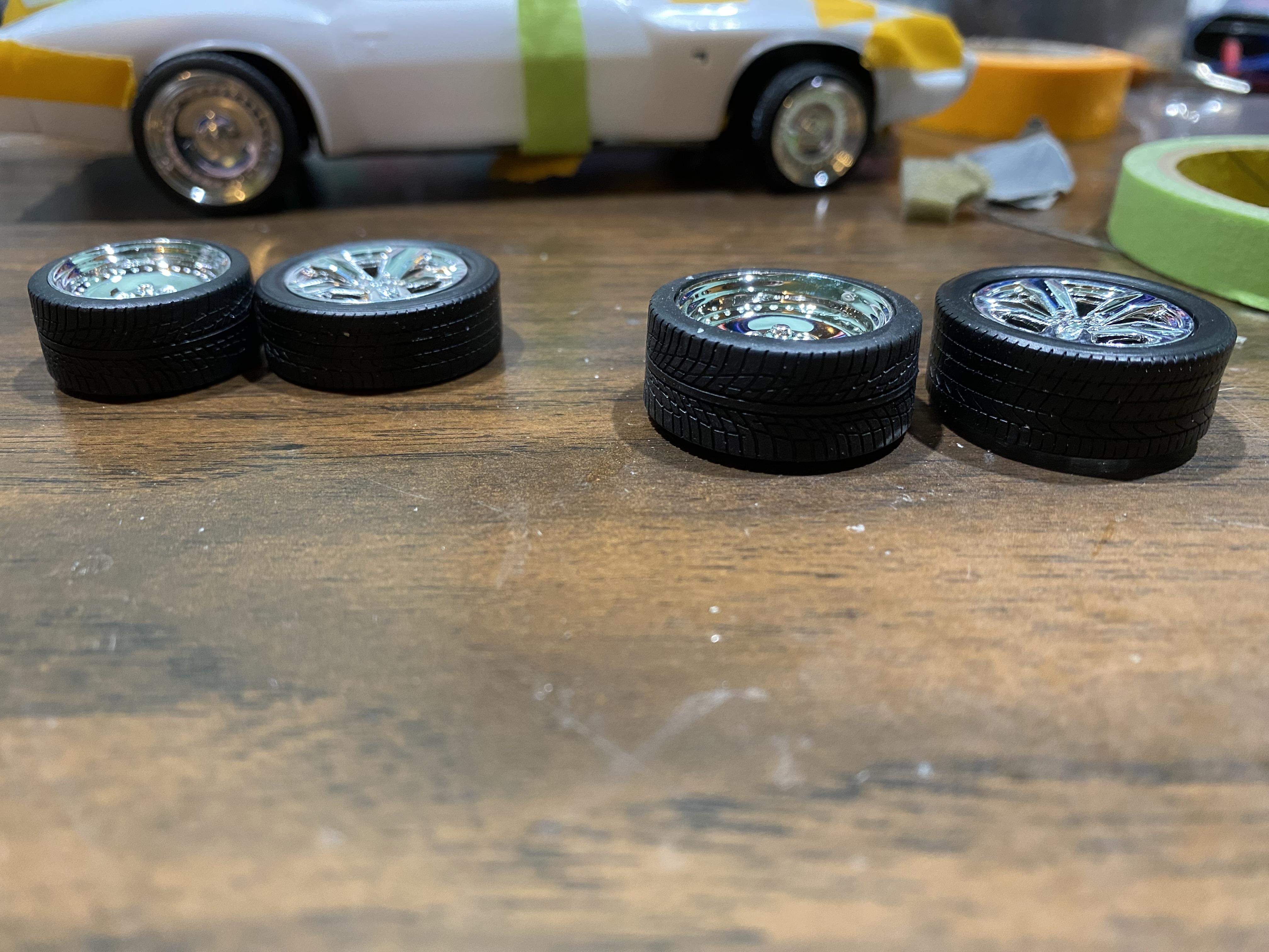

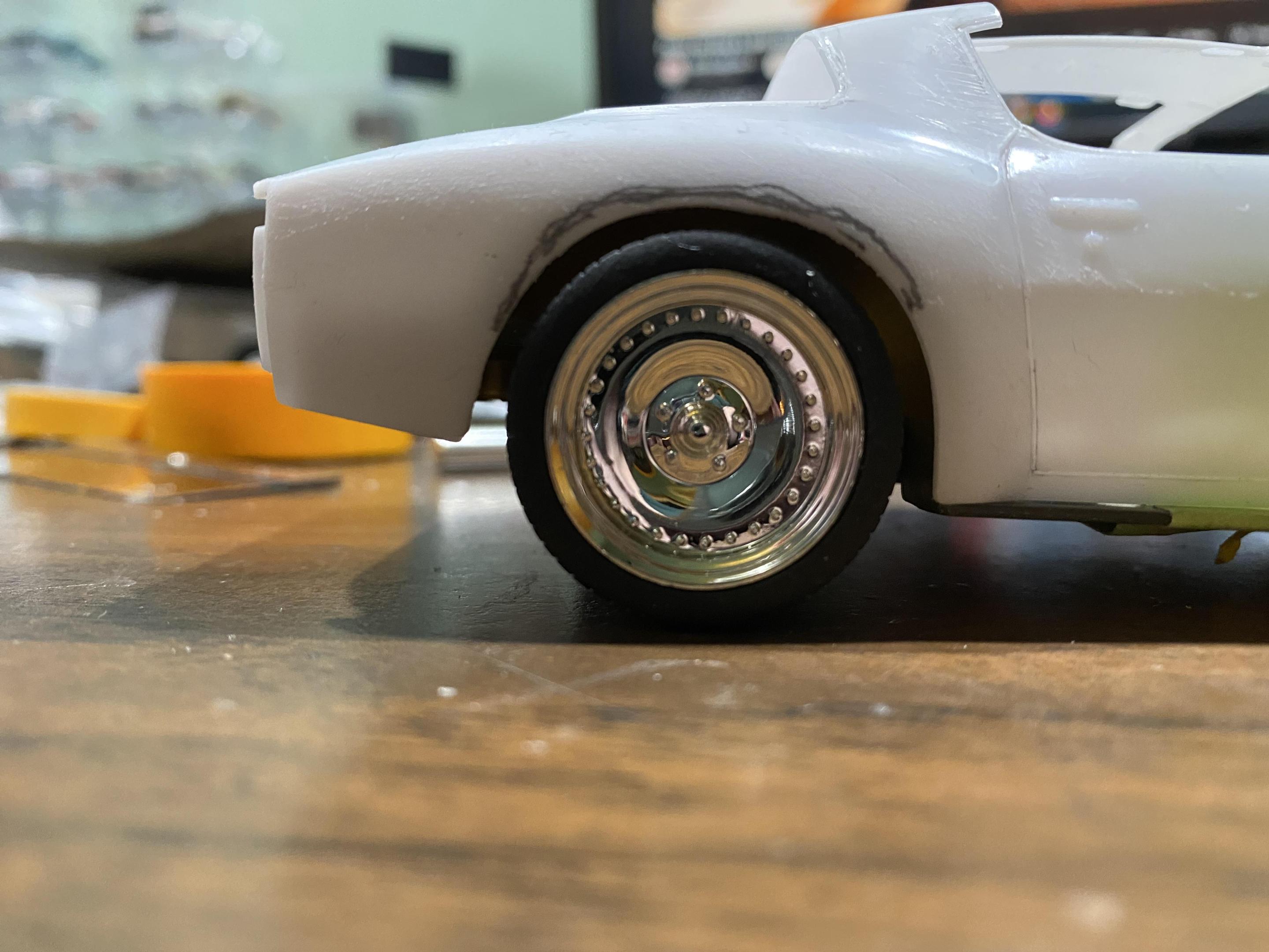

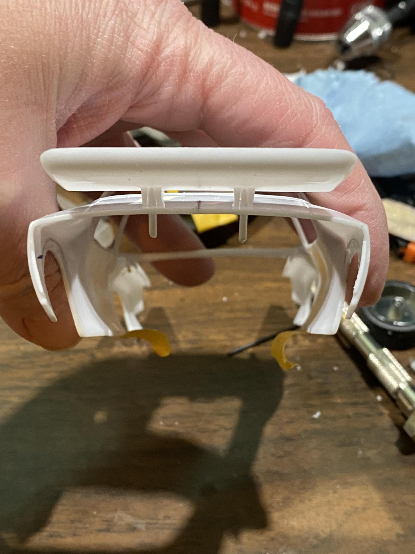

Thanks, I was pleasantly surprised when I mocked it back up and saw how it fit. The front will need filler panels for the back half of the openings to work with the “little” front wheels and tires. I do like the resin like that as it can be worked pretty quick since it’s a UV cured product vs waiting for a chemical reaction to kick off or for it to gas out like you would different body fillers. -
Hmmmm, ‘79 Firebird Widebody ZL1 anybody?!

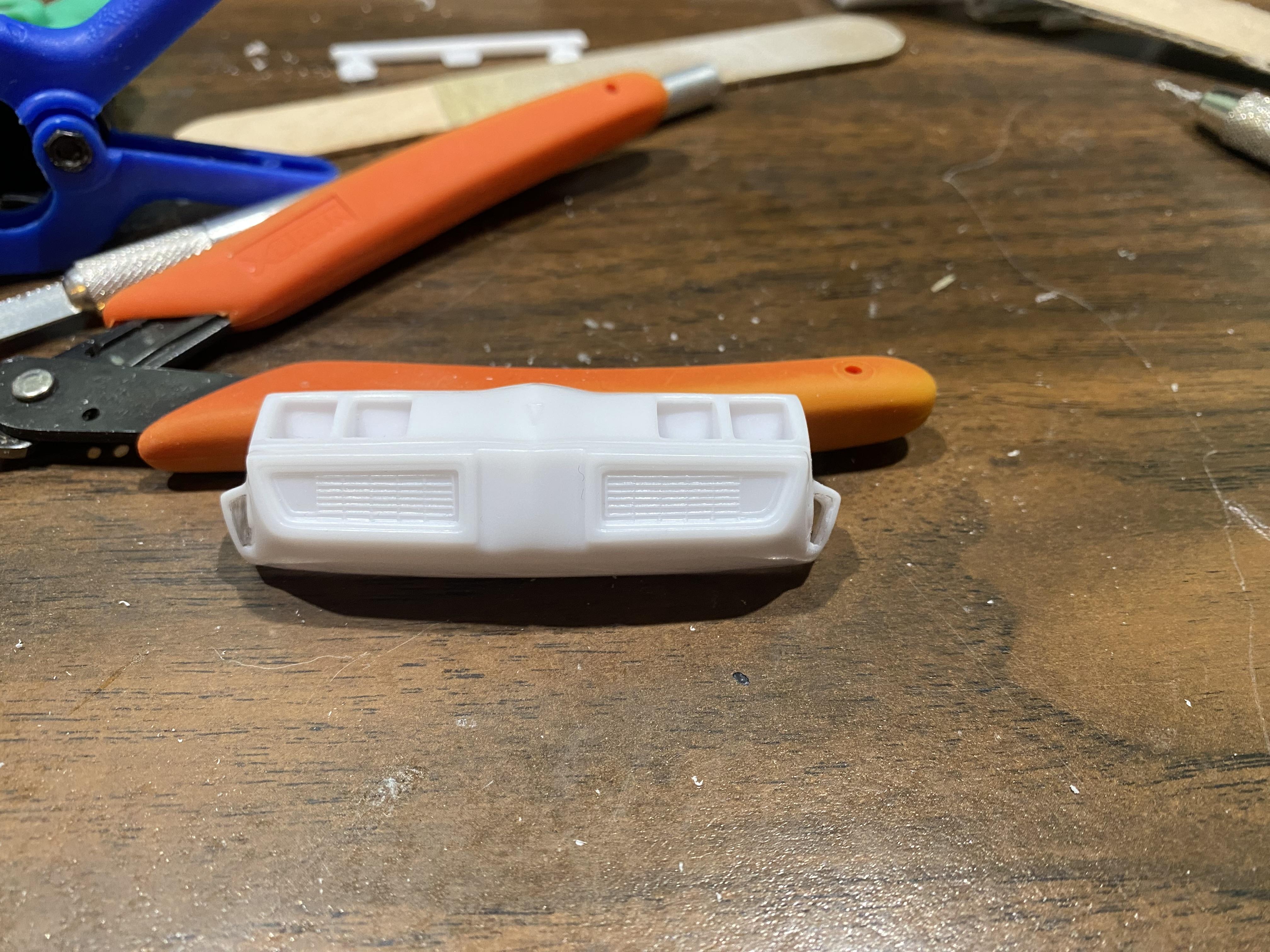

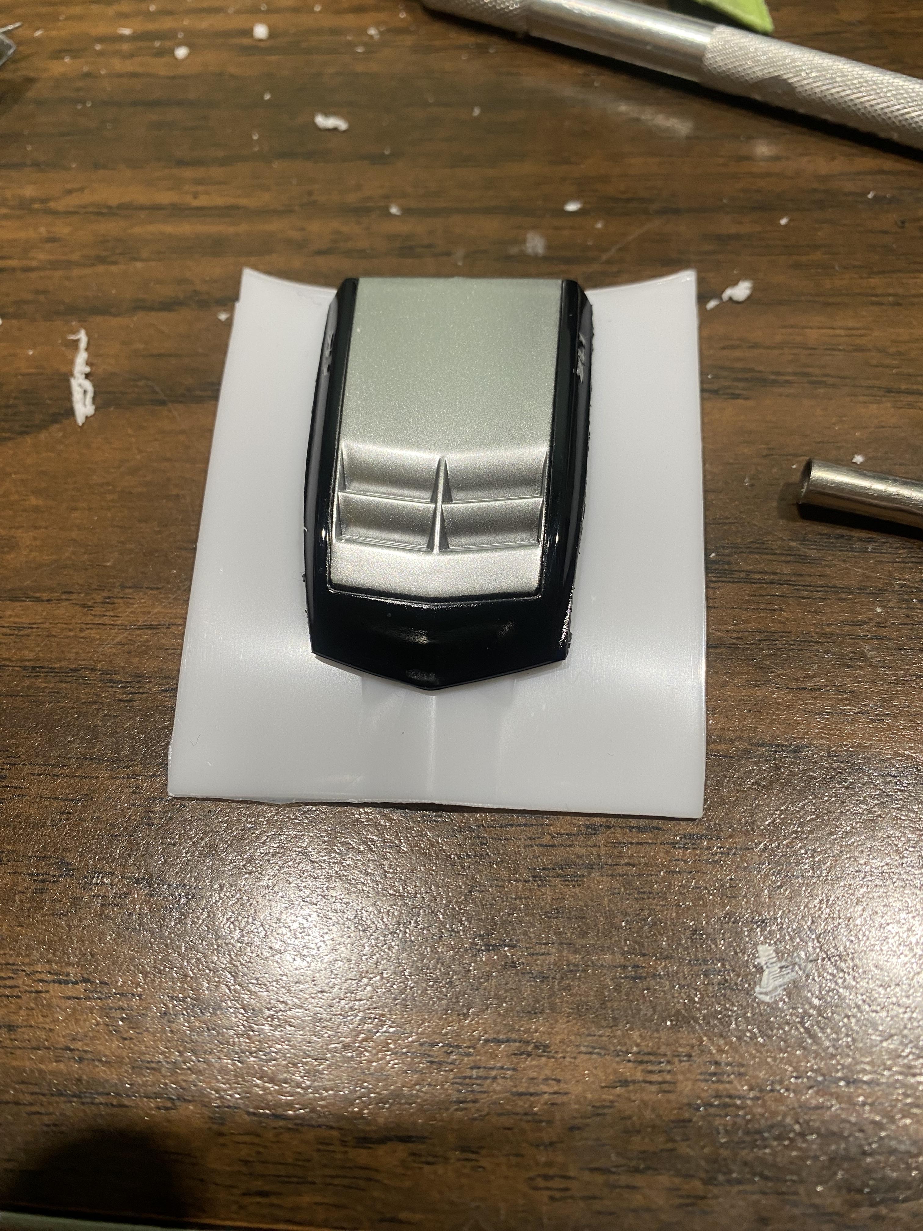

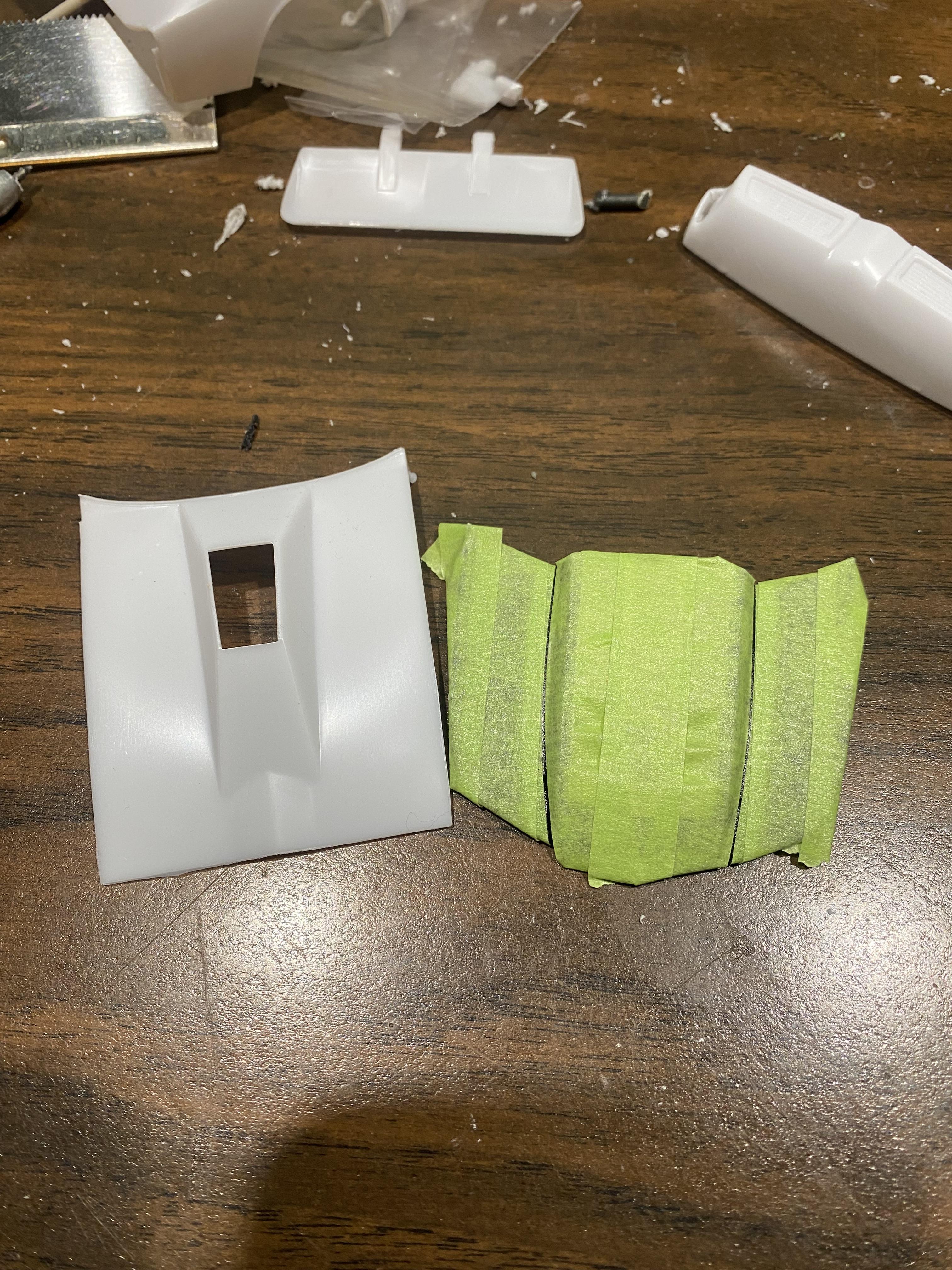

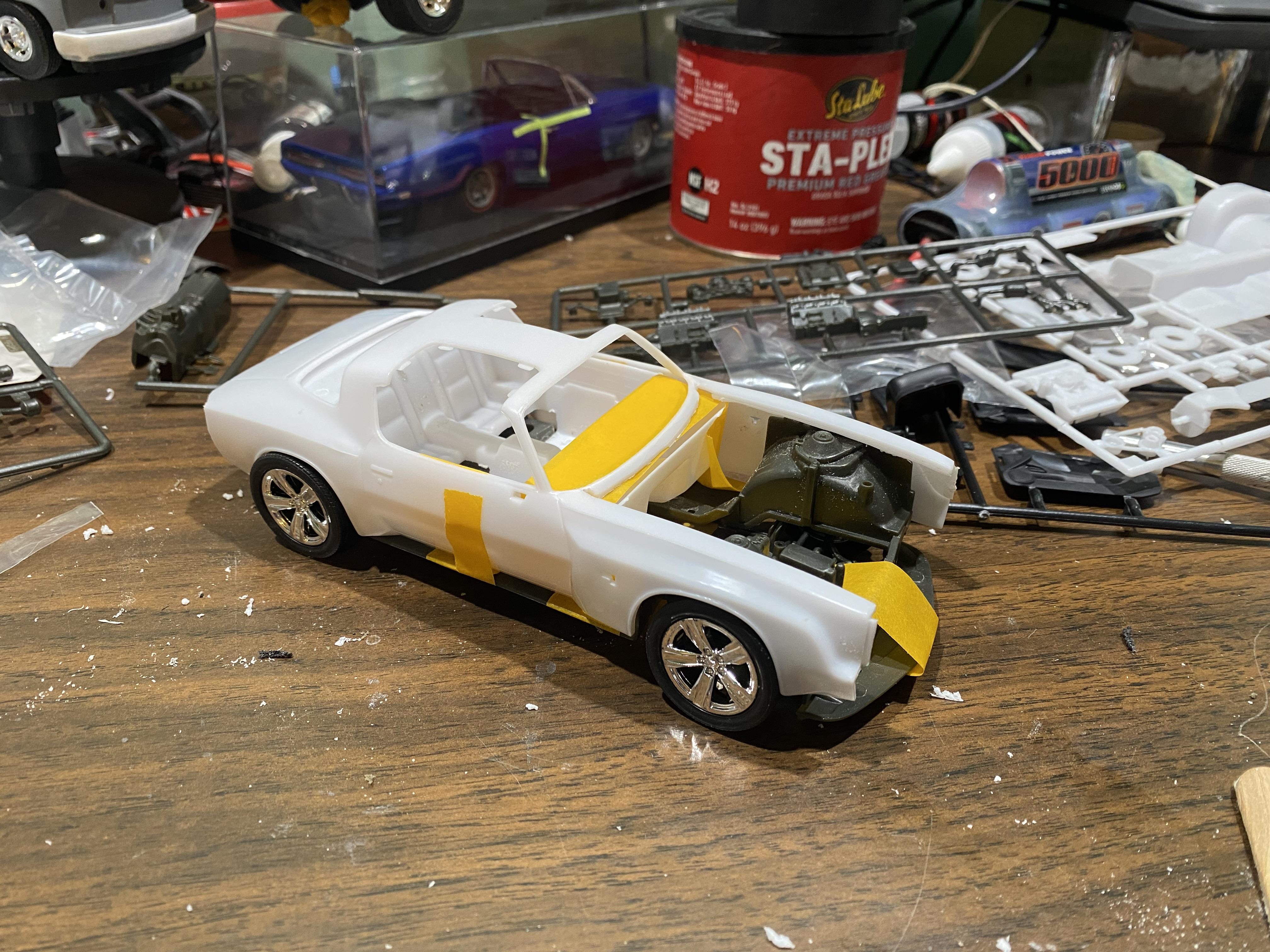

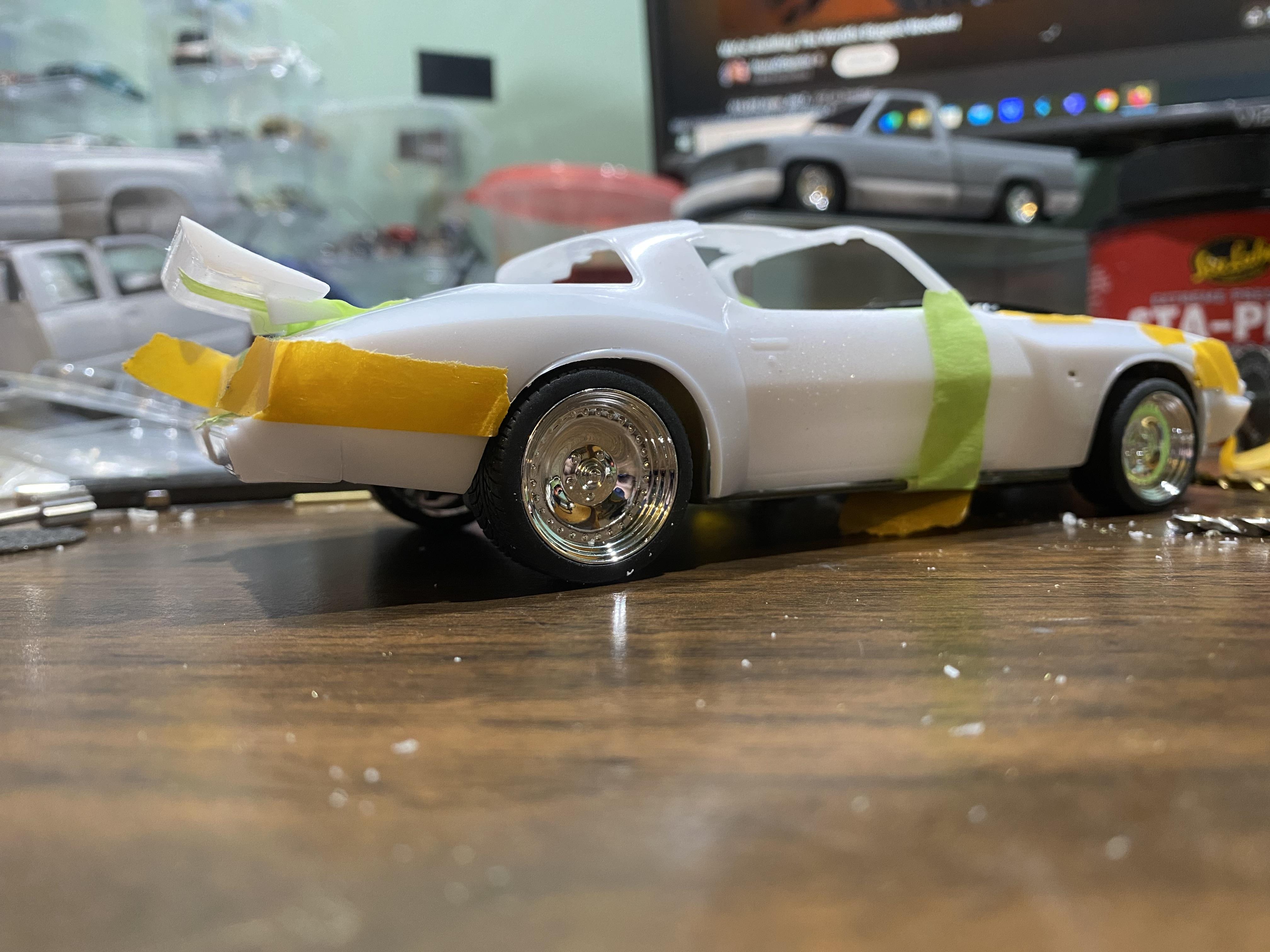

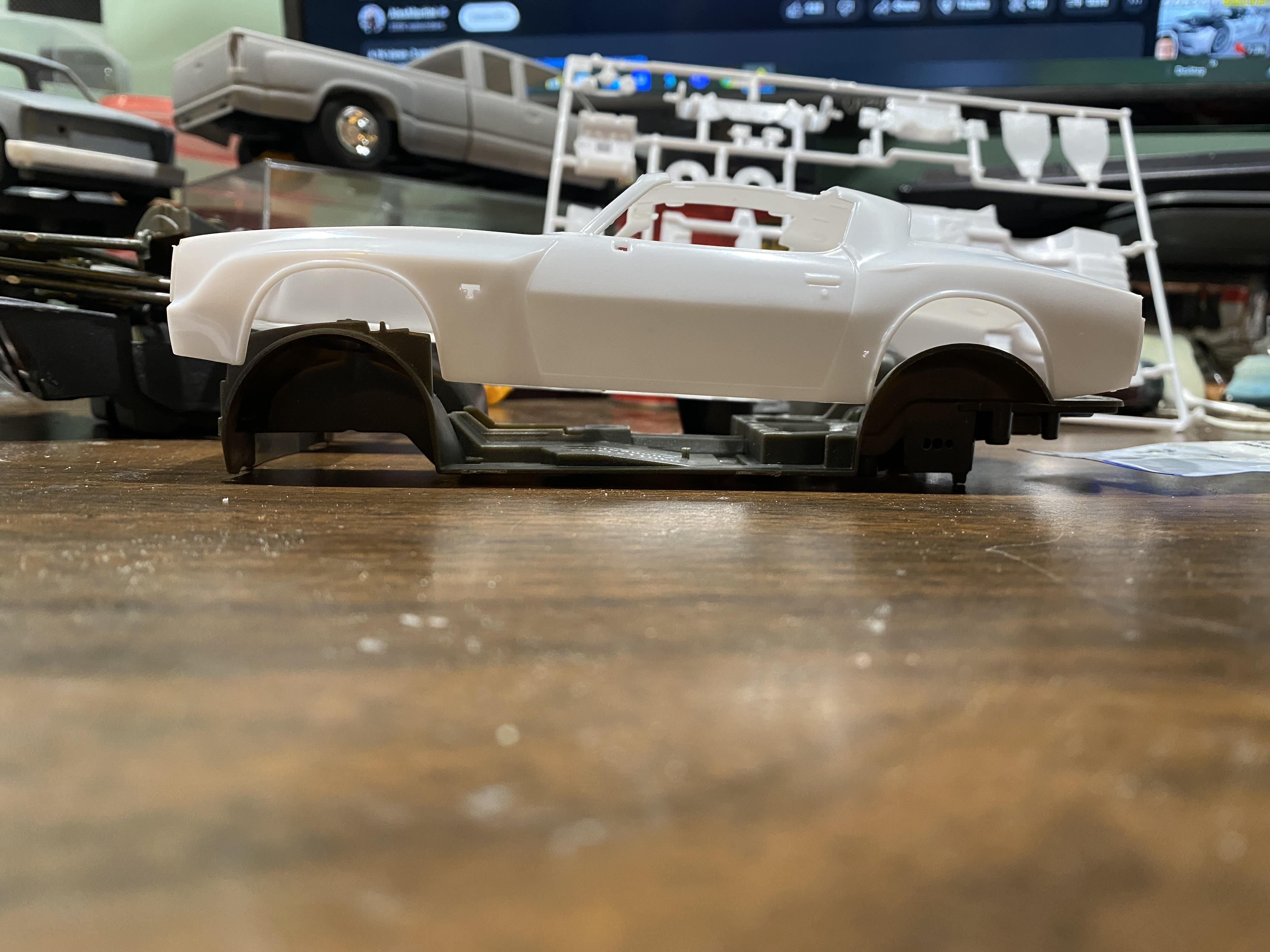

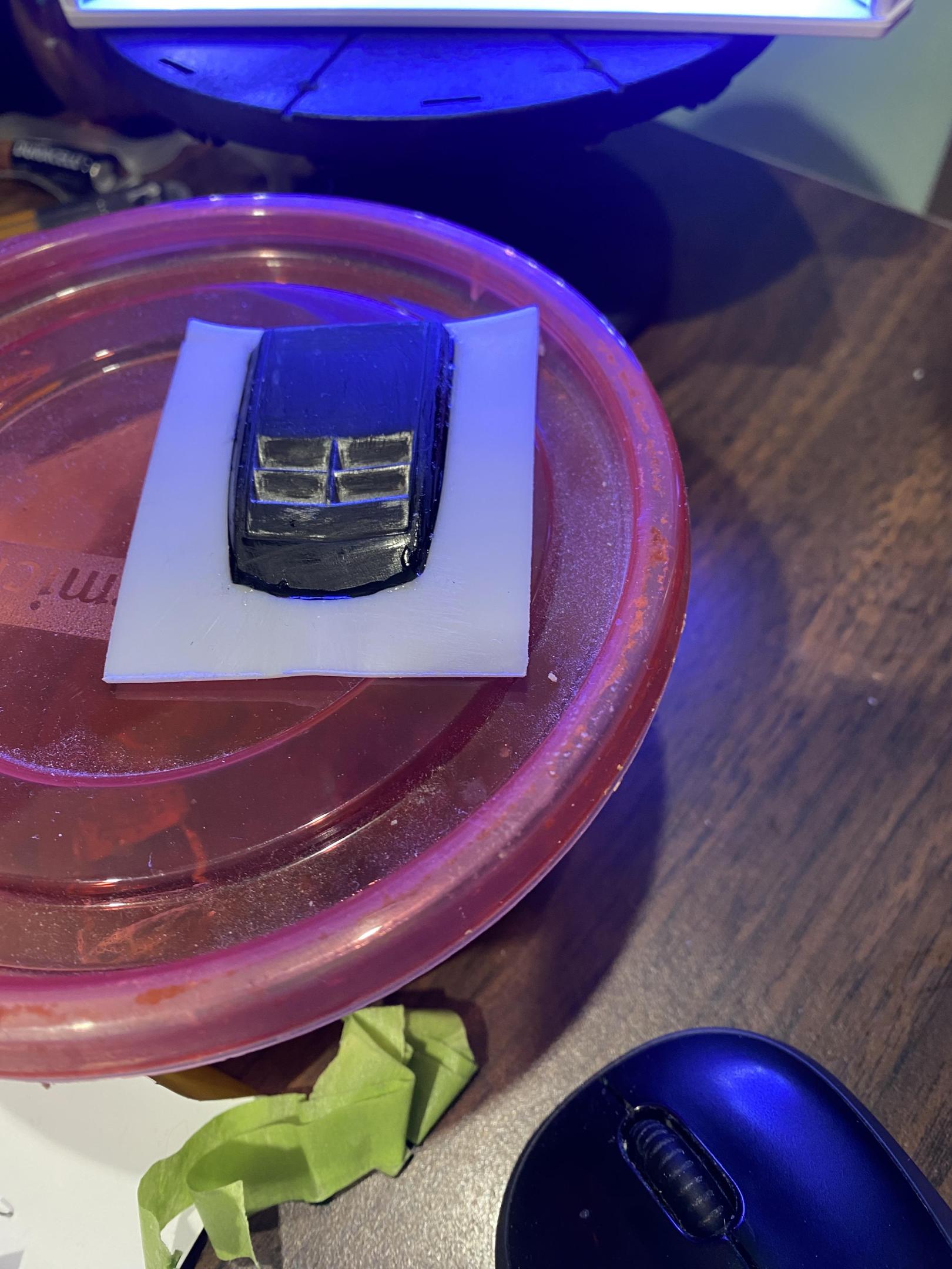

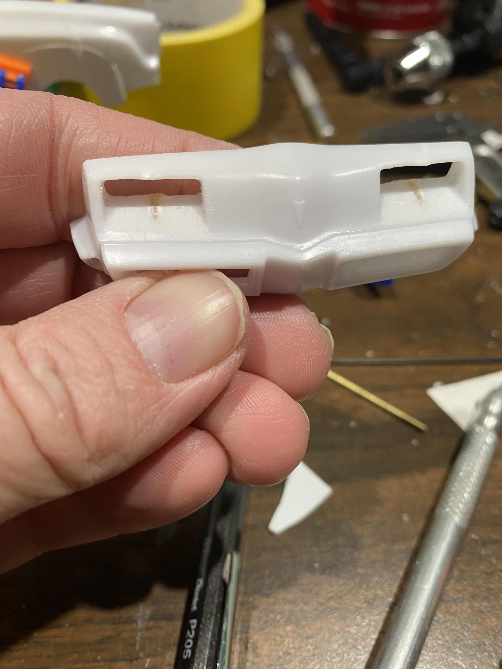

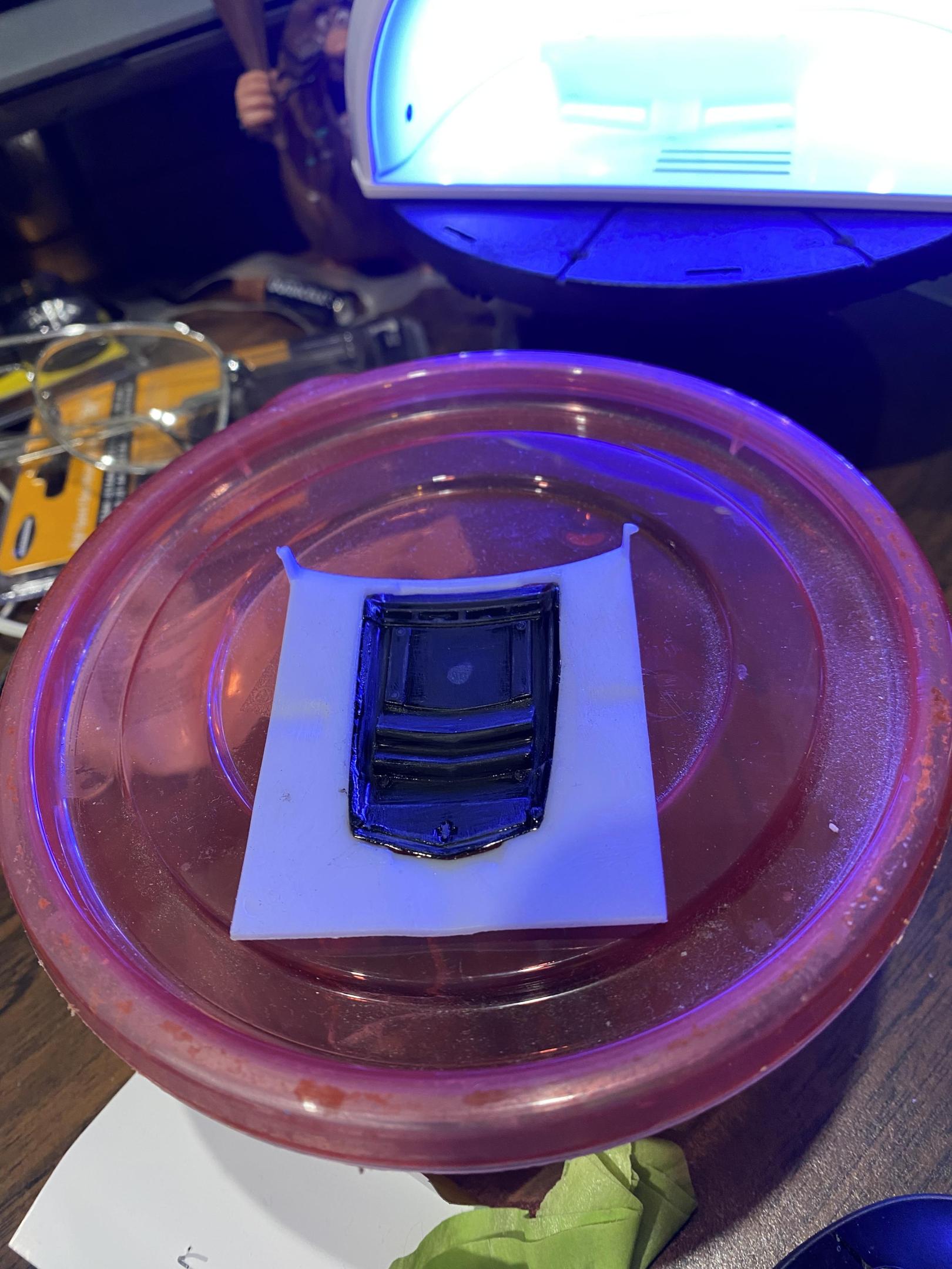

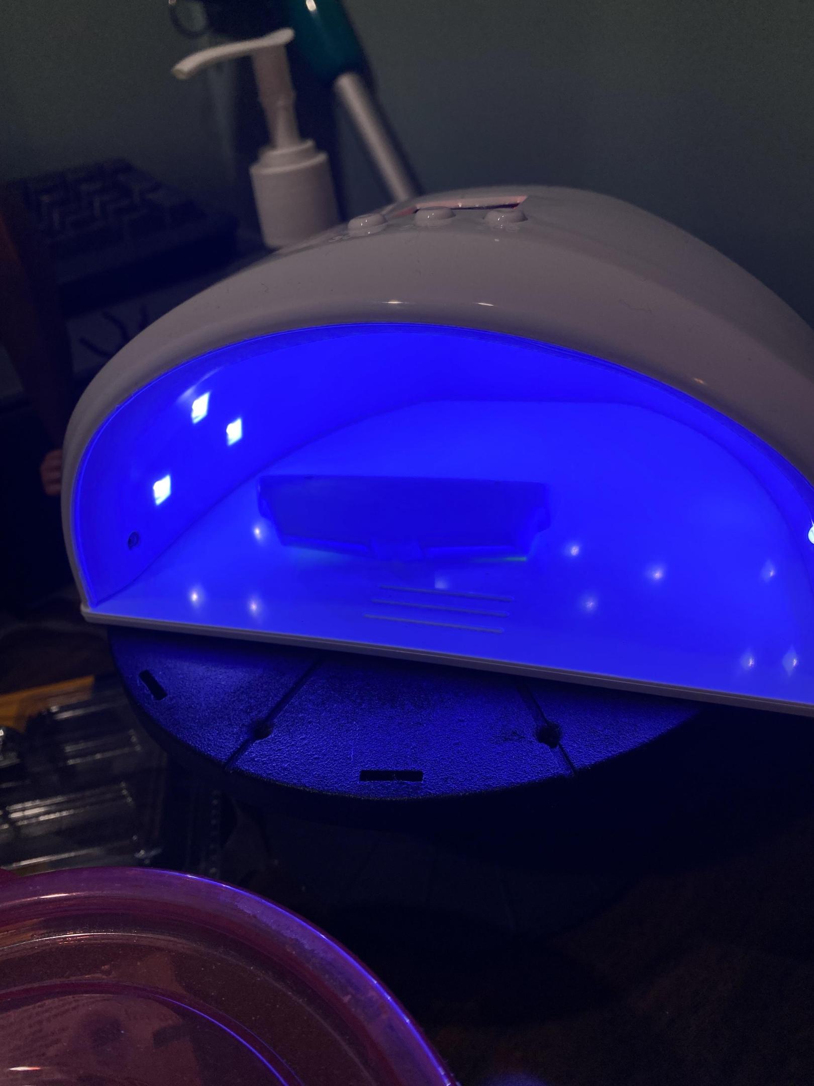

Ok, spent some time on it after dinner, spent a little time with my Dremel and it turns out that fixed the rear wheel well problem with out any extra work! Hopefully the front openings will be nearly as easy. I also used sone of the Bondic UV Epoxy to try and fill in the separation of the two hood sections into one as well as fill in the openings in the fascia where I removed the dividers between the pairs of headlights then stuck both in a UV fingernail paint setting device to cure them. Then finally, I drilled the wing and decklid so I can pin them together during final assembly. -

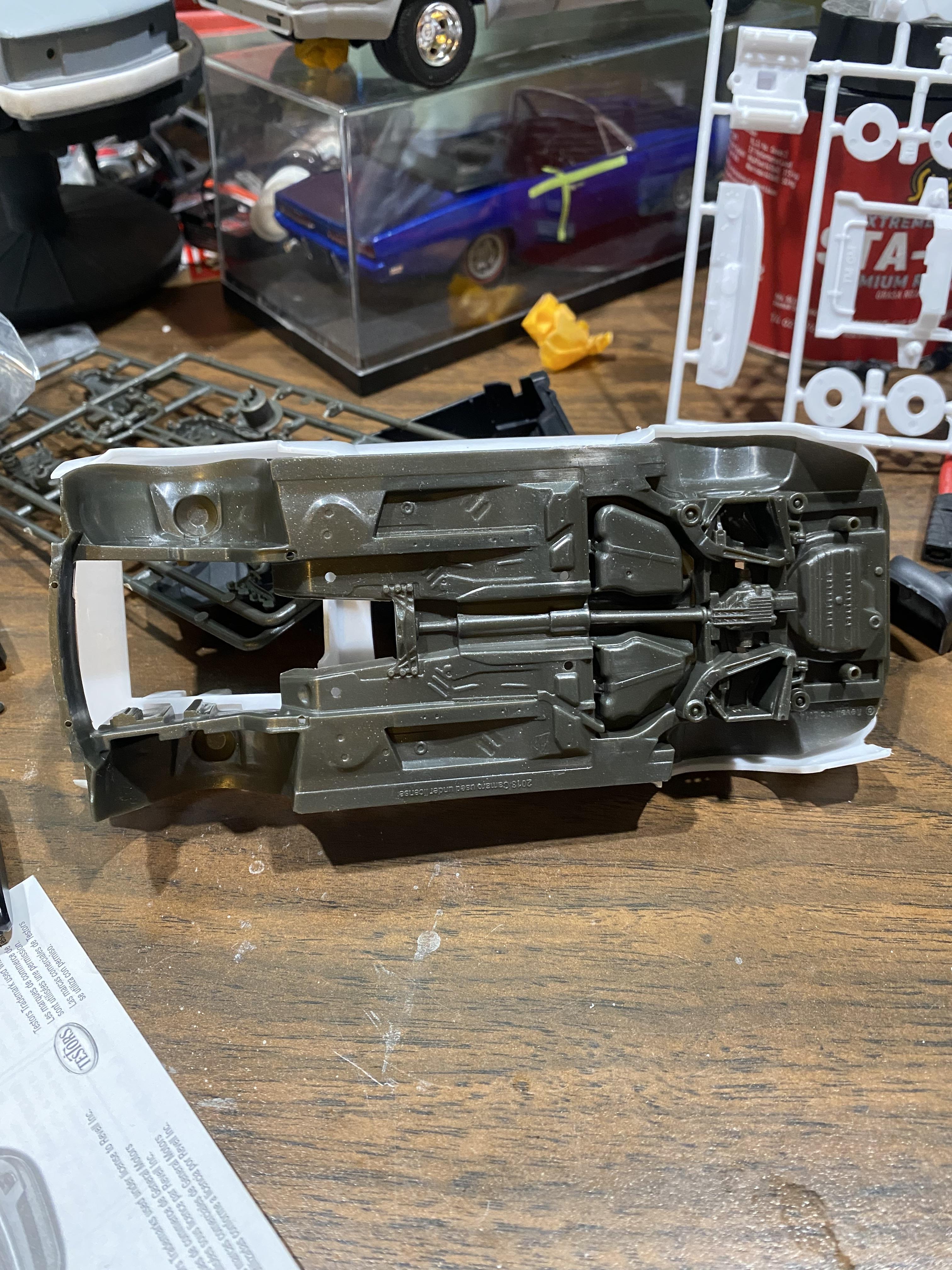

Thanks, this just looked like it would be interesting to do something crazy with since it is one of those “Meh” Malaise Era cars and kits both. That said though. I have been debating on painting it with colors similar to the Travolta Fever Firebird since that is how this kit started it’s existence. I had thought about shortening the chassis, but it’s otherwise pretty close in measurements unlike say putting a mid 00’s Ford GT chassis under a DeTomaso Pantera (there is a greater difference there), so I figured moving the wheel openings around would be easier in this case.
