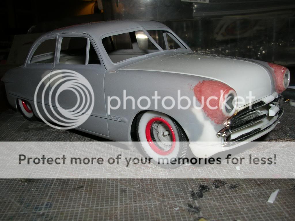

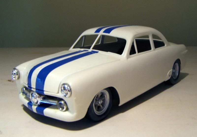

Bernard Kron Posted May 29, 2015 Author Posted May 29, 2015 (edited) Thanx again guys. Glad I can provide some inspiration. Modelbldr Tom, that's nice work on your '49 grill. It's slimmer and lighter looking than the modified '51 grill I used. I also think that resin tends to add thickness to most pieces, something I had to compensate for when I used my Modelhaus grill. I trimmed the bumper splashpan like you did. Anyhow, once you're done... - Allcad or replate? Also, those tunneled headlights are really fine. Are you using aluminum tubing for the buckets? I started a couple of projects a few years back where I also modified some '49 grills. On this one I lowered and simplified the stock grill to fit in the AMT custom grill surround. I landed up thinning the rolled pan a bit to go with the lighter look. I landed up pinching the chassis for a '50 convertible mild custom so it's still sitting in the box... This second one was modified to incorporate rod lamps in the corners. The car was intended to be a road racer with a Weber carbed Ford small block under the hood. Again, sitting in its box contributing parts to other builds and waiting for my return... Someday... Edited May 29, 2015 by Bernard Kron
