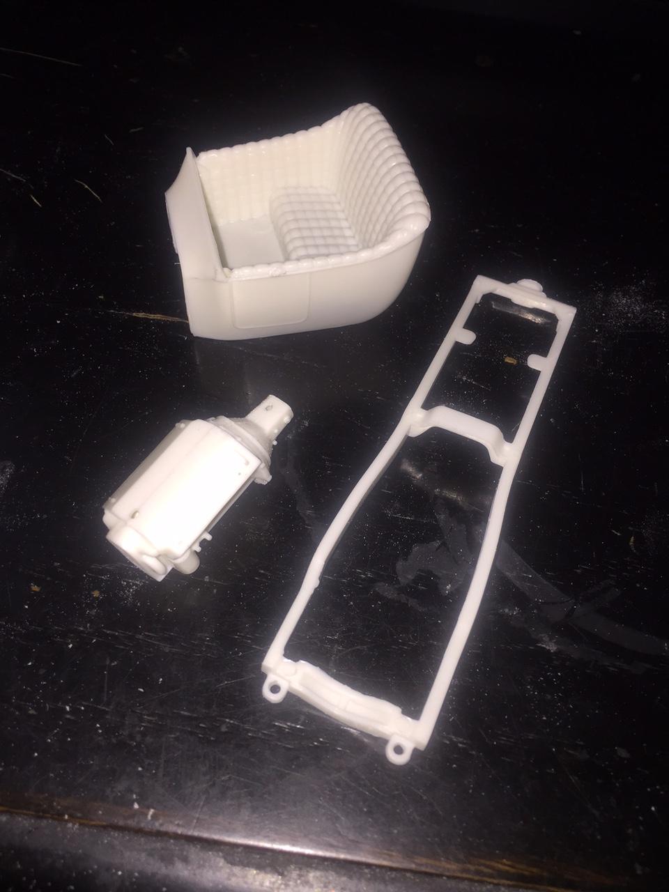

Darren B Posted August 3, 2015 Author Share Posted August 3, 2015 Thank you guys, another thing that I am deleting is the fake roll up curtains that they molded in over the fruit basket. No matter how well you paint it it just looks fake, getting some basic work done to get the engine halves together and sanding on the frame to smooth that out, that's where I am right now. Pics coming soon as soon as I have something substantial to post. Quote Link to comment Share on other sites More sharing options...

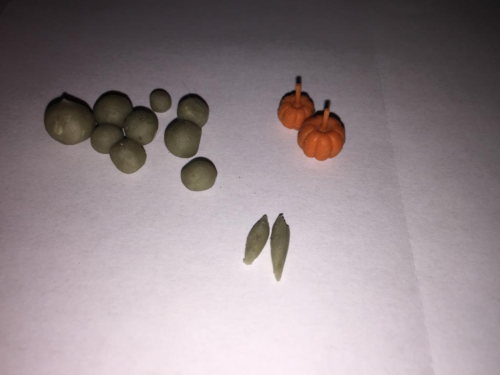

Pat Minarick Posted August 10, 2015 Share Posted August 10, 2015 I used some of the crayola air dry clay for these. Quote Link to comment Share on other sites More sharing options...
Darren B Posted August 10, 2015 Author Share Posted August 10, 2015 I used some of the crayola air dry clay for these. those look so real, and love the truck by the way, was it hard to do? just blend the two colors together then roll them out? I would be curious as how you did them..... Quote Link to comment Share on other sites More sharing options...
Pat Minarick Posted August 11, 2015 Share Posted August 11, 2015 Darren I used only the lime green color. After it dried out I washed over it with different green acrylic paint and cleared them with dull cote. I made the stems out of little pieces of railroad Lichen. Hope that helps. Quote Link to comment Share on other sites More sharing options...
Darren B Posted October 12, 2015 Author Share Posted October 12, 2015 I really like how the watermelons came out will have to try that.... Quote Link to comment Share on other sites More sharing options...

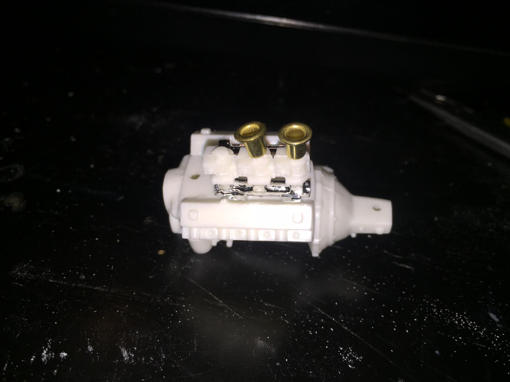

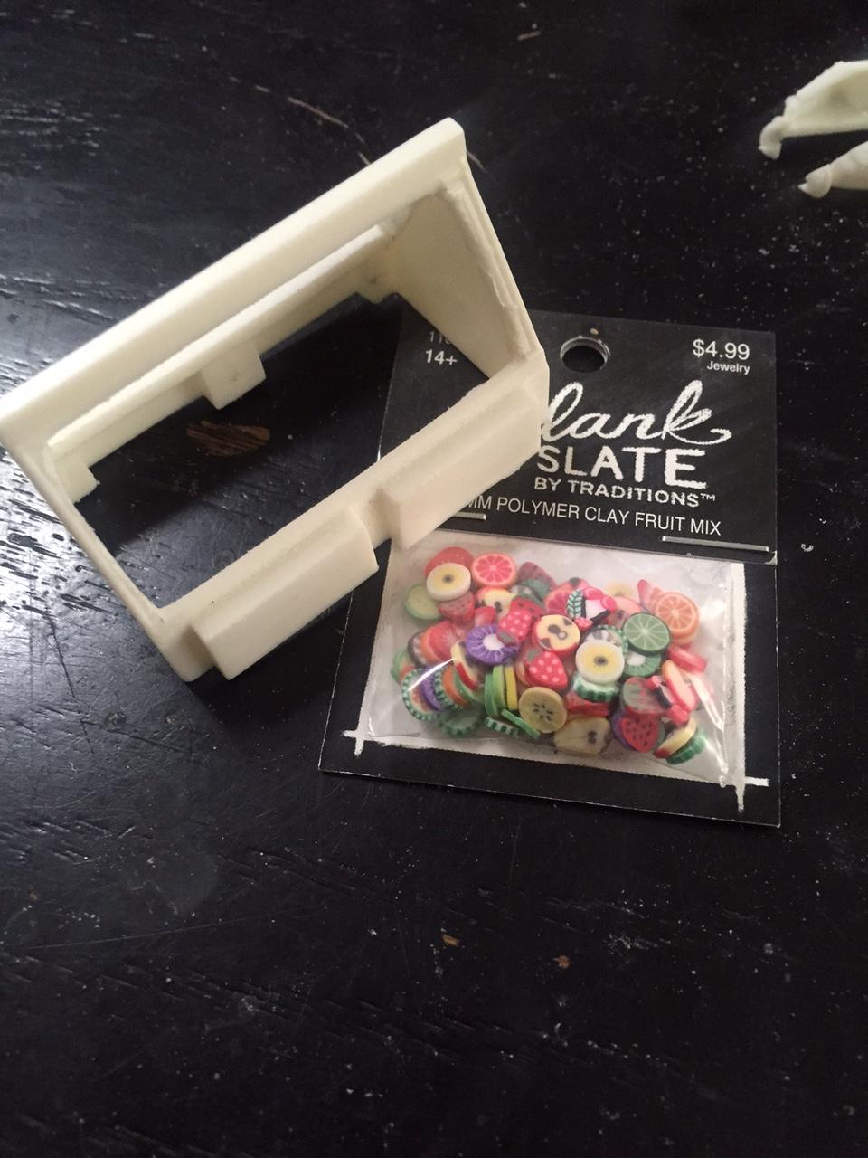

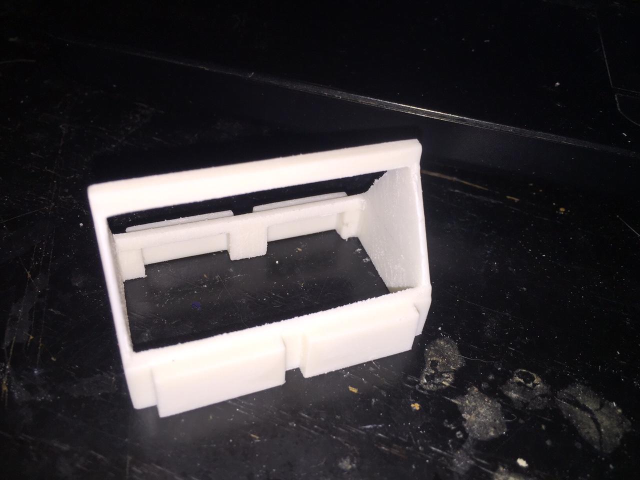

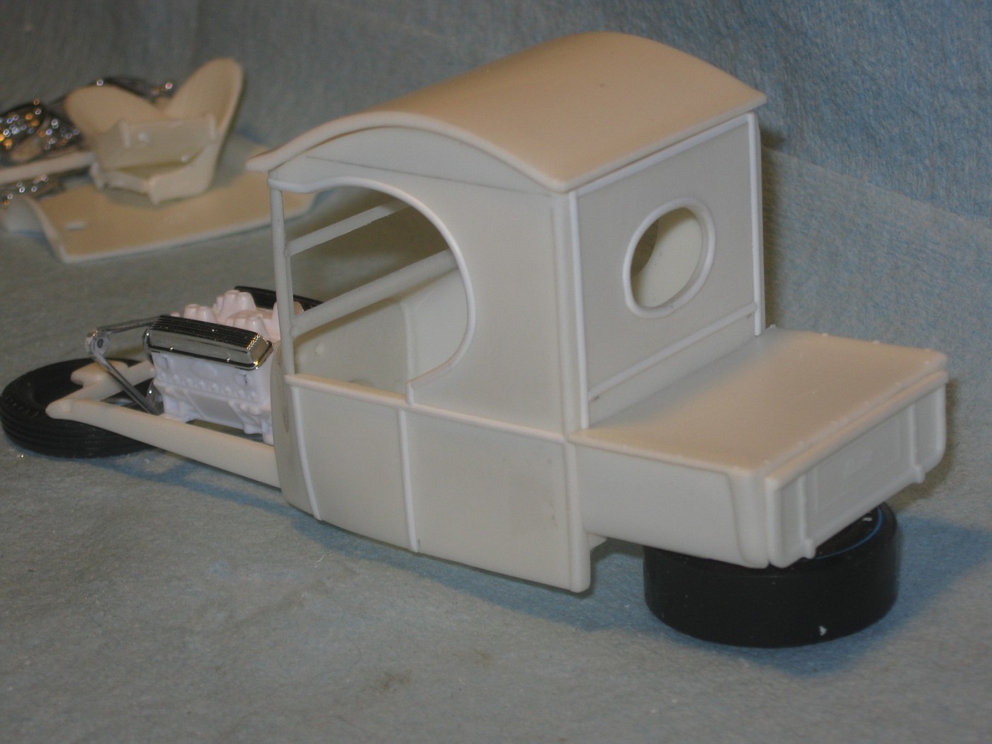

Darren B Posted October 12, 2015 Author Share Posted October 12, 2015 (edited) Have been working on just cleaning up parts and working on the engine, needing to find some reference on how the fuel rail looks on the real engine, but plugging away at this one...one thing I am changing on the engine is the stacks for the carbs are horrid to work with to get them to look good after removing from the sprue so decided to use these metal do dads from the rc end of the hobby shop for stacks..... and getting the fruit box cleaned up and ready to add shelving to it.... moving slow but steady on this one! Edited October 12, 2015 by Darren B Quote Link to comment Share on other sites More sharing options...

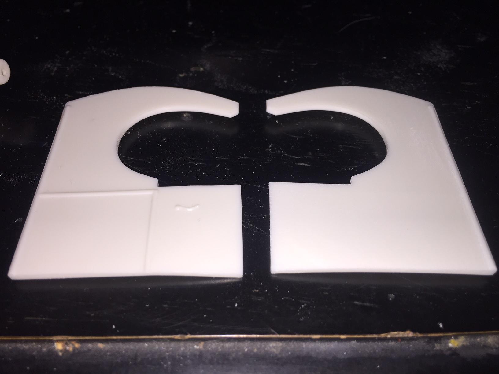

Darren B Posted October 12, 2015 Author Share Posted October 12, 2015 Also getting rid of any raised detail and either will scribe new lines or use strip styrene... Quote Link to comment Share on other sites More sharing options...

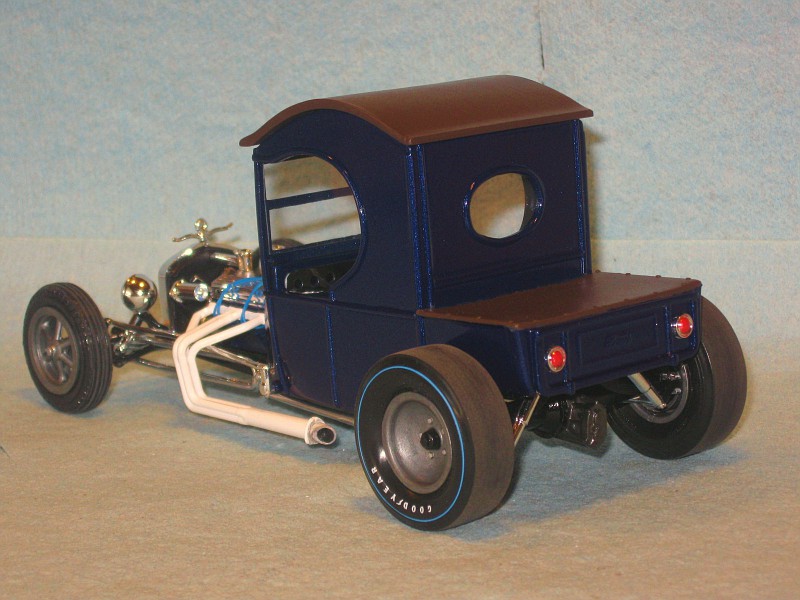

Dennis Lacy Posted October 13, 2015 Share Posted October 13, 2015 (edited) Neat project! I redid the body character lines and added a bunch more using .040" half-round strips around the "C" openings, to the back of the cab and around the back window. Getting it to conform around that back window took some major patience! Something has to be done like this or that body looks like a slab. Hosted on Fotki Hosted on Fotki Edited October 13, 2015 by Dennis Lacy Quote Link to comment Share on other sites More sharing options...
slusher Posted October 13, 2015 Share Posted October 13, 2015 Looking good Darren, really interested in seeing more of your work on this. i have a 29 AMT ford i was thinking of using for something similar... Quote Link to comment Share on other sites More sharing options...
Darren B Posted October 14, 2015 Author Share Posted October 14, 2015 Neat project! I redid the body character lines and added a bunch more using .040" half-round strips around the "C" openings, to the back of the cab and around the back window. Getting it to conform around that back window took some major patience! Something has to be done like this or that body looks like a slab. Hosted on Fotki Hosted on Fotki That is really cool, love the like of the half round, never gave that a thought but will be adding that for sure, looks so much better thank you for sharing with me will give it a really good look. Quote Link to comment Share on other sites More sharing options...

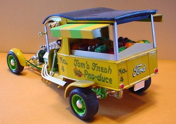

Dave Van Posted October 14, 2015 Share Posted October 14, 2015 (edited) Long ago when the Fruit wagon was a very rare kit......but I wanted one...I built my own version. I made it from a Paddy Wagon kit. The fruit and veggies are made from oven clay painted. Easy to make. Edited October 14, 2015 by Dave Van Quote Link to comment Share on other sites More sharing options...
Darren B Posted October 14, 2015 Author Share Posted October 14, 2015 Long ago when the Fruit wagon was a very rare kit......but I wanted one...I built my own version. I made it from a Paddy Wagon kit. The fruit and veggies are made from oven clay painted. Easy to make. NICE i love your version not to mention all the ideas you just gave me for the sides... thank you for sharing looks like ill have to get me some clay everybody's clay work is better than painted epoxy sculpt.... Quote Link to comment Share on other sites More sharing options...
