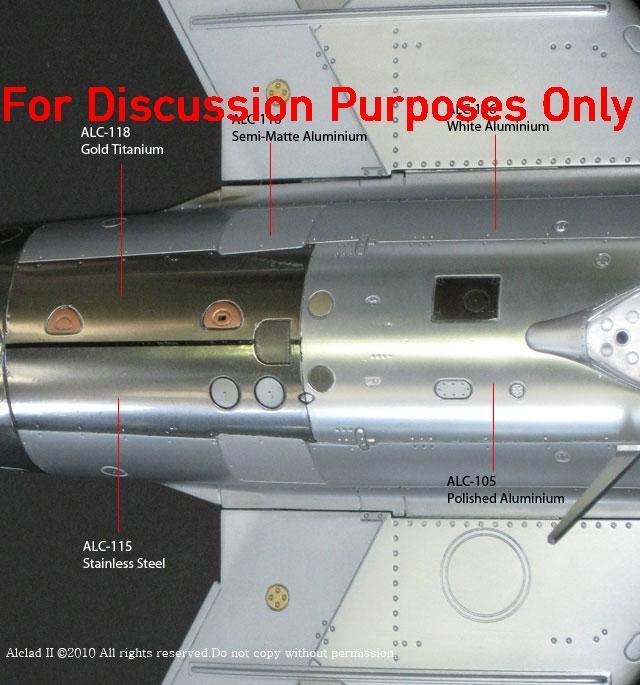

Odd. Contact Alclad and ask them if there's a solution. Gold Titanium is supposed to have a noticeable, but not solid, pale gold color. Check out the photo.

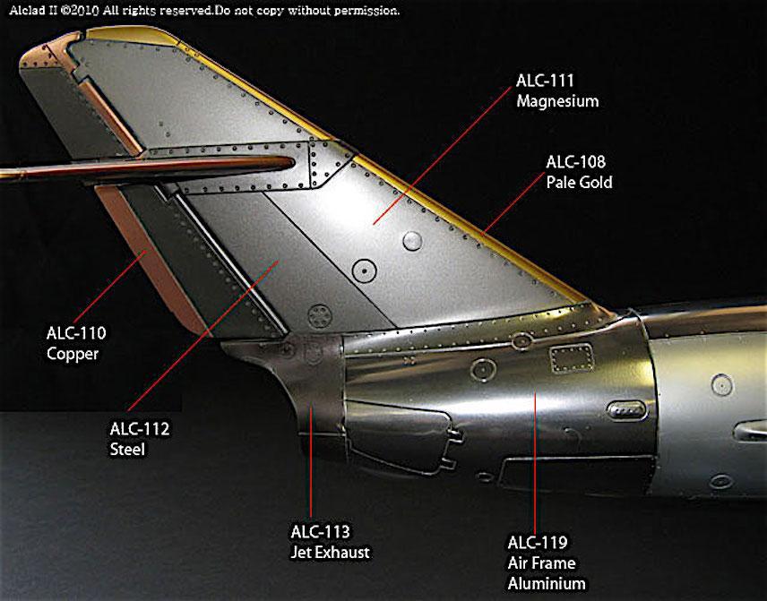

Here's the photo from the Alclad website... looks more like silver than gold to me...

It isn't. If you bothered to check the photo link, you'd see that isn't the case:

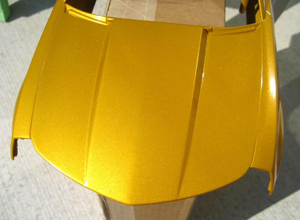

This paint does seem to be transparent to some extent. I ahve had good results when a silver base is used. Tamiya does have  a spray TS-87 Titanium Gold which works great. the gold parts on this Nissan interior are TS-87 airbrushed.

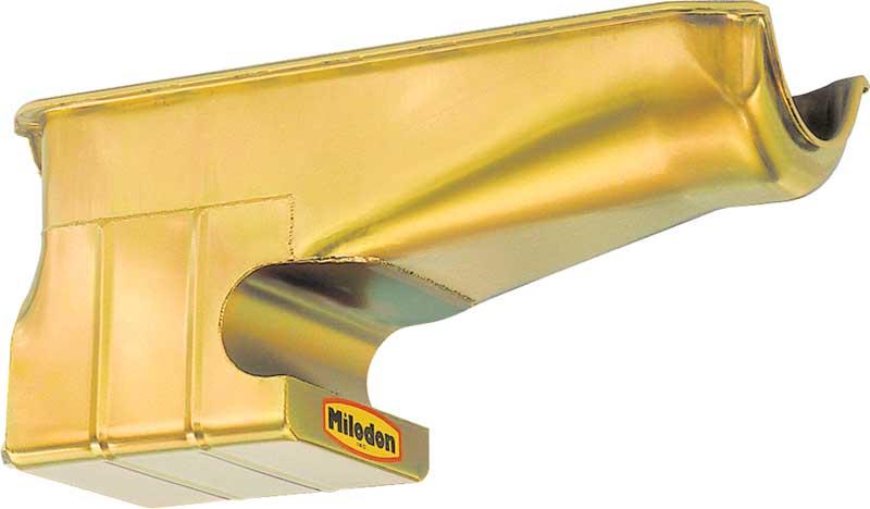

I appropriate everyones input. The 1:1 color I'm trying to match is this Milodon deep sump oil pan or at least come close to it. Does anyone have any suggestions. The Milodon catalog says it has a gold finish. I`m open to suggestions.

Yep..it a pretty strong color. Unfourtunatly did check the Alclad color chart before purchasing the titanium gold...my miss-step.
I`m now considering trying Testors Inca Gold lacquer
Testors_Inca_Gold_One_Coat_Lacquer..thum
or possibly trying Alclad II ALC #108 Pale Gold
Pale_Gold__108.thumb.jpg.cdd140b48328188
Any thoughts on which is a better match to the oil pan.
Edited by 69NovaYenko
Share this post
Link to post
From that picture it looks like Pale Gold would be a good match, but I have that Alclad paint and I don't think it is as intensely yellow as the photo above shows. The Inca Gold looks like even better match.  Problem with the Testors paints is that the metallic particles in them are rather large and they look like metal flake paint instead of metallic finish.  You might want to browse the fingernail polish section of your local grocery store or drug store - you might find something that works.

Alclad Pale Gold would be a good one to use. Titanium Gold, like the others have said, is not a dominantly gold color.

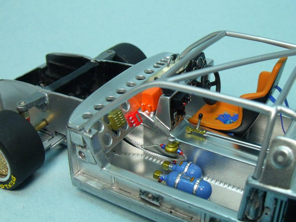

Alclad Pale Gold is what I used on the bumpers, wheels, exhausts and bits on this model (the shinier stuff is BMF):

Just to let you folks know what I finally did to match the color of the Milodon deep sump oil pan. First, you all gave some great suggestion and couldn't decide which was closest the  Alclad Pale Gold or Testors Inca Gold; so I got my hands on both and did a side by side test. The winner was Testors Inca Gold because the  intensely of the goldish/yellowish tint was a much closer match. As pointed out by Peteski, in an earlier comment,the only issue with the Testors paint was the metallic flakes in it. I resolved this by top coating the Testors Inca Gold with Alclad II Klear Kote Flat and it majorly toned down the metallic flake.
