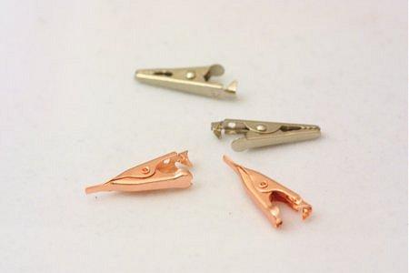

935k3 Posted February 16, 2016 Posted February 16, 2016 (edited) If you have a Radio Shack near by you can get the really small clips(the bare copper in pic below.) with no teeth. Crimp them on Bamboo Skewers and you have great way to hold parts. After painting stick the other end of stick in a block of Styrofoam till dry. i also drill into parts and insert wire leads to clip on to. Edited February 16, 2016 by 935k3
