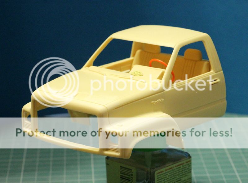

As I am American Medium Duty  trucks fan, I can't stand to work (make a model) on this one.
autowp_ru_gmc_c7500_topkick_dump_truck_2
The only thing I will change is the rooth. I like standart one. And I not sure about the bumper. May be I will use the stock one. I bought the resin on e-bay couple years before. I guess it's Perry's:
The grill is fited to suit.
There are couple fuel tanks and acumulator boxes in kit. Plus chequered plates and buckles for hood and boxes in separate bag:
I like this kit. Quality of the cast rather high. No boubles.
There is pimple on a back wall, like the real cab has. Also bottom line need correction.
Door handles are made through
Interior tub is flat as usuall.
I have PDF with dimensions, so I can say the scale of a kit is something between 1/24 and 1/25.
Toolbar sits rather high. Next photo shows it better.
 The steering wheel is too small for this truck. It's a pitty - no head lights lenses or wind screen in a kit. No instruction too.....

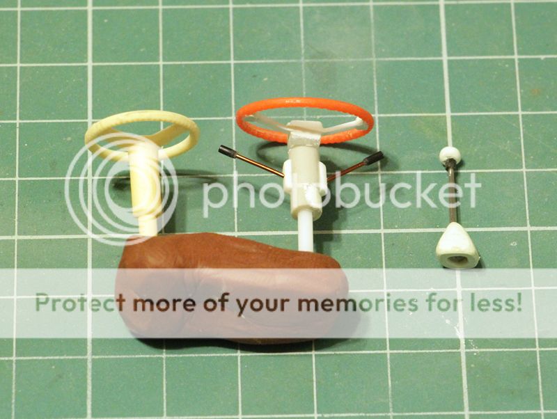

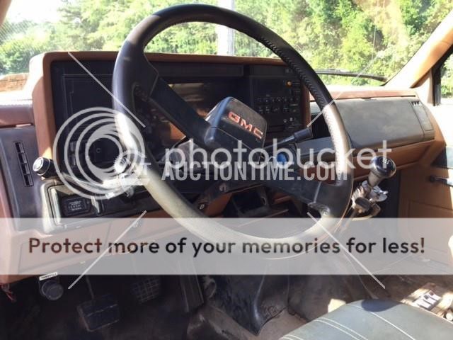

So, the steering wheel has been remade. I used the rim from Ford LNT kit. The rest of steering wheel are styrene, epoxy patty, wire, piece of sprue. Though Ford's rim is 1mm bigger, then TopKick one should be it has an ideal cirkle.
I also made the gear shift lever.
14_zps6uxlcskj.jpg~original
Here is how it should be:
21_zpsab24d3vy.jpg~original
I also filed down the bottom and back side of the dash. Now it sitssits a litle lower.
25_zpsrgw4nuhw.jpg~original
Almost like at home. Erly Tahoe and Silverado have the same cab and dash.

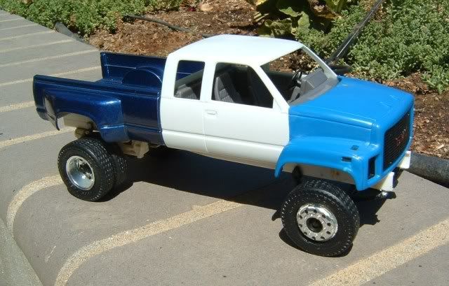

Nice work.  Here's one I started about 5 years ago.  The front clip is from a DG Productions model.  I plan to switch to Moebius tires and wheels.
Share this post
Link to post
Thank you guys! Hey Craig! Where is that bed from?
I guess the cab is Silverado's?

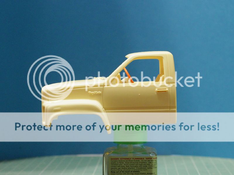

The more I work on TopKick cab, the more imperfection I found....
Here we see, that the bottom of the back wall of the cab is not parallel to under grill bar. So the cab/hood is twisted slightly.
Here headlight niche was depressed on hood corners. Stock state on the left.

Sorry for the delayed response, I haven't been on the site in a while.  The cab and bed are from AMT's C-3500 phantom dually kit.  I had lowered the original kit and made bigger rear tubs to fit the tires.

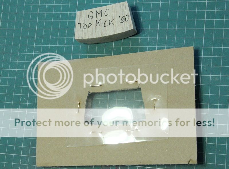

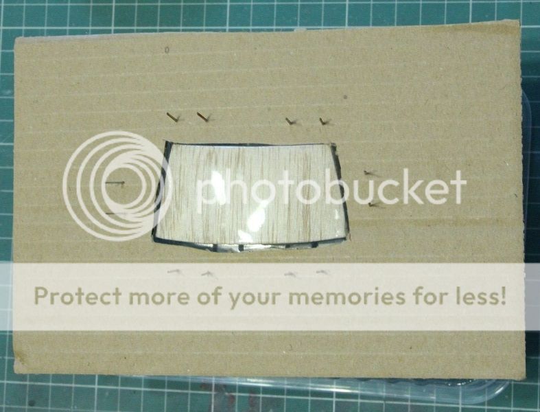

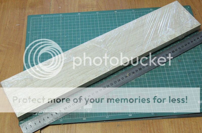

Small update. Here I made a blank (I hope it correct word) from balsa wood.
IMG_6798_zps39d2itom.jpg~original
Stick a plastic to frame
IMG_6799_zpsvxqv2uir.jpg~original
Warmed it over gas oven and cover a blank with plastic.
IMG_6800_zpsqbcujrjt.jpg~original

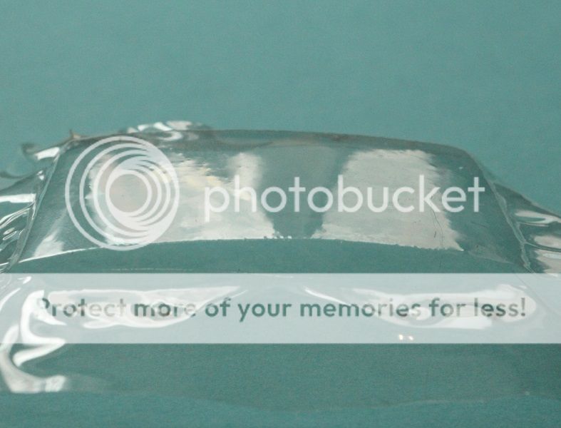

Unfortunatelly plactic goes covered with very small pimples. Plastic thickness is 0,1mm.
IMG_6802_zpsxco5yli5.jpg~original
Why could it happen?
