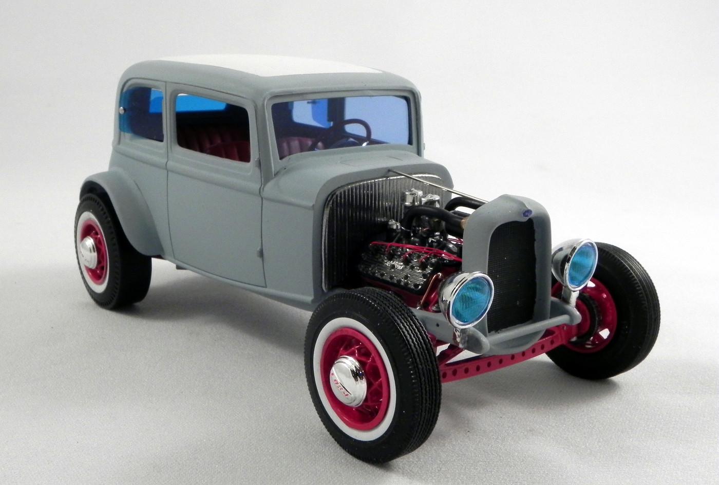

Ace-Garageguy Posted April 8, 2017 Share Posted April 8, 2017 (edited) Every car is different. You I do what looks best in each individual situation. Sectioned AND lowered here... The body has been channeled the full height of the frame rails, and the top of the rad shell lowered to line up with the cowl correctly. But this lowering ALSO would result in the bottom of the rad shell being below the pavement. A careful sectioning job corrects this, and also avoids to often poor proportions of heavily chopped rad shells. Even if you use a PE insert, it's fairly easy to customize it to for a sectioned rad shell EXACTLY with some precise work. Edited April 9, 2017 by Ace-Garageguy Quote Link to comment Share on other sites More sharing options...

Ace-Garageguy Posted April 9, 2017 Share Posted April 9, 2017 (edited) The importance of proportion and line can not be overstated when it comes time to do the rad shell. The original American Graffiti car had a rad shell that was sectioned too much, and always looked goofy to me. A shell with that much chopped out of it would be appropriate for a channeled car, but not one like this, where the body sits on top of the frame rails. A rework of the basic idea gets the rad shell looking right in relation to the rest of the car. See the difference? The BEST way to get the radiator shell right is to use a hood to mock up the top of it relative to the cowl, AFTER the body has been channeled the amount you want. THEN, figure out the amount of sectioning that will be required to bring the bottom of the shell up to where it won't be torn off on every speed bump. Edited April 9, 2017 by Ace-Garageguy Quote Link to comment Share on other sites More sharing options...
