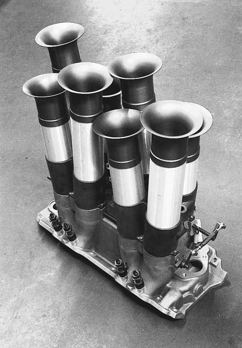

1) It depends entirely on how you set the car up, and
2) These ain't street setups...and they ARE smallblock manifolds.   ;)
Image result for smallblock chevy, long injector stacks
Another trick is to stagger the length of the stacks to broaden the torque curve...

I posted the top two pix to illustrate long stacks on smallblock manifolds.
I posted the last pic to illustrate staggered stacks on anything.

I posted the top two pix to illustrate long stacks on smallblock manifolds. the only relevant thing you posted.
I posted the last pic to illustrate staggered stacks on anything. funny, you didn't state that. by the way, again, that's NOT reason why the stacks that are pictured where staggerd.
