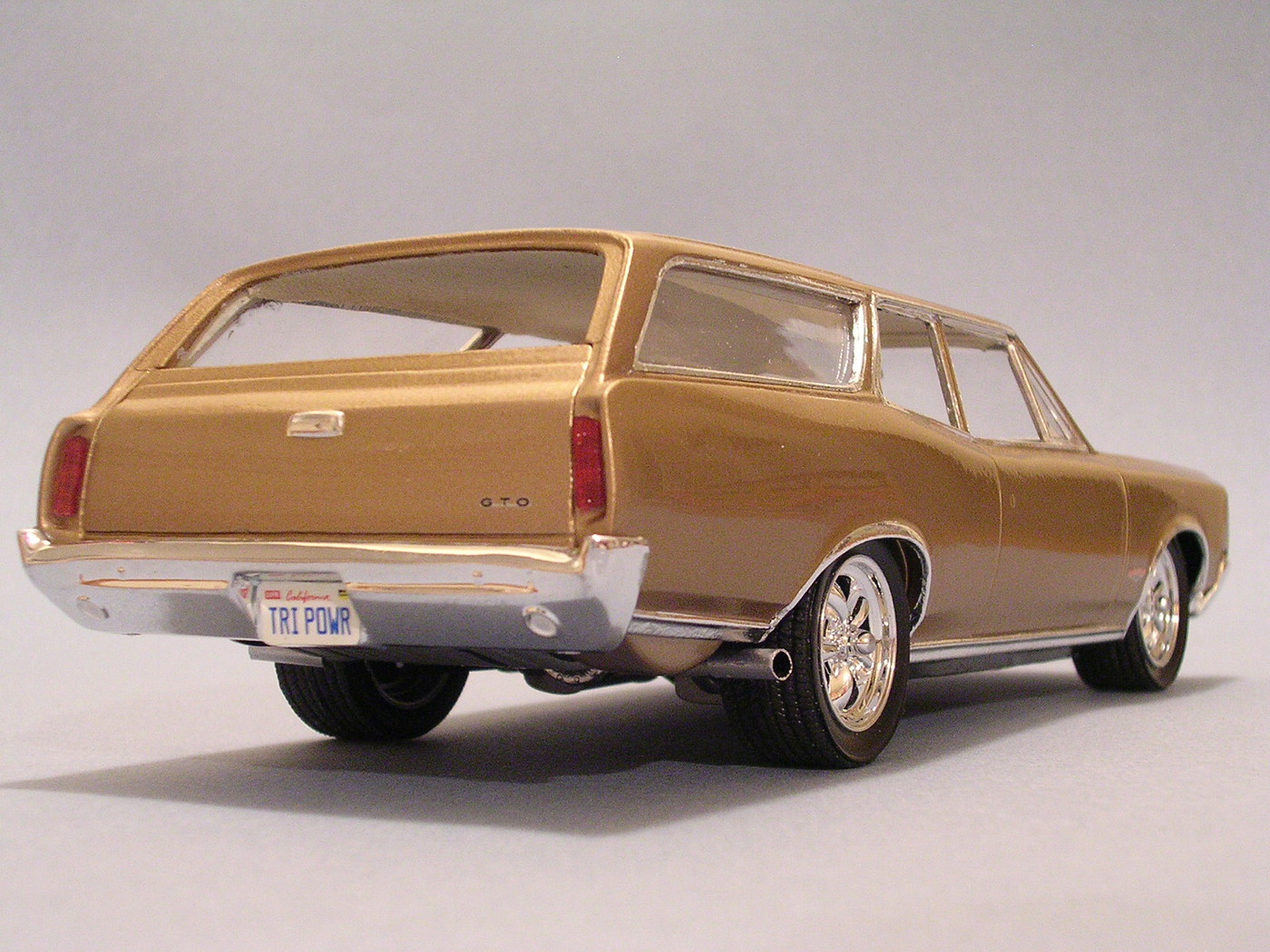

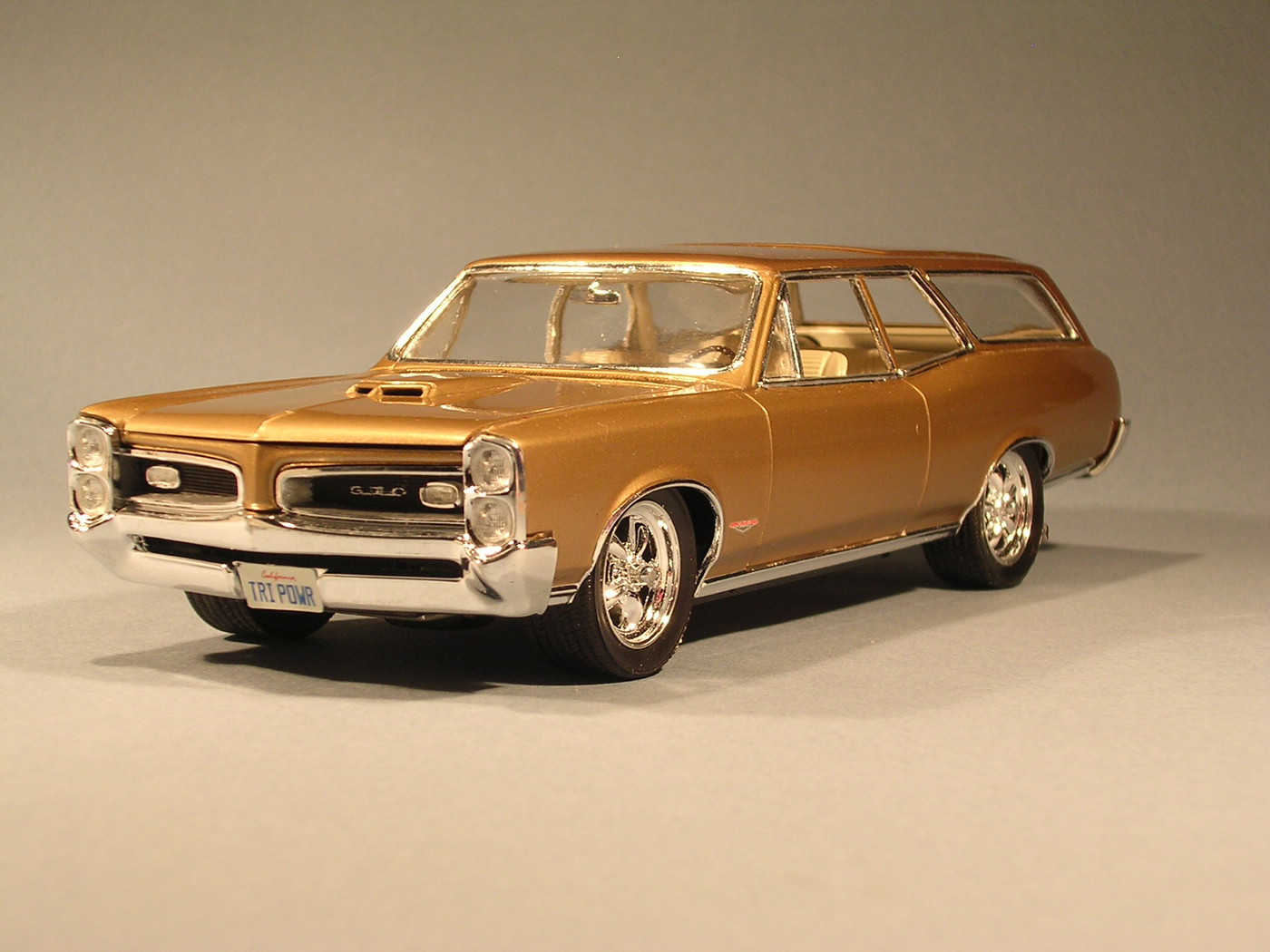

Karl Sheffer Posted January 2, 2019 Posted January 2, 2019 You mean something like this? I built this from the Revell 66 GTO and a 65 Chevelle wagon, before the 66 Chevelle wagon was released. I did it as a phantom 2 door wagon. I had to scratchbuild the taillight area to match a Pontiac. The 66 Chevelle wagon will get you there a little easier. Here is the link to my Fotki folder which also shows some of the cuts I did. https://public.fotki.com/kas1256/models/66-gto-wagon/
