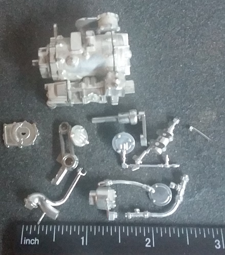

Gramps46 Posted August 2, 2019 Posted August 2, 2019 I have this turbine engine but I don't know where it came from and I think it might be too big for the Howmet.
aurfalien Posted August 2, 2019 Author Posted August 2, 2019 25 minutes ago, Gramps46 said: I have this turbine engine but I don't know where it came from and I think it might be too big for the Howmet. Thanks Gramps. It's a cool looking engine but doesn't look close to the Howmet. Hoping some model aircraft guys would provide guidance as well. I was thinking of robing the appropriate jet aircraft model kit but unsure what would look close as there are just so many of those kits out.
Ace-Garageguy Posted August 2, 2019 Posted August 2, 2019 1) All turbine engines are not the same, and there are hundreds 2) The turbine model shown above is the ancient Revell parts-pack version, and does NOT represent any turbine engine that ever actually existed. 3) The Howmet cars ran Continental TS-325-1powerplants, derivations of the T-51, and were never put into real production. 4) For that reason, it's highly doubtful there's another model of the correct engine floating around. 5) The AMT kit provides decent bare-bones that would respond well to detailing based on the multitude of photos and info available on the engine. More info here:
aurfalien Posted August 2, 2019 Author Posted August 2, 2019 15 minutes ago, Ace-Garageguy said: 5) The AMT kit provides decent bare-bones that would respond well to detailing based on the multitude of photos and info available on the engine. Hi and thanks Ace. Darn, was hoping of an easier option. Welp, I guess making the included engine of the kit better is what a modeler would do. So I'll plan on that. Thanks again.
