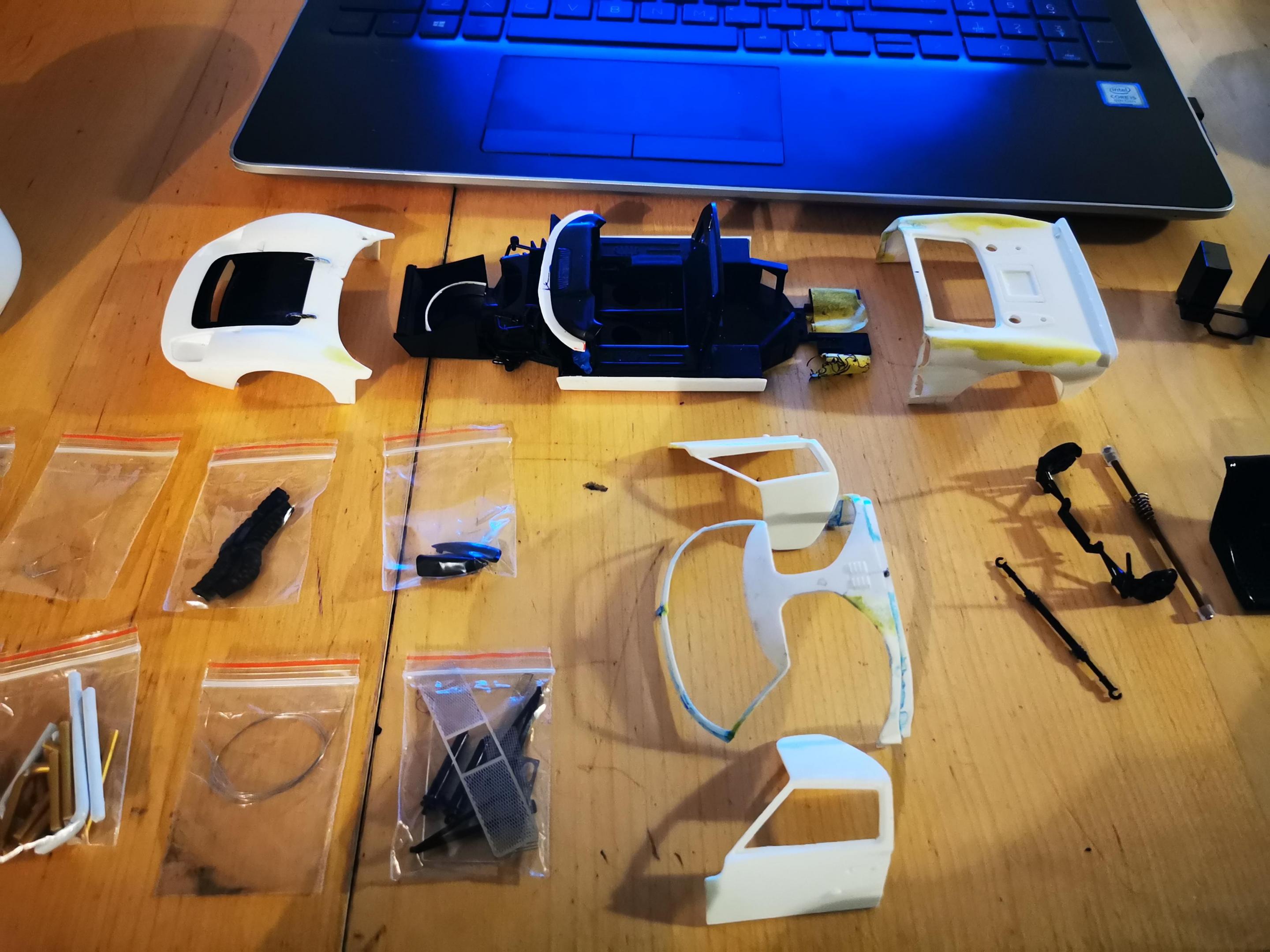

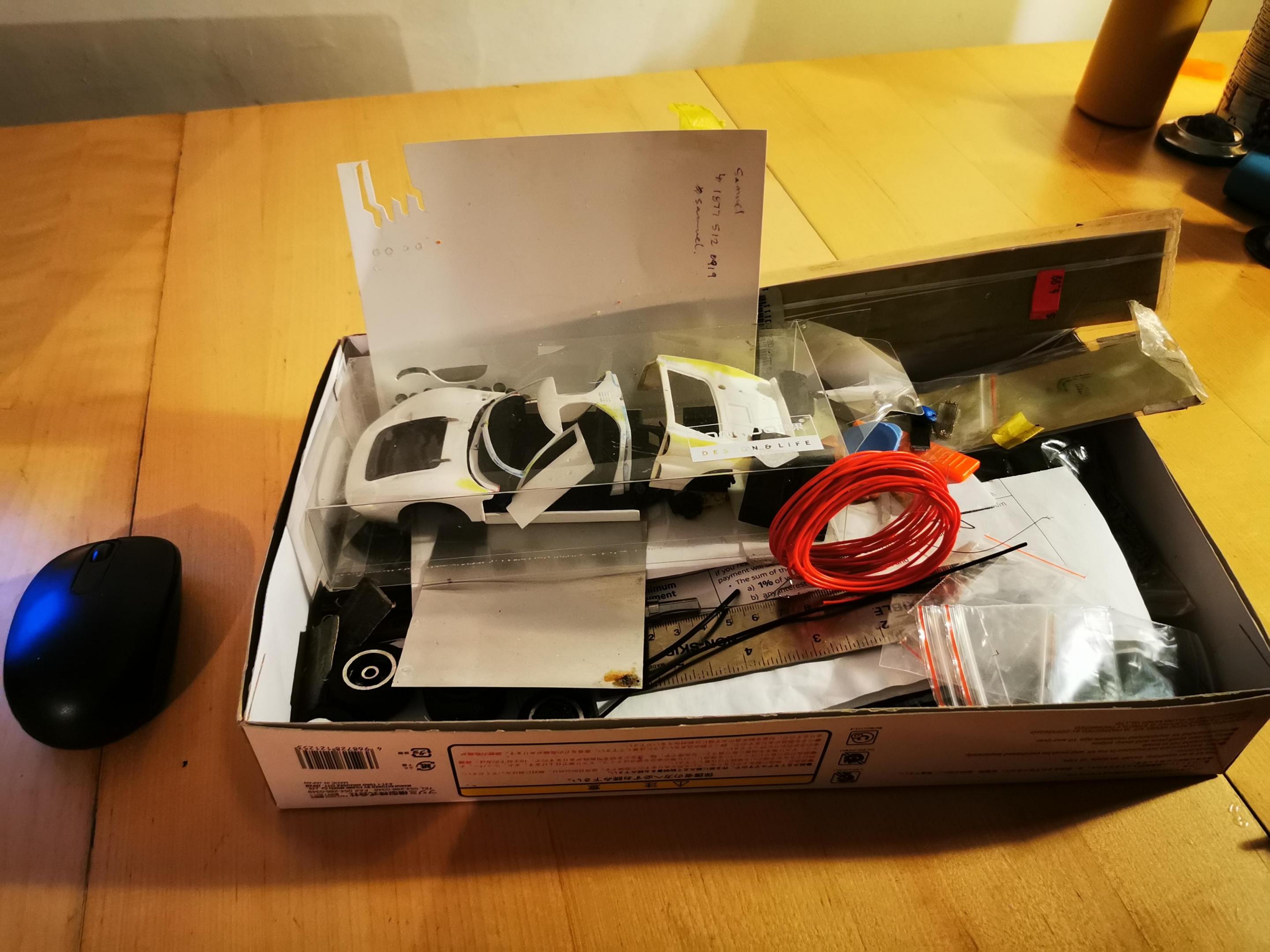

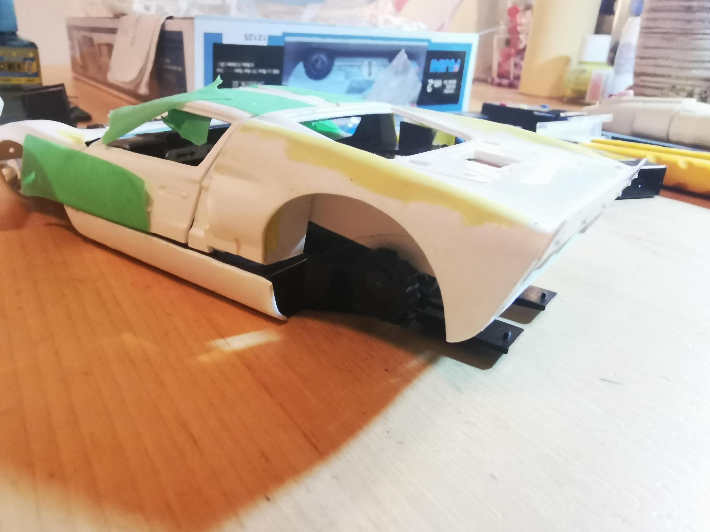

So after many years of not building a scale car, and having this kit in storage since 2010, I decided to take a break from building Gundam robots (as I normally do) and build up this GT40. This is also because of the COVID-19 quarantine that I have a lot of time to work on this.

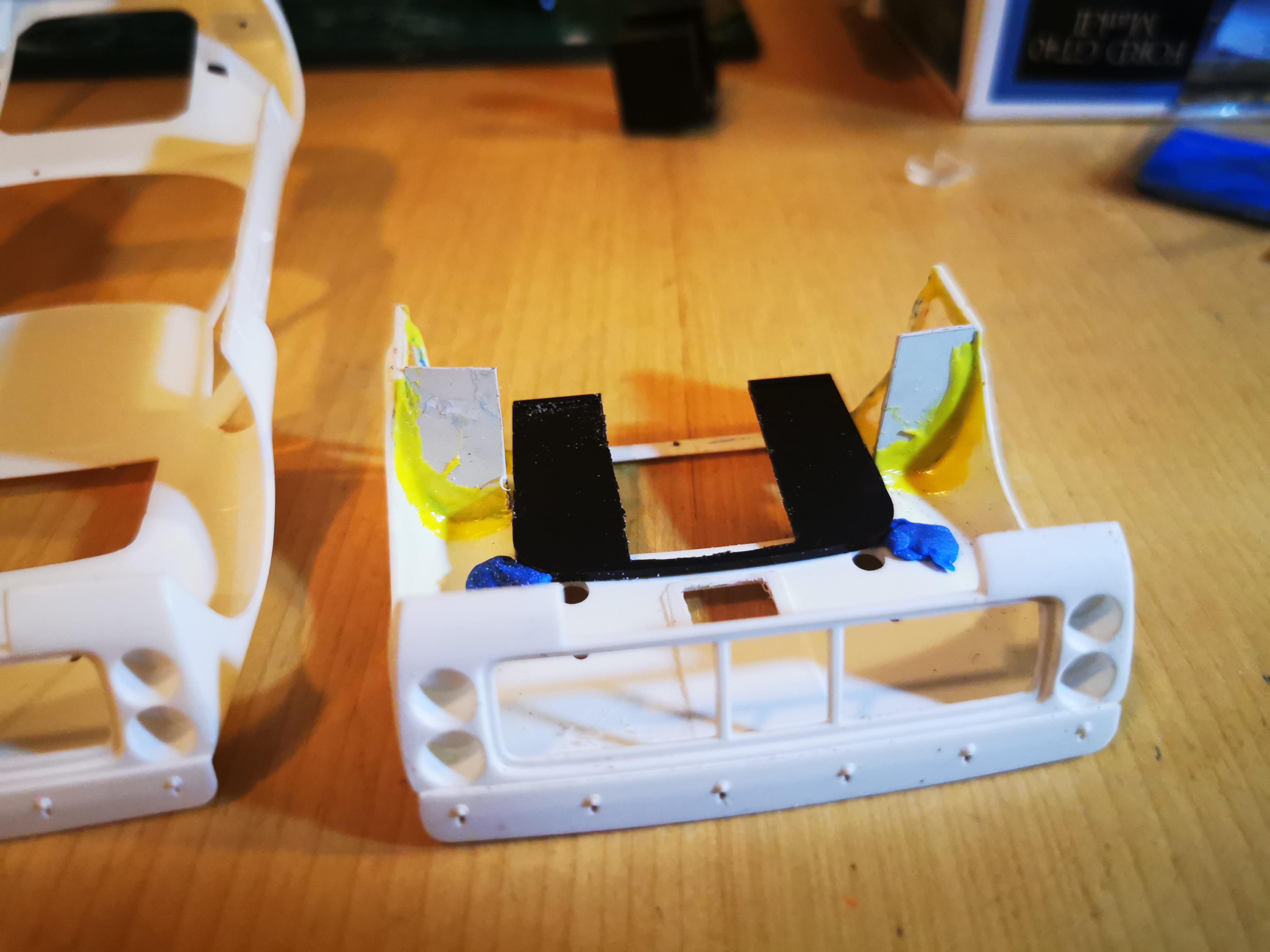

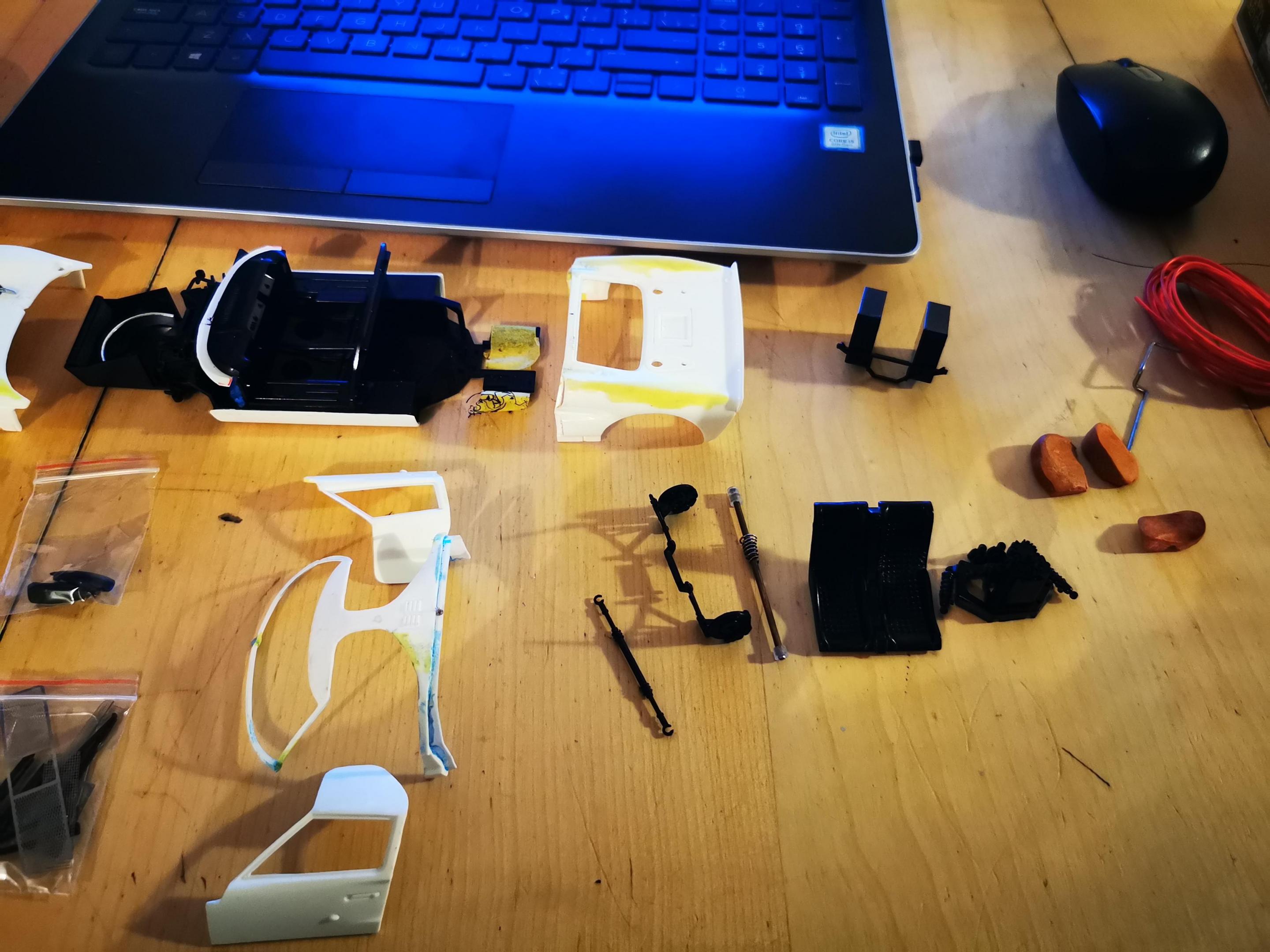

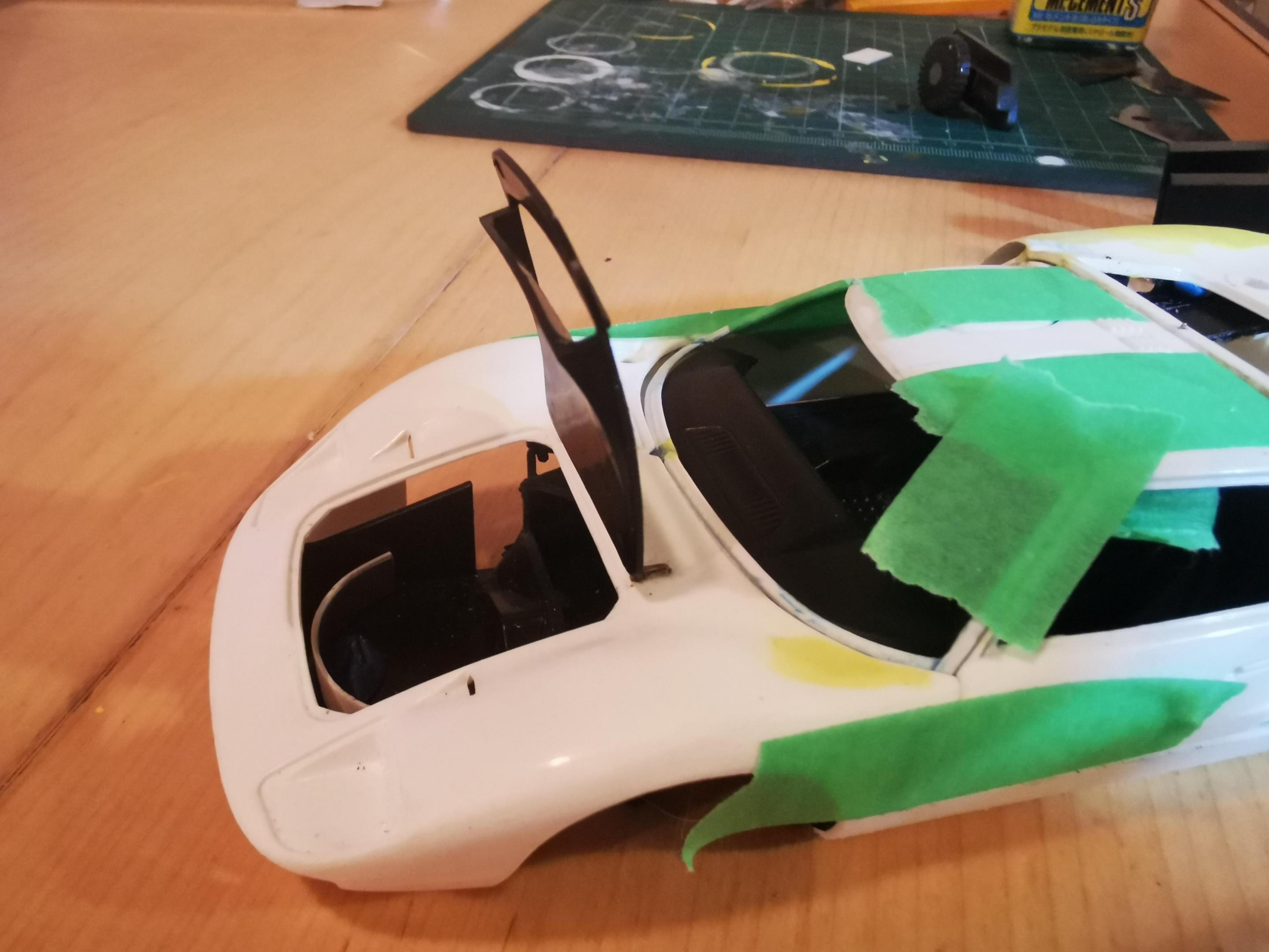

I decided to super detail this build, working doors, bonnet, trunk, working on scratch-building an engine..., rebuilding the front and rear suspension, putting in a working trunk hinge with cables, bonnet hinge, tire compartment, etc., etc..
I know some of these details can be done with the KA-parts super detail kit, or by using the IMC/Union kit as a base... but I had this in storage and lack of money pushes me to further my skills. Just wanted to share.

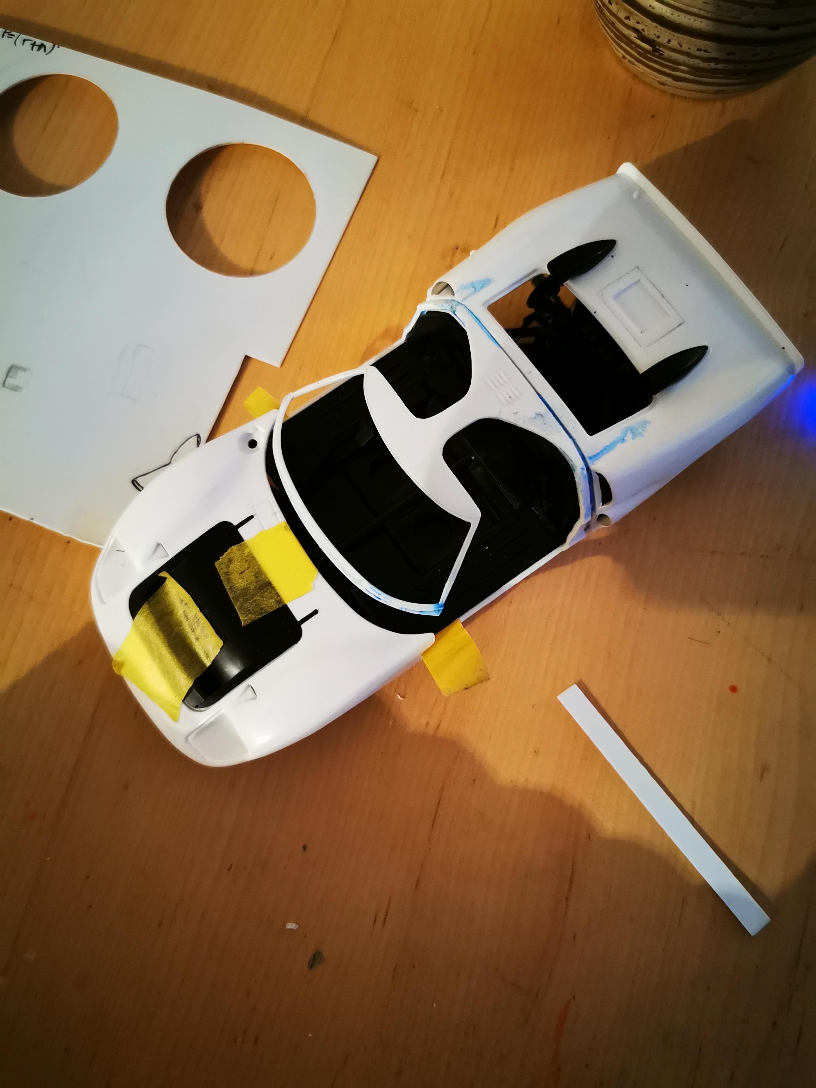

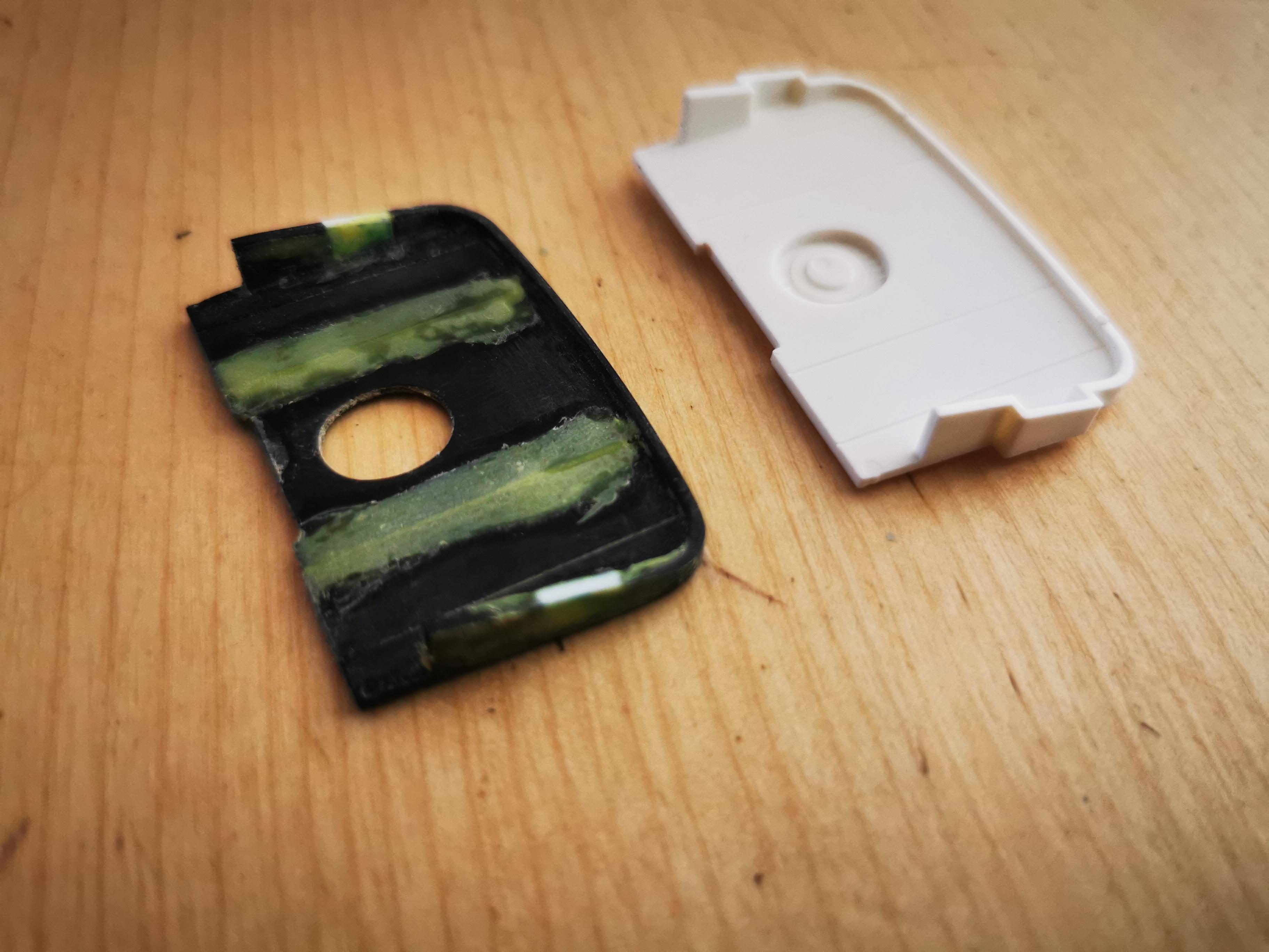

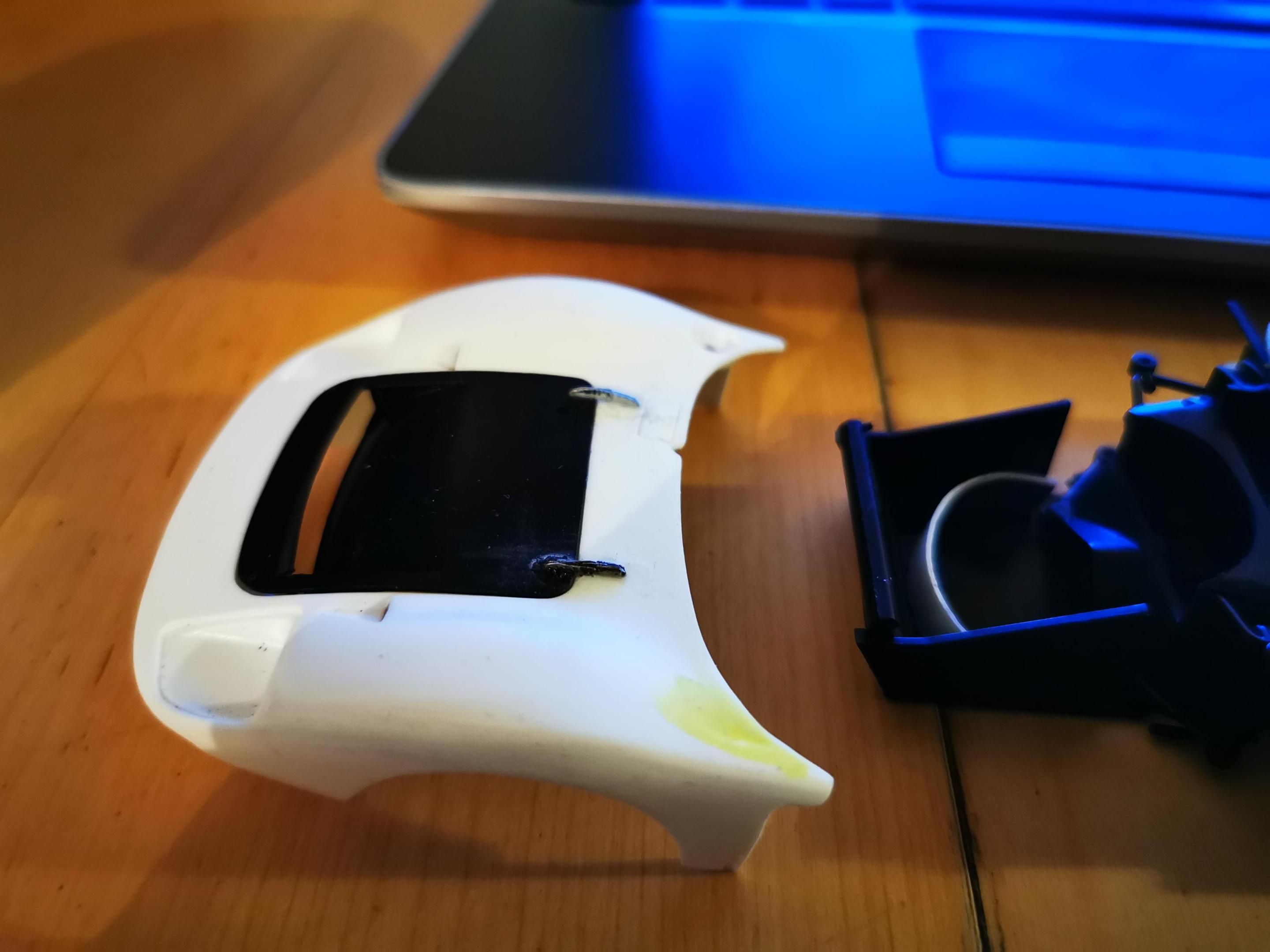

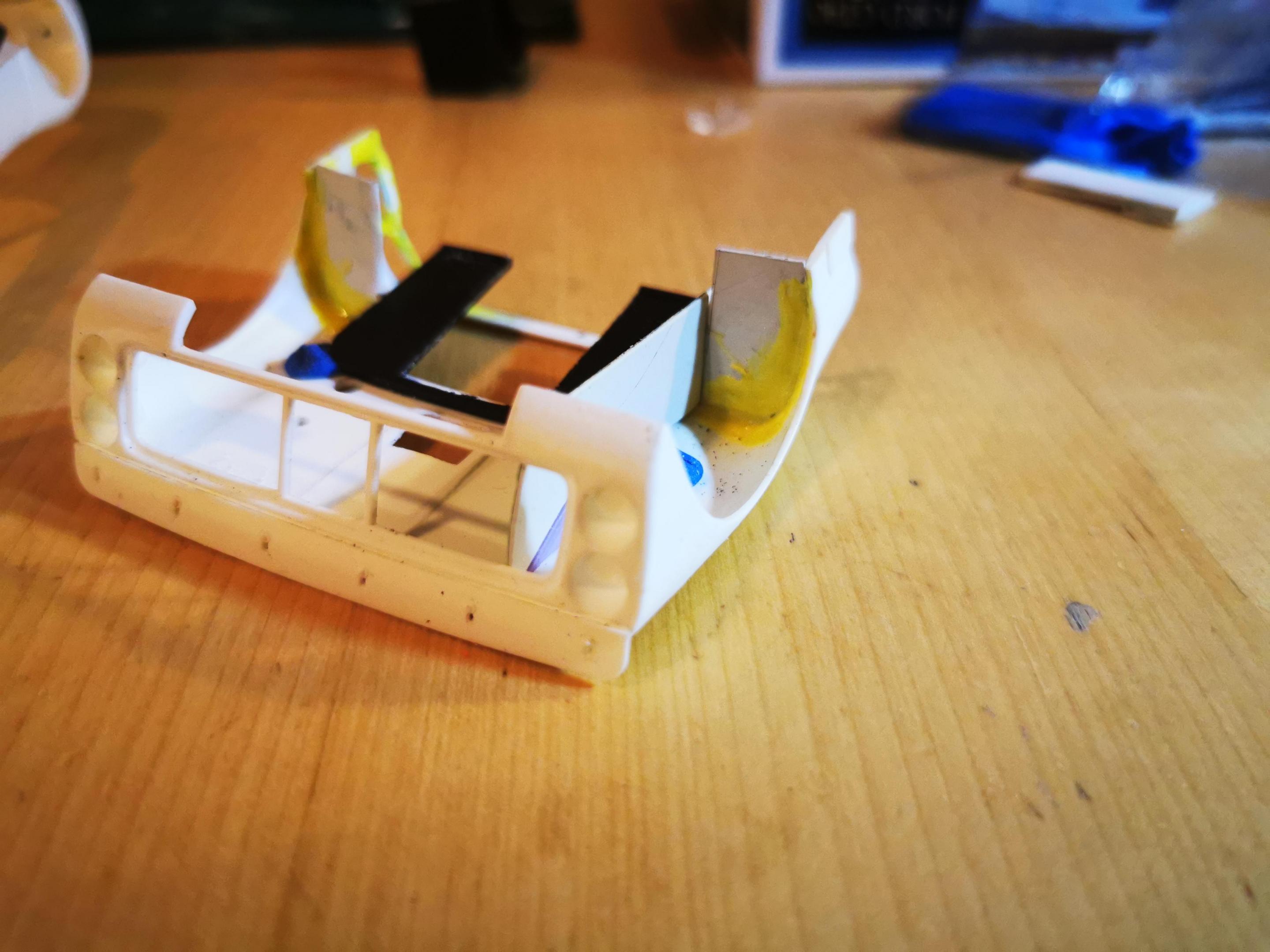

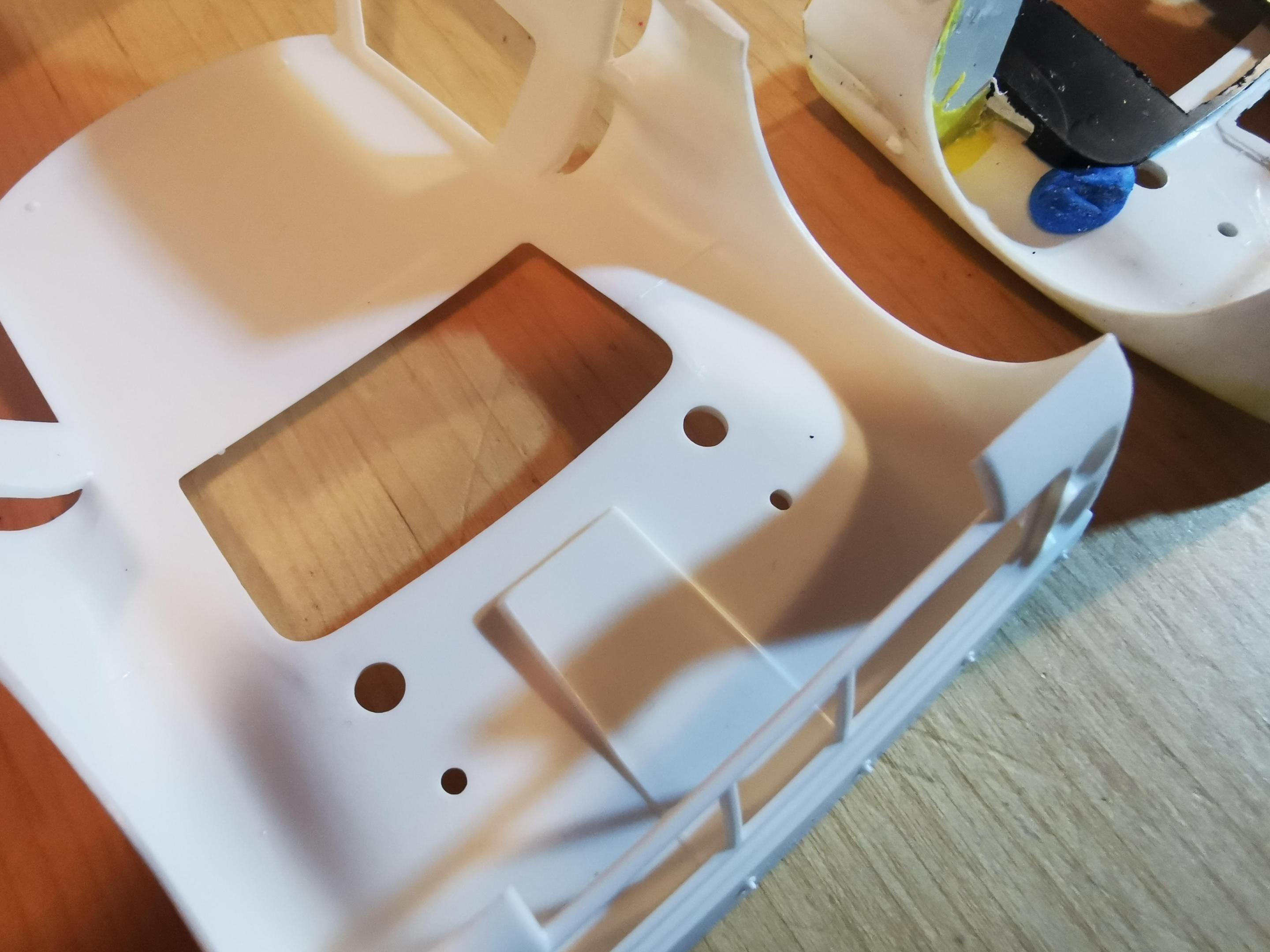

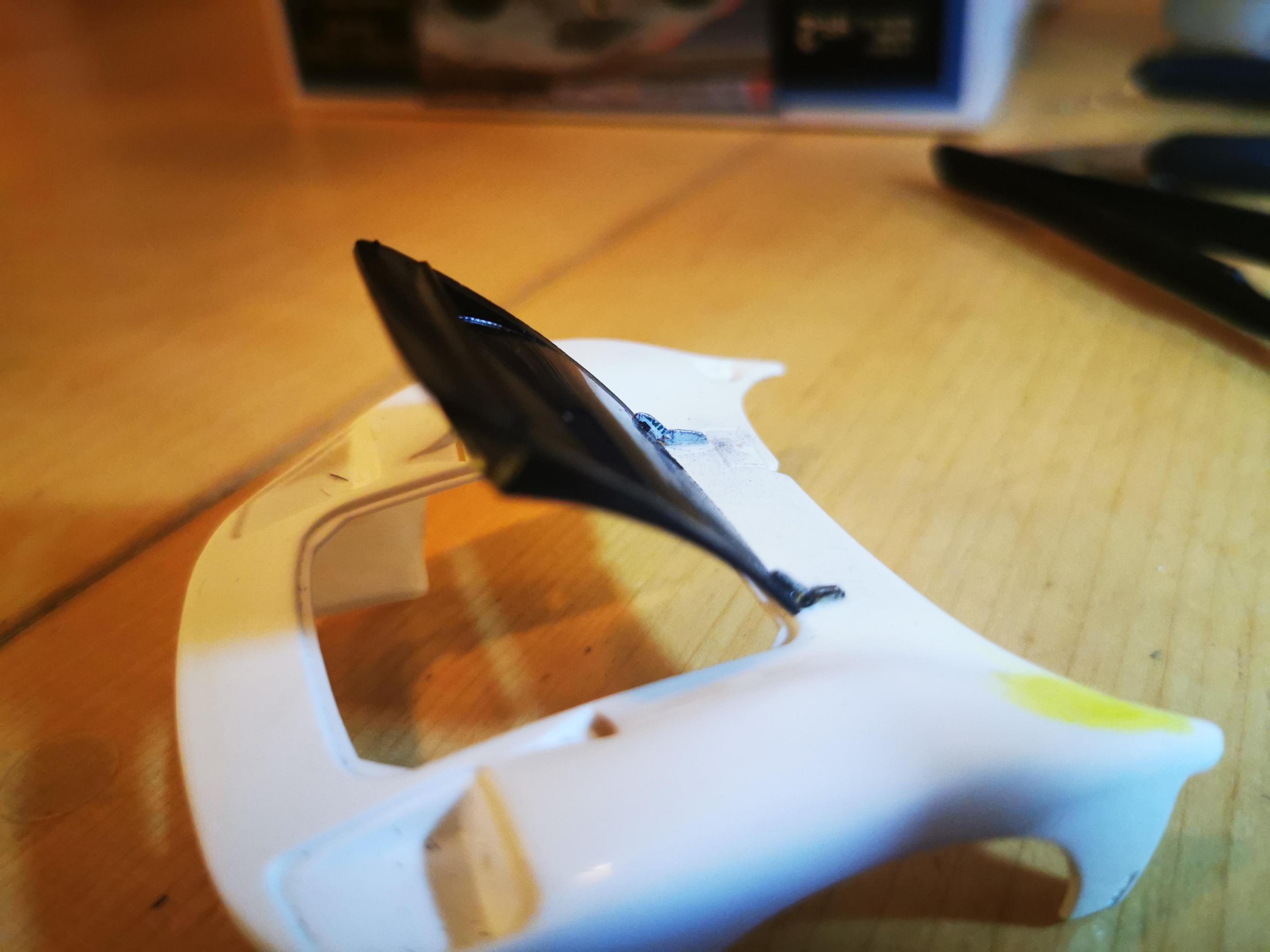

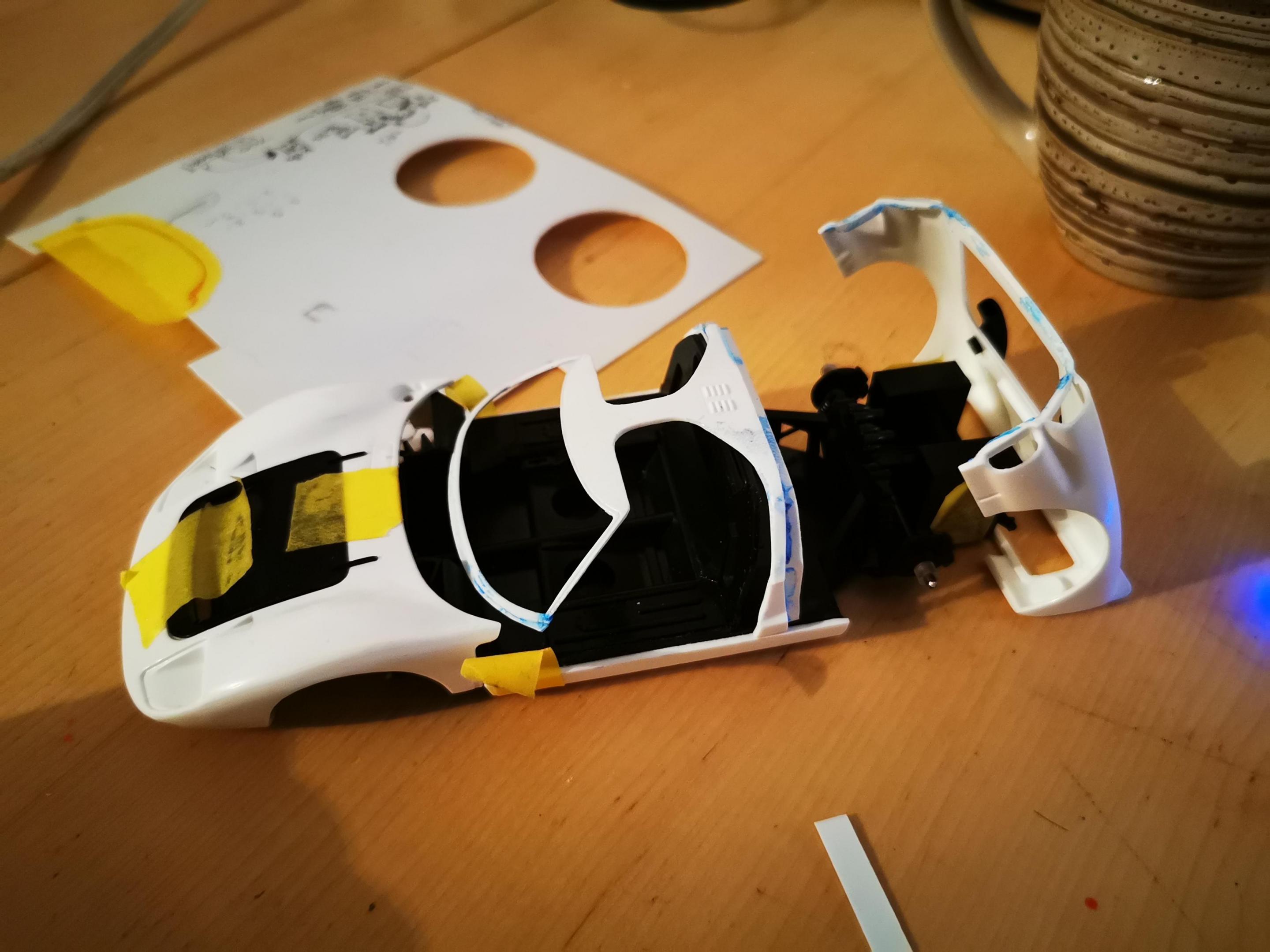

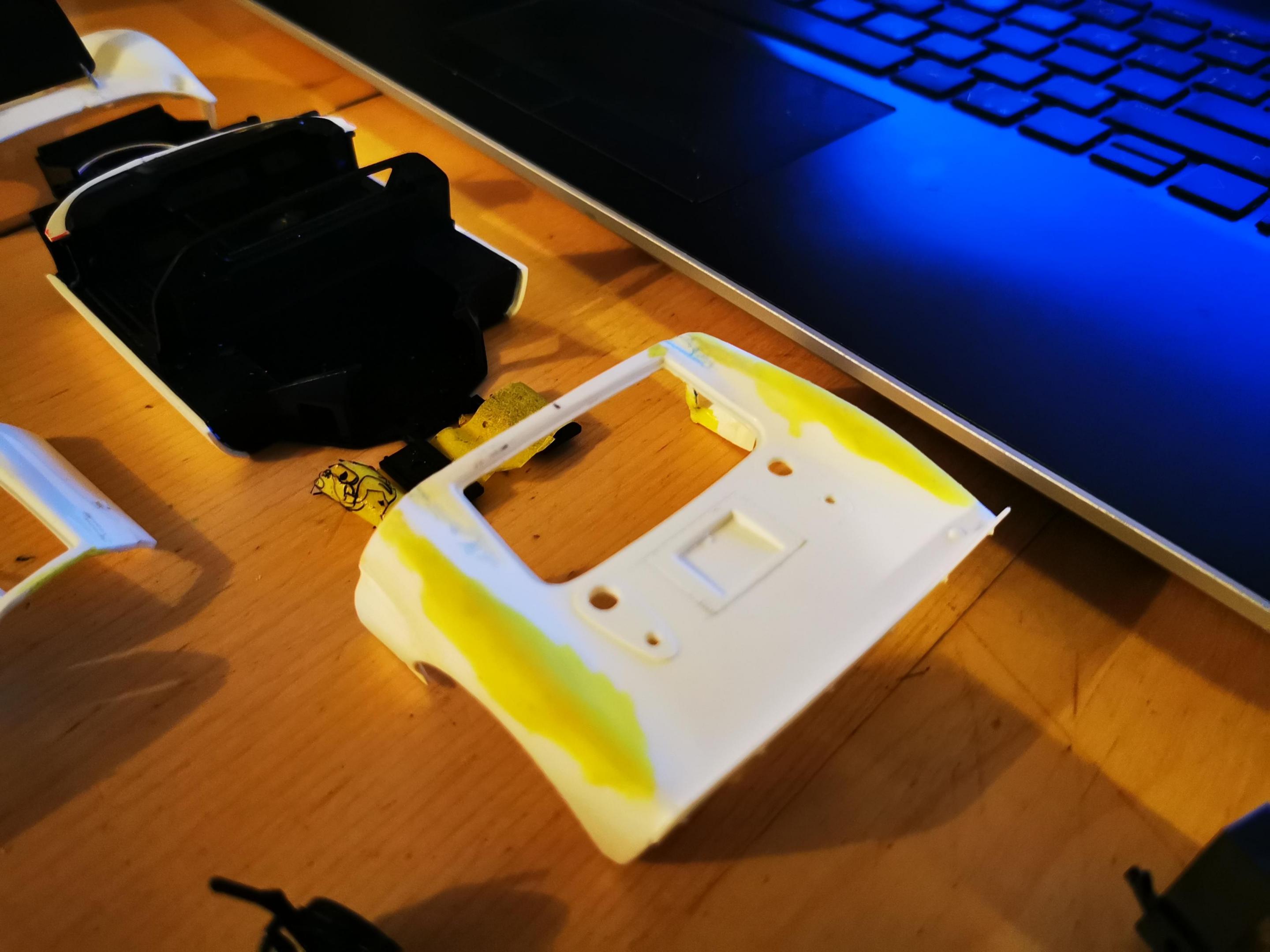

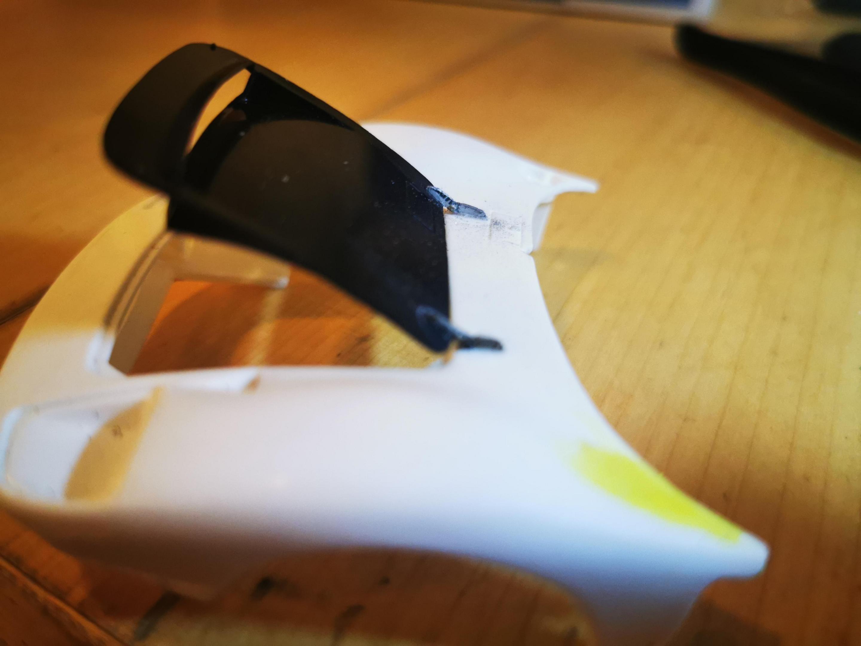

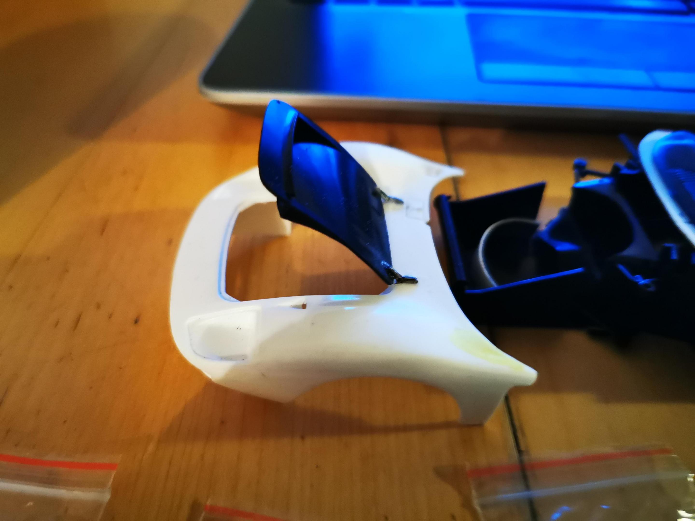

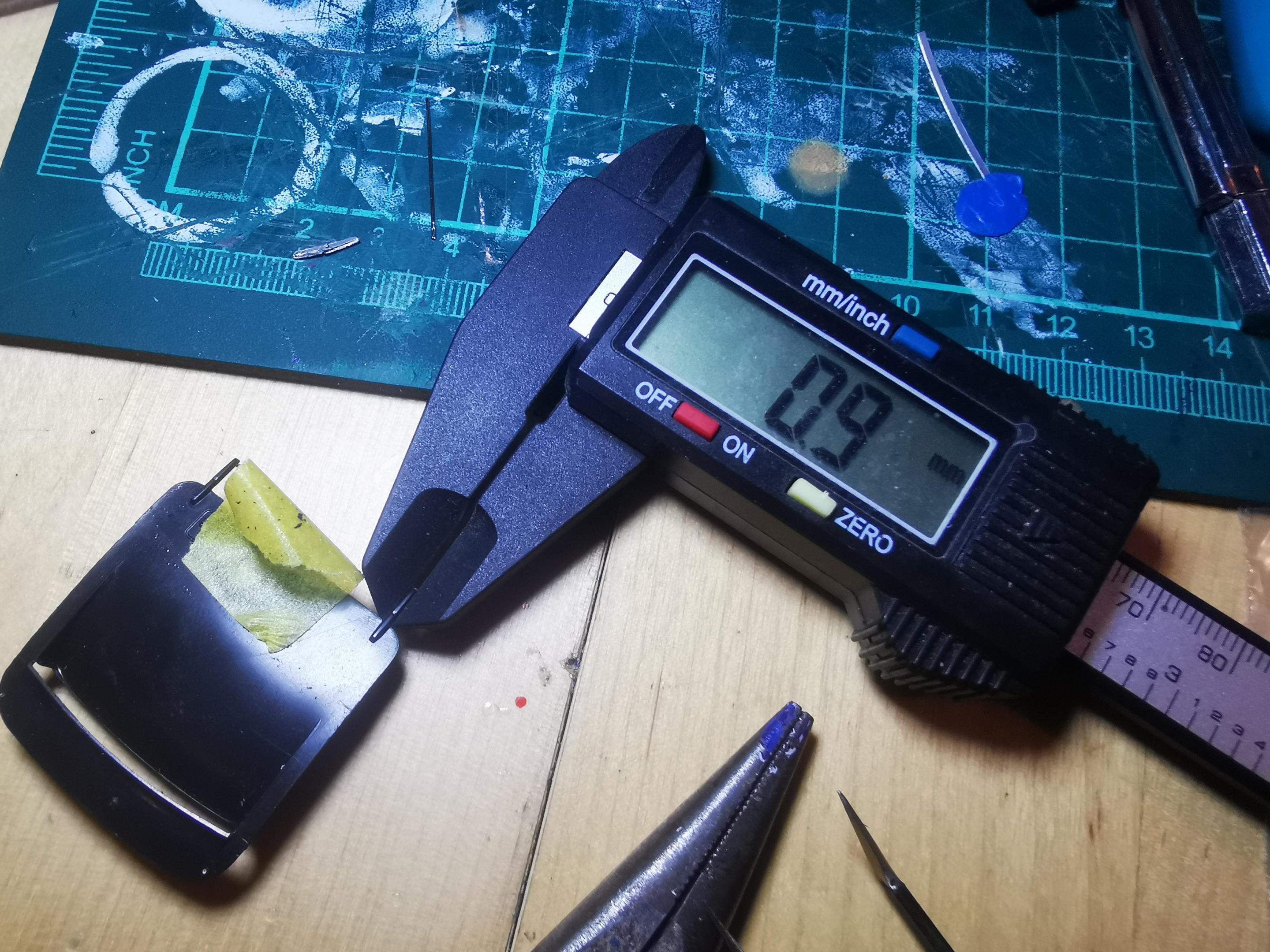

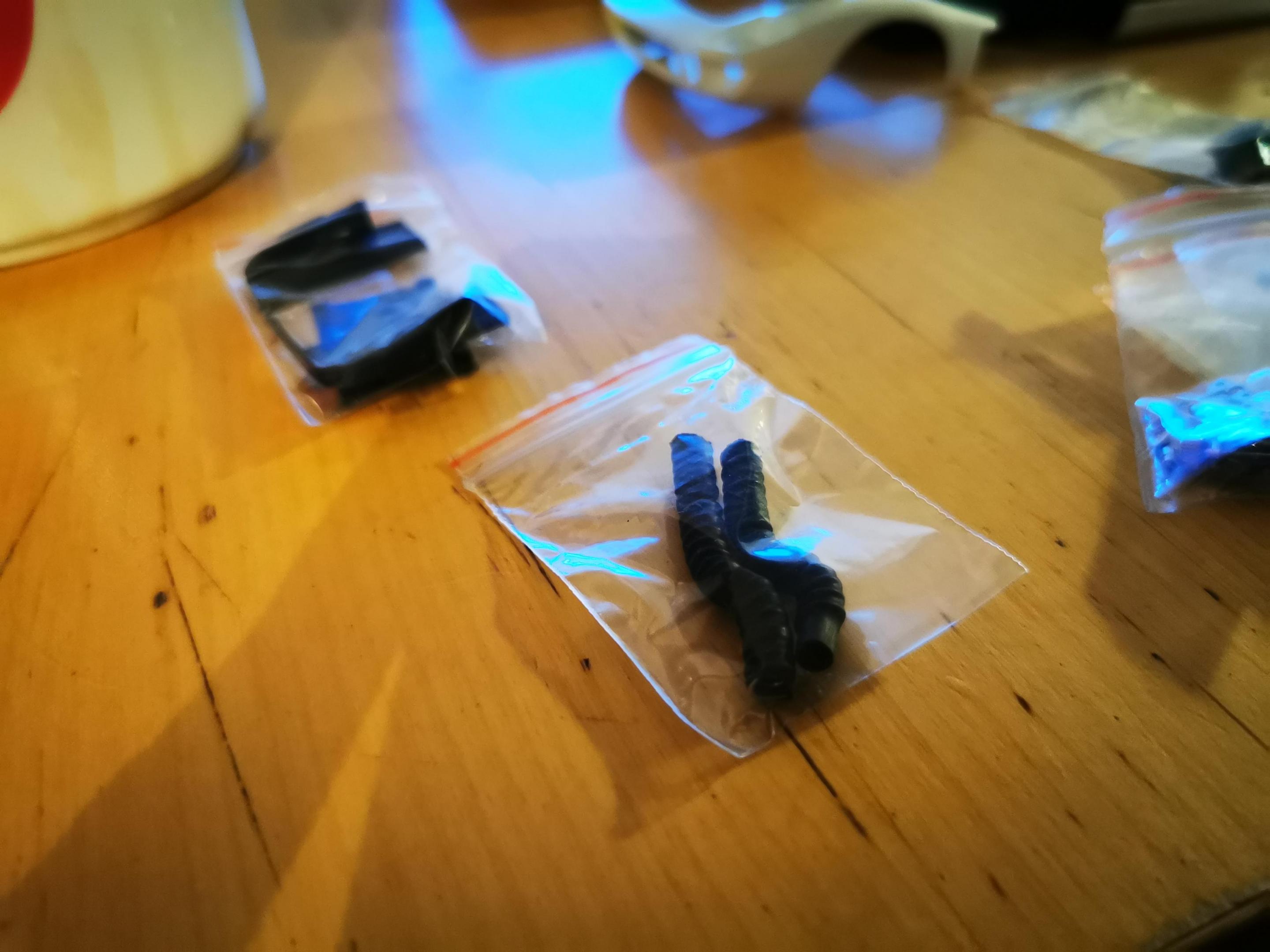

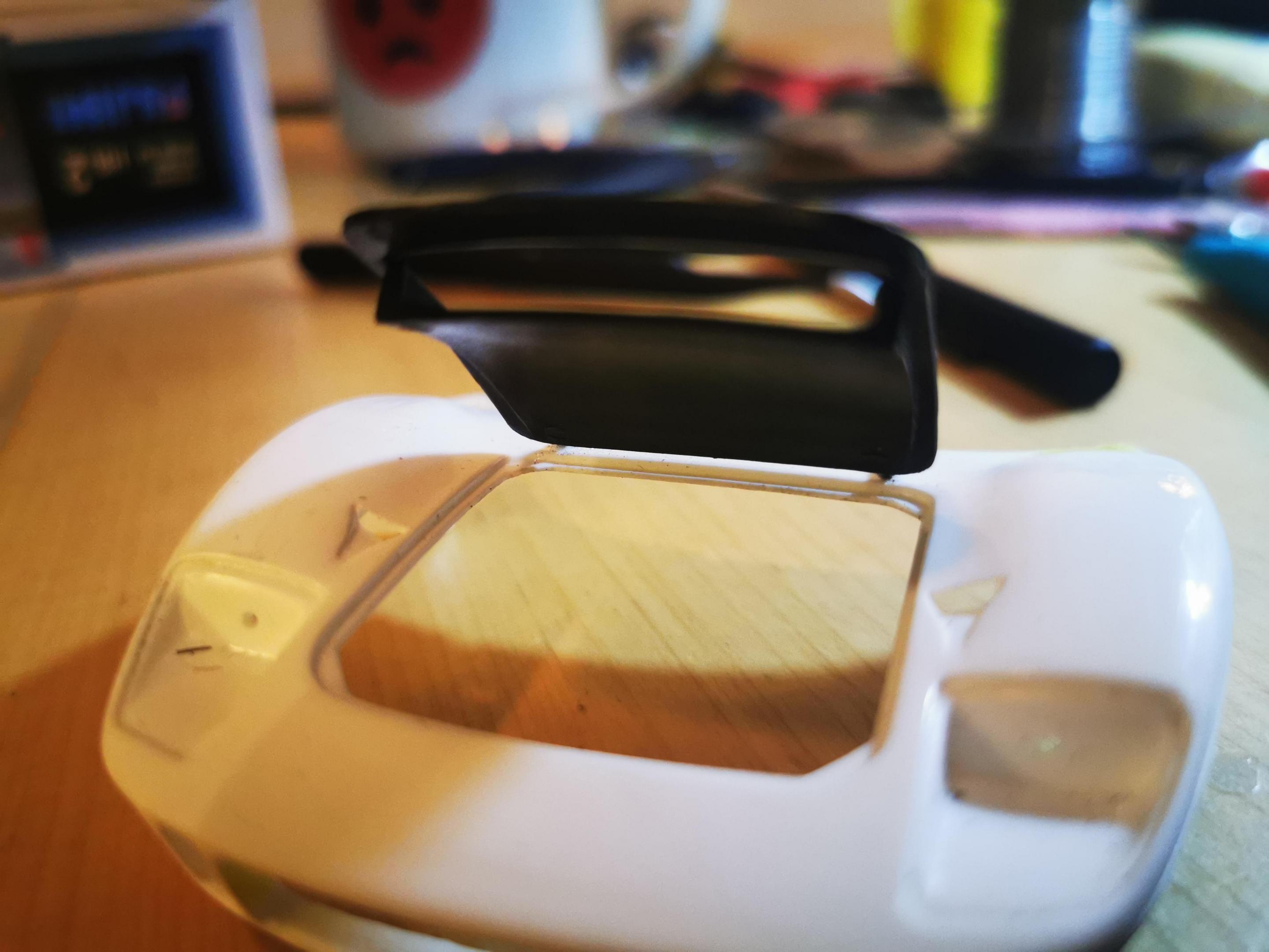

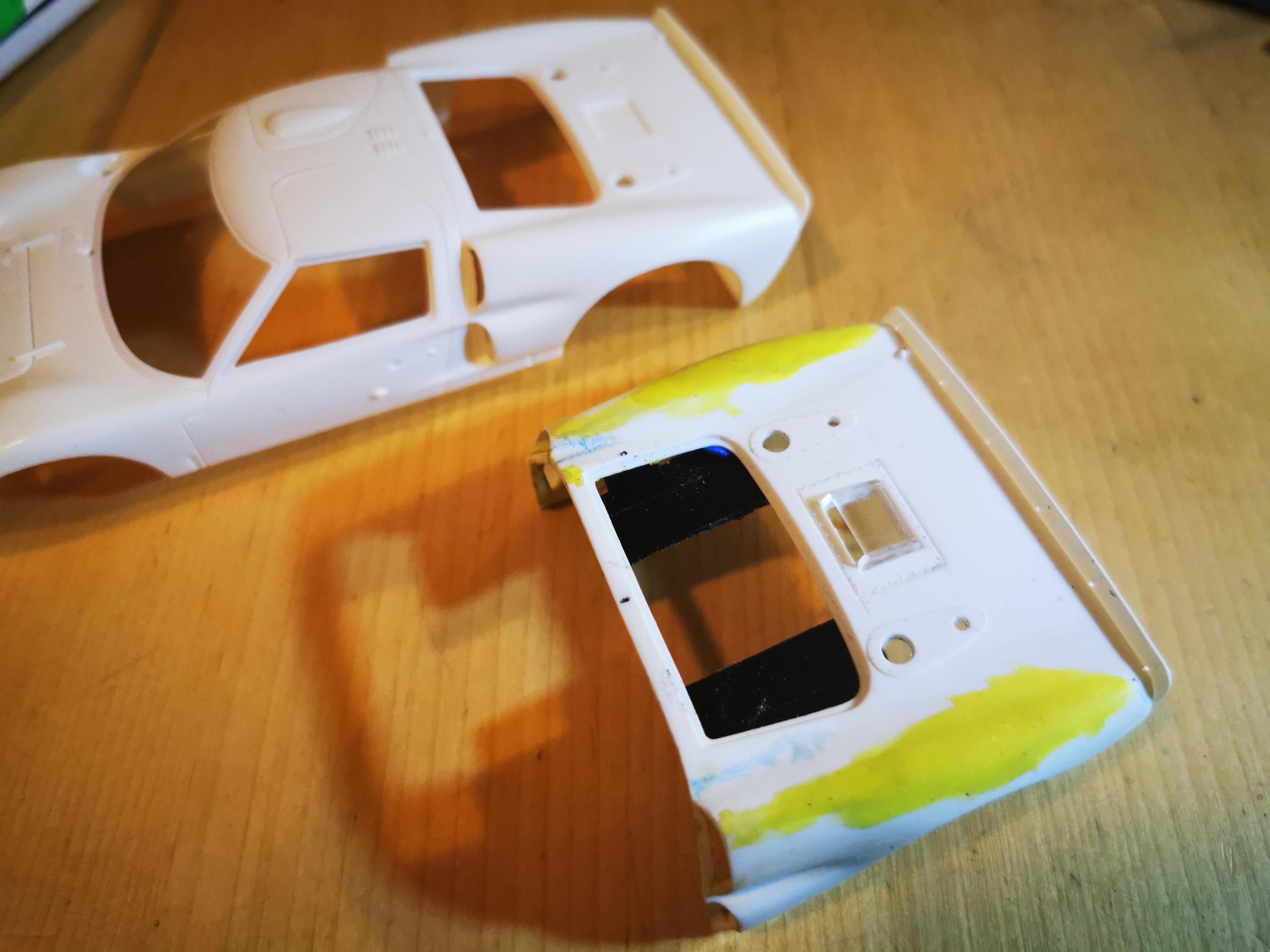

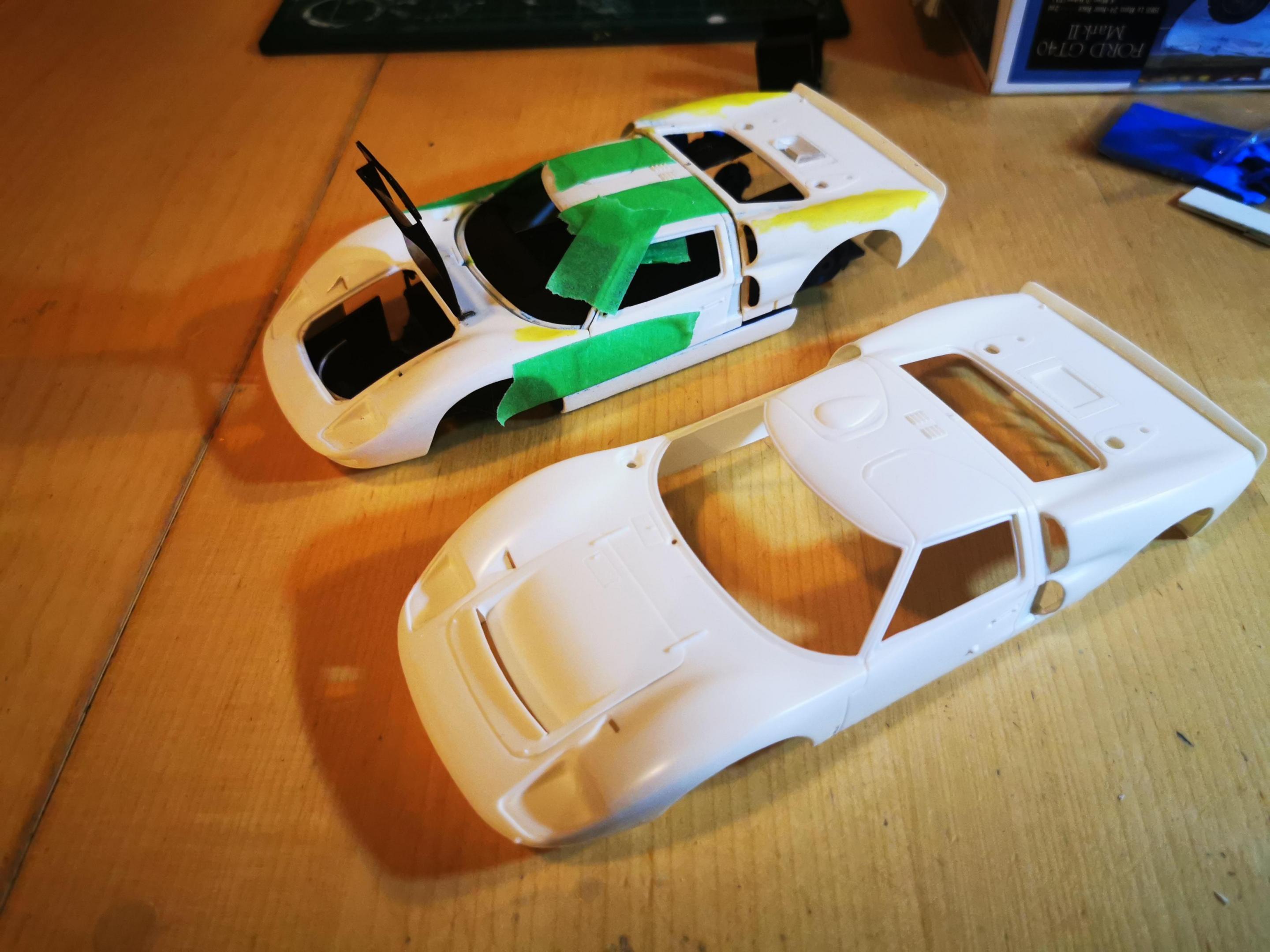

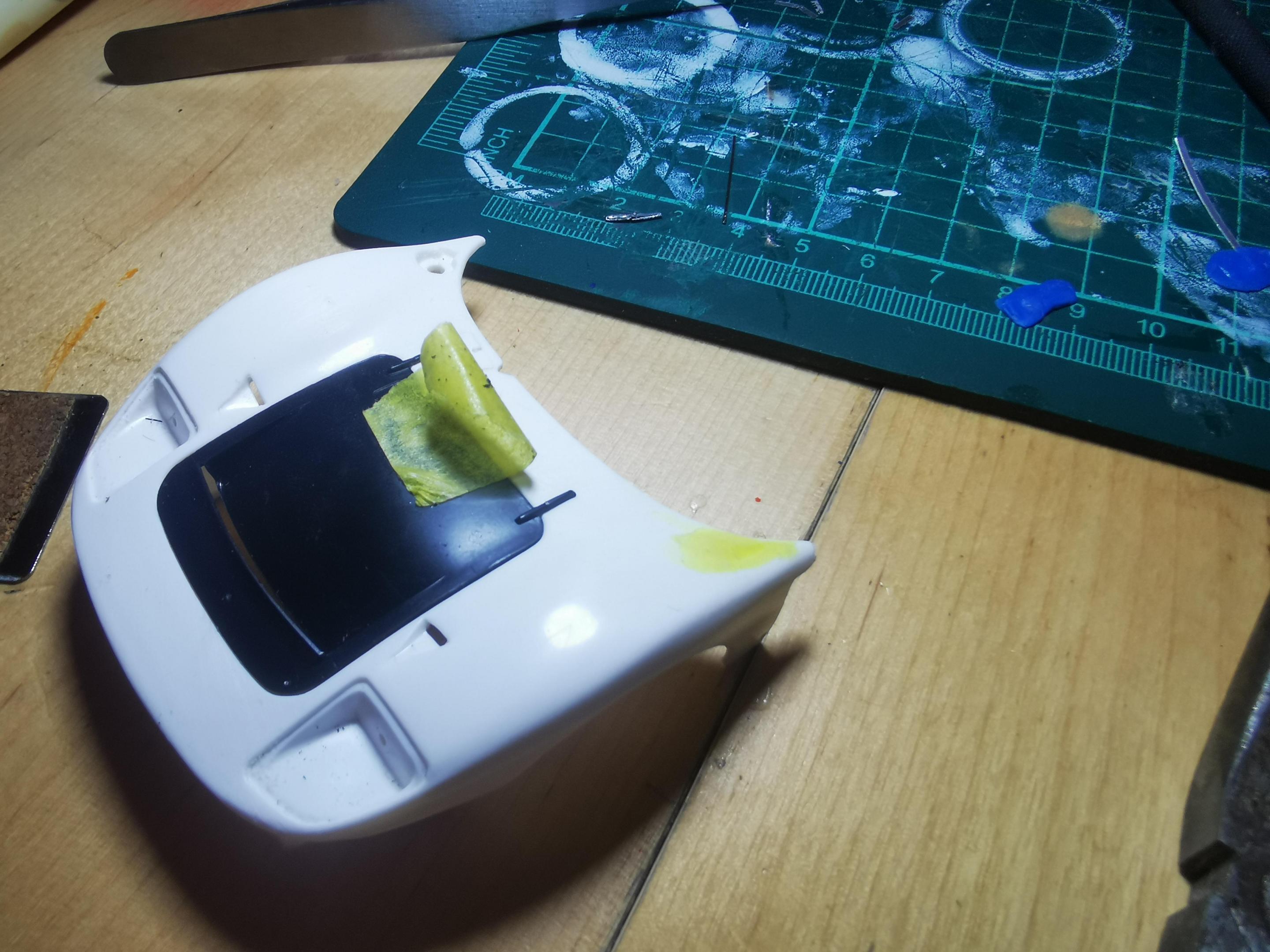

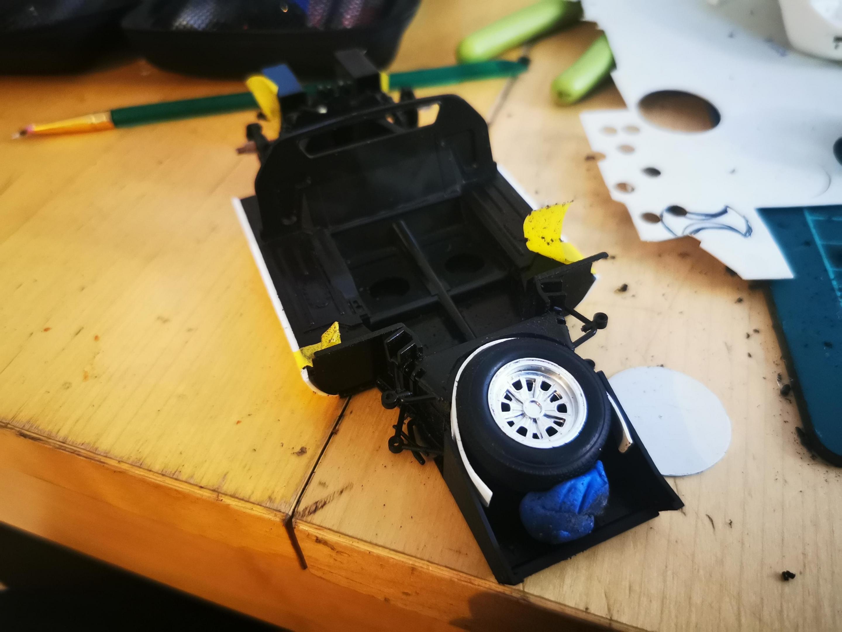

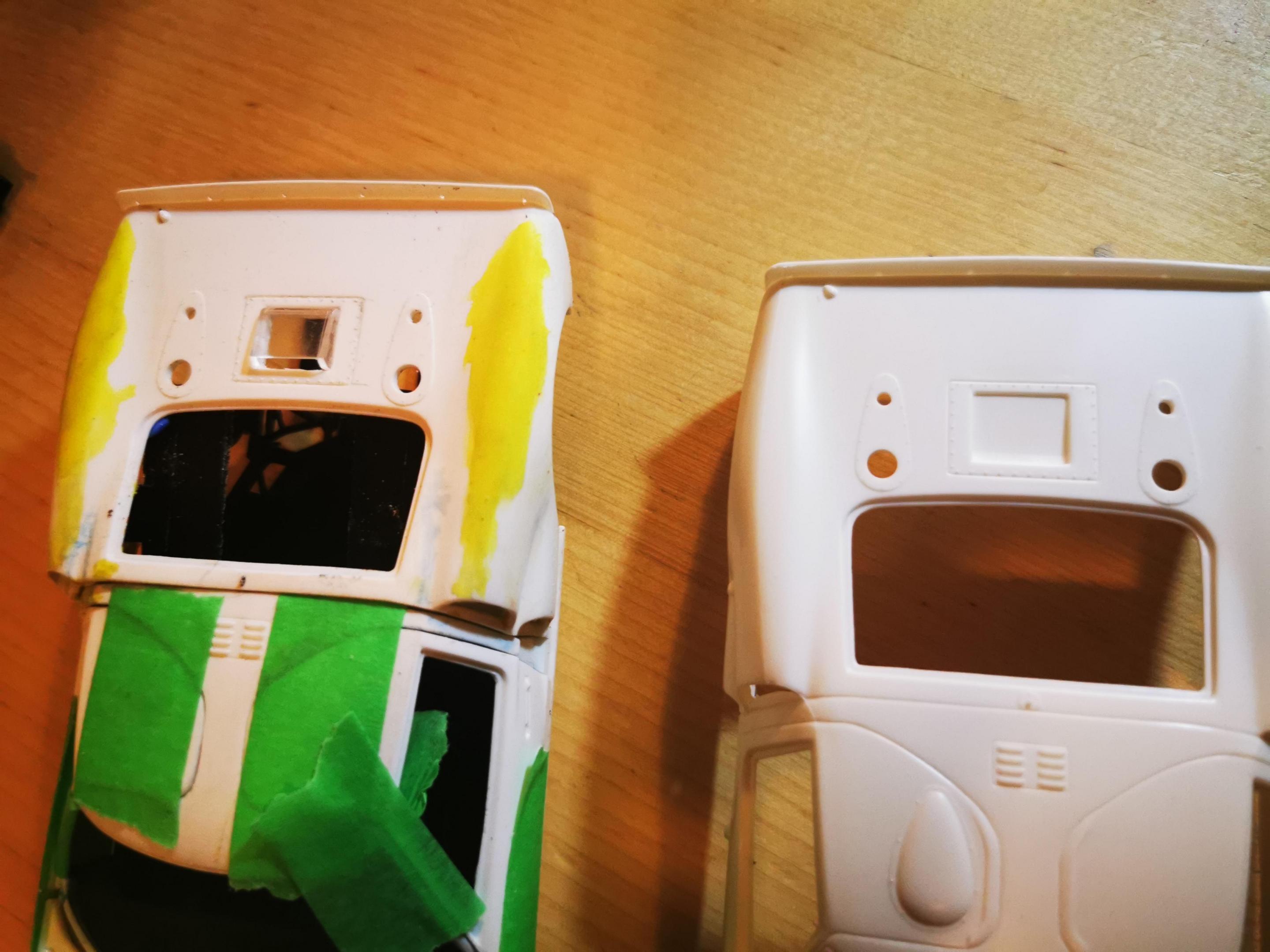

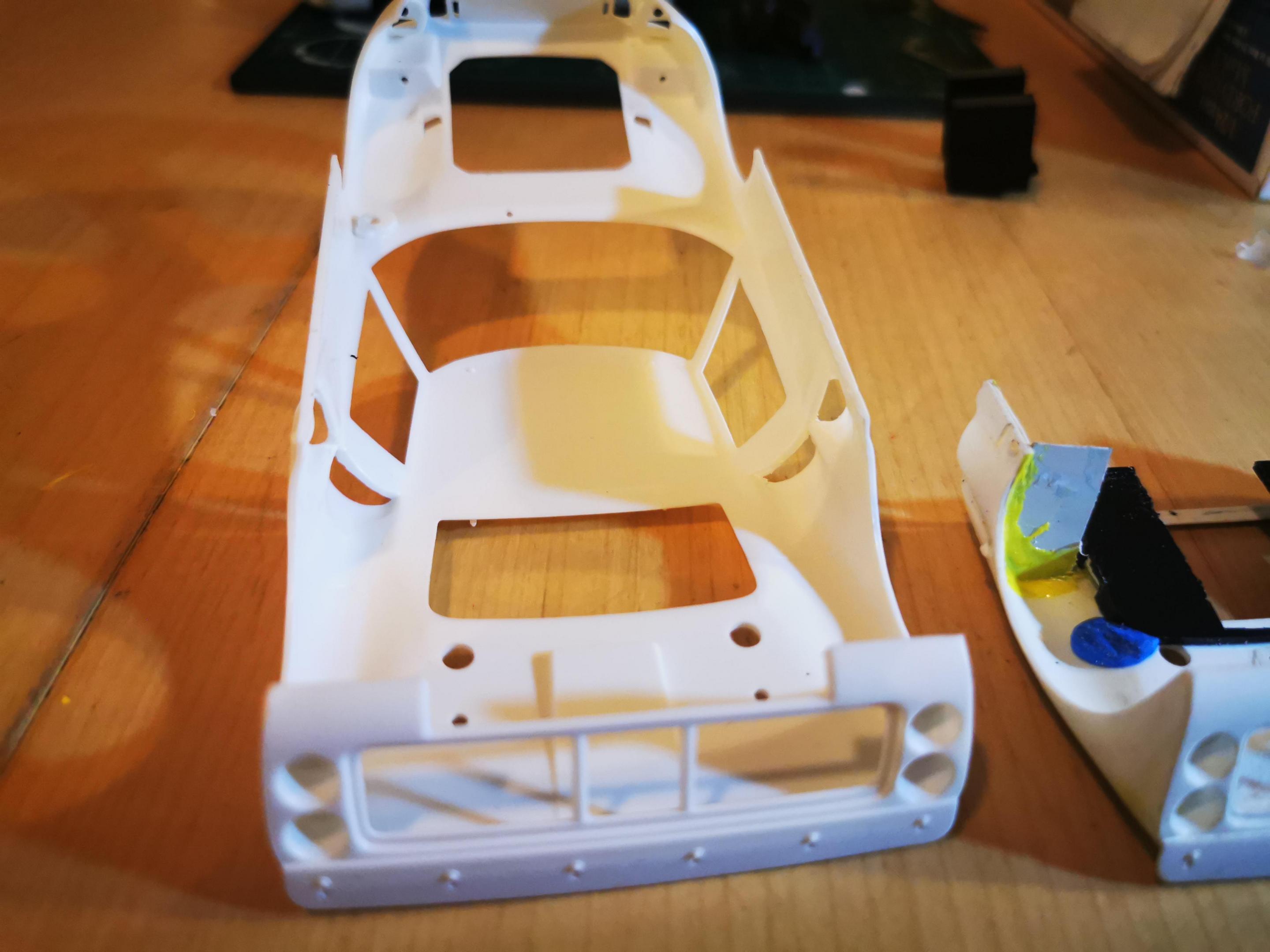

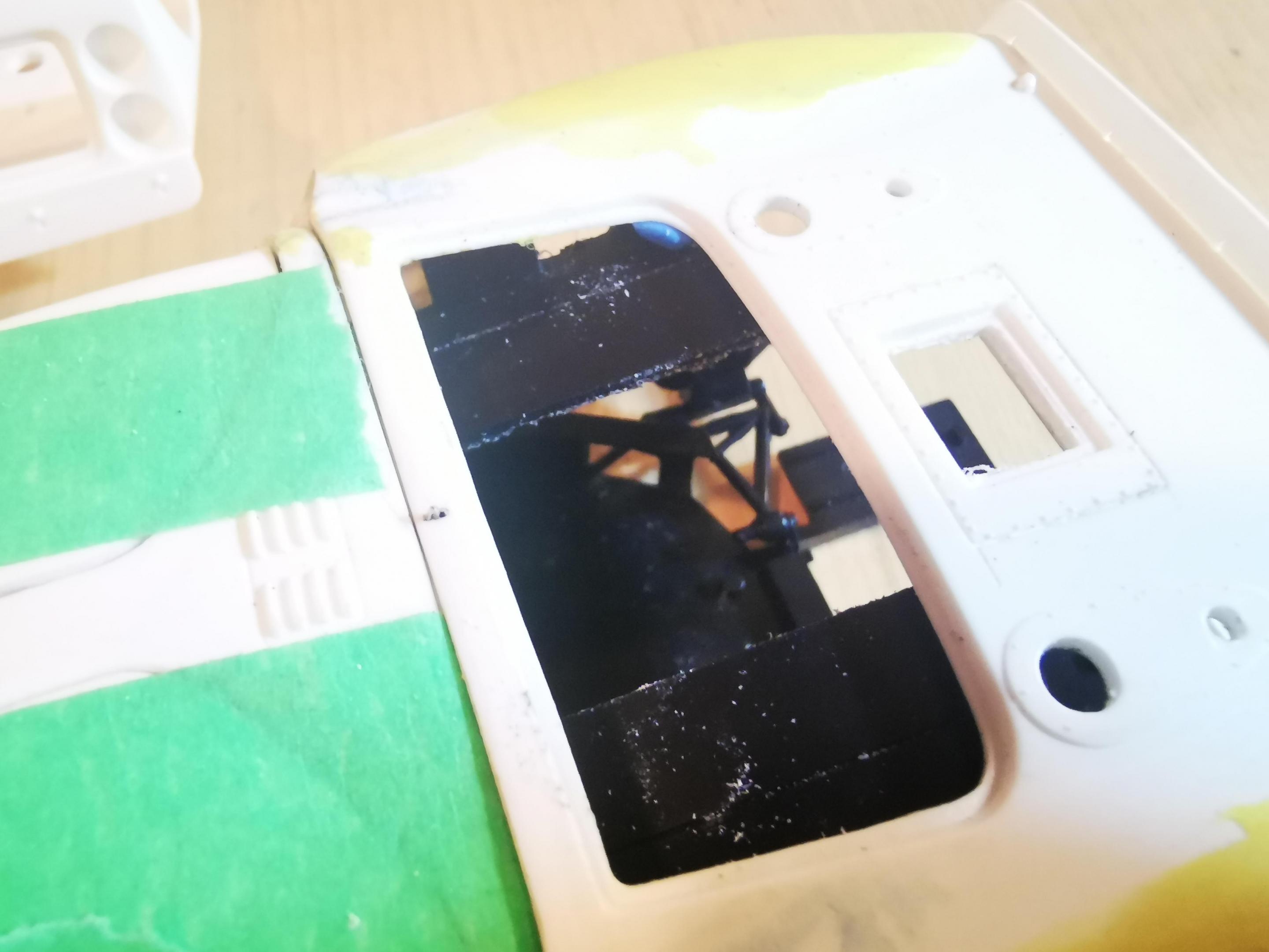

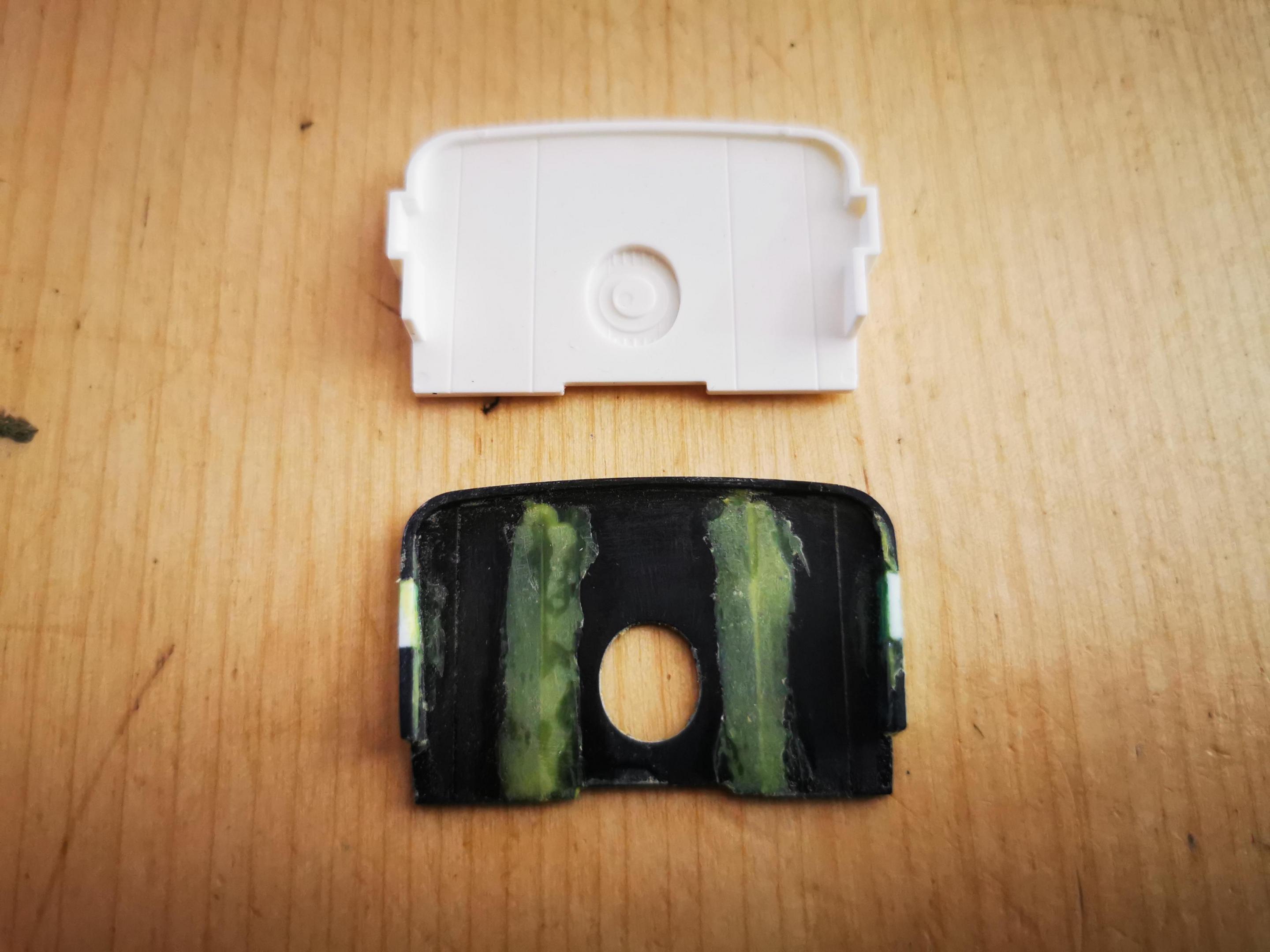

Decided to work on the engine cover today. Had to clip off the vent ports that were in the wrong position and fill them up. Also cut out the fake carburetor molded in the engine cover under the rear bonnet. Doesn't look like much, but i had to split the middle section first to get a better angle to cut through the carb, remove the carb, glue the middle piece back in place, use some putty to fill the gaps from sawing, sand, cut little 2mm triangle pieces to fill the vent ports. Tested in place and it actually looks good and fits great!

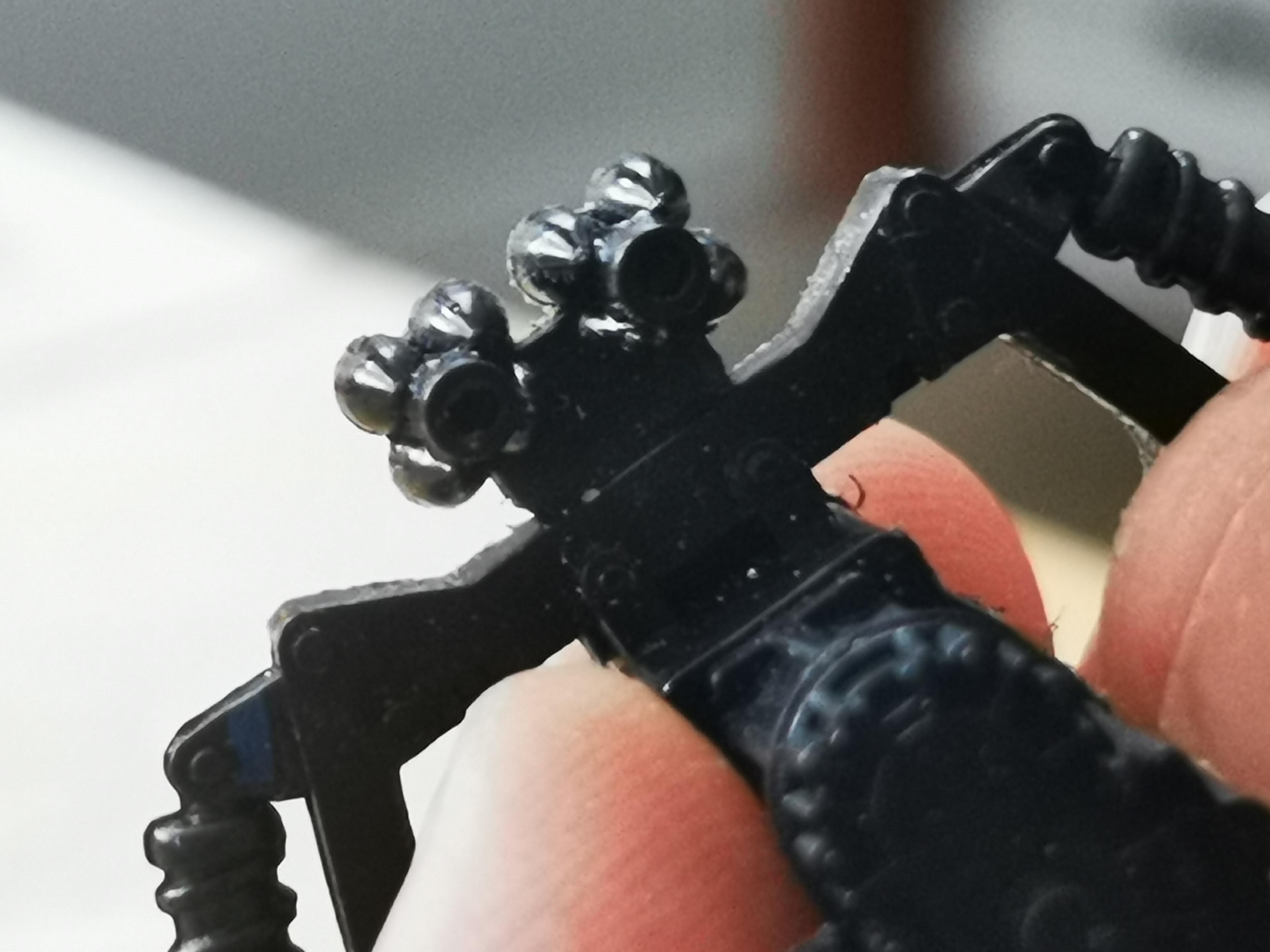

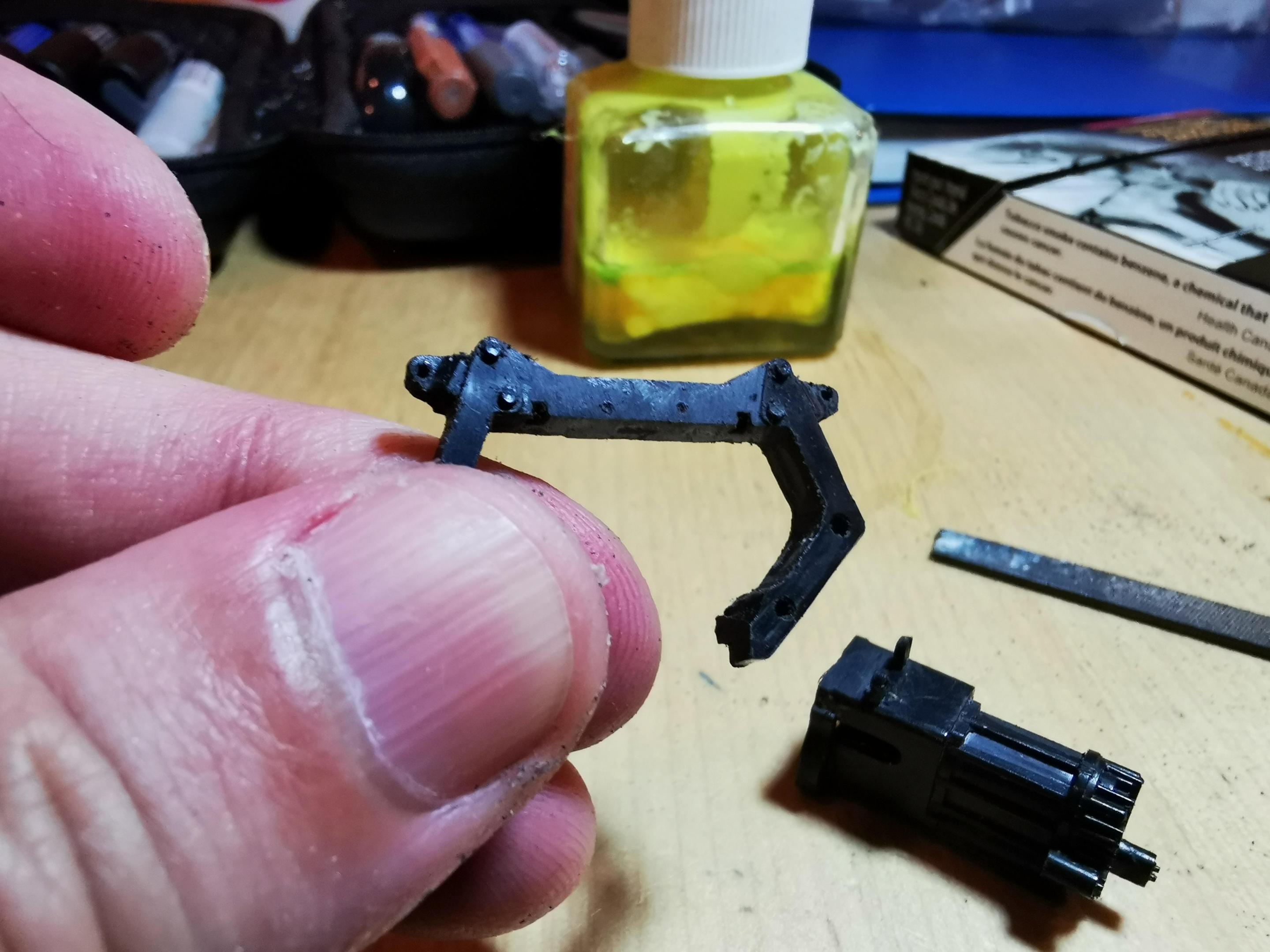

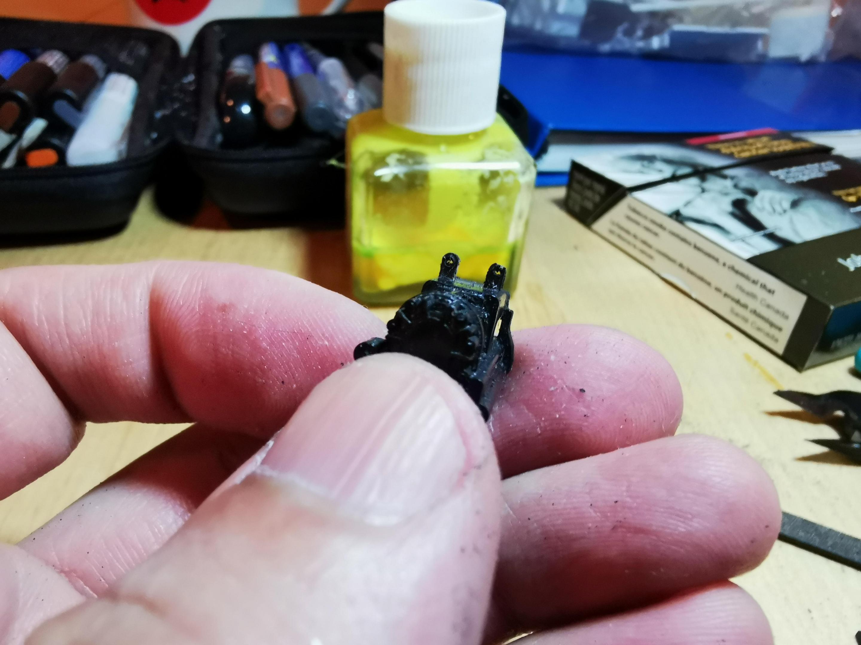

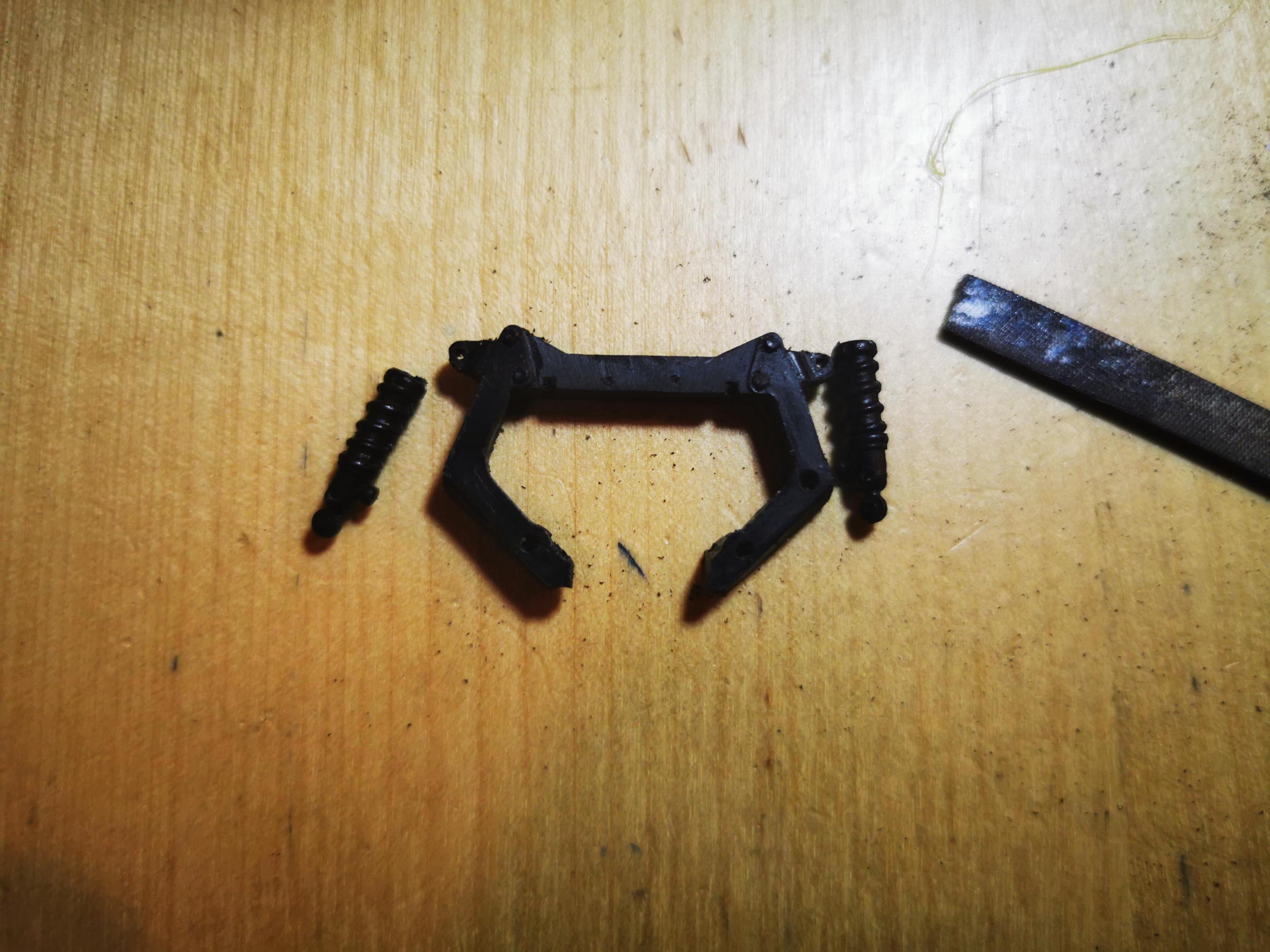

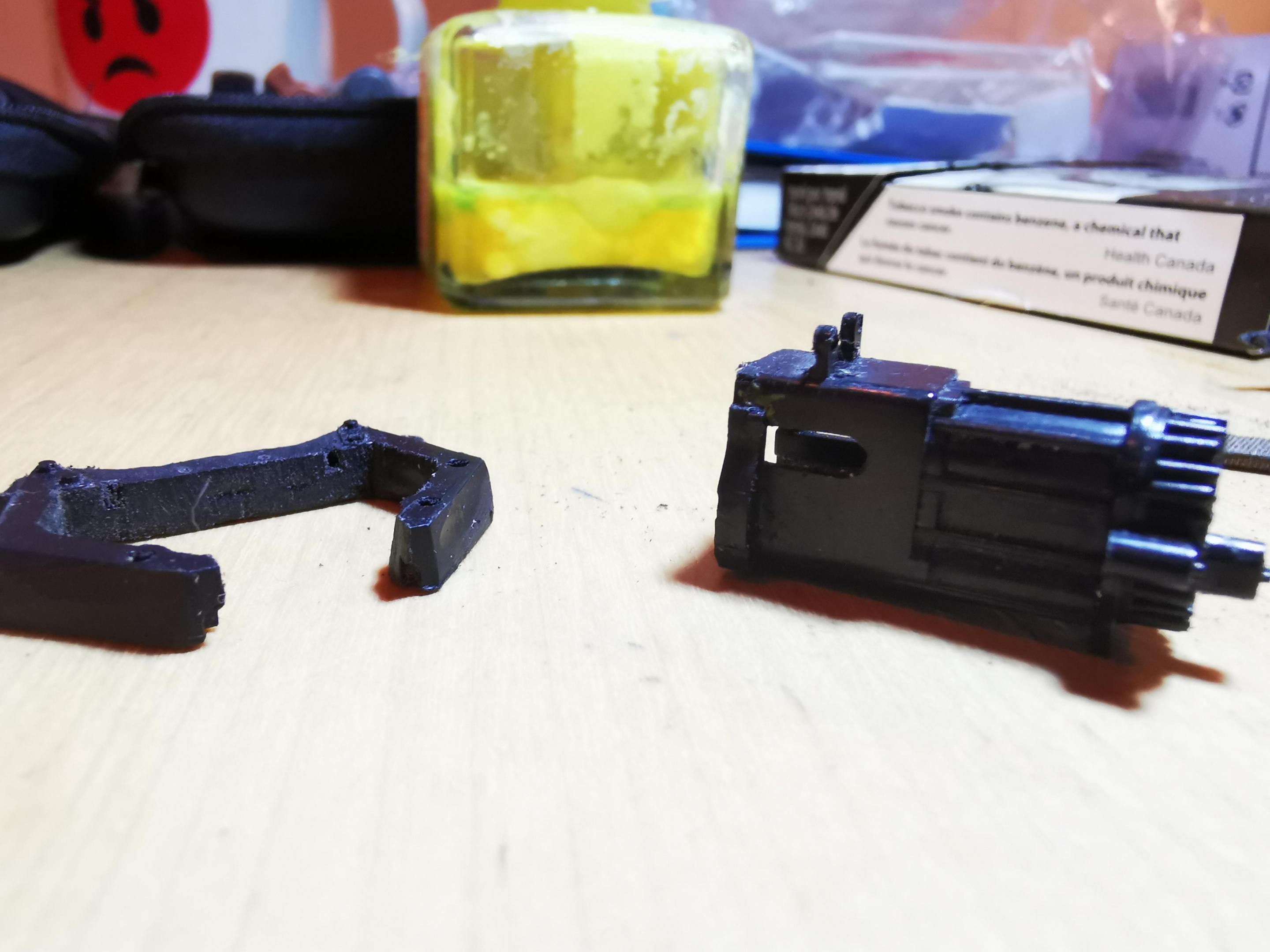

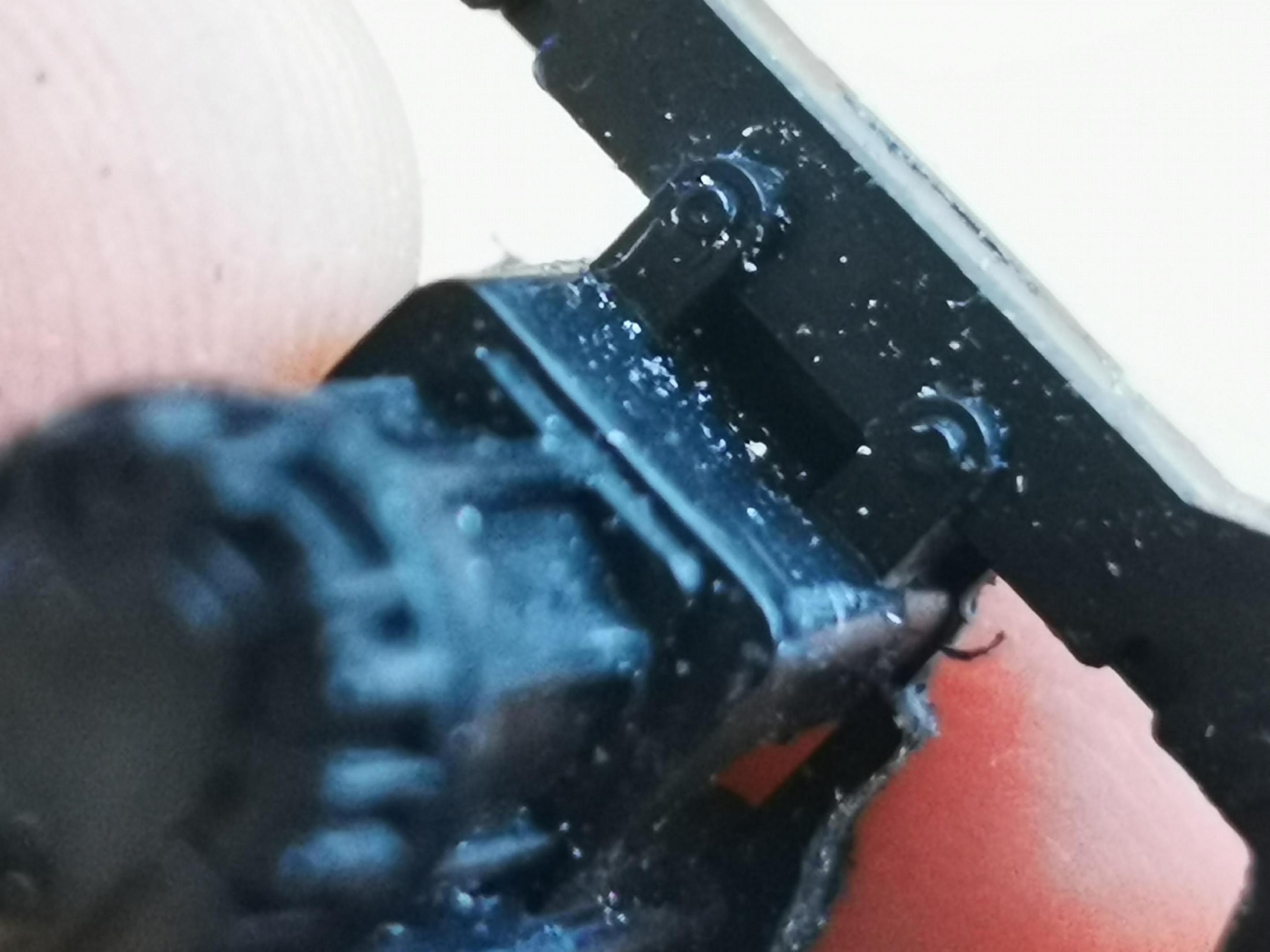

I am now in the process of removing the dual 4 port exhaust from the rear suspension piece.

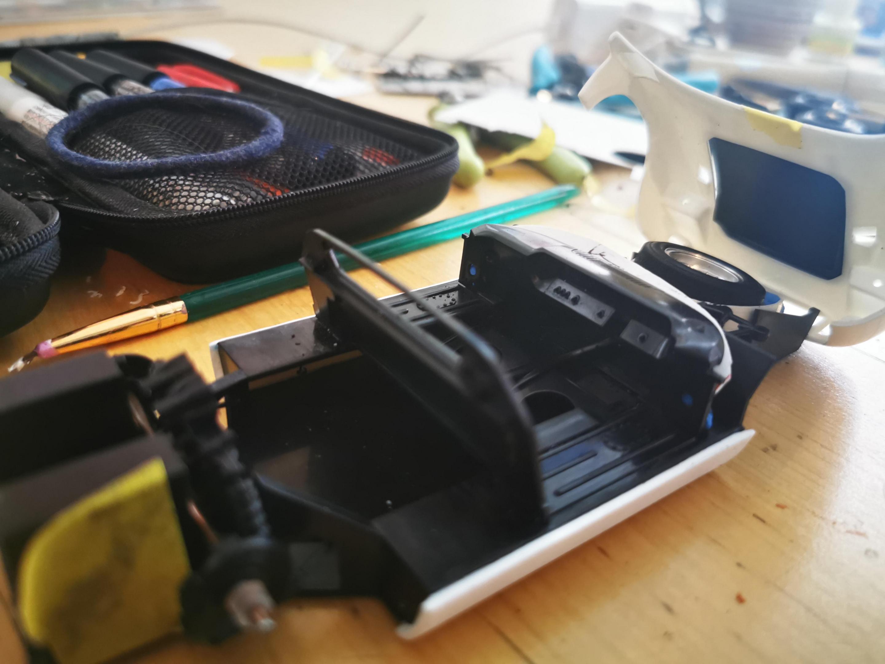

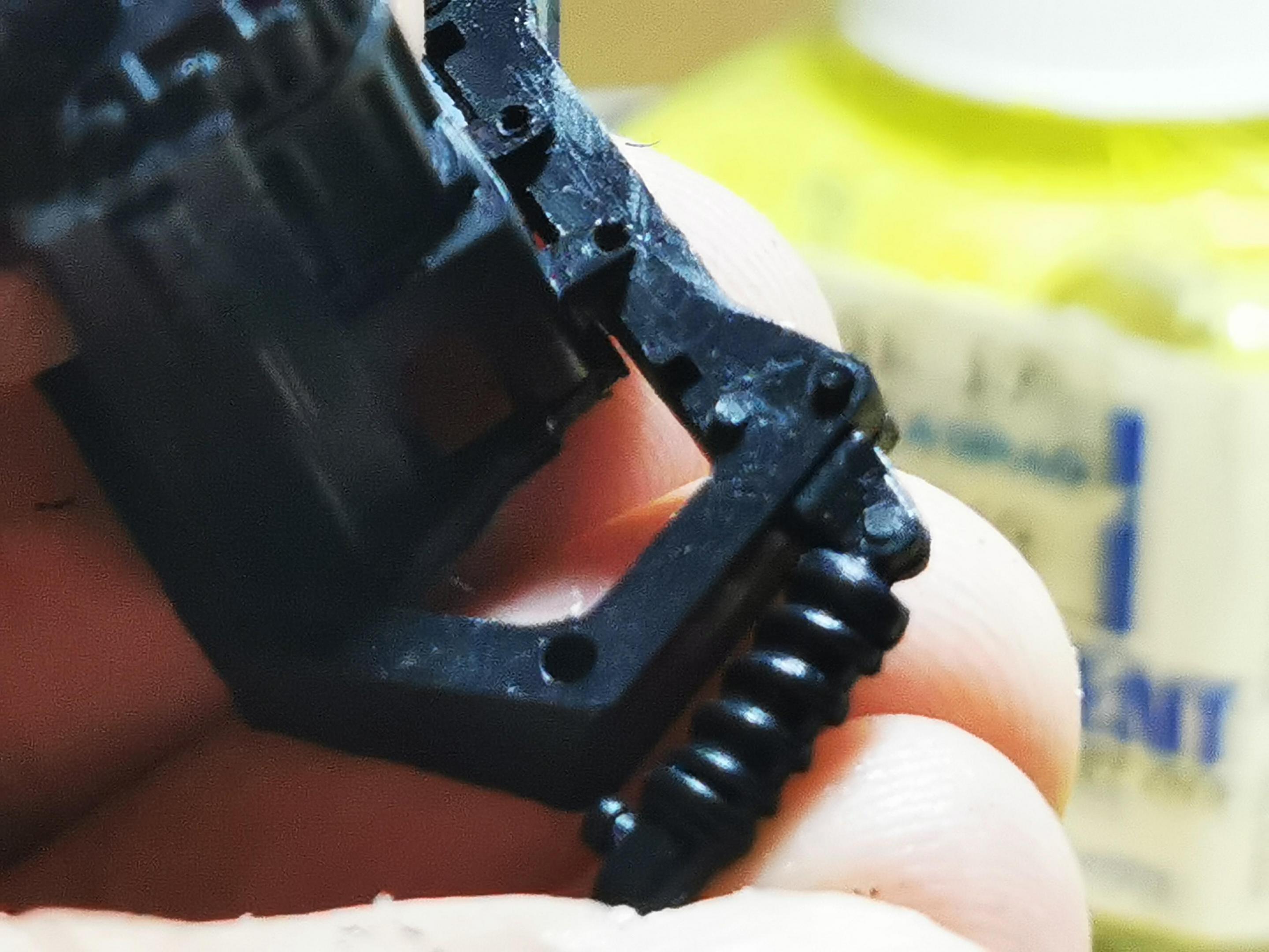

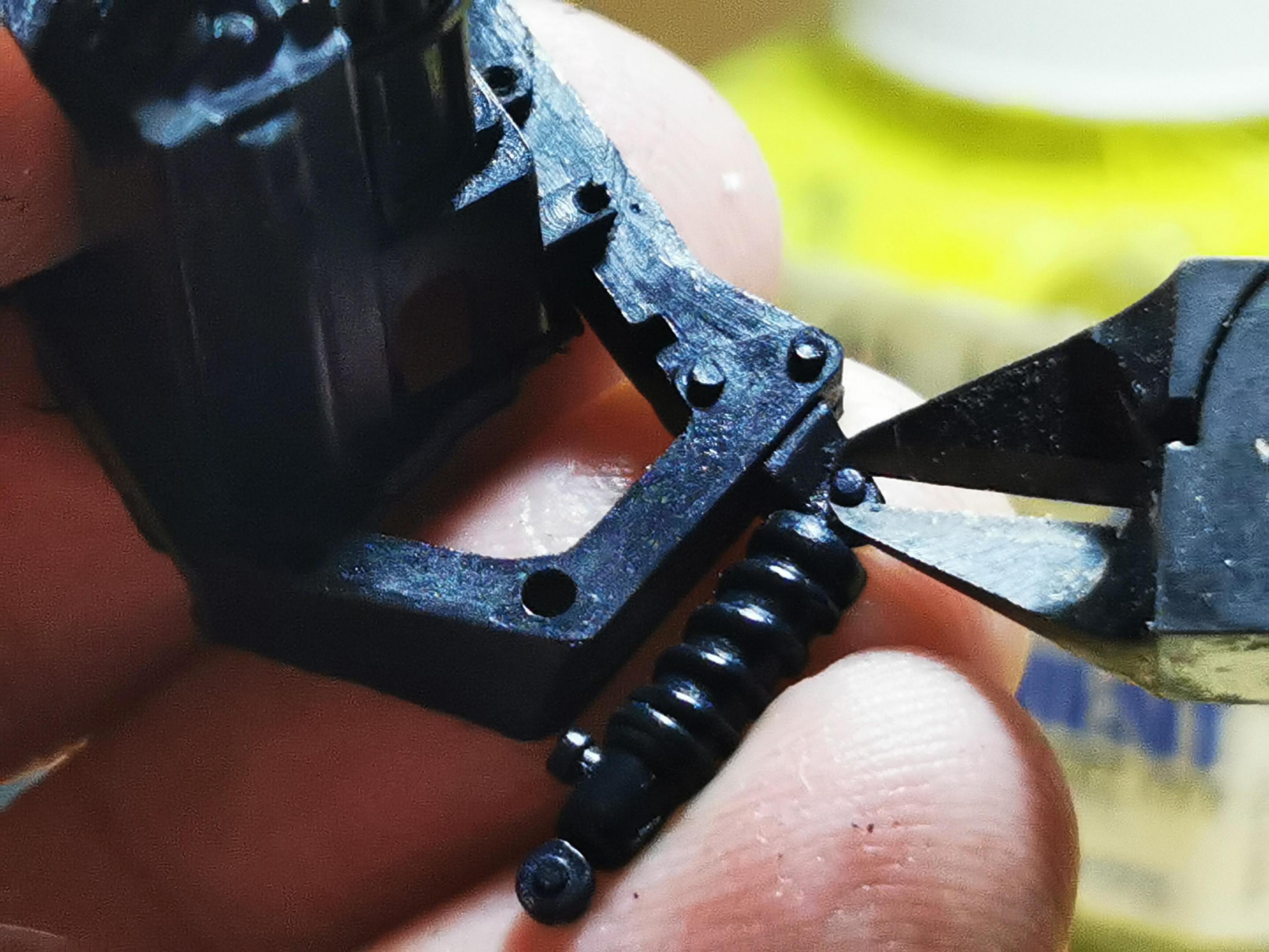

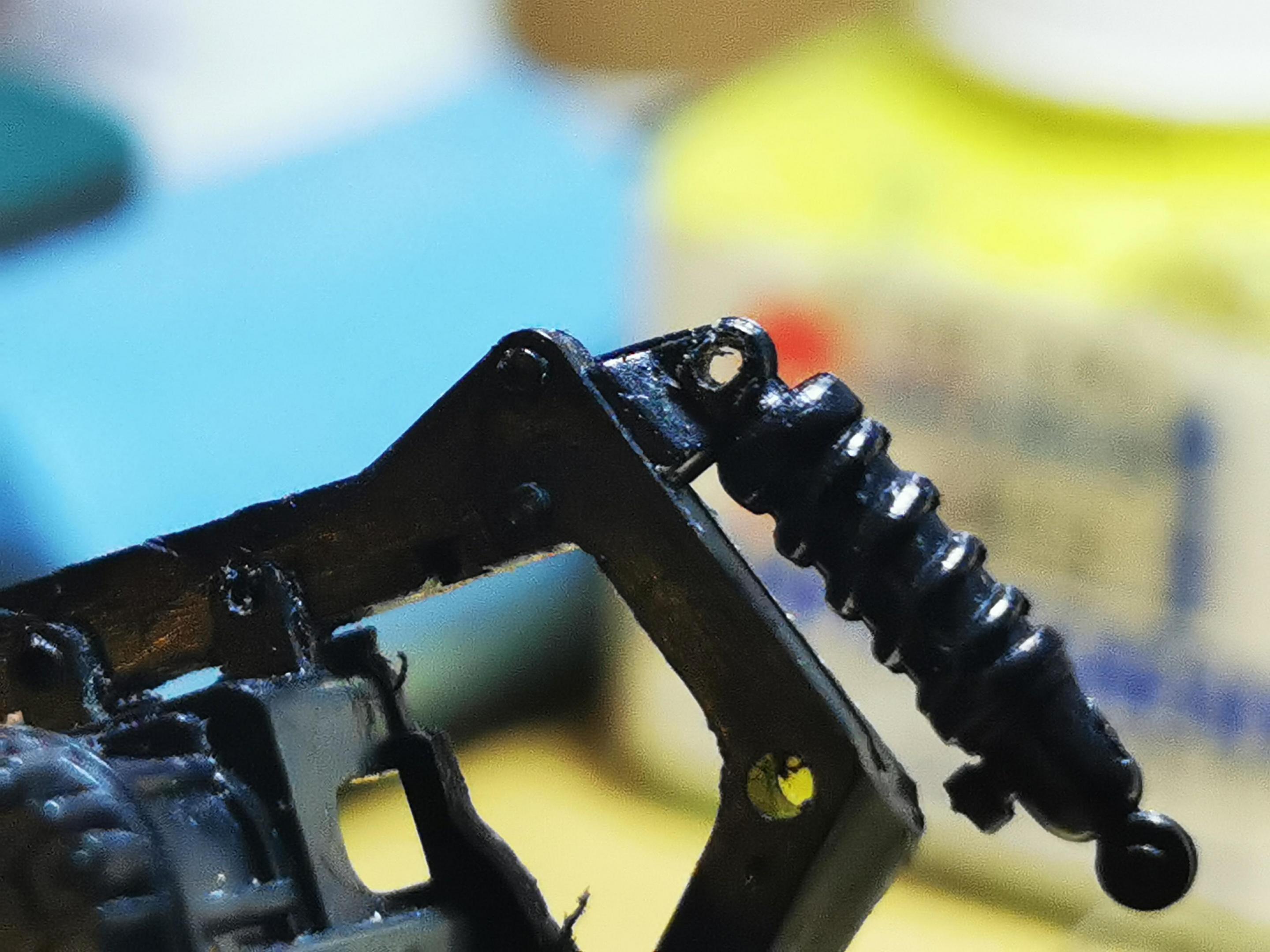

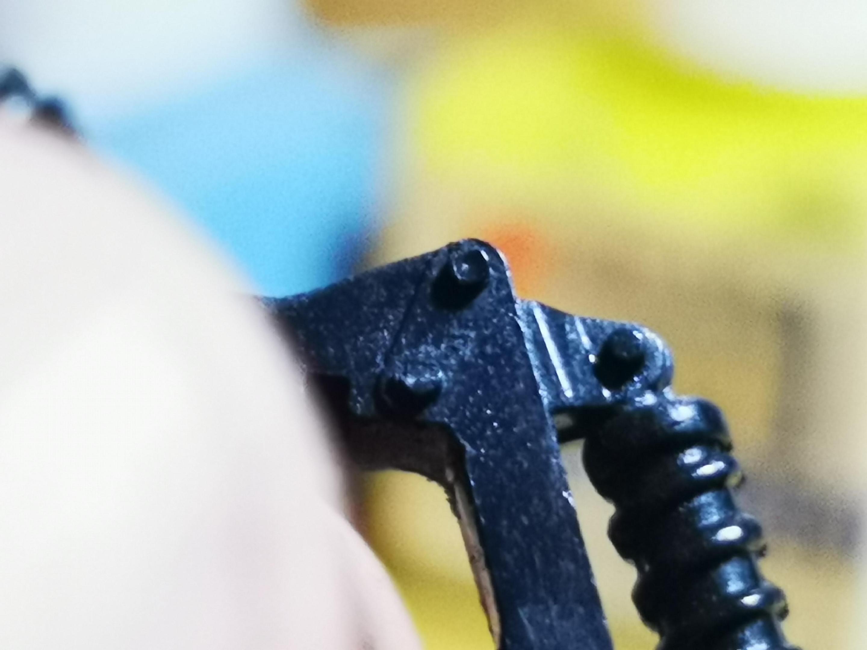

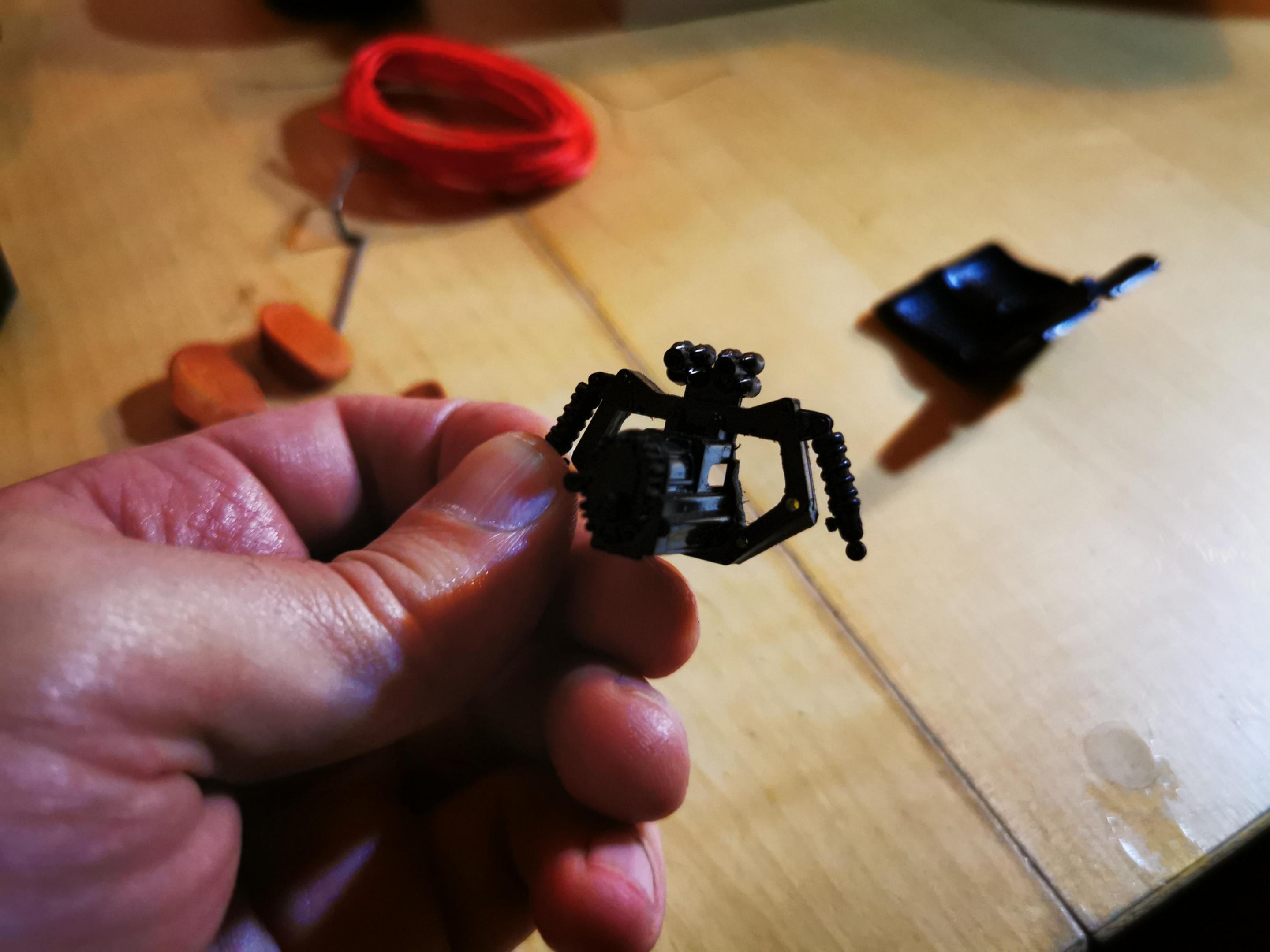

Ok... So I detached the trans box from the rear strut... Drilled the rear coil over connections into the strut... Detached the coil overs. Need to put the rear strut back together... Scratch build the coil overs... Make engine...

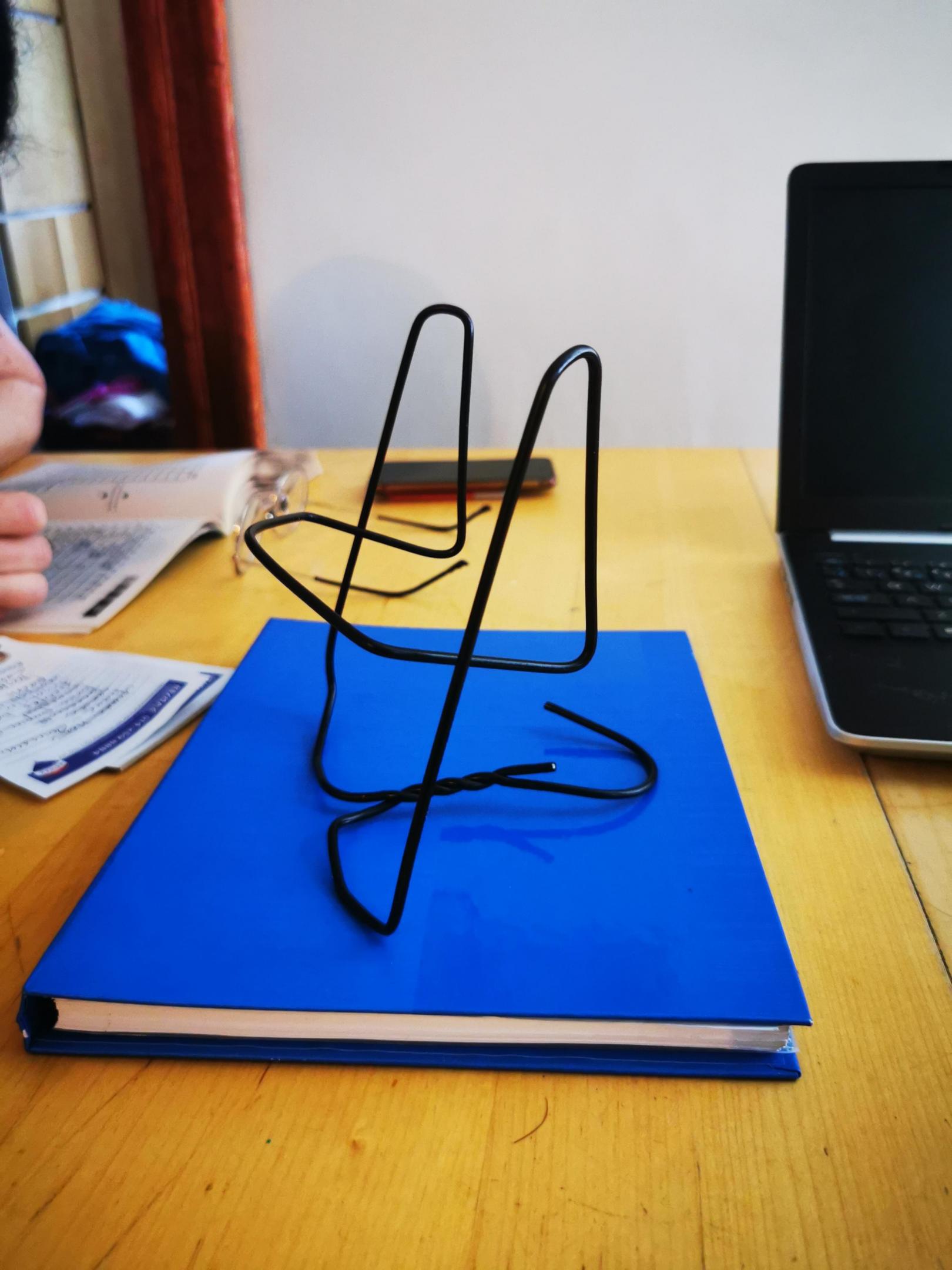

Here I am cutting off the exhaust. Recording this was easier said than done. Because I don't have a stand/tri-pod to record I had to fashion a camera stand out of a coat hanger. I was actually surprised to see how well it worked.

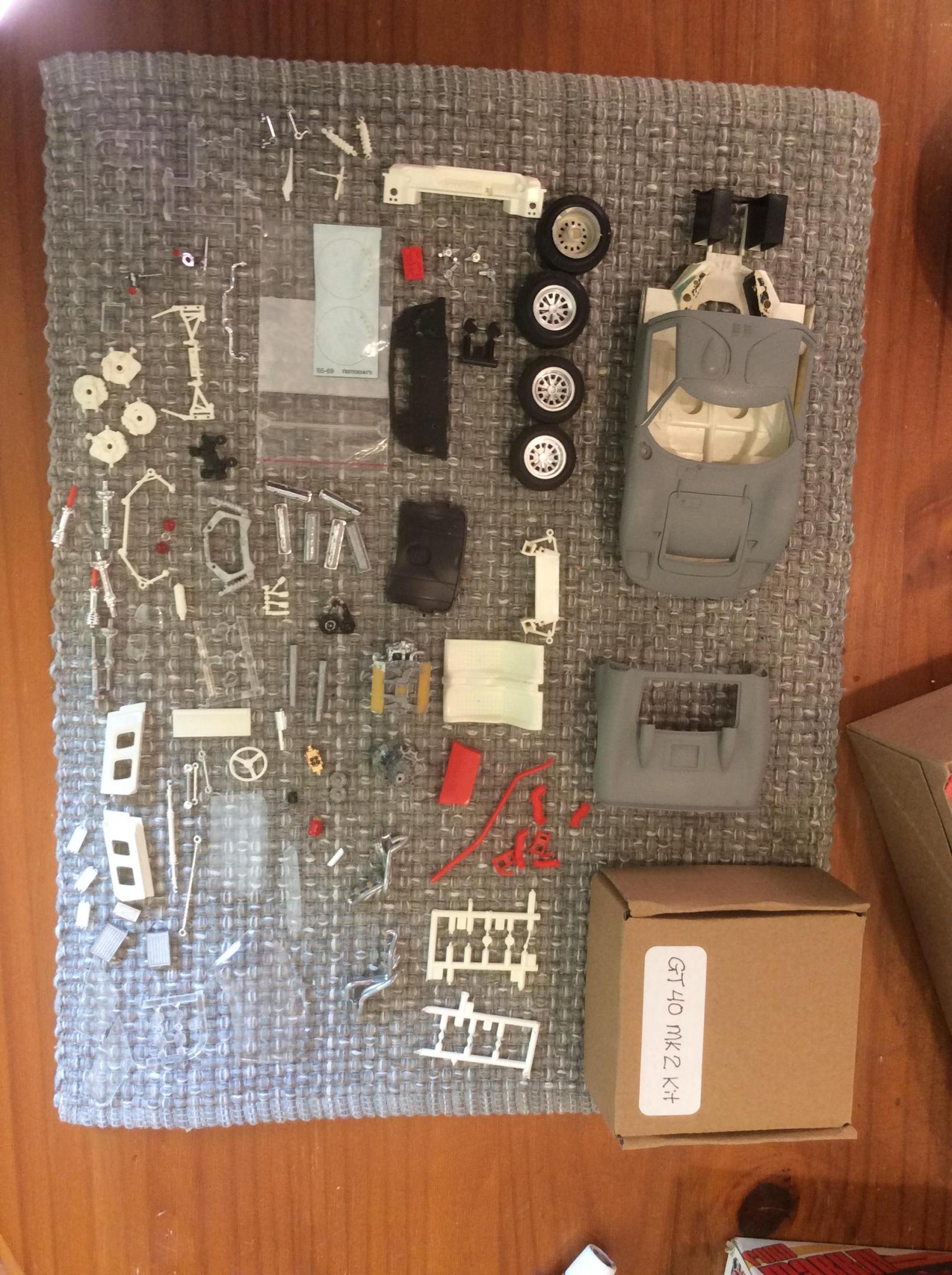

I guess the correct term should be conversion kit as you are "converting" part of one model into another.  Sometimes I start with a "complete" resin kit and add other resin or plastic parts.  I'm not sure who started the "trans" kit trend but CMA and many others use that term.  Anyway,  keep us updated on your enhanced, semi scratch built and modified MK II.  As for what holds the engine in, a lot of expoxy and super glue using the Fujumi or HRM part that the gearbox goes through.  Adding the engine adds a lot of weight so it was hard to get it to stay in one place.  Remember - the CMA transkits do not come with any engine - just a simplified gearbox using the Fujumi kit parts.  No doubt I will encounter the same problem you are anticipating with my modified MK II I started on long ago that is similar to what you are doing now.  I will be watching to see how you make hinges for the doors and rear deck.  I added some photos on the yet to be determined MKII build and a diecast to give an idea of what I would like the engine compartment to resemble.

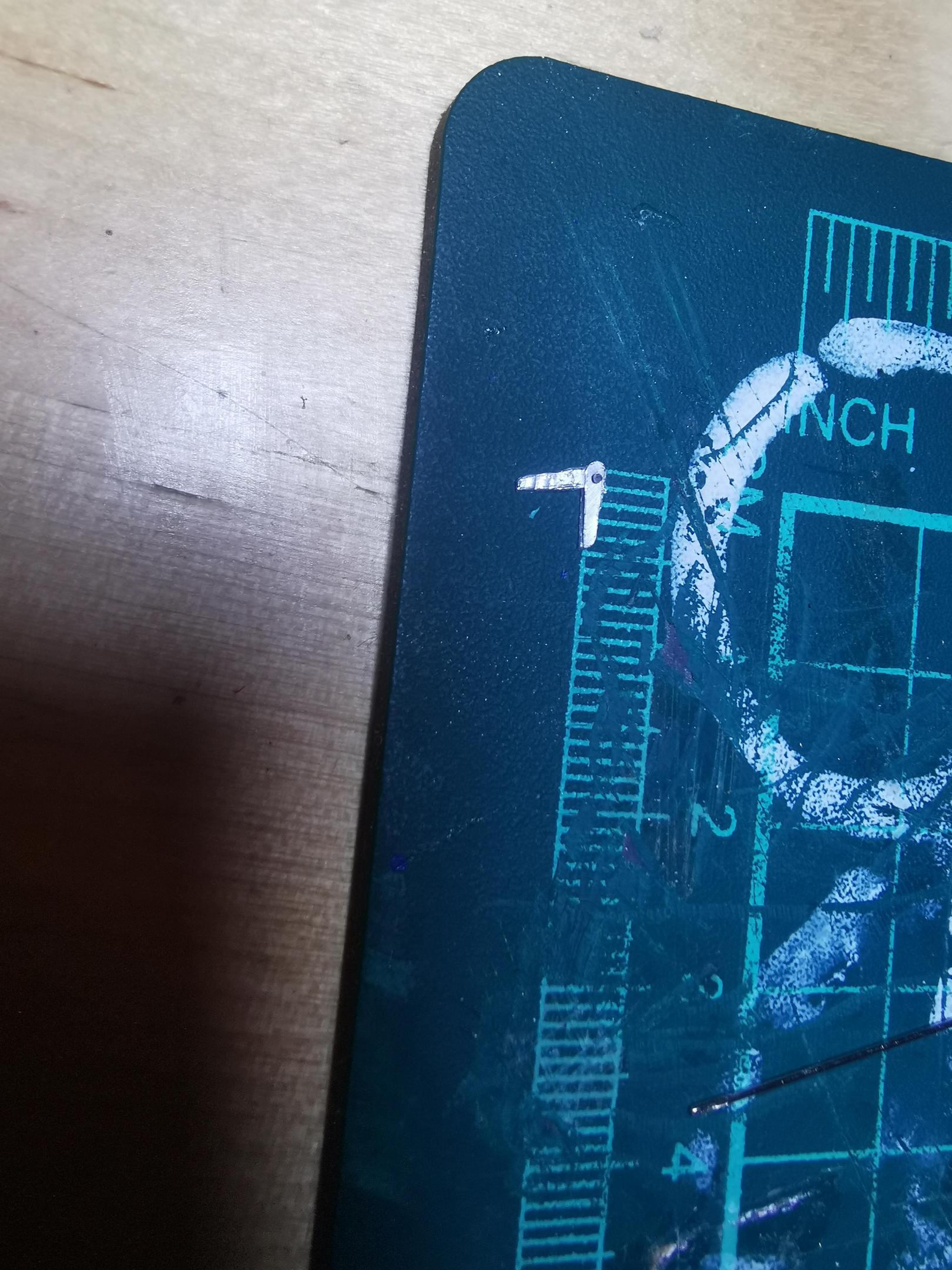

HAHAHA. Yah, I guess in reality it doesn't matter about the term used. The result is the goal. And I will. I am waiting on some Albion Alloy tubes to come in the mail. The 4 week possible lead time is killing me! I am planning out what I will be working on next!

Thanks Edgar! I think later today I will start making the prototypes for the hinges in plastic to be later transferred to brass.
